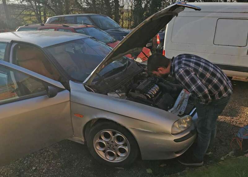

Six-cylinder Posted February 25, 2023 Author Posted February 25, 2023 Not a good start to the day, I went to take the Alfa 156 to a small gathering near Leighton Buzzard and it would not start. It turns over with enthusiasm but did not did fire. It has been an old problem but I thought it had been sorted when an Alfa specialist cleaned all the connections. With no time to even do basic checks I grabbed the Volvo V70 T5 for the trip. Since @Andyrew put some new used tyres on it for us it runs beautifully smoothly. The car gathering was great with a huge variety of cars, from a smokey engined Audi A3 TDi to a pre-war Daimler 2 1/2 Ltr saloon. I was a little out of area so 75% of the cars I had not seen before. Andyrew, High Jetter, Dyslexic Viking and 7 others 10
Six-cylinder Posted March 2, 2023 Author Posted March 2, 2023 Alfa still not starting. Both mine and @Andyrewcode readers say no fault found.

Zelandeth Posted March 2, 2023 Posted March 2, 2023 52 minutes ago, Six-cylinder said: Alfa still not starting. Both mine and @Andyrewcode readers say no fault found. Hmm...If it's cranking merrily but you're not getting any spark/fuel/either crank sensor seems most likely candidate. Got any ability to interrogate live data to see if there's a feasible engine RPM shown while cranking? LightBulbFun 1
