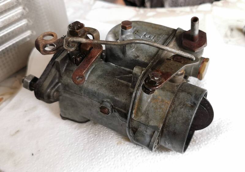

First job for today was to reassemble this so that it can be returned to its correct home tomorrow.
It wasn't hugely dirty, but one of the main differences between this and the previous rebuild was that this time I used a proper (used) gasket rather than a home made job from last time.  Given how tiny the idle jet passage is in this carb it's entirely possible this was an issue.  Fingers crossed this will get Dolly running properly.

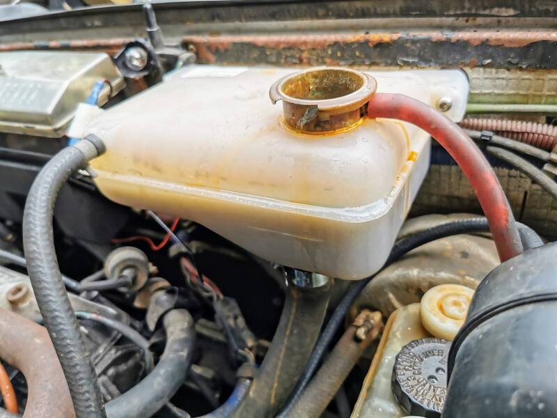

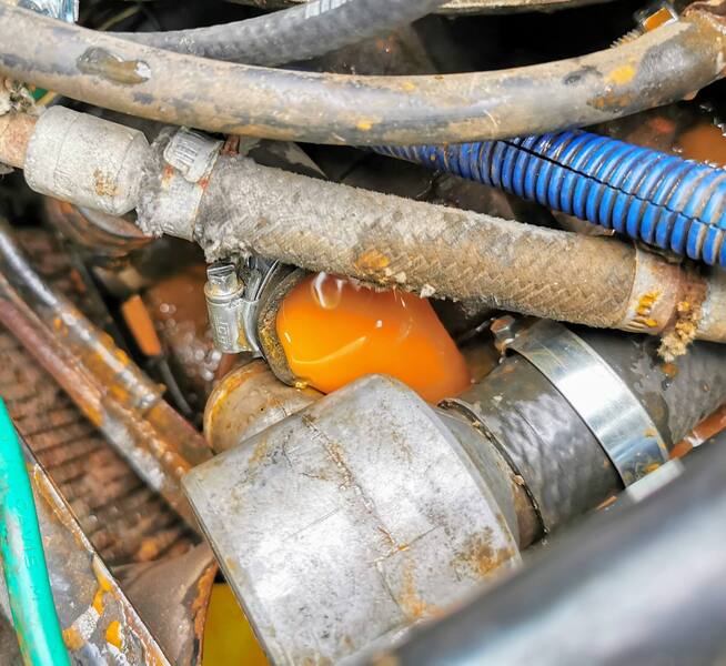

Next up was a coolant flush which I knew was rather urgently needed.  Quite HOW desperately needed became apparent once I started draining the coolant.
Yes, this is completely opaque and as neon orange as it looks.
I've split the bottom hose from where it attaches to the thermostat housing as the actual bottom hose connection on the radiator is almost entirely inaccessible without removing it from the car.  Given we know the radiator is clinging to life by pretty much entirely by willpower alone at this point I wasn't going to go to lengths like that nor get too aggressive with it.
Given the poor access and the sheer number of things the water was bouncing off on the way out of the engine bay it was no huge surprise that my attempts to capture the escaping coolant were about as successful as expected.
That hose shifted about ten seconds later when I wasn't looking and dumped an order of magnitude more water everywhere.  This better shows how opaque the coolant was!
It's almost entirely just rust and water though, there's no sign of any antifreeze I can detect, so I sighed, shrugged and just made a point of thoroughly rinsing down the area afterwards to ensure that anything was sufficiently diluted to eliminate any risks to cats etc.  This doesn't smell sweet like older antifreeze though - no, think "rank, stagnant pond water" in this case.

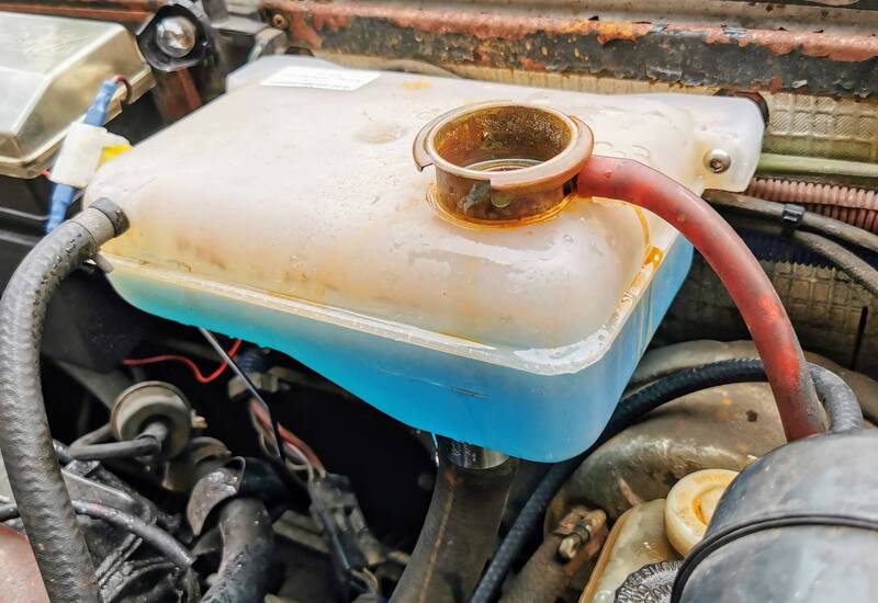

This is what was left in the (couple of week old) expansion tank after it was drained.
Yes, that is about 1/8" of rusty slime.
