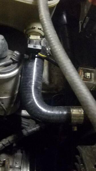

It's always been ok with the old hose, as there is a vent on the radiator above the top hose inlet, and also the inlet manifold, teeing into the header tank. The new hose is maybe a little higher, but filled easily last night.
I've done around 80 miles today in it, and they do work! It's a very hard plastic, so not your typical heat shrink tubing.
I didn’t know about that sort of heatshrink. Could you tell us what it is please,  I would like to have a read of the data sheet?
I can think of several occasions such a product could have saved the day, not all cooling system problems either!
I assume there is a joiner / sleeve inside the pipe so the heat shrink is just a jubilee clip in effect ?
One minor advantage over a jubilee clip or similar, is that the band can be positioned over the bead on the joiner, giving a more secure seal.
https://www.floteconline.com/categories/powergrip-sb

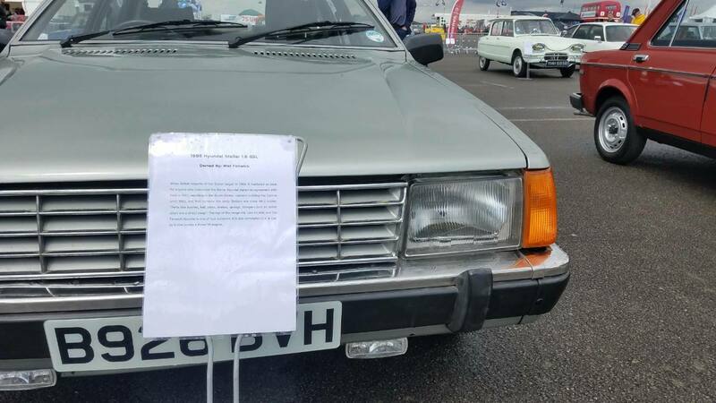

It was then onto Silverstone Classis where I was part of the Telegraph's 100 rarest cars stand (bribed with a free entry ticket...) When I got to the gate I was almost turned away "That's not enough, you need a wristband or QR code to get in." Only to have a complete change of tone "Oh, complementary tickets, I do apologise sir!"
I got back in the car to shelter from the worst of the rain, and had a reminder that I do need to increase the temperature of the evaporator, as all the ice which forms on the outside of the casing does melt at some point!
All in all a very enjoyable weekend, although if I'd had a quid for each time I'd been told "Did you know these were based on the Cortina?" I'd have covered my fuel costs for the whole trip.

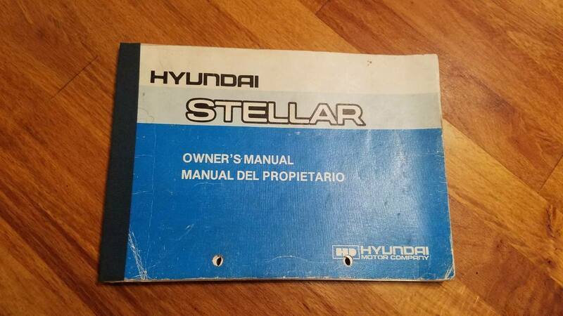

In the meantime I'm going to try repairing a far less important item (and hence a more appealing task!)
36 years of use have taken their toll! You can see that the previous owner has obviously decided to put it in a ring binder after it disintegrated, then presumably realised that punching holes along the bottom made it rather difficult to read! I should imagine that trying to find another, for the pre-facelift versions made for only 2 years, might be tricky.
First stage was to straighten it out, and clamp the pages together.
I've bought some book-binding adhesive although normal PVA can be used. I suspect it's just watered-down PVA anyway, to help penetrate the pages edges, but it was hardly expensive.
Then I dribbled it onto the spine, and from now on it's just a case of adding a thin layer once dry, and repeat.
The first layer seemed to soak in very well (hopefully not all over the pages!) so need to build up a thicker layer for strength.
One of those plastic almost-a-triangle binder grips would be a good back-up. (Or just faster)
That's my plan B, although depending on how far in from the spine it extends, it may obscure some of the text. (Not that I have to refer to the manual often, I think I've figured out how the car works after 24 years!)
On 8/5/2021 at 1:04 AM, wuvvum said:
That must be up there with "Did you know Princess Anne had one of those?"
I wonder if someone has ever said that to her "Security, it's another one" as her close protection officer drags person away.
After several coats, I've built up a decent layer of glue.
Then to protect it further and neaten it up, I covered the spine in self-adhesive  tape. It's supposed to be suitable for long-term book repair, so hopefully shouldn't ooze stickiness after the first hot day in the car!
A shame about the punched holes, but short of scanning and reprinting (no!) I can't see a solution. Loads better though :-)
And no sign of glue running onto the pages either. It seems strange that the edge bond could hold the paper strongly enough to use, but it seems to be holding fine!

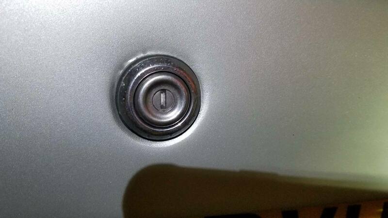

This is now on its 3rd ignition switch in my ownership, so it would seem like they are a bit of a weak point. What seems to happen is that the plastic breaks up and no longer holds the contacts together. At least they are  very easy to change, just a single screw and it pulls off from the back of the steering lock.
I'm down to one working spare of unknown age, so I was quite happy to find a seller on eBay who accepted my cheeky offer for a BNIB part. Even better, there was a Black Friday deal on which gave another 20% off!
I do like receiving genuine parts :-)
The best bit was that it wasn't just the switch, but a complete lock set too, even down to the glove box lock!
Shiny new keys, moulded with the HD logo (the curved part of the D can break off after heavy use).
I probably won't swap the locks at this stage, just if I have a problem. The only lock which is showing its age is the boot lock, which is chrome-plated rather than stainless and has pitted slightly.
At some point in the future it'll need painting again, so makes sense to fit all new locks then.

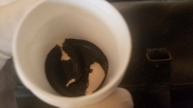

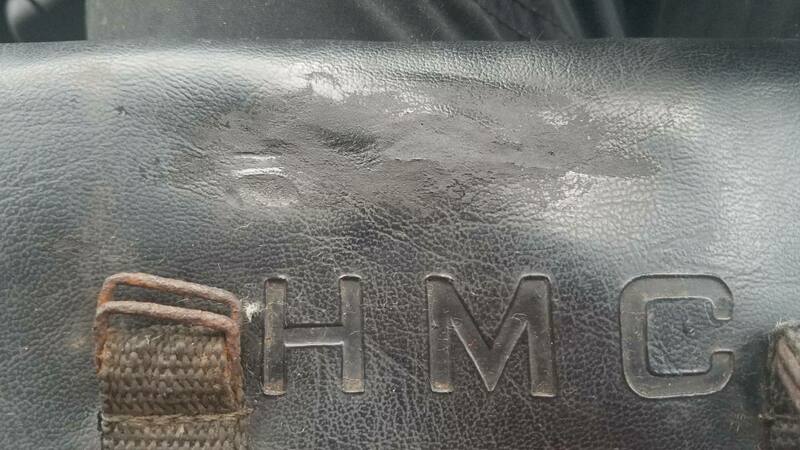

Part 2 of the 'avoiding laying on a cold floor and taking the gearbox out' was to see if I could repair the original tool kit bag, using a motorcycle seat repair kit I've had on the shelf for quite some time!
The tear in the vinyl I strengthened by gluing on a piece of fabric on the rear.
Then I mixed the 'filler' material with a dye, possibly mixing up slightly too much!
It dries to a rubbery texture, and seems to adhere well enough to the fabric and edges of the tear
And here's what goes into it, although not sure if anything has gone missing over the years.
