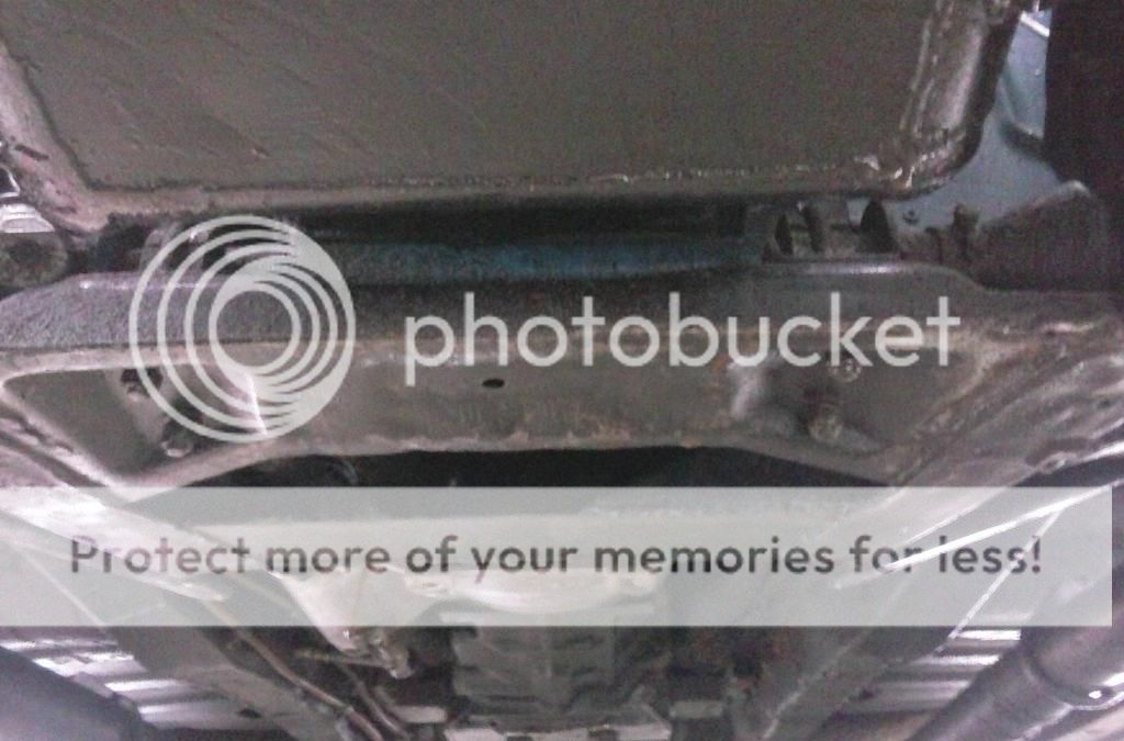

Live action dead beam axle fettling today! we went out the excellent wife, baby and i to a stereotypicaly bleak car boot sale and i noted from my back seat position slighly odd feel from the trailing arms over the badly kept access trails to the field as if the rear dampers had become devoid of oil and the bushes had become well past the best before trifles .
a quick investigation showed major fail and a slow bump avoidance drive back .
jacked and ready:
So today is brake lines disconnect,exhaust off, dampers off and mounts,weld,,then reverse of former ,,motivation is weak haha
Normally id be all over thus but food is needed thus this is a situation of choice between wasting time eating,,or wasting time messing about with the last working car out of 5 or so vehiculars
wishing you were here update: axle is off and the only casualties are one snapped exhaust hanging bolt and a handbrake cable circlip also denting the sense of achievement, nothing fought back with much gusto so i overcompensated with the preemptive muscle tensing only for it to undo straightaway

i'd have binned the axle and purchased another but for the NLA nature of it in the dealer and also second hand items being equal
it shouldnt be so dire, the weld is plenty strong and it is afterall a pressed steel fabrication to begin with :)

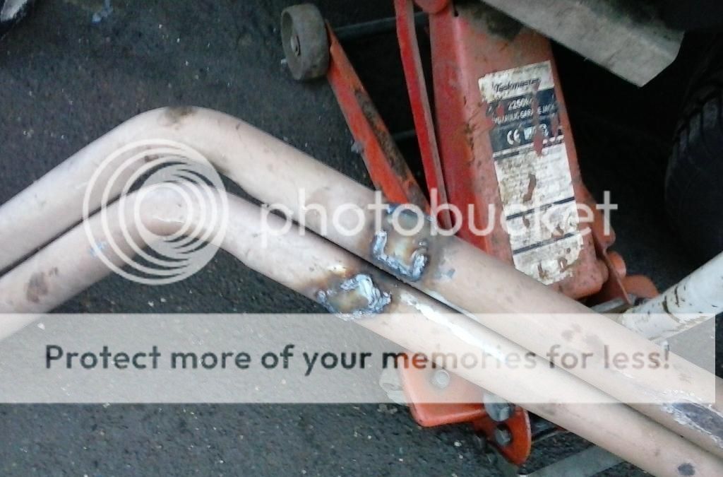

Job complete !  no variable negative camber anymore
i finished the weld up on both sides with a pair of 3mm fish shaped plates to synch up the weld pattern and provide a second brace so to speak.
Also the exhaust hanger bolt had snapped so a quick drill out and tap sorted that, i hate wobbly exhausts haha

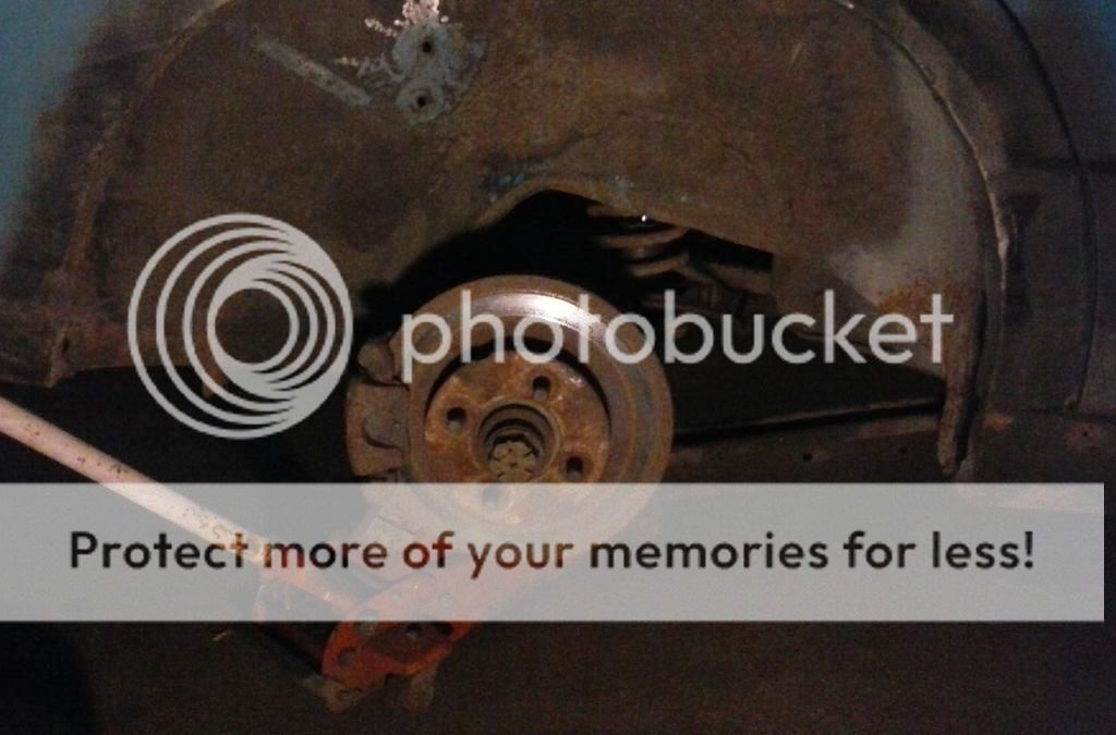

so common rot areas for these protobishis is the rear axle, lower rear quarters, front wings behind the flaps, the front bumper, rear sills and the inner rear wheel tubs go behind the dampers
based on the list Ive done the rear sills,,and axle so naturally the front wings came next..

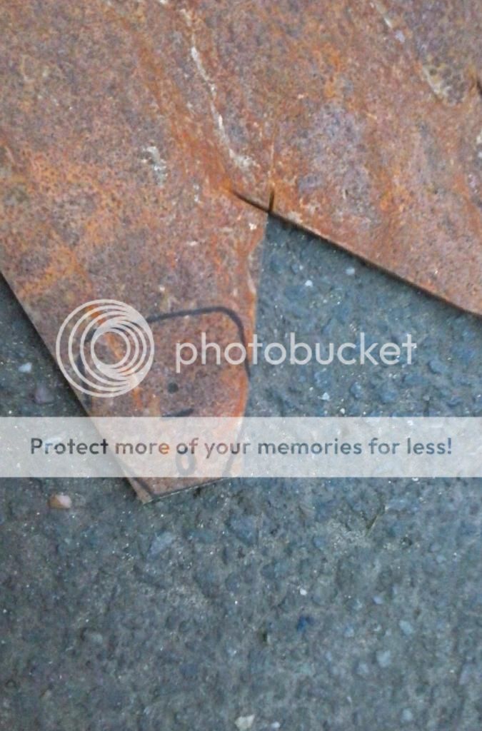

jack it up ,,grind the rot out
then cut out a patch for the hole and flap mounts and shape it with a house brick and some skirting board, weld in place and grit wheel it smooth
mask up ,key the surface with a toenail buffer and some 'davids' zinc primer goes on
Top coat applied which is basically some ford colour that I compared with the car tactically parked in the line of sight from the paints area
and the flap bolts greased up and popped in
flaps on but my method is to space them off the wings so the metal has a chance of drying out
Done, NS to do next but its much less rotted thankfully

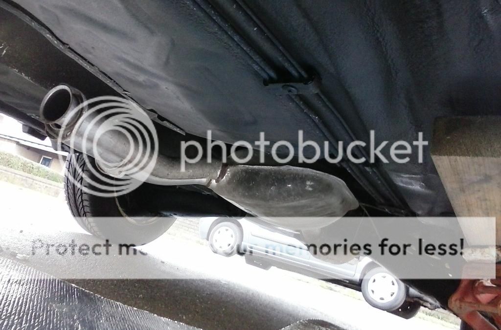

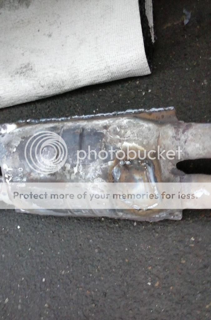

The other day the tail pipe came off at the back box joint which made the car sound abit like an MGB , of which was ok but it was a little loud and also a certain points of the rev range it sounded so gash that it couldn't carry on like that too long.
To solve this I welded a repair patch to the rotten tail pipe at a slight angle to have it go straight out and bend towards the OS rather than upwards and point downwards as stock and also cut away the perforated section for a little less backpressure as I think the insides of the box are well and truly kippered.
Also whilst the tail pipe was in easy access I hammered the end into a roll tip as it took no time and I like them!
As the exhaust only really has a month or 2 left before it gets the 1.8 fitted I turned the welder up and welded over rust in situ to attach it, ,sounds even quieter now than standard oddly but has a little hint of rasp to reward nearing the linear rossa.

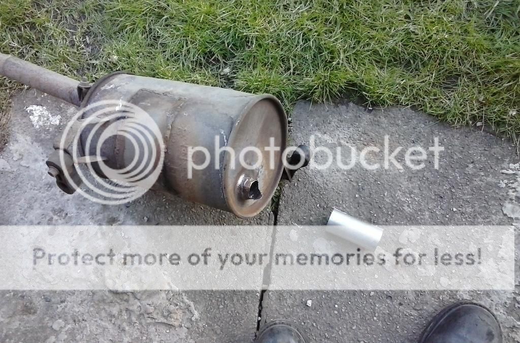

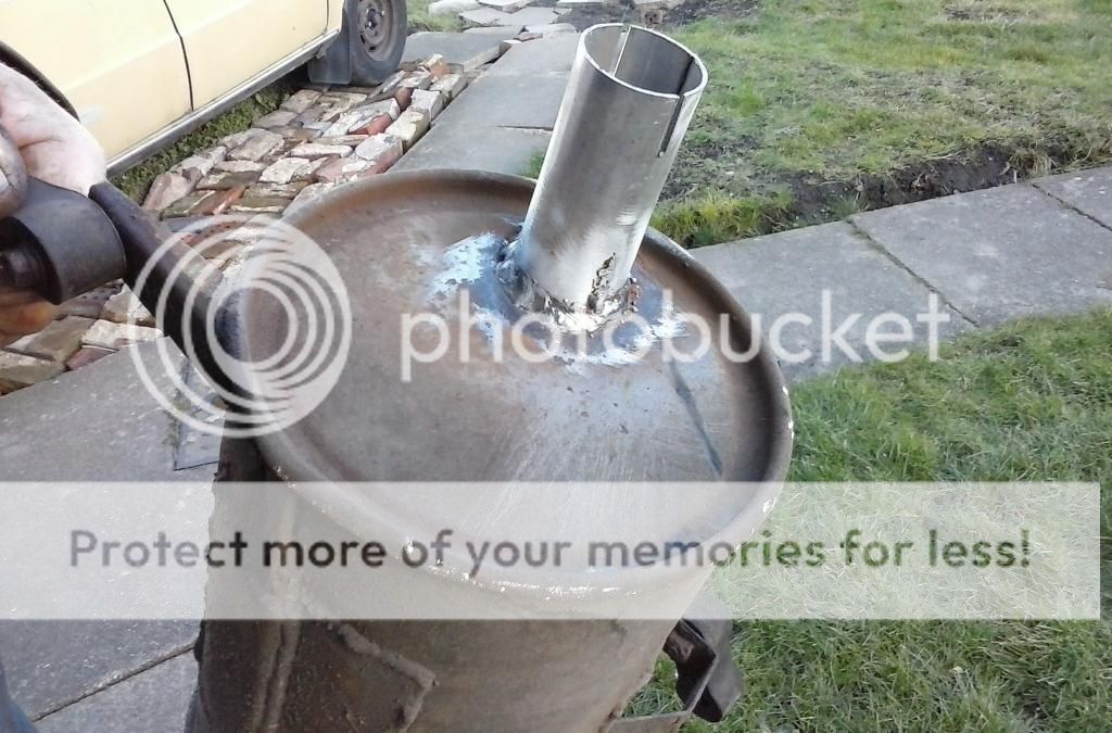

car, an unexpected fault punctured my dreamlike view of the world in the form of the backbox breaking off at the inlet to it and
subsequently being dragged along the road advertising to all and sundry that the car was an actual J plate, the noise the car made frankly was embarrassing to the point of driving with beige paper carrier bags over the heads to prevent identification of the apparent noise criminal.
my father removed the back box in a sort of "thanks for the help
but please at least don't break the fixings way" and I procured a slide on 1.5" sleeve to weld onto the back box
I actually bothered to clean back to steel for this repair

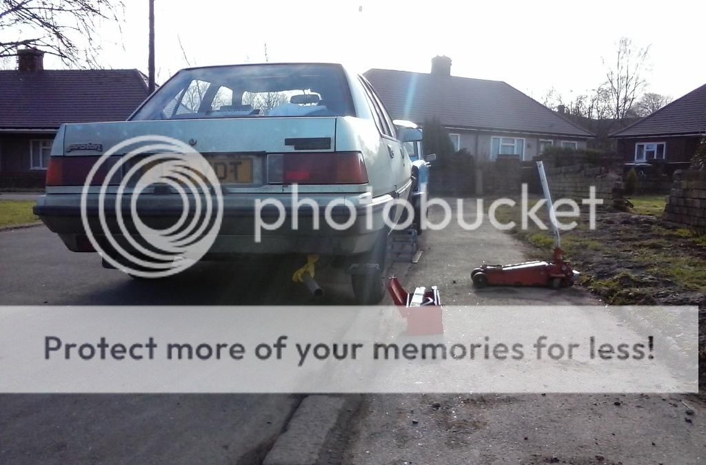

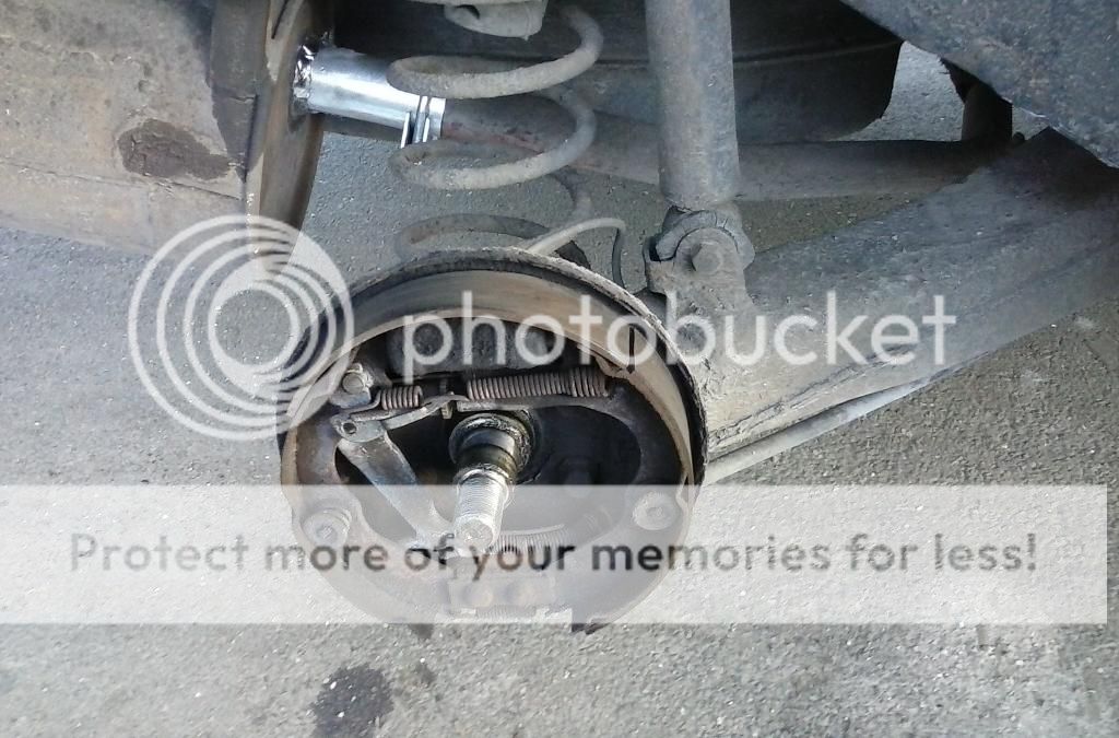

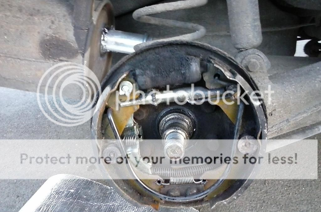

whilst on with the exhaust I decided to see why the handbrake suddenly became completely inoperative,,yet felt the same and still worked on the footbrake, bizzarely I initially felt nothing was wrong as it had plenty of meat on the shoes!
This I have temporarily resolved with some shoes off a spare axle and now they've bedded in the handbrake is reasonably equal side to side although I will swap for new everything (cylinders/shoes/springs etc)

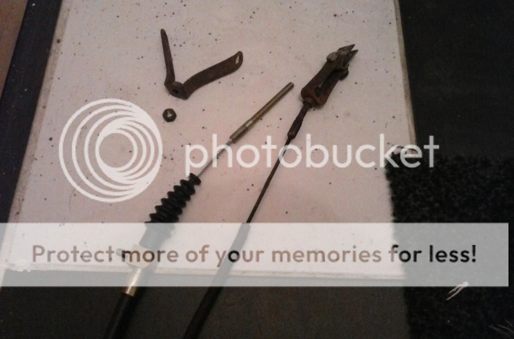

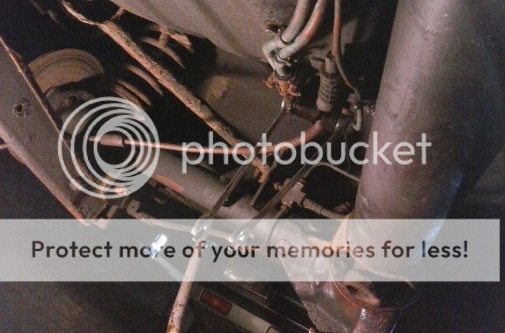

first up mot wise the handbrake was terrible due to the cables being partially seized and not allowing the caliper lever to properly return either for the self adjust mechanism
I sprayed the cable with loads of wd40 and applied heat but it was to no avail as it recorded basically zero brake force
so I got a new cable off ebay and fitted that up with a view to not bodging the original cable like I did before, why would I reuse a knackered cable rather than buy a £3 one madness!

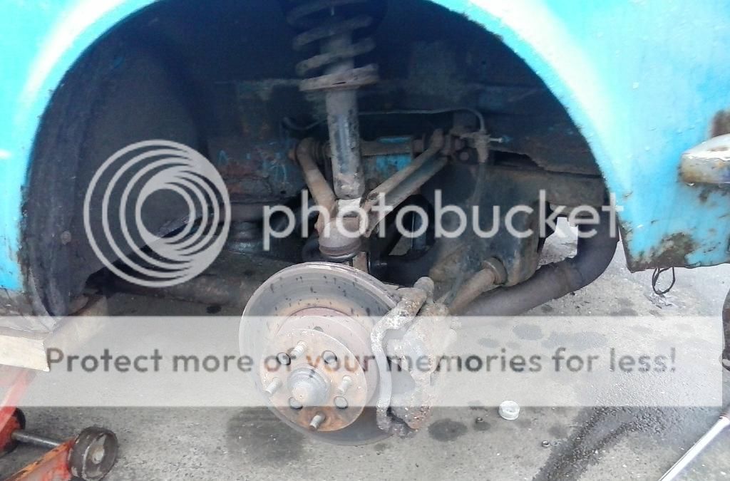

it wasn't enough however as the steering coupling had too much

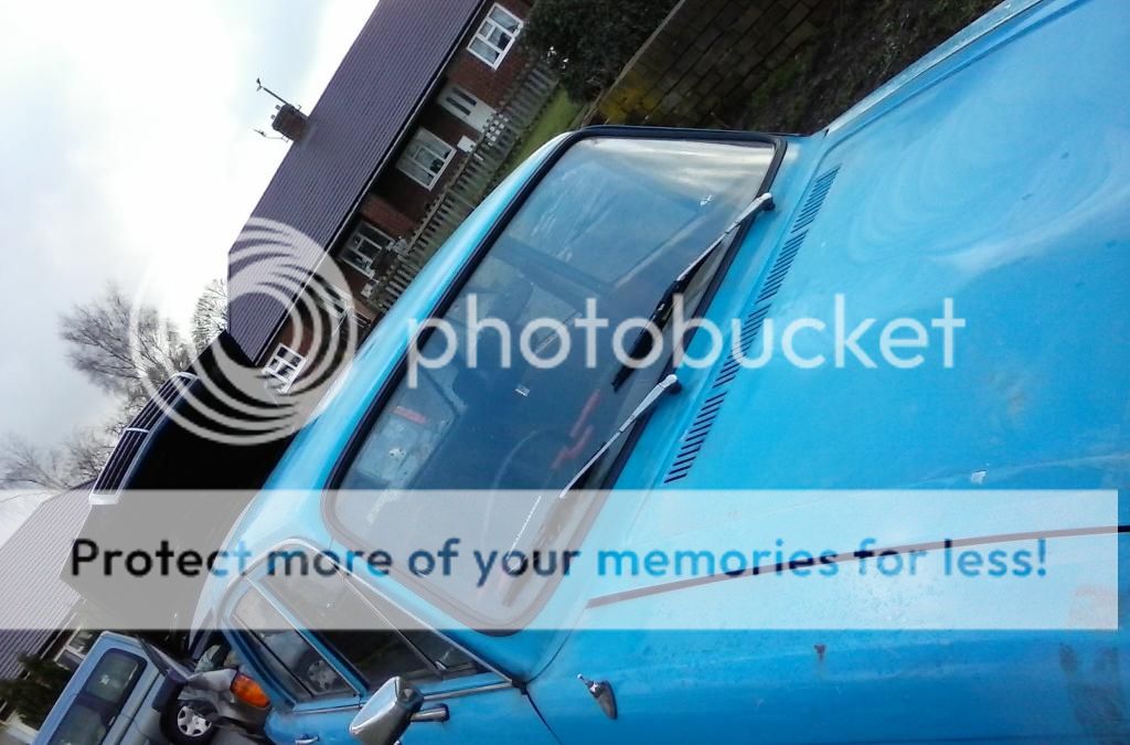

play, a lower balljoint was also absolutely wrecked inexplicably, the handbrake was good enough (before a new cable) and a wiper
wasn't clearing the screen effectively

got underneath and it was a miserable job due to the cold and how quickly steel absorbs hand heat
new cable/ old cable ,,and another to donate 1/4unf nuts rather
than dieing an m6 thread down it and chopping it up

I tried to fit a scimitar UJ inplace of the daft O ring damped rag joint but it was a tiny bit bigger and clashed with the starter motor and inner wing,,and the subframe etc
the steering rack needed loosening off its mounts and loads of contortional double jointed carry on to tighten up the pinch bolts
New balljoint popped on and come the day for the retest it wouldn't start because I had the bonnet open in the drizzle and as such I had to wip dry every lead!

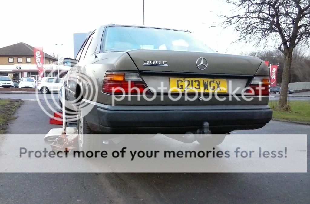

Today I was in a good get jobs done mode, but rather than do building work I simply fixed another exhaust and also also adapted a speedometer cable correctly to the triumph, it runs an H suffix lt77 out of a LDV200 and has a sprint speedo which by sheer random chance reads exactly correctly when compared to the satnav which was a right bonus to not have to send it away
my dad has had this 300e for the last 4 years ,I bought it then he adopted it somehow!

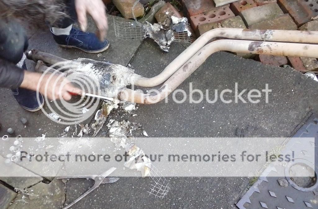

its been as reliable as a clay mug but inevitably the exhaust started to blow a while back , we investigated the price of a mid section and it was either unavailable or £200+ so we did a proton on it today, ripped of the crappy old bodges and got the welder out
obligatory jacking up
we antagonised the joints and bolts until they relinquished their hold upon the haggard centre section and chipped the guff off the box
I whipped out the sparkler and struggled tbh as although there wasn't any wind to speak of the air mass was flowing slowly and consistently just fast enough to blow away the shield
the gearbox exhaust mount had nearly worn through the down pipes but as the steel is so thick I just popped on some wear plates
we replaced the rear section as it was cheap as chips from Poland ! and literally zero rust on any of the w124 grot spots which was satisfyingly excellent news as I cant be bothered with needless welding ,,, G plate steel  FTW
if ever we look to sell it ie never,,,a poetically perfect sale picture just in case
anyhow a test drive revealed zero leaks and with its fresh tyres it literally has nothing to invade the serenity of the drive experience, auto box shifting like a vario ,,engine turbine smooth and despite the 240k miles it still picks up in a 188bhp style

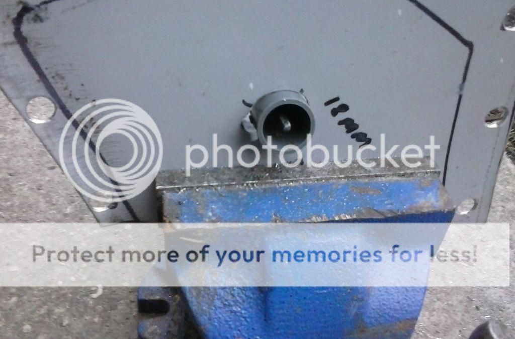

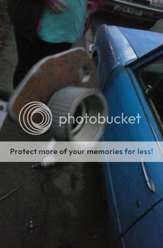

The speedo hasn't worked for ages,,,that is pathetic! I bought a 4quid dolomite 1500 cable which is at least the right length but doesn't fit either end without adapter parts
first job as it is impossible to fit from underneath was to make an access hole
then I made a cover plate to seal it back up after
hole for the cable,, I got that wrong though somehow and will remake the plate later for a straighter path

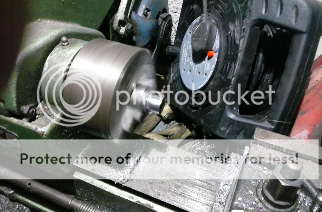

I went all engineer on it and drew a technical drawrin
then made it on the spinning bobbin from an old wheel nut
I had to make another claw clamp as this time I'm not modifying the cable to make replacement easier
I fitted the cover plate with grommet and everything to seal up the trans tunnel cover and simply jubilee clipped the cable end onto the back of the speedo
and now I have an accurate speedo, which confirms that when asked it really deploys 230lb/ft with positive effect!
