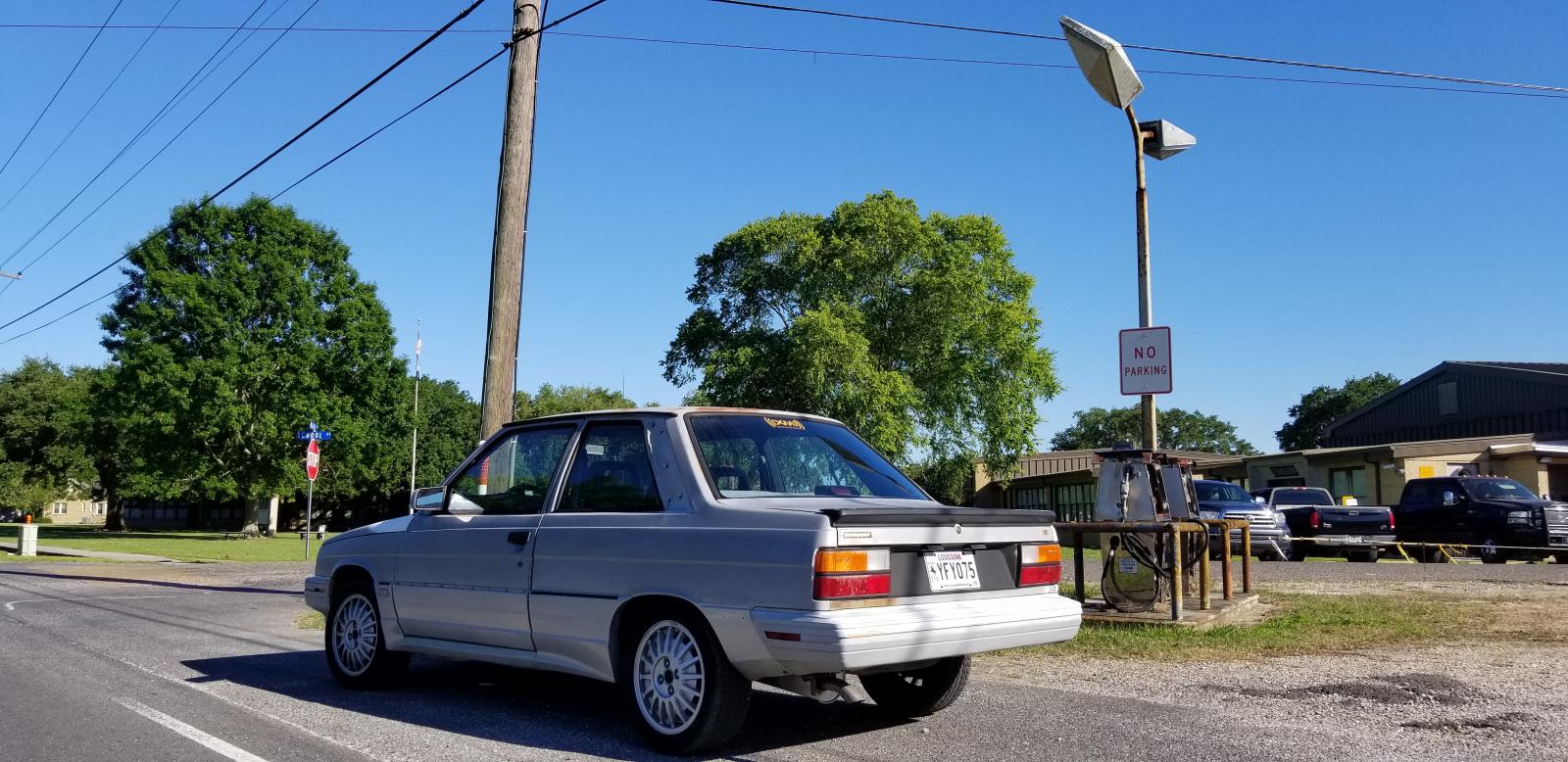

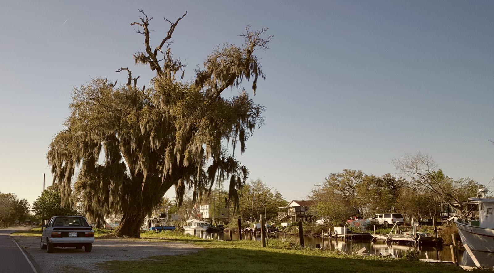

It was a nice day yesterday so I went out for a drive, that's at Pointe Aux Chenes, big old oak tree on the bayouside.
Figured that was better than complaining about the car. It needed a bit of a run, seems to have done it good. I think the last tank of fuel disagreed with it somewhat.
Phil

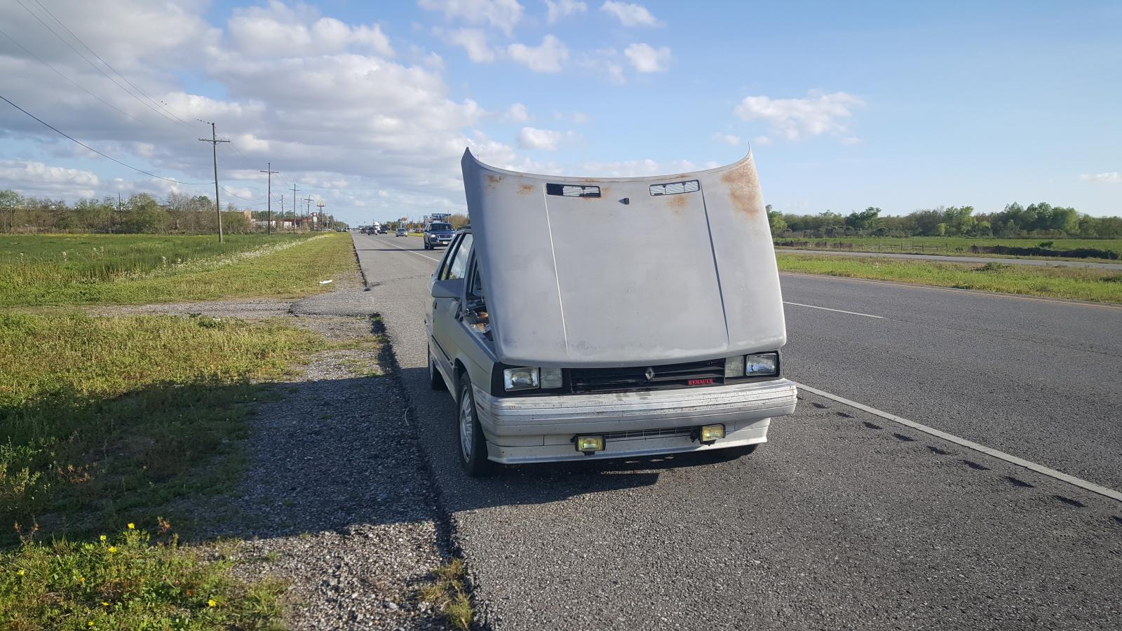

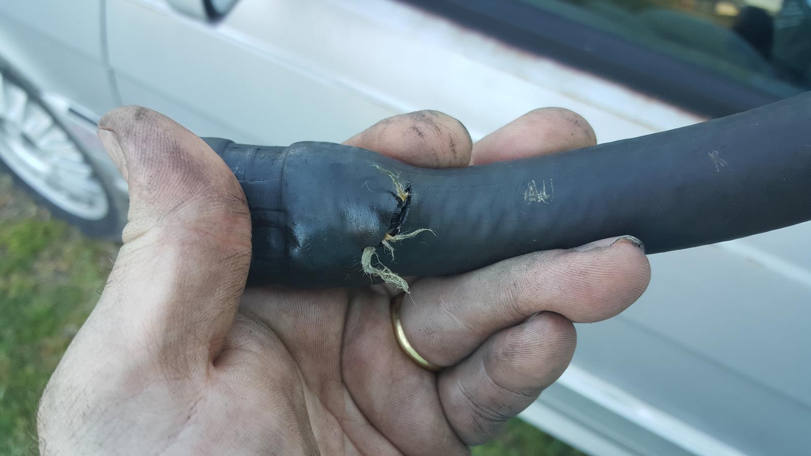

Well, had the first FTP in a while yesterday. Driving along, I stopped to pick up the photographs I had developed. Had taken one of the car.. the camera has a small light leak so the pictures came out very 1985:
Got going again, was accelerating quite hard out onto the highway. Got to about 50 and all of a sudden there's a large cloud behind me- first worry was that it was smoke. Slowed down, there's the whiff of glycol through the vents and clouds start appearing from the sides of the hood.
Let it all clear, it was apparent the leak was at the back of the engine- right by the exhaust manifold so hence the large volume of steam.
One of the ER doctors my wife works with stopped to ask if I needed anything, declined because at that point I hadn't gotten to exactly what the problem was. I wasn't going to abandon the vehicle on the side of the road.
Identified the problem, the bypass hose from the inlet manifold to the thermostat housing had split open.
Started to walk, the auto parts store only a couple miles down the street and it was a nice day. Someone I know recognised the car, turned around and kindly gave me a ride there AND back. Fitted the hose, clamped it down tight on one end and stretched it over the other (stupid design where one end is bigger than the other), filled it up with antifreeze and got going.
It got me home, was repaired by the roadside and was only broken for the time it took for the engine to cool down. I'm glad the hose failed where it did, and quite abruptly because it generated the big cloud of steam as a warning and I was able to stop and switch off before the engine even got hot. It lost about a gallon of coolant in total, which isn't bad really. No concern of the usual F series cracked head from an overheat. Win.
The pipe bodge will probably last but I'm going to go to a different store and try find a suitable replacement that has a different size end on each end of the pipe to fit a little better.
Phil

Could you use a copper joint (different dia each shoulder), for stepping heating pipes... +2 hoses ??

Could you use a copper joint (different dia each shoulder), for stepping heating pipes... +2 hoses ??TS
Did think about that but the current fix appears to be watertight.
My concern is 5 years down the line that the pipe splits because it's been massaged gently over the larger of the two metal spigots.
Phil

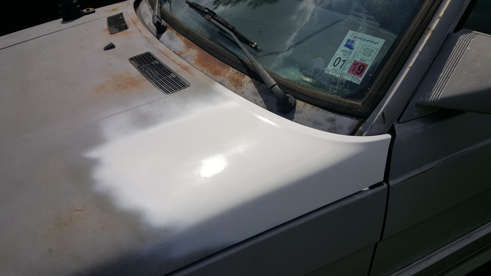

I decided to scrape back some of the old paint on the hood to see how bad it is. It's not nice. It needs to be bare metalled and redone from scratch.
However, a rapid blow-over shows just how badly Krylon goes on...post-5454-0-22624400-1489951216_thumb.jpg
Unimpressed. Going to stick with Dupli-color, I think. On the bright side, it does have a bit of a shine to it. Better than can be said for the rest of it...
Phil

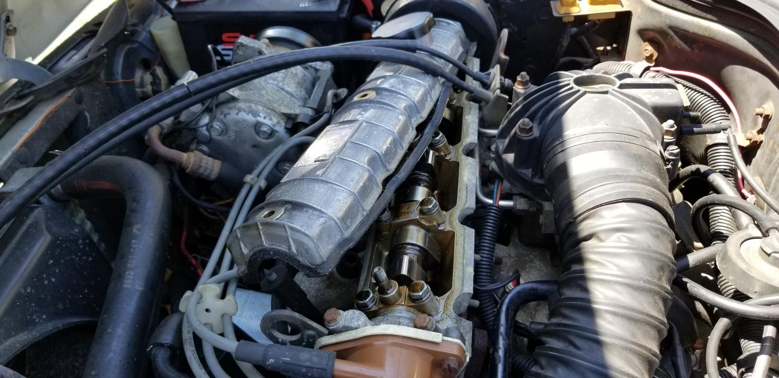

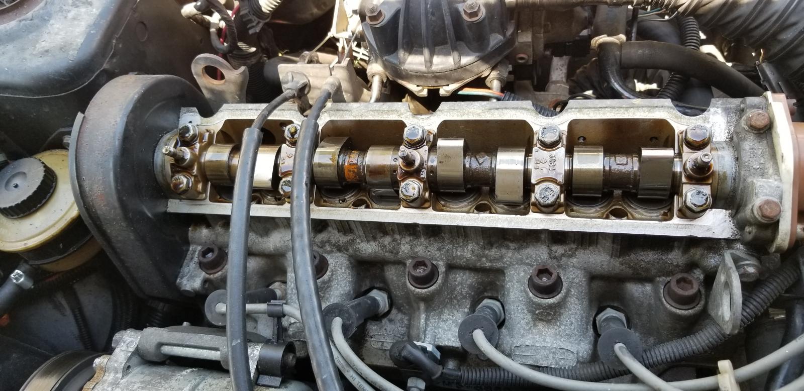

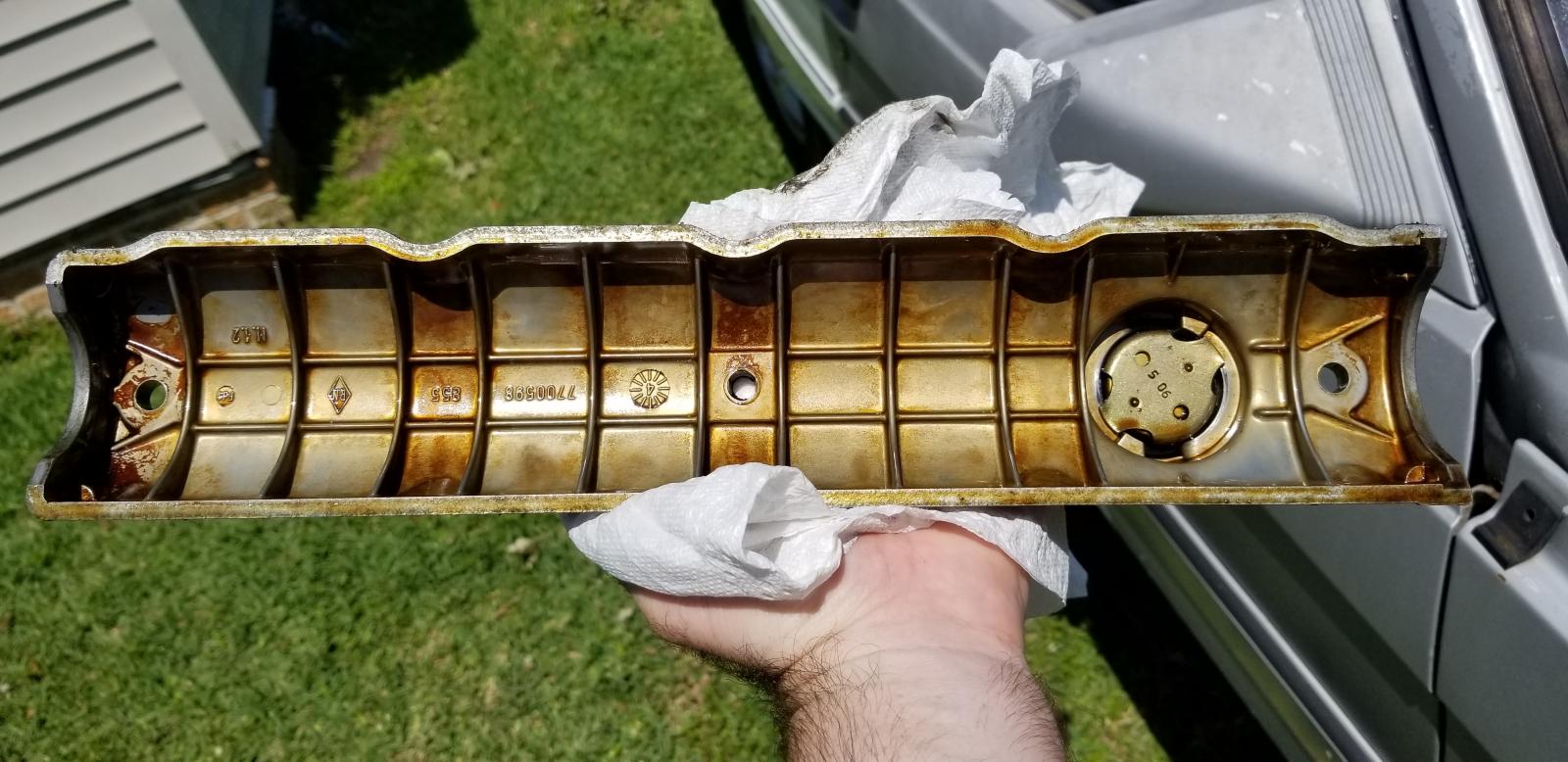

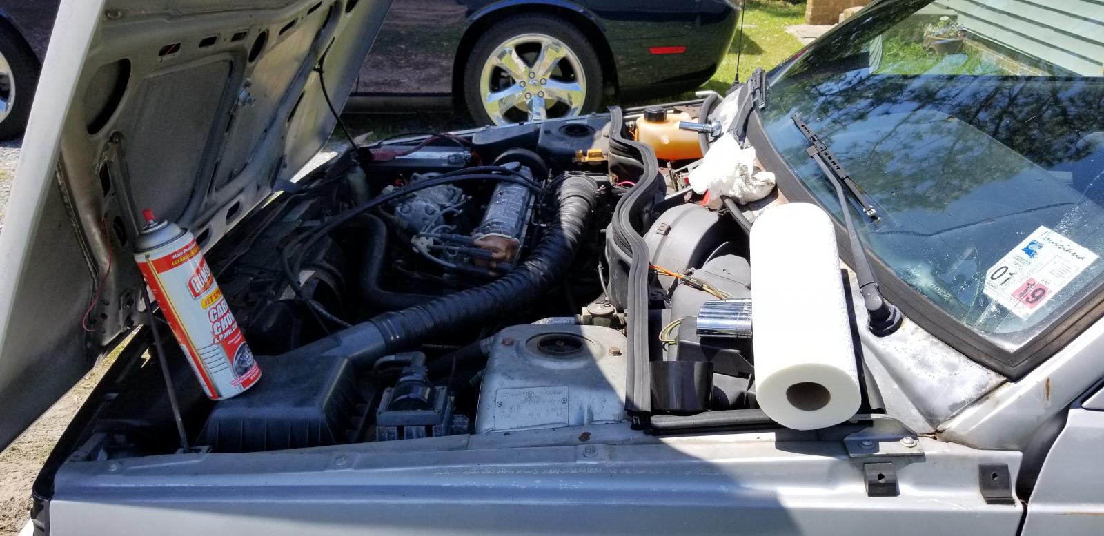

After fitting the silencer, many noises made themselves audible. Suspension creaks, various other clunks and bumps. One of the ones that concerned me was the oscillating whine coming from the engine bay at about 1700 RPM.
Popped the hood open and started up, using screwdriver-to-ear method to isolate the location of the noise. Unhappily, it came from a non easily replaceable item, the cylinder head. (Why couldn't it be an ancillary part?)

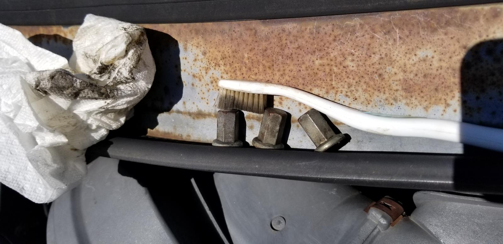

Cracked off the nuts that hold the cam cover on and cleaned them up thoroughly. It would appear they used to be chromed.
Fought with the bloody lid for five minutes because it didn't want to come off around the things attached over it.
Was pleasantly surprised at how much cleaner the inside of the engine was, you can see where the active motion of oil flung from the camshaft has cleaned up the innards. Diesel oil ftw.
Everything inside looks ok, no bad wear on the shaft, but this is the one that broke a valve and the shaft doesn't belong to the head. It's got 120k in a different engine as I had to replace the head (which didn't come with a camshaft) so there was always a possibility of it being a bit grumbly. Well, it is.

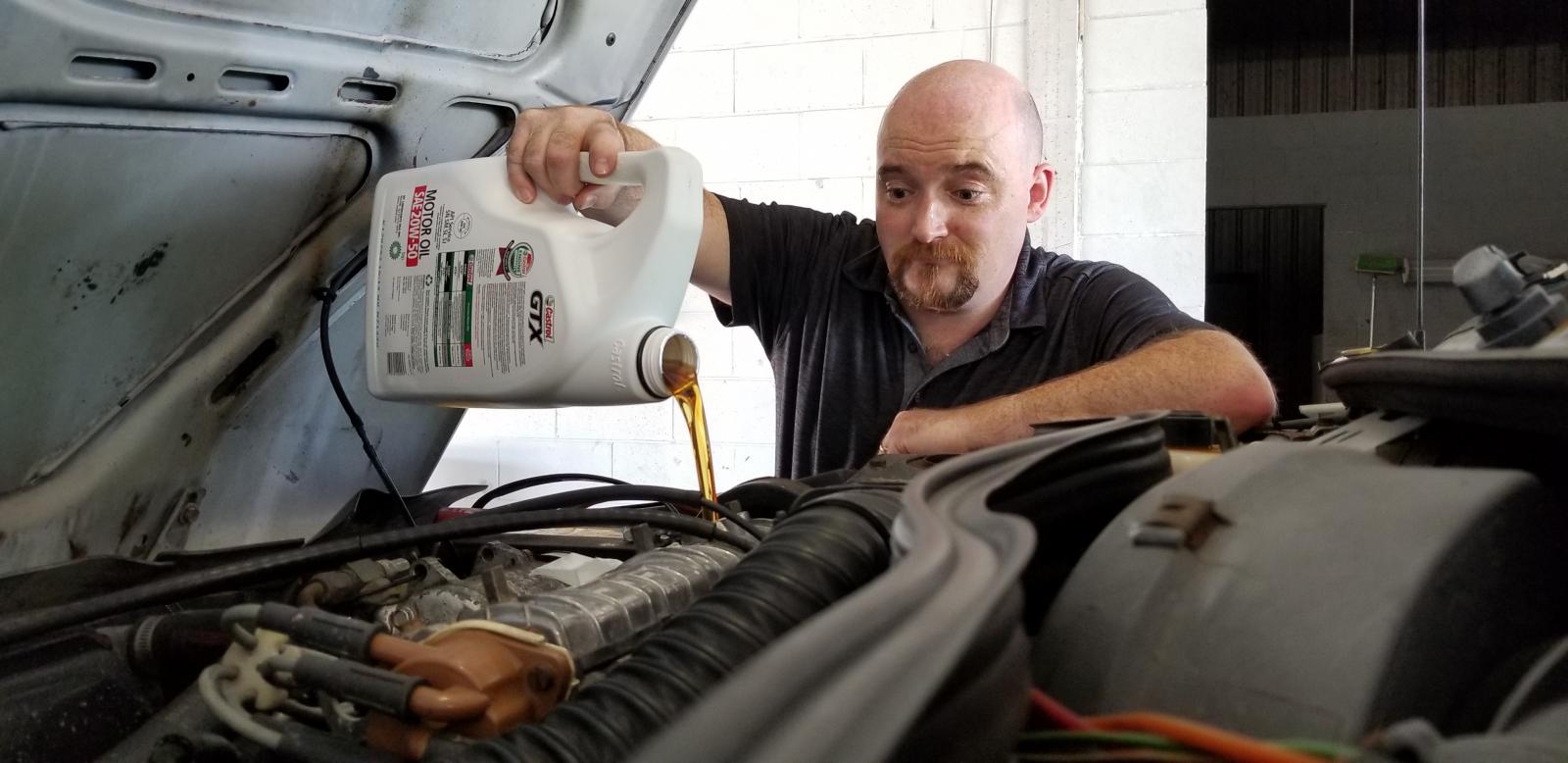

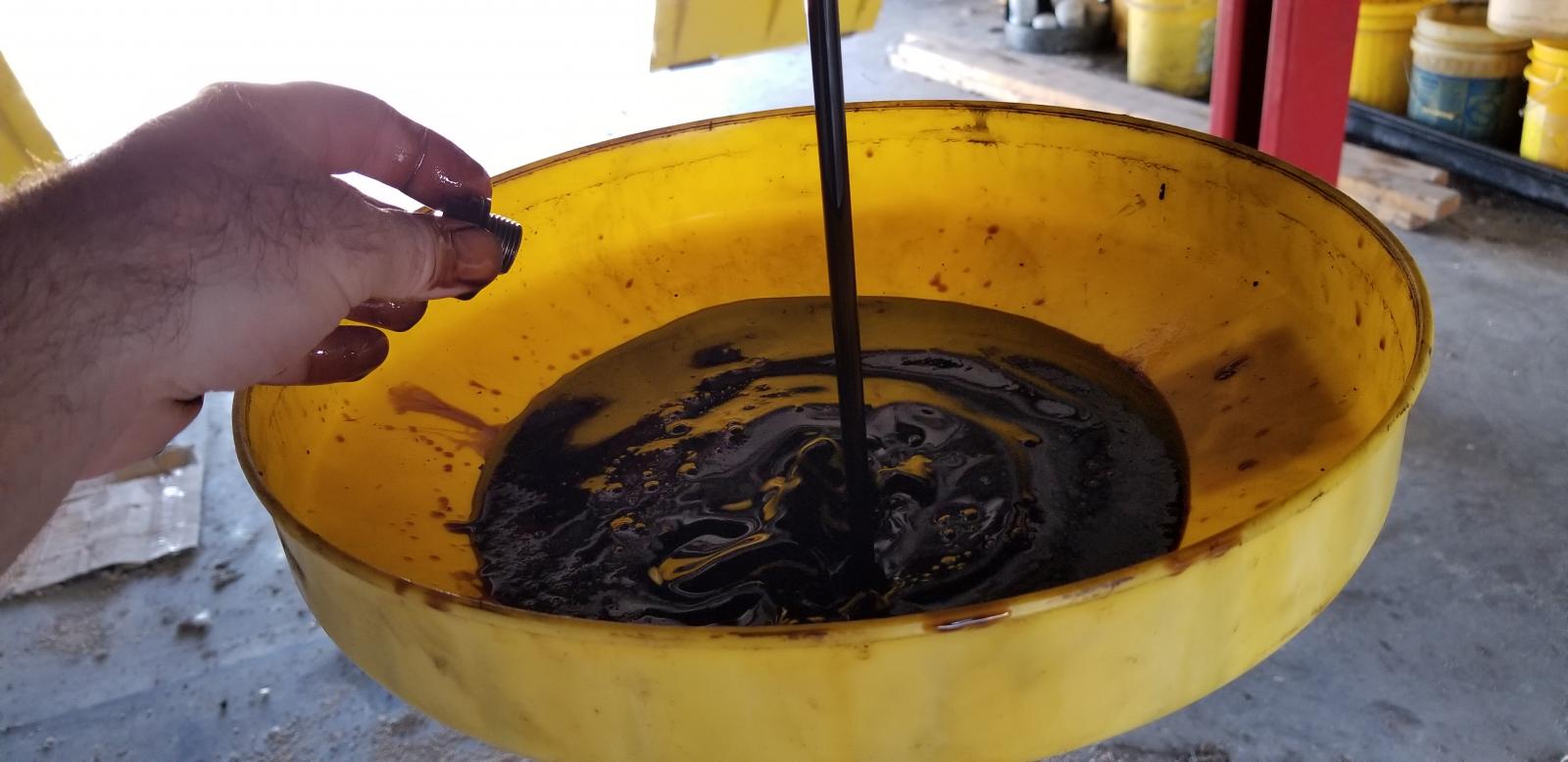

Decided to change the oil, as it had picked up all that dirt.
Phil
The only 20w/50 oil the shop had. $30. Daylight robbery! The 0w/15 fully synthetic stuff was cheaper. Oh well, had a $15 rebate card so that went to good use.
Old filter out, new one about to go in. This one was better value at $3 in a very dusty box.

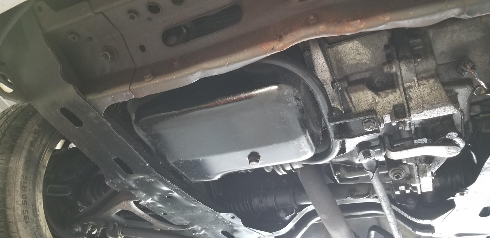

Gave it a quick wipe over underneath. Looks ok still.

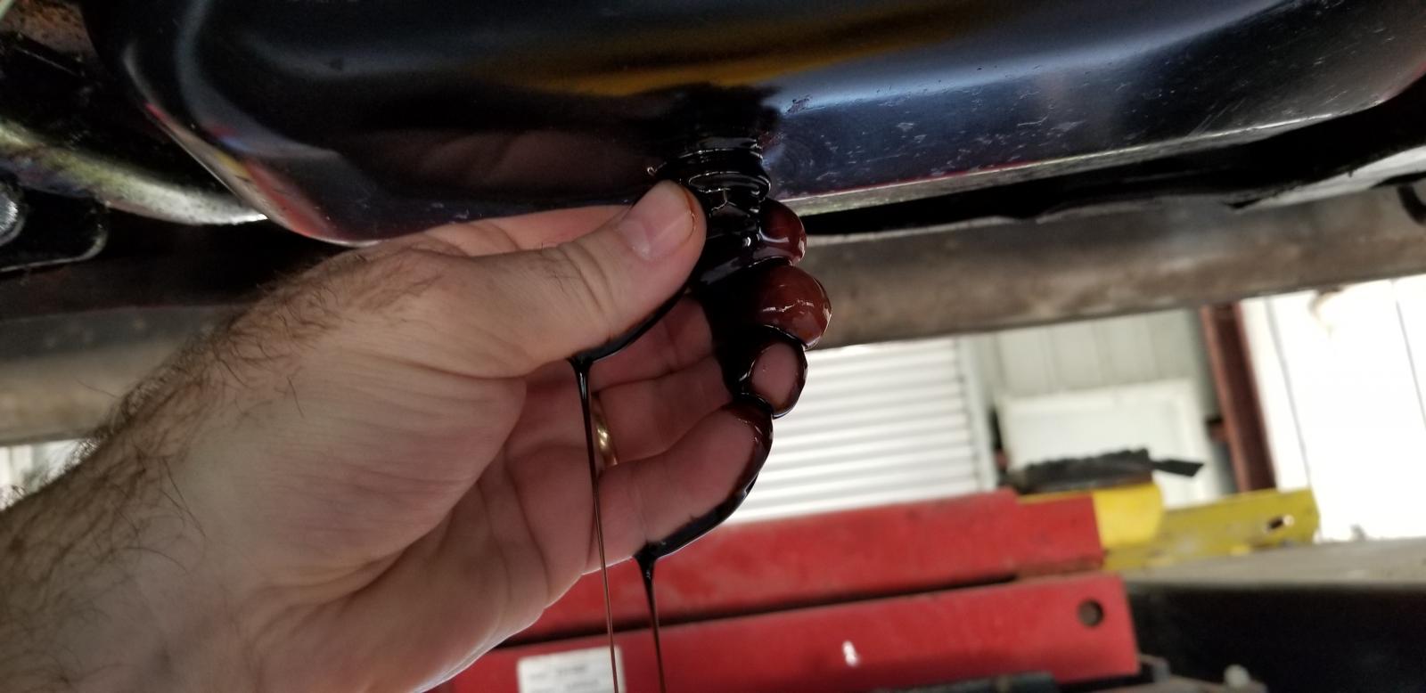

One observation made, why do sump plugs have more threads when the oil is hot and burning your fingers? Also why do they manage to hang on at a wonky angle at the last thread, not pull out and spray oil off to the side?

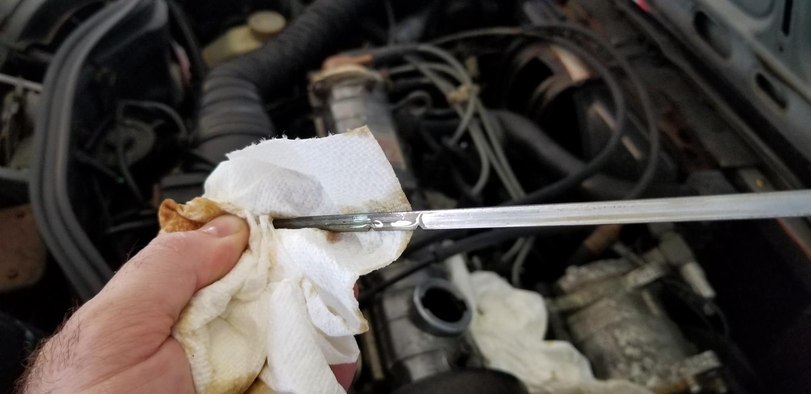

Yup, that needed changing. Thankfully though, no twinkles visible. Just dirt.
New stuff going in. Much better color. Pulled the king lead off and cranked it over until it built up pressure, then checked the level, topping up a little.
Satisfactory. Good for another 3-4000 miles now.
Phil

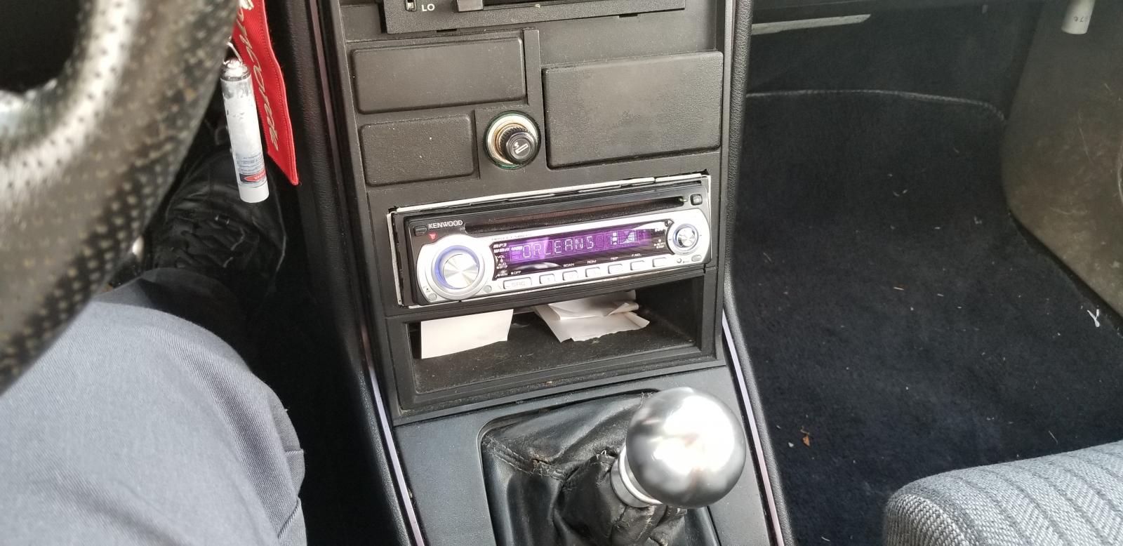

I just fixed the radio, the cage was wrong and the thing fell through into the dash. I think Kenwood still seem the correct trim bezel for it.
I can now turn the radio up and pretend the bad noises have gone away.

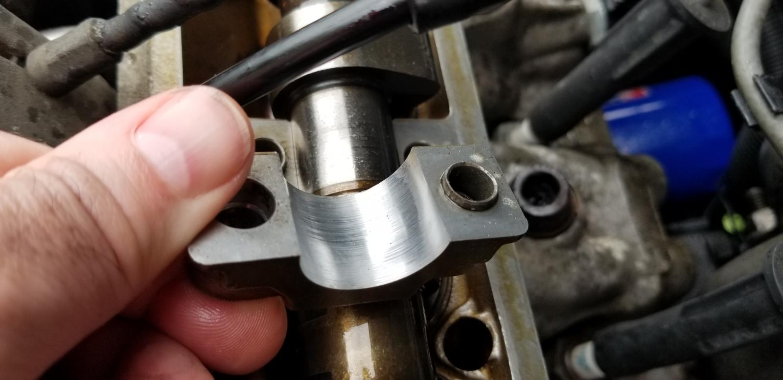

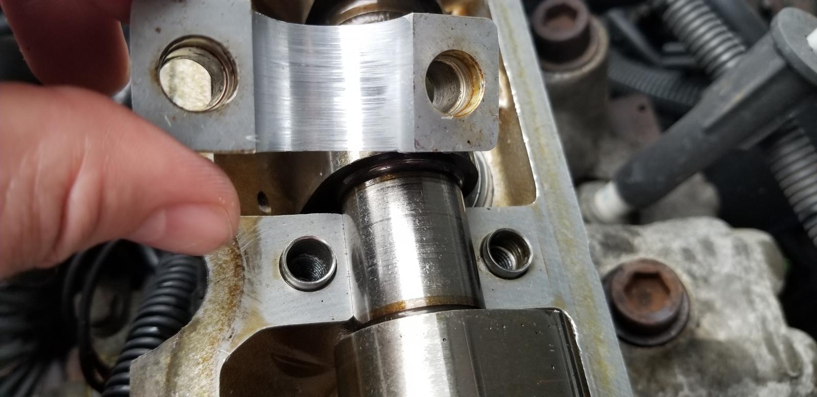

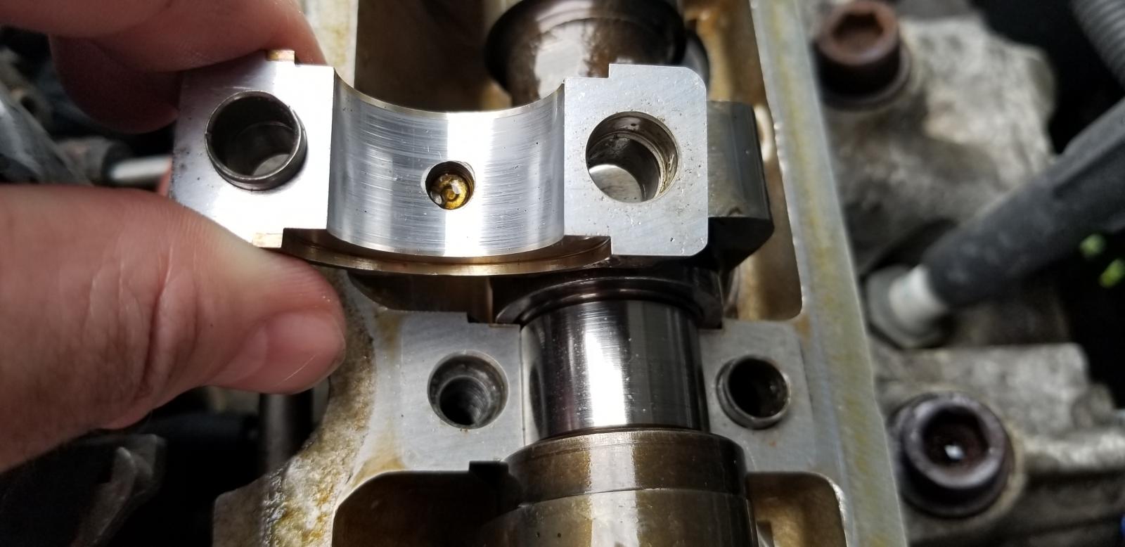

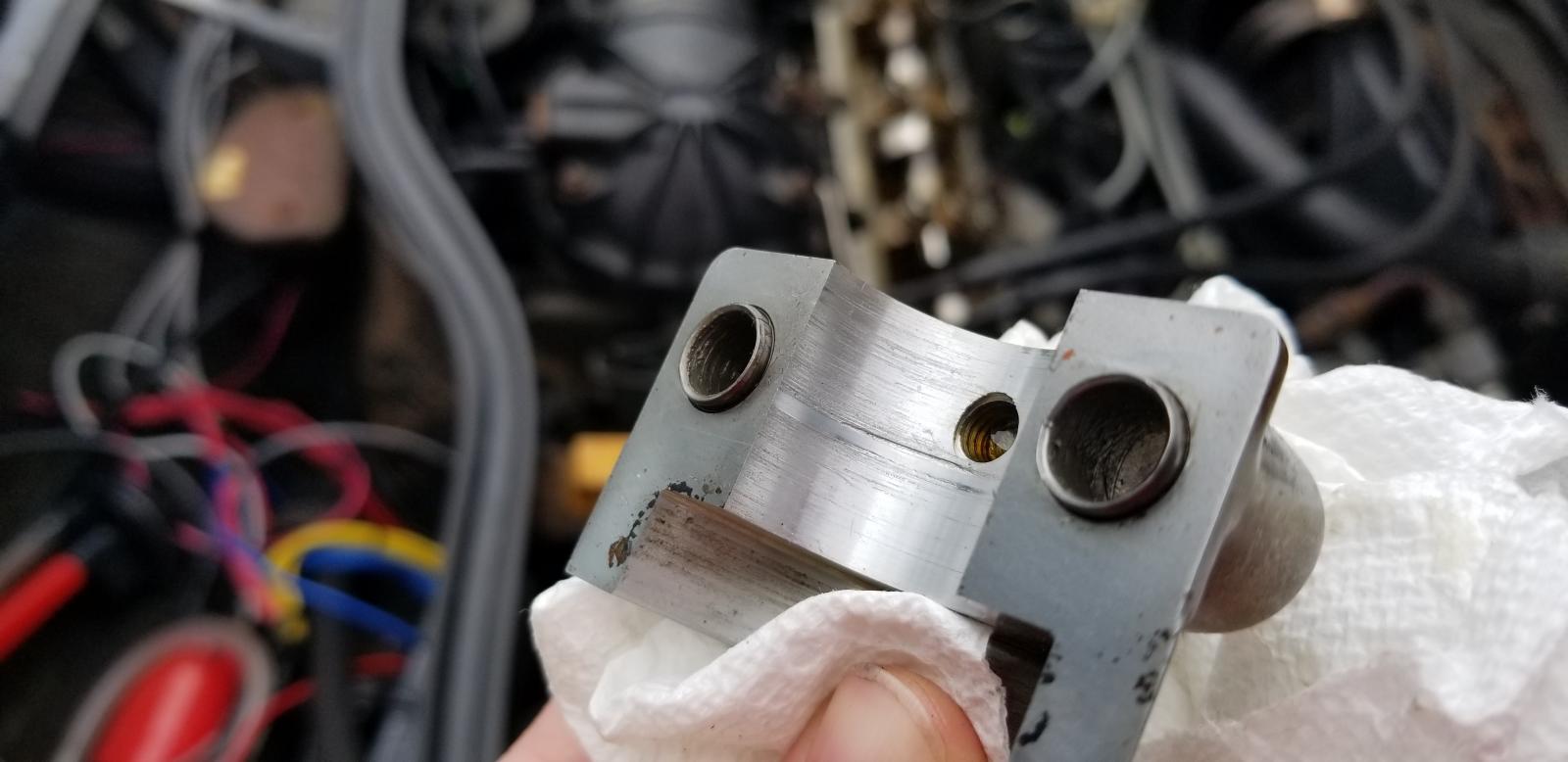

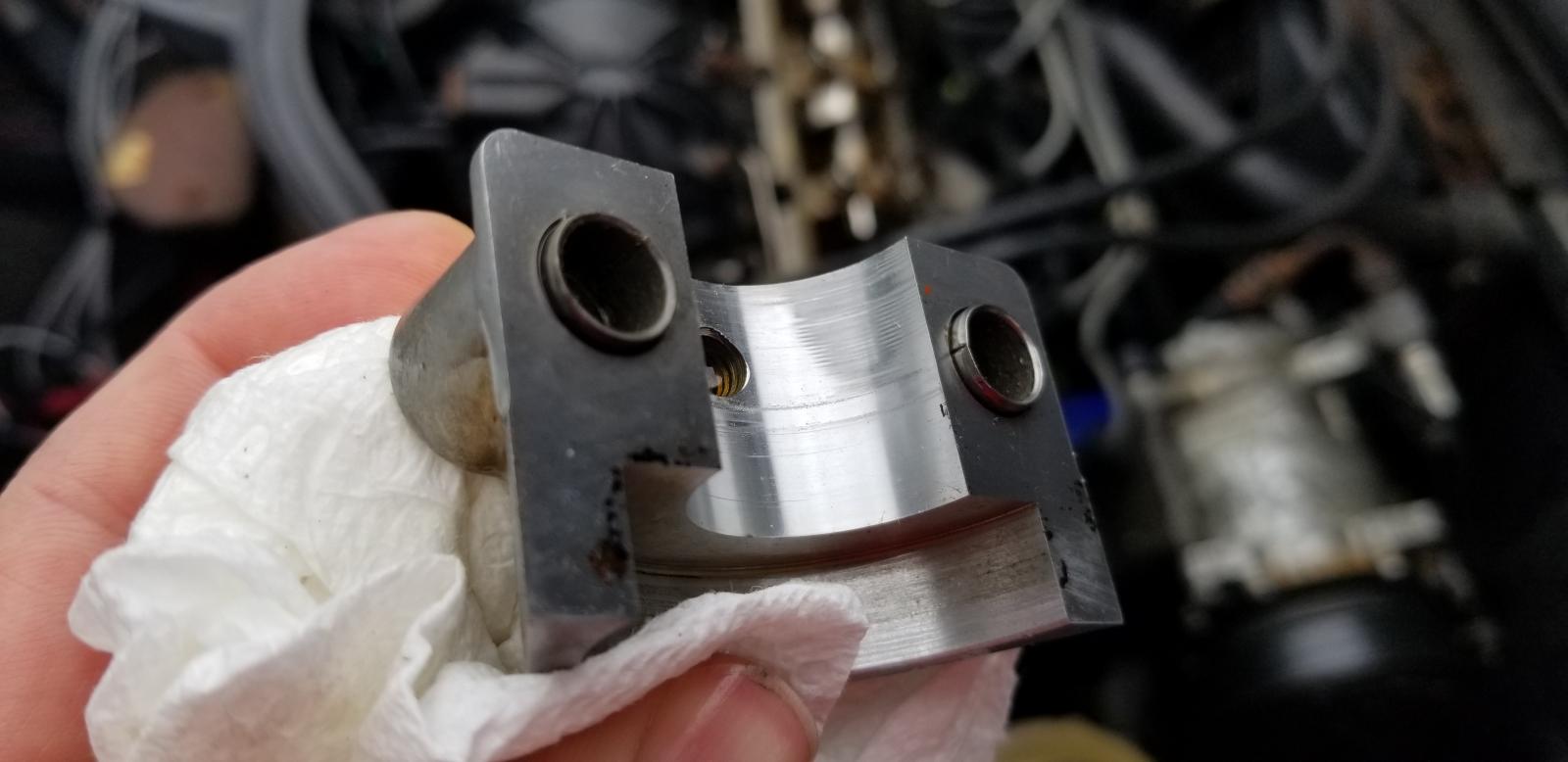

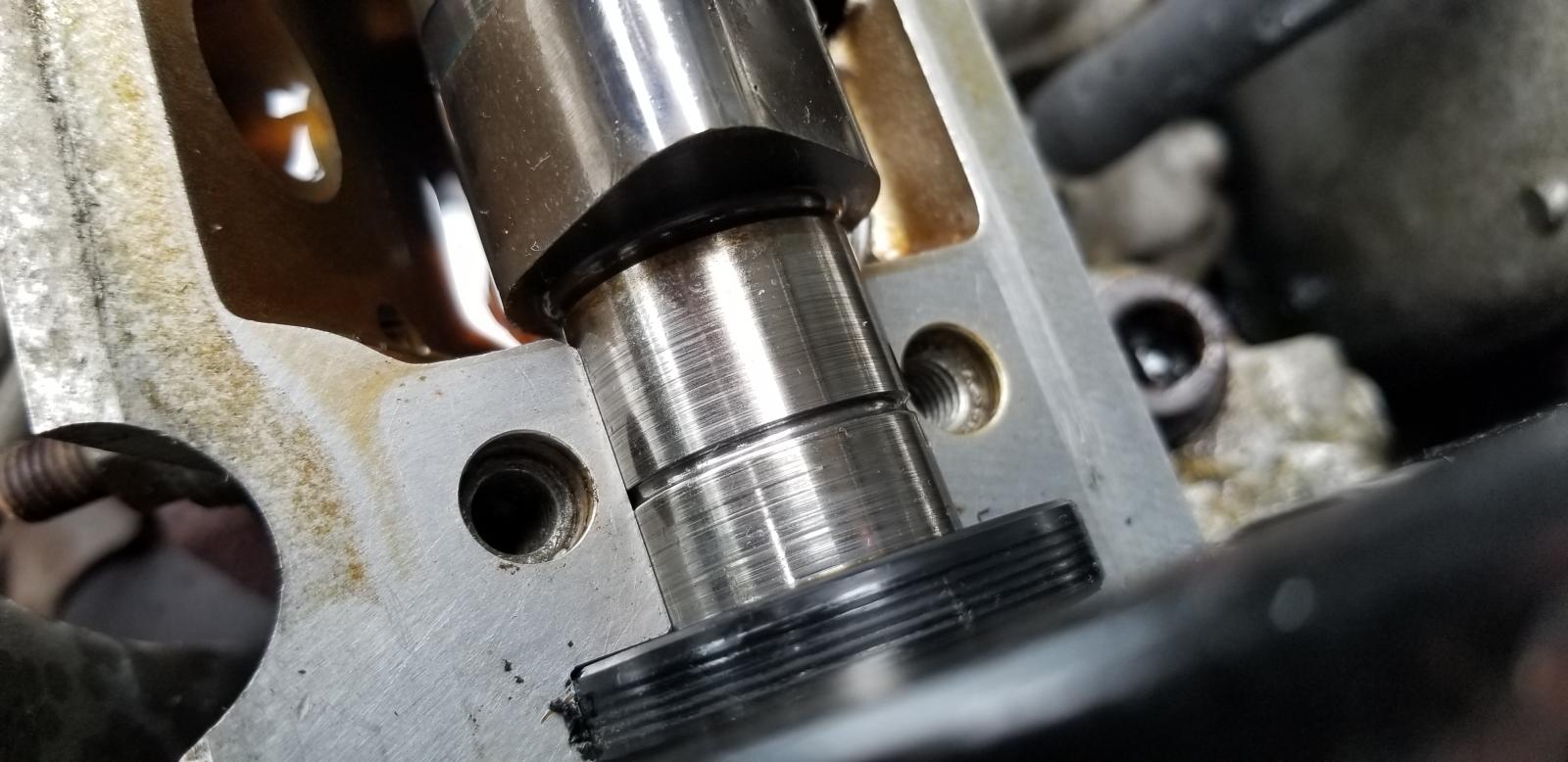

I'll start with a picture today. This is #5 camshaft bearing. It is only moderately badger's arse and does like to piss oil a little more than it should (thankfully into the right places).
This is the load side, the rough edge being the lash; most of that wear was on the bearings when I got them.
The camshaft is not showing (too) many signs of unhappiness so that's all good.
The rest are okay. Having finished inspecting the things, they got throughly cleaned and put back on. (Mental note they need torquing correctly).
Noise was hunted with screwdriver to ear. Turns out it's not the top end. Loosened off the auxillary belt and started it up, to be greeted by the most noisy thing being the fuel injector.
So, overall, either the water pump, alternator, power steering pump, tensioner idler or aircon compressor bearings are shot.
This makes me more happy than I was because those guys unbolt and one is even under warranty.
Phil

Yeah, the water pump is moderately awkward to get to work the engine running. Makes sense though that the noise was being translated up through the block.
Sad thing is, if it's the water pump, that was replaced 5000 miles ago when I rebuilt the engine.
Phil
