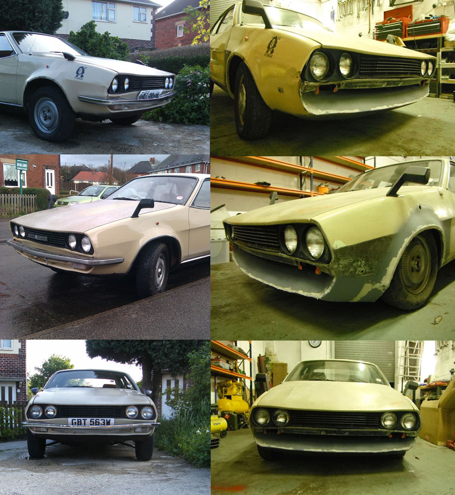

vulgalour Posted November 8, 2015 Author Posted November 8, 2015 Finally got time and motivation to crack on with the Princess this weekend. Putting theory into practice on bodywork is quite a learning curve, especially when you're trying to do ambitious things with shapes. I had fitted the MG B sidelight-indicator units to the front valance on the Princess, it looked perfectly okay on the bench. Then when I put it on the car it looked HORRIBLE so I had to cut out all the work and start again. I'd already marked out where I wanted the unit to sit but transferring the shape of the light unit to the curved panel was a case of trial and error as the light unit is slightly curved horizontally whereas the panel it's going into is heavily curved vertically, and ever so slightly horizontally too. After much nibbling and filing after the initial hole cut I had a hole the right shape without taking too much material out. Then I just had to make a rectangle of metal the right curve to fit the hole. That's also complicated. The recess needs to sit parallel to the top edge of the panel I'm working with but the back of it will be angled so the units sit in a better way. Many, many frustrating minutes of bend, hammer, tweak, bend, adjust with offering it up to the hole between and eventually I get to a point I can weld it in. Ugly welds, I know. I do know that welding from the other side of this would have probably made for a neater finish and required me not to make a second pass on the seam. It was very difficult to get access all the way around on the back of the panel due to its shape so I opted not to. When the piece was welded in I trimmed off the excess with the tin snips and then got the flap wheel to get everything flush. This bit wasn't so bad and the end result is fairly smart. Few bits here and there need extra attention and finishing and of course a bit of filler will be needed before paint. The backing plate next. I made several cardboard attempts at this and it was just annoyingly difficult. The back of the light units have two fixing bolts in opposing corners and the unit itself isn't flat so you need a really specific shape for the hole. Originally I was going to cheat and get a repair section but I've been unable to find one so I guess it's one of the few bits of MG B that you can't get off the shelf. After a while I had one side in, not fully, but enough to check for fitment. You can just see the orange corners of the backing plate where I've not trimmed them yet. It's not bad. For a first attempt at this sort of thing I think I've done okay and with a little more graft I'll have it finished nicely. What's surprised me is just how difficult it's been to get the shapes I want. I did notice that the tolerances I'd allowed in the cardboard version were probably a little tight for the metal version so I'm hoping I don't have too much trouble getting everything as smartly finished as I want. danthecapriman, Alexg and LC Torana 3
vulgalour Posted November 28, 2015 Author Posted November 28, 2015 Ah ha! Needs some fine adjustment to be properly finished like the bolt holes for the indicators enlarging slightly so I can fit them but otherwise it went remarkably smoothly today. I'm very happy with how this looks. I've a few options for the front number plate location, all of them are very easy, and a good amount of finishing work with filler to get it all looking as it ought. Driver's side wing needs that repair section letting in and the headlight alignment sorting out which are comparatively easy jobs to getting the front end tidied up. Next I'll either finished the rear light bucket or the passenger outer sill replacement. Can't do anything about the suspension until I find someone local to make me at least one suspension pipe and since disturbing everything the front corner is so low now that the tyre rubs on the inner arch when properly inflated. But hey, it's progress, and good progress at that! eddyramrod, Coprolalia, trigger and 6 others 9
Parky Posted November 28, 2015 Posted November 28, 2015 That looks mega, Stance Yo! Are you losing any cooling / ventilation with the new style of valance? Can't really remember what the old one looked like (apart from a bit bent) oldcars and vulgalour 2
vulgalour Posted November 28, 2015 Author Posted November 28, 2015 I should be okay for cooling, the new valance ramps the air up at the radiator smartly. There used to be a box-scoop thing in the middle obscured by the number plate and seemingly designed to push cold air into the front crossmember. If needed I can put a new box-scoop into the front valance in the future but I doubt it'll be a problem. Car has always run a bit on the cool side since fitting a Rover bubble fan.
