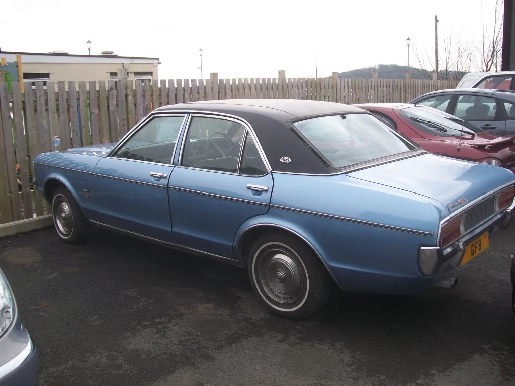

eddyramrod Posted December 6, 2013 Posted December 6, 2013 VA, where do you stand on whitewalls?These bad boys are Delta Majestic 185/75/14s, ordered through a tyre supplier in Paphos for me. From Atlanta, Ga. If we could get them in Cyprus I'm sure you should be able to get them over here. If you wanted to re-tyre the steels, that is... I'm constantly impressed with this story, you are making a real statement with this car. Great Stuff!
