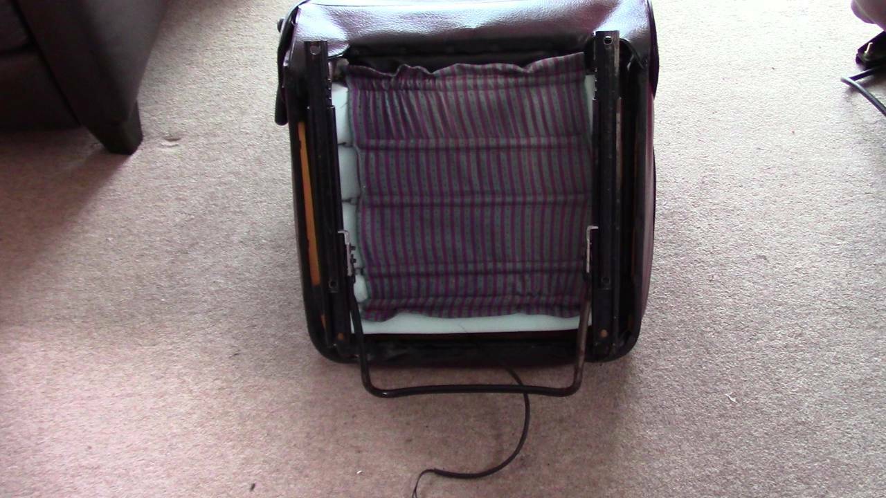

vulgalour Posted October 14, 2023 Author Posted October 14, 2023 Progress! Today I got the seat bases repaired and the new foam installed. They are now very comfortable seats, firm without being hard, squishy without being saggy. It is a job I do not care to do again, installing the seat base springs was a two person task and cost me the skin off a knuckle. I'll chuck some pics up in the future when I've done the video editing and whatnot from today's exploits. Next on the hit list is the rear brake drum I haven't rebuilt yet. After that probably do the covers for the rear lights inside the boot and the new boot carpet, both of which I have materials for and would tidy it up. Always good to balance out jobs you don't like with ones you do, even if the ones you do like aren't as important. GrumpiusMaximus 1
vulgalour Posted October 14, 2023 Author Posted October 14, 2023 Longer ago than I care to admit to, the driver's side seat base diaphragm failed just as I was pulling onto the drive. There were as far as I'm aware two different types of Princess seat diaphragm, one being more like MGs and Triumphs use being one big square of rubber with hooks all round, and the other like this. Typically, the big square rubber one is still available in various sizes while the hessian and bonded rubber straps like mine isn't. The seat frame bases appear to be made differently too, I don't believe my seats have the provision for the extra hooks needed for the rubber square type so I had to find a way to recreate this. I managed to find some of the right sort of rubber webbing and had some leftover hessian from work on the Lanchester. Combined with some very strong contact adhesive I hoped this would be a simple recreation. Unfortunately I couldn't get a strong enough bond between the hessian and the rubber. I then used a PU adhesive/sealant which was stronger and still not strong enough. Rather than chasing a solution down that route I looked at alternatives and realised I only needed horizontal springs or webbing of some sort and then a method to keep them evenly spaced. Some hunting online found Parker Knoll style seat springs and a standard size was suitable for the Princess seat bases. I had some good strong fabric that I could make a panel with channels for the springs to go into and I built up a seat diaphragm with that. It worked really well except that I ended up sitting quite a lot lower in the car since the springs gave the foam less support. It was an adequate solution and I moved on to other things until recently when I ordered some medium density foam to go between the diaphragm and the seat foam. This solved the sitting-too-low issue and firmed the seats up to be more like the HLS trim versions so they're a lot more comfortable now. Best of all the extra foam has taken out the saggy look of the front seat bases, a common issue with HL seats. The passenger seat back foam is still pretty good but the driver's one is definitely getting tired now and would benefit from being redone. That, however, is a job for another day since taking the seat back covers off is a bit of a nightmare and not something I want to venture in to until it's more necessary. Marshall2810, Honey Badger, LightBulbFun and 8 others 11

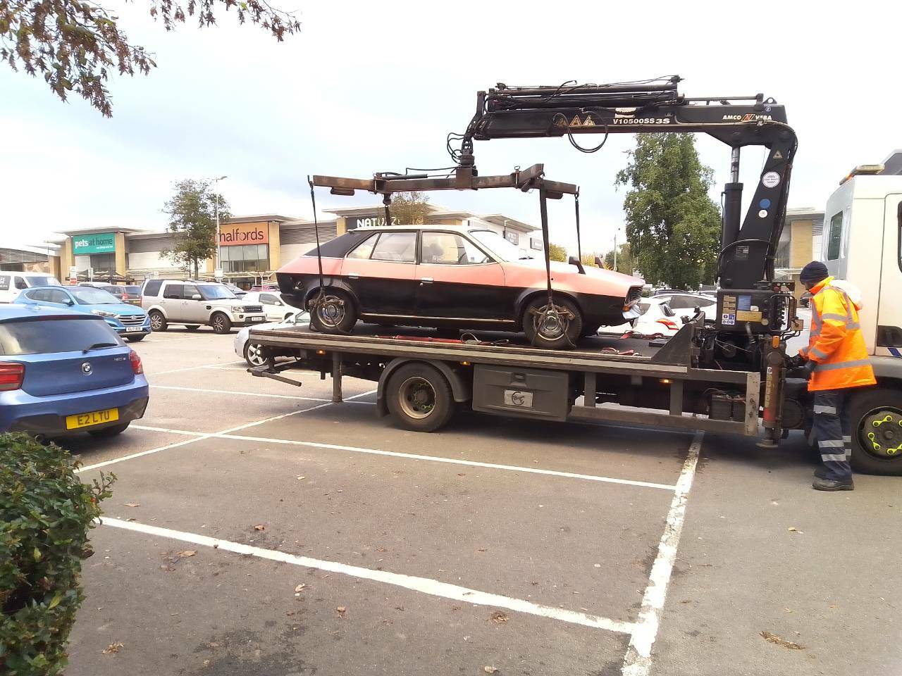

vulgalour Posted November 3, 2023 Author Posted November 3, 2023 Things are not off to the best start here. First time using my insurer's breakdown cover. It could definitely have gone better. Fortunately for me they sent a very nice recovery driver who was incredibly easy on the eye and had me homeward bound in no time. That is, after I'd done waiting for THREE HOURS in a retail car park. Longest quick trip to the shop ever. Seriously, I only went out on a five minute errand for some household bits and bobs. Safely docked we trundled the ridiculously short distance home - seriously, it would have been quicker for me to walk home, find the spare part I needed and walk back - and then unloaded the car ready for me to sort it out in daylight. The FTP itself was a really stupid one. I drove the car with absolutely zero issues, had driven it yesterday, and had been moving it about on the driveway with nary a problem. Got back in to set off for the next part of my mission and *click*. I knew that it was either a bad earth or a stuck starter solenoid. The dash lights etc. were all still fine, I just didn't have enough power to get the engine to crank over. Weird. A few attempts to start and some further investigation led to a whisp of smoke off the throttle cable. Definitely a bad earth then since a few years ago it did that to me due to a bad earth cable and the next earthing route on this car after that is apparently the throttle cable. I did get the earth points cleaned up to a point that it dealt with the poor earthing situation but by then the damage was done. I now had a throttle cable that was jammed in the sheathing due to melted plastic parts. I did free the cable off but in the process damaged the sheathing so that now the throttle just jammed on and wouldn't return, rendering the car unsafe to drive. Couldn't bodge it either, I didn't have the right things with me even though I did have lots of things with me. The one thing I needed was a replacement throttle cable and that's the one thing I wasn't carrying today. The really weird thing is I didn't stress about it. I got bored, and rather worried that my phone battery - which I was going to put on charge when I got home, typically - was almost expired by the time recovery arrived. Other than that, I seem to be pretty chill about the whole experience. One person stopped to ask if he could help, several people stopped to ask me what the car actually was, a couple of people complimented the colour (thanks, Barbie!) so it wasn't as terrible as it could be. I have taken down details for the private company that runs the car park. Parking limit there is three hours and I reckon I exceeded that by the time we left so they may send me a fine because parking companies. I've kept proofs and took photos of the fact I was actually broken down, just in case. Tell you what though, it really is a comfy place to be broken down, could have even had a little nap if I wanted to. vinyljunky, richardmorris, barefoot and 9 others 11 1
grogee Posted November 4, 2023 Posted November 4, 2023 16 hours ago, vulgalour said: The really weird thing is I didn't stress about it. I got bored, I felt the same on my last FTP. Just gave into it and let it wash over me. Cars gonna car, as our American friends don't say. The biggest stress was how to get it 'home' if the AA couldn't fix it because we were in temp accommodation at the time. Luckily he did get it going and it turned out to have run out of fuel; the Rennow electrics had lied about there being some juice in the tank. vulgalour 1

Zelandeth Posted November 4, 2023 Posted November 4, 2023 22 minutes ago, Noel Tidybeard said: run a piece of string thru window We did get an old Bedford coach back to base on one occasion with me hanging through one of the floor hatches manually operating the throttle lever on the fuel pump. Double declutching was a little interesting, and I was half deaf in my right ear for a few hours afterwards, but we made it! Rustybullethole, lesapandre and vulgalour 3
vulgalour Posted November 4, 2023 Author Posted November 4, 2023 The choke cable idea is a good one and had I got more space to open my door to get to the pedals and a choke cable end that didn't like to fray whenever you look at it, I would have given it a go. I had enough tools to thoroughly mess up the carb settings to compensate for a lack of choke should I need it, though the car was still warm enough that I shouldn't have. Likewise the string idea, a great one if you have a length of string (and okay, I could have gone into Homebase and got one, it was another thing I didn't have in the car) and you wanted to navigate the three roundabouts and entirely uphill run from the retail park to my house. I didn't fancy trying to do that and breaking down in an even worse spot, or having a mishap, waiting seemed the sensible course. I have ordered replacement battery cables and a replacement throttle cable so I shall have some tinkering to do once they arrive. mercedade 1
