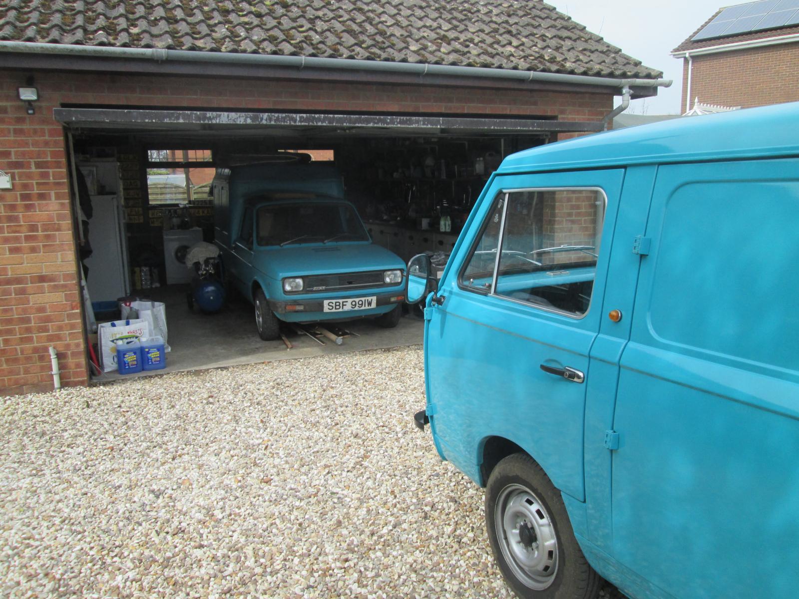

My 1978 Fiat 900T van. And the rest of my fleet...(3 years later!!! ...Updated 11/12/23)

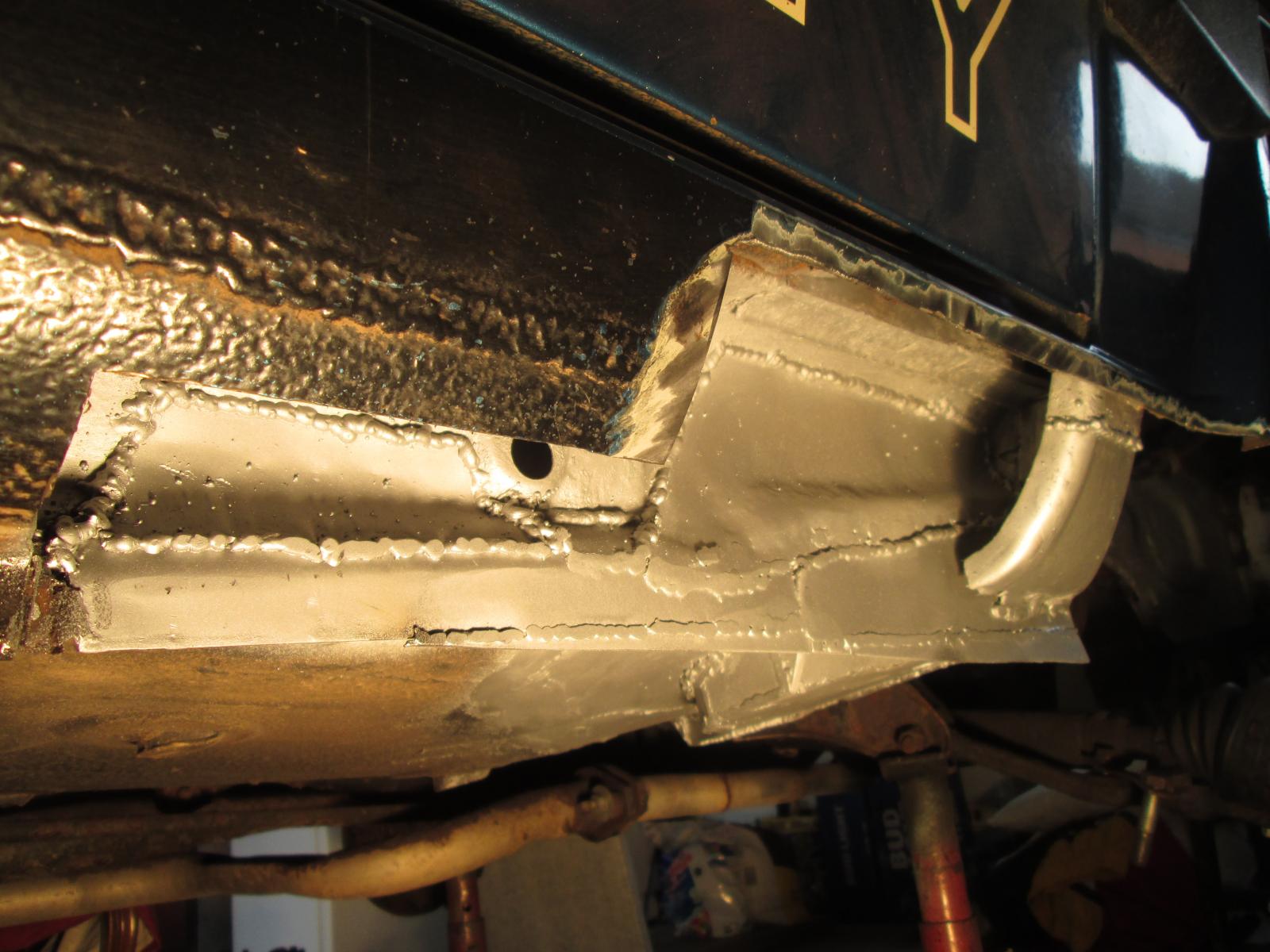

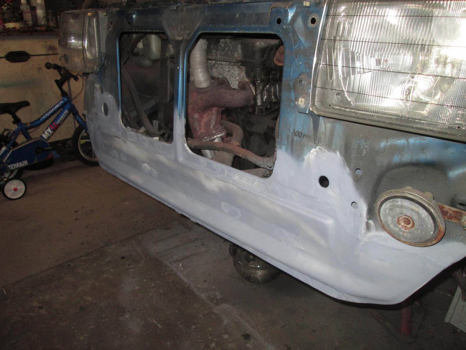

After I stripped the driver side front suspension off, I did the repairs to the inner wing. I cut the rotten section out and repaired it on the bench and then welded it all back. This meant I had to take out the interior in the drivers footwell...joy.
This was all welded back in and then closed up by forming a section on the vice using a hammer and dollies to cover it. No pics I'm afraid...

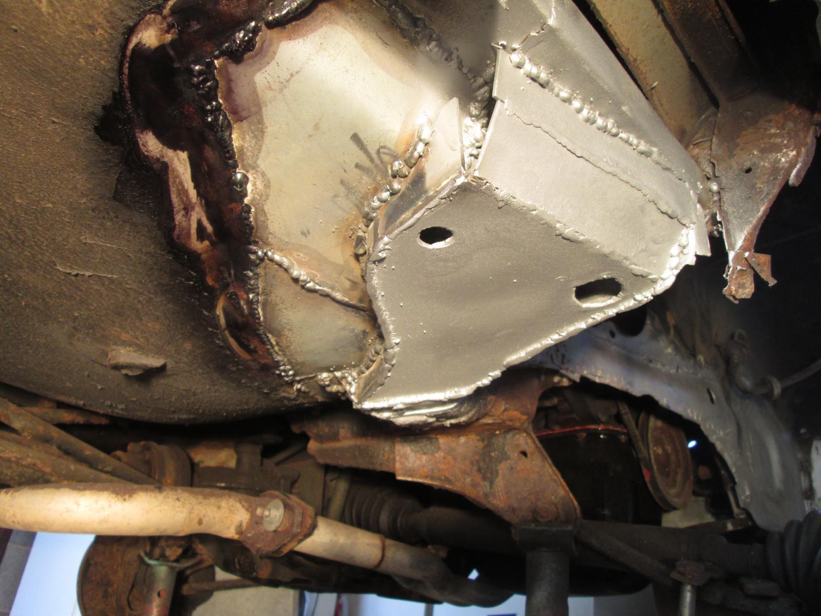

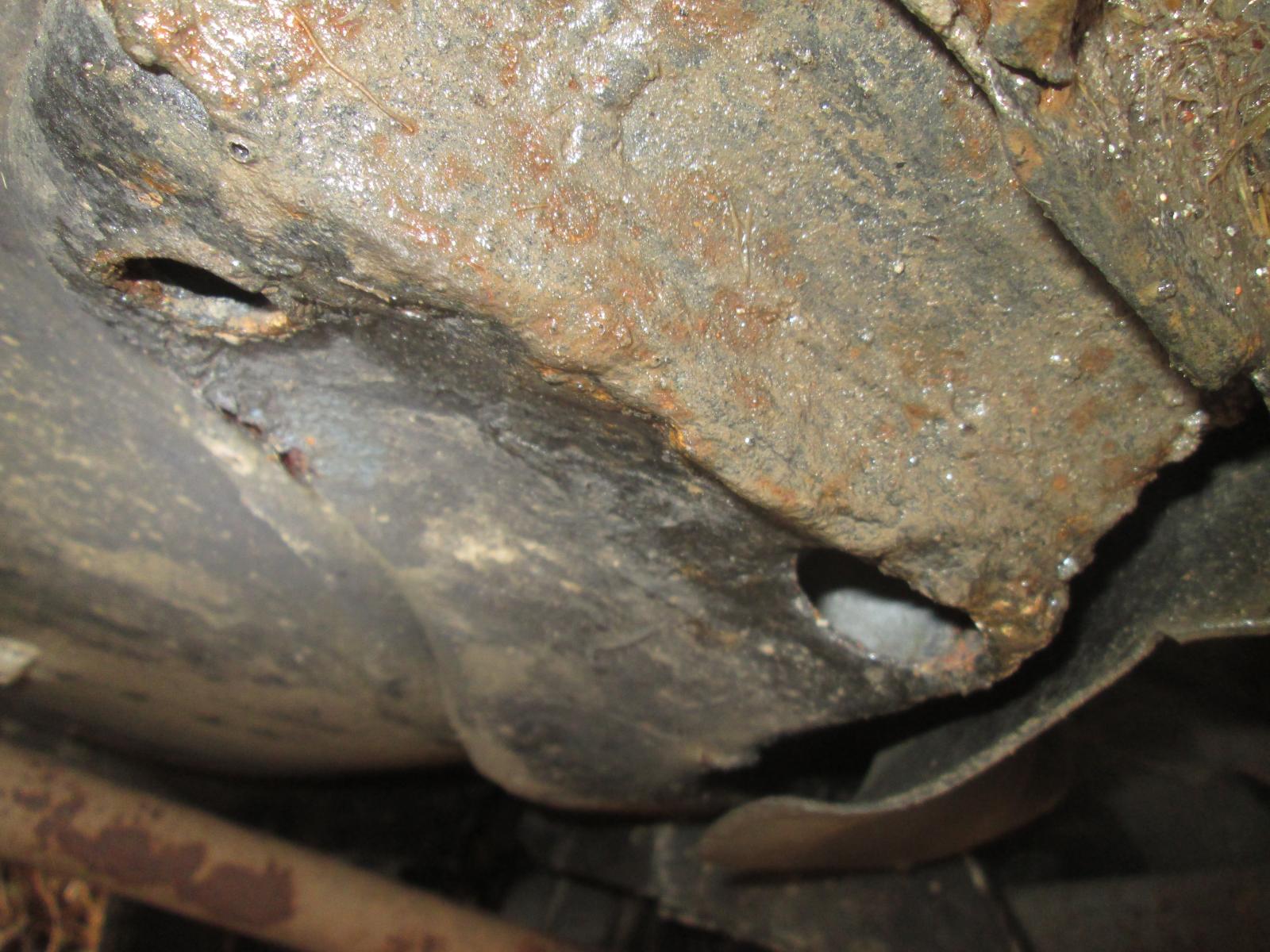

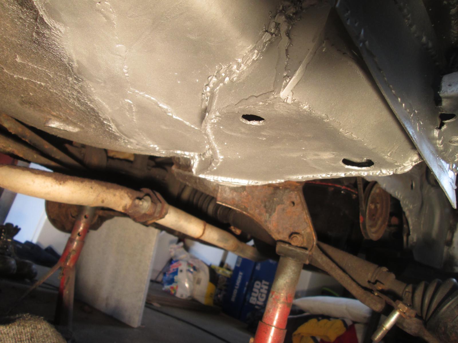

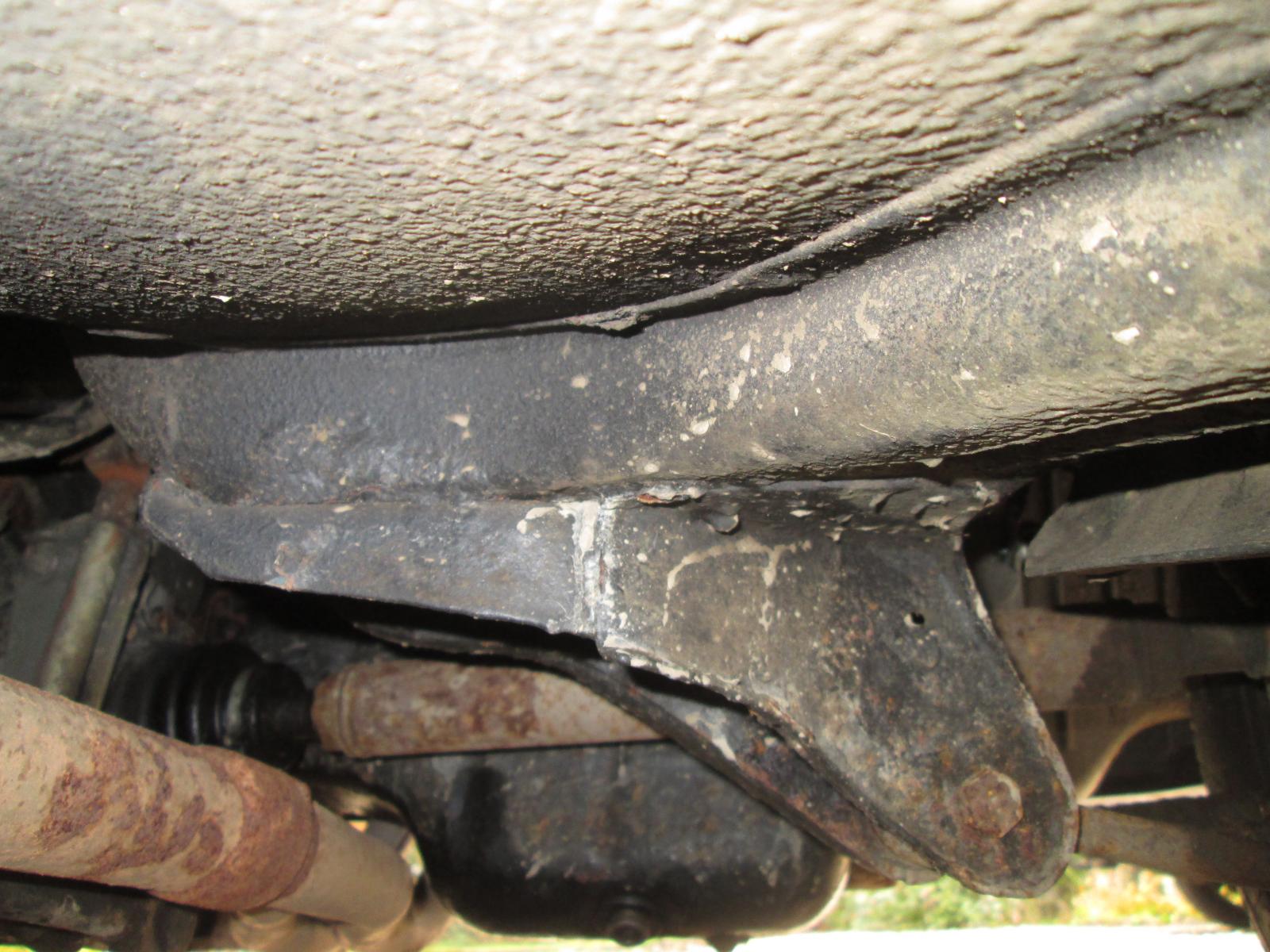

The front crossmember has a section to where you locate part of an arm on a 2-post lift. The drivers side had been flattened and plated over...
It should look like this. Pictures from my 750L...
What the MOT bloke had done in the past was bash it all flat with a hammer and weld a plate over it, to the point where now, if you put a jack under it, it would make crunching noises...

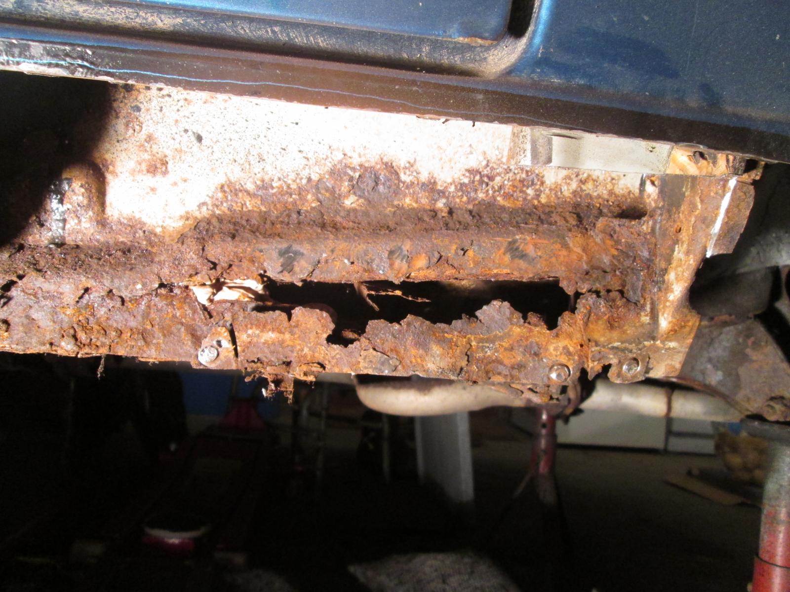

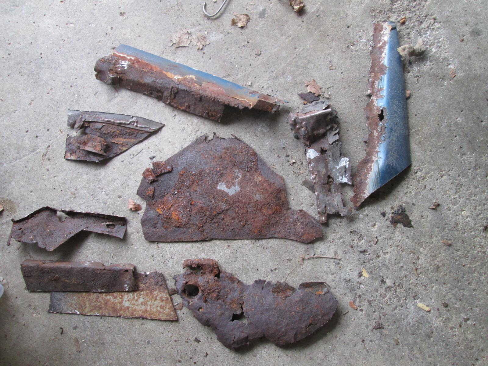

I cut the end of the outer sill off and this met my eye...

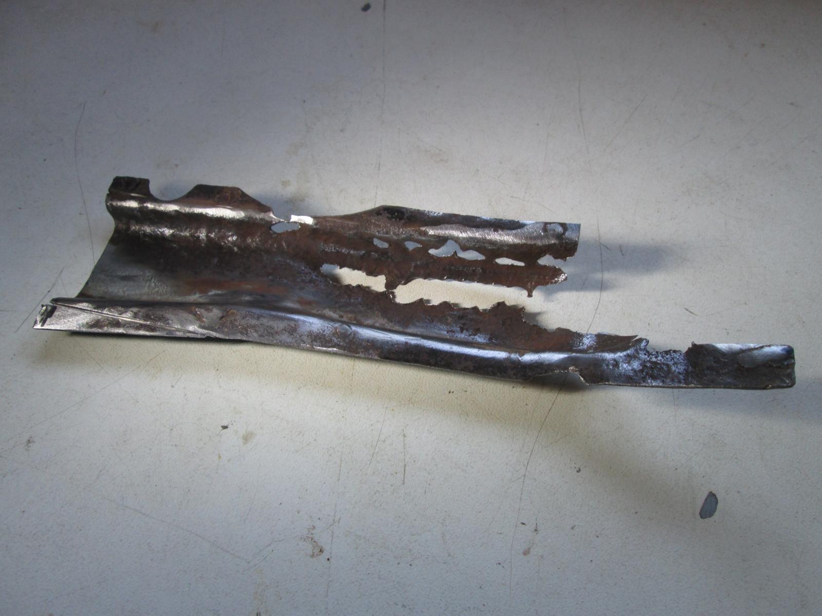

And this is what i ended up cutting out from the crossmember, floorpan and inner sill...

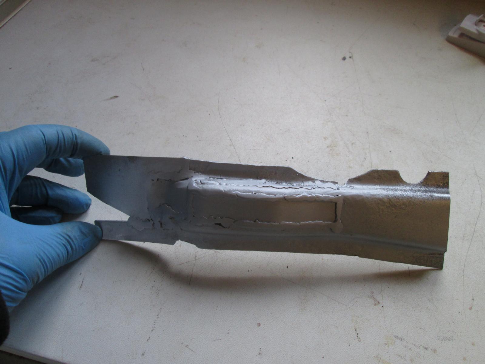

The bit in the middle is the welded over repair. The bit at the bottom is the remains of the original crossmember.
I replaces all the rotten sections of floor first and then rebuilt the crossmember using templates and measurements off the 750L... I the replaced the inner sill sections and rewelded in the outer sill...
Here is the finished inner wing and front end all primered up...
Everything is now all painted in POR-15. Including the suspension which I put back de-rusted and painted. This means I now have to take the passenger side suspension apart as that is covered in rust and shite, so it doesn't look right. This means I am going to have to do the back tod as that will be put to shame by the front...old cars eh.

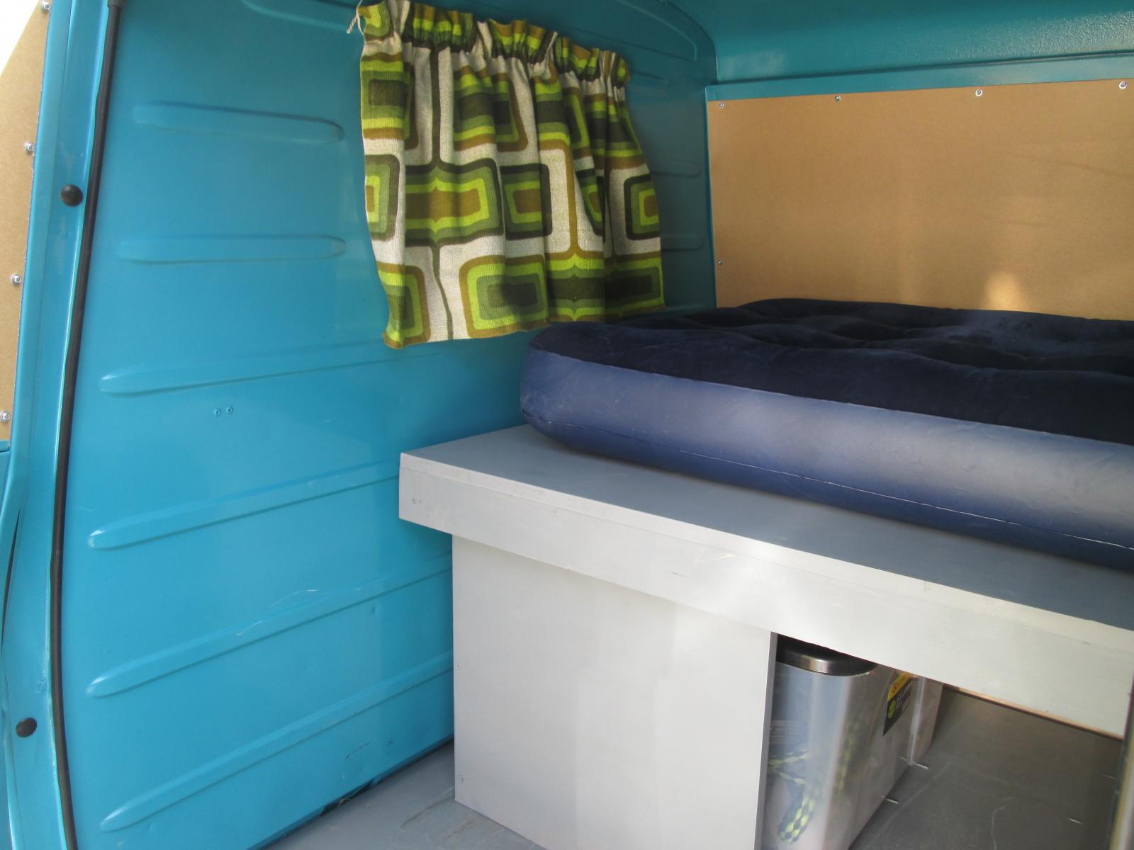

I do have picture of the removable bed I made last summer for the van. I used it for a long weekend at a festival with my step-brother and his family (they were in a moss covered LDV Convoy...of which the high top roof has decided to seperate itself from the body...but that is another story...). It was comfy, but you don't need more than a weekend in it...

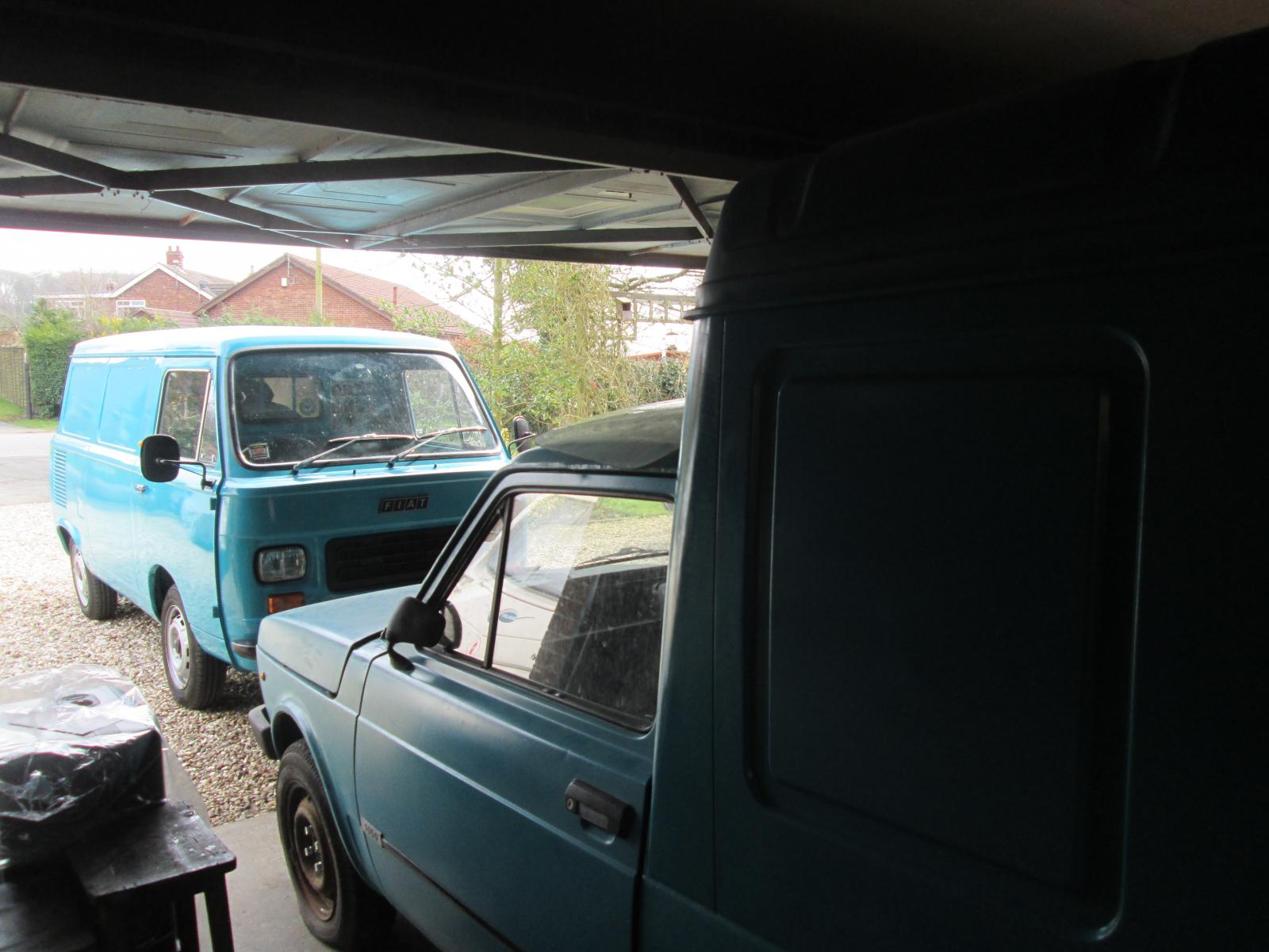

So, Lombardi collected and transported to garage. Fiorino removed and Lombardi takes it's place...
Fiorino on trailer...

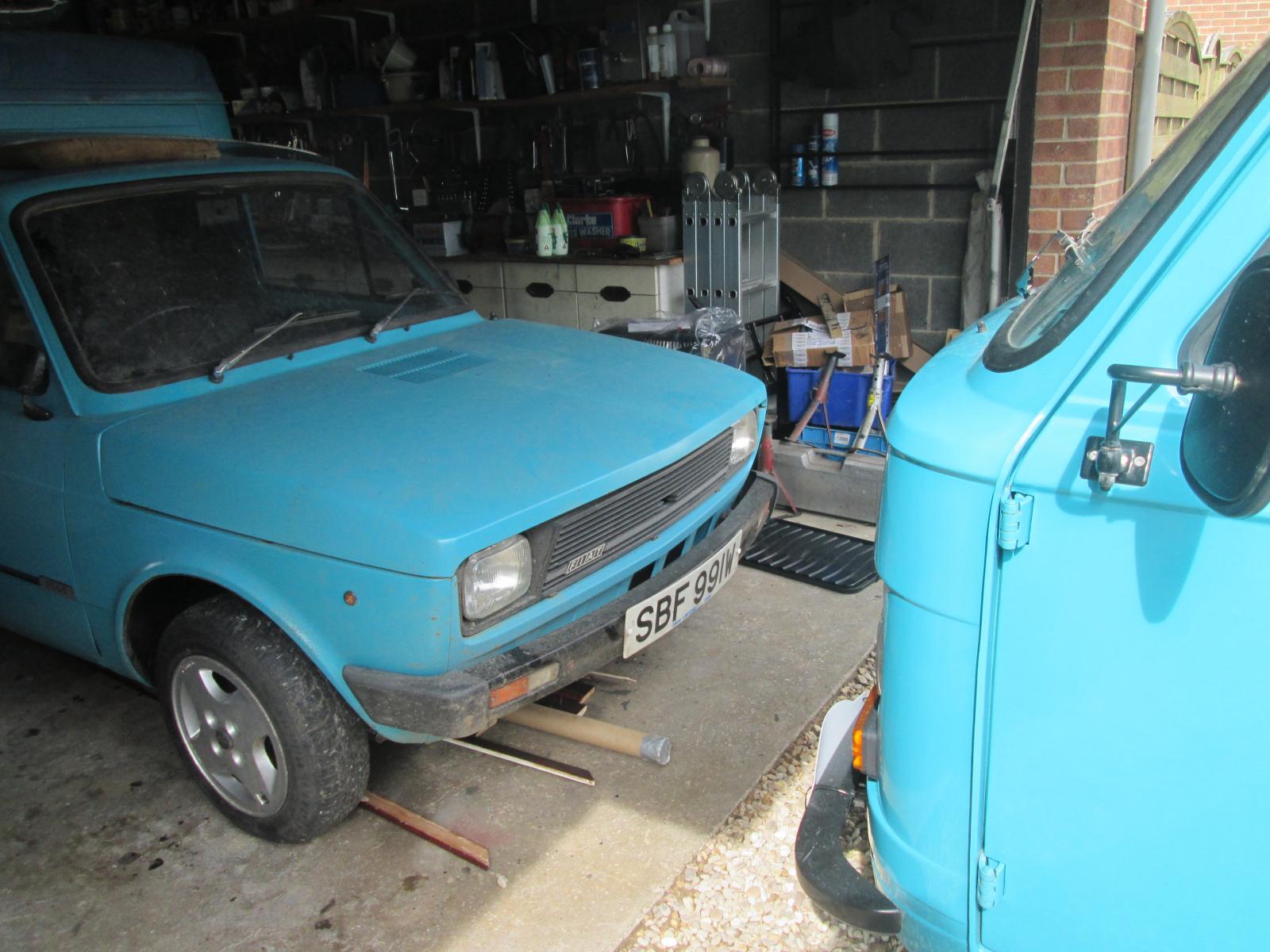

Fiorino is now in garage. I now had a chance to assess all the boxes and bits in the back of the Fiorino. I had a week off work after Easter, so got the 900T from it's lock-up and moved some boxes of bits and old panels from the Fiorino to the village lock-up were the 900T is resident.
It also meant that after 2 years of Fiorino ownership, the 900T and Fiorino finally met, FACE TO FACE.

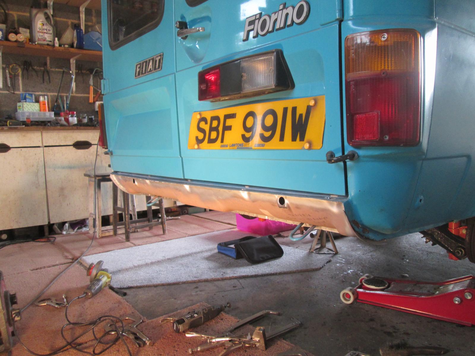

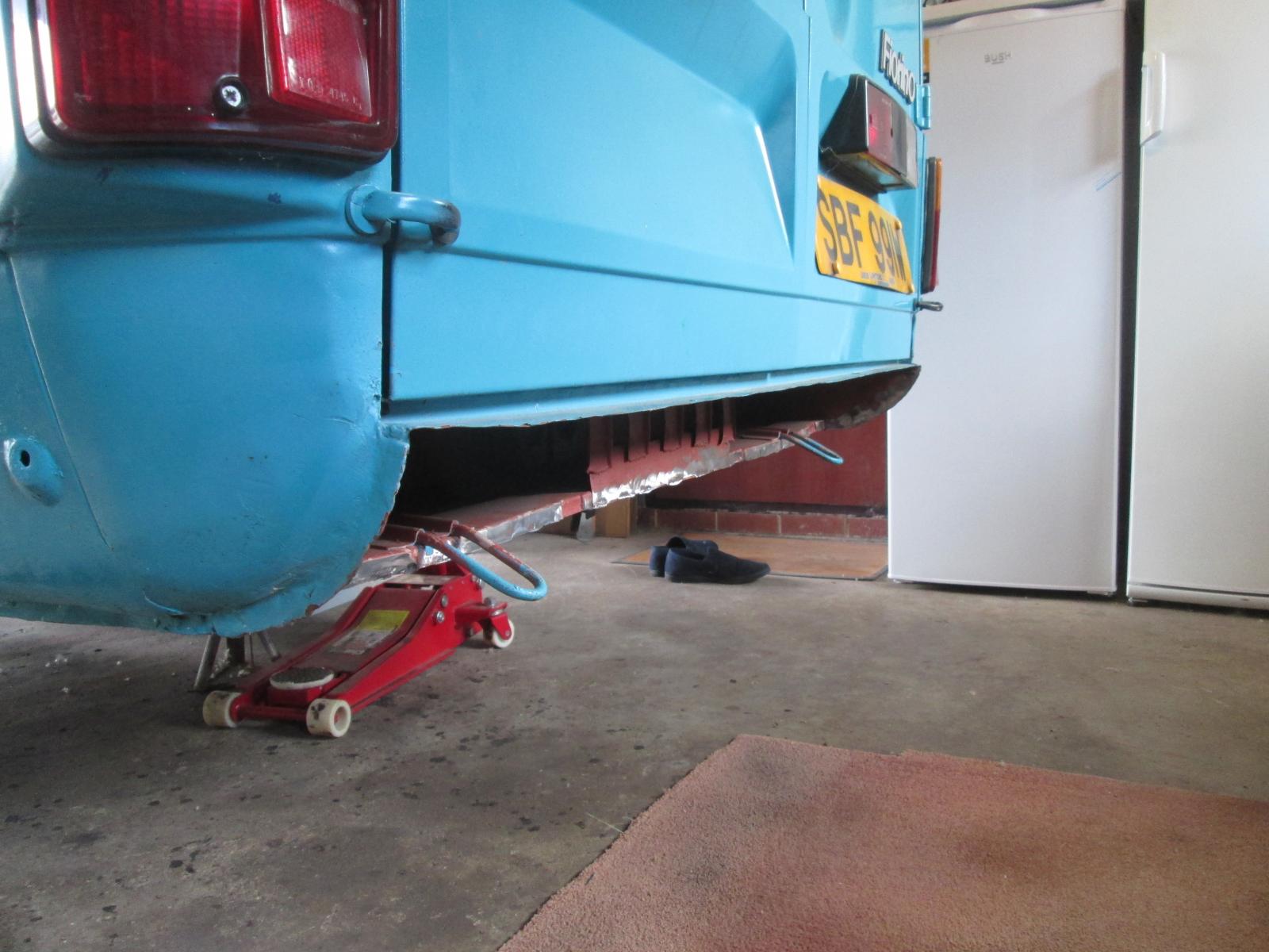

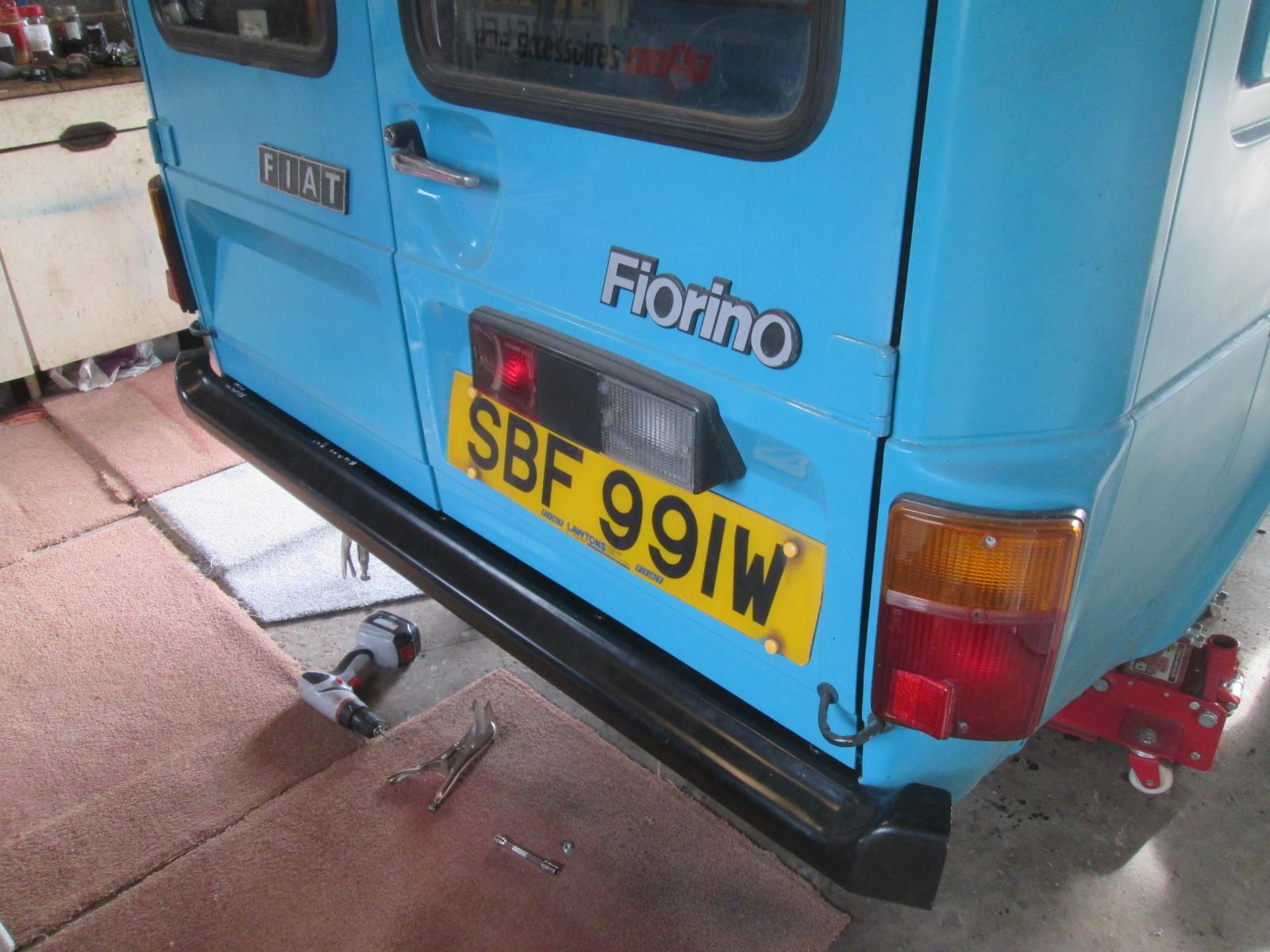

I did the rear panel instead. When the previous owner had the welding done, he couldn't get a rear panel, so they chopped up a mini van or pick-up panel and used that. This is all well and good, but I was able to find the correct panel on Italian E-bay. I'd also got a new bumper from Italian E-bay and this panel had all the mounting holes for the bumper in it. So I cut the rear panel and put the correct one in...
The fabricated rear panel...
The correct rear panel and new rear bumper...
Cut it out...
Put it in...
With bumper loosely fitted. Obviously, most of the panel is covered up and you won't see it, but I now know it's right...

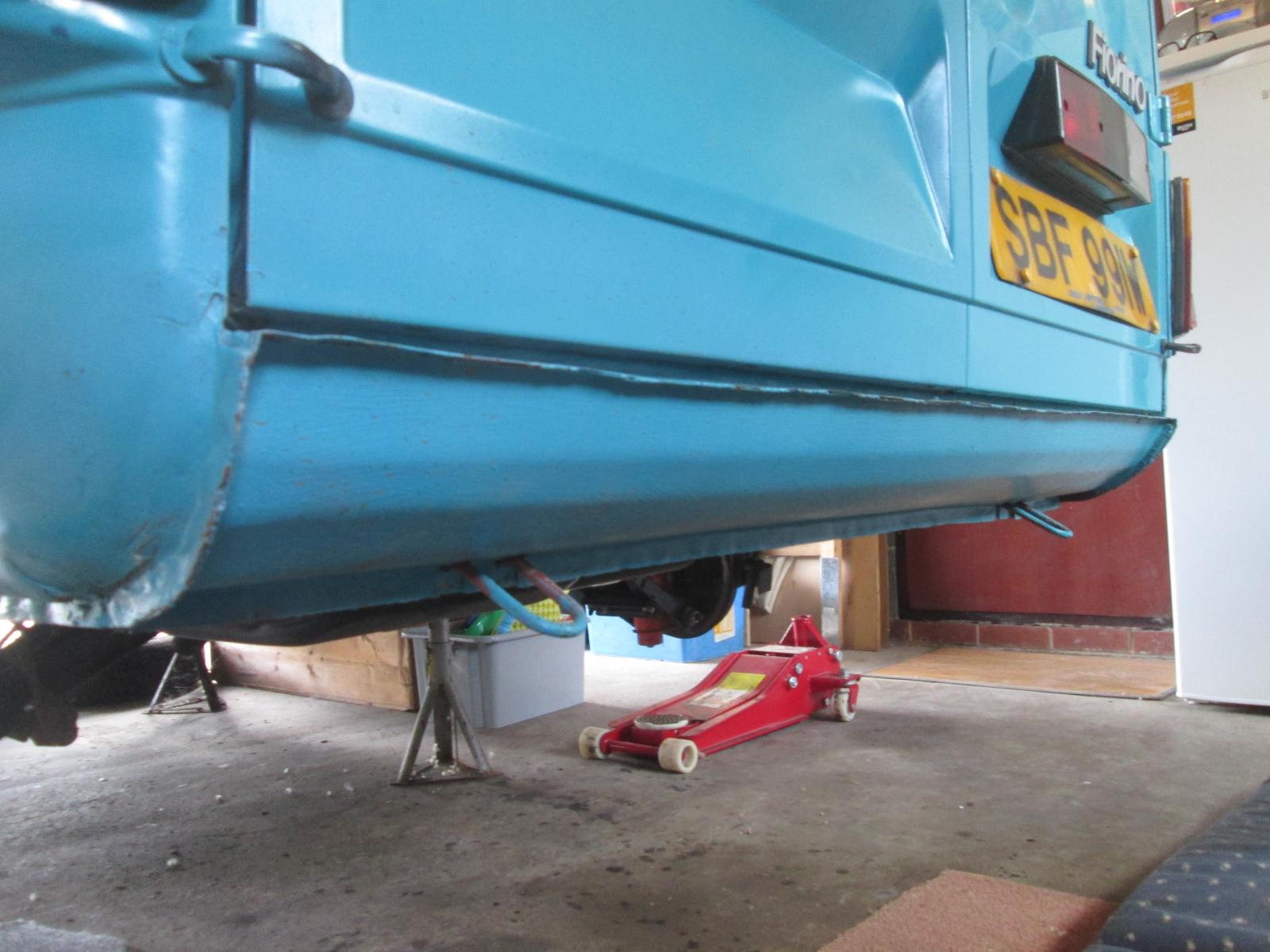

What I also did was spent time underneath, scraping off and cleaning up the sections of split and cracked underseal on the floor pan, this led to patches of solid metal but with surface rust on. Some bits will need cutting out and tickling with the MIG, but only where the rust has turned fixing holes into squares and the like. Not a big job at all...

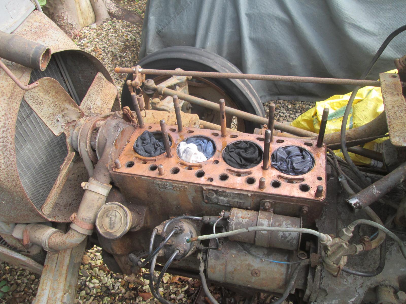

I've also been doing work on this tractor - a 1947 Ferguson TE-20. It belong's to my Step-mother. The tractor is an early one so has the Continental Z-120 engine in it rather than the Standard unit...
I did have to free the engine off by putting diesel down the bores and leaving it for a month or so. It was then able to be freed off using the starting handle...
There was a stuck valve though, so I took the head off and was able to remove them all but one which was stuck solid. As a result I got some new valves and guides and the head has been sent to have the valve removed and new guides put in. They are also repairing the broken thermostat housing mount that you can see in the picture. I had the broken off piece. Should be ready next week apparently...
I took the brass drainage tap off the block after lubricating it for a week. It then took me a week of soaking it in deox-c, then paraffin, and then eventually heating it, I was able to dismantle it. It had been left in the open position, so it was drained many years ago, but once I got the tap working properly I could put it back. But first I put the pressure washer on a narrow setting and put it up to the drain hole and gave it a blast. I also blasted each water channel form the top of the block too. There was brown water and rust flakes all over...
I've put the tap back in and filled the block with deox-c. I'll agitate it  with bottle brushes and flush it through. I'll deox-c it a few more time and then pressure wash it again...
It's current state...the cylinders are stuffed with oil soaked rags. Also the head gasket is that colour because it's made of copper. Anybody know how to go about getting a replacement made?? It appears to be two layers of copper sandwiching something else (I don't know - yet)
You can either reanneell the gasket or buy new parts are easily available for the Fergy, I would assume continental engine parts are no exception as they made enough of them.
Oh yeah I know that parts are easily available for the Fergy, just not Continental engine bits. You can get main engine components, such as I have with the valve and guide set, but they have to come from America and it does take a while...it's the smaller engine components and accessories that are a problem...
Thanks for the gasket link. I was aware of that, but the tractor was converted to run on TVO, probably when it was new, so to alter the compression the common practice was to fit a thicker head gasket, which I guess is why it has the thick copper gasket on it...I had thought of just getting the gasket set you linked and converting it back to run on straight petrol...
I'll have to have a ponder...
Can you even buy TVO? If originality is important there are companies which will copy gaskets to the required thickness, although not necessarily using the same materials as some composites contain asbestos.
If the head gasket is solid copper it needs to be annealed before being reused as they are quite thick. Used to have a vintage car that had a solid copper gasket. You can also get a aerosol of copper gasket cement to use instead of jointing compound.
I suspect it is copper asbestos from what you describe and would be best to replace it
There are various recipes out there on how to make a petrol/parrafin mix. This tractor left the factory running on straight petrol, Ferguson didn't offer a TVO version until about 1950...Converting it back to run on petrol would mean a lot less hassle to be fair
Thanks, that is interesting to know about. Probably another good reason to convert it back to petrol...
The standard way to convert to TVO was 2 head gaskets and a decompression plate sandwiched between them, plus a cover over the inlet manifold to get/ keep it nice and toasty.
For a TVO recipe try
4 parts kerosene
1 part petrol
1/2 part diesel or a bit of 2 stroke oil.
Depending on the work it's doing you may need to add more or less petrol to the mix.
You need the engine to be warm before you switch over but contray to rumours there's no need to blank the rad off/ cover it in blankets etc, they are more economical running on petrol though and less likely to foul a plug.
