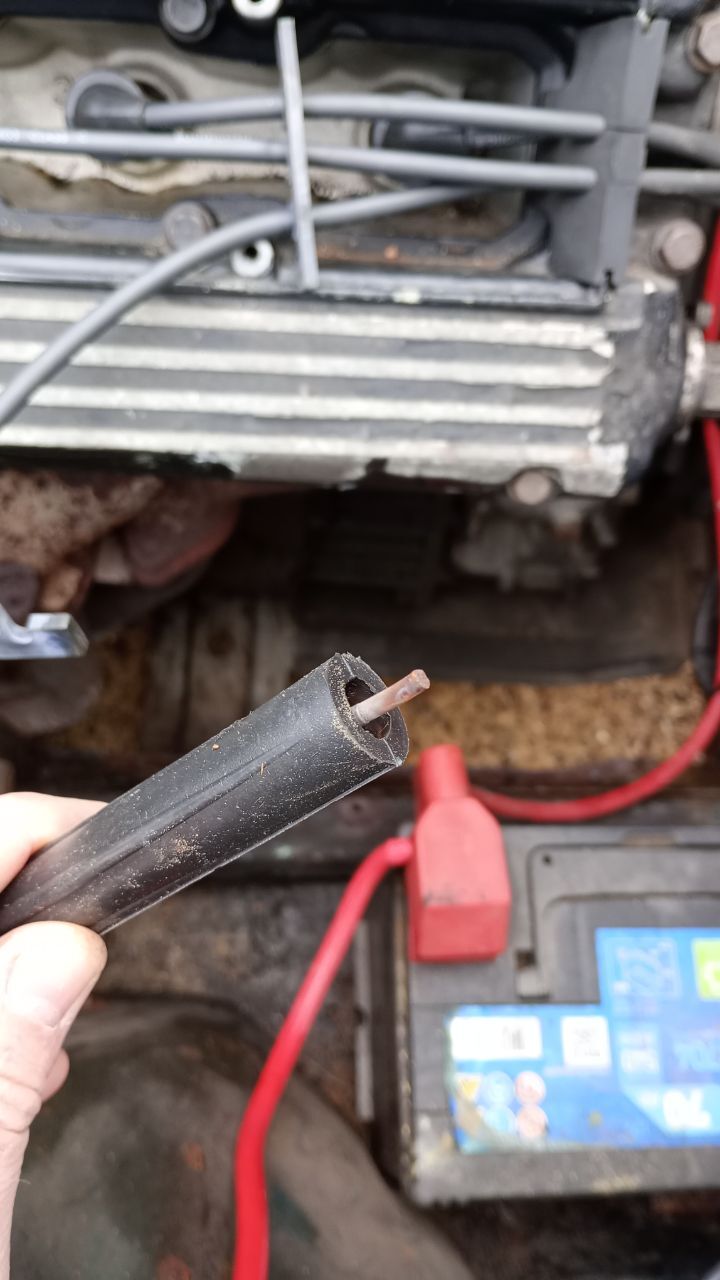

Secondly, there was a chronic misfire from cold that disappeared by the end of the road. I thought it was going to be some complicated 5th injector nonsense, but rarely for me I started with the basics before spending huge amounts of money.
Hmm, that would do it. Never seen a plug fail like this before, wonder if it was a counterfeit one?

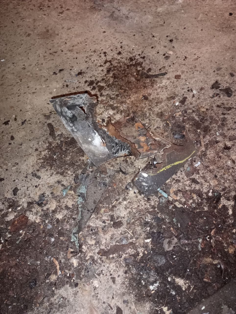

Running better I couldn't ignore a weird tapping noise from the back I was getting every time I changed direction. It sounded like something rolling around, but I searched everywhere in vain. Eventually after swinging the back end of the car violently from side to side on the drive (neighbours must have wondered what the hell I was doing, not for the first time), I tracked it down to the rear light cluster
IMG_20250404_164939.jpg.5ad9ac1edb5b8ddda98865ebaf4cdde7.jpgIMG_20250404_164946.jpg.7e1b73ae75a37b4bdf46c60f594f7950.jpg
Yes, that is the remains of a bulb that was rolling around inside the cluster. I couldn't believe how noticeable it was!

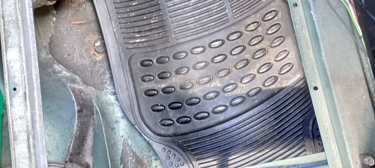

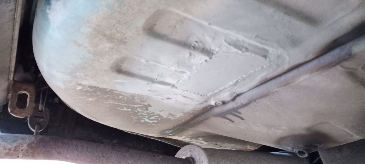

As mentioned, all that leaking water had left it's mark on the boot floor, and the last MoT had handily marked up the areas for attention.
IMG_20250427_141747_HDR.jpg.52c99ee57cd2541e80d841d7d4978cab.jpgIMG_20250427_141757.jpg.72e4b58b6ceb86ee52b76c1e8aca5fdd.jpg
As these were only advisories, my normal approach would be thus:
Fixed

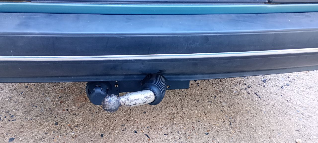

However, the need to move this,
With this,
Meant I was going to have to do something more permanent*.

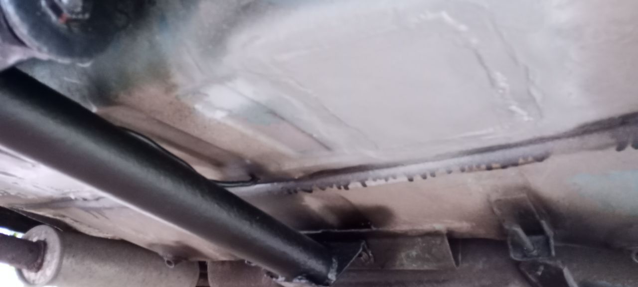

Chop , chop
CAD
Several small fires and lots of swearing later,
Seal sealer hiding all the sins,
Of course, I'm ignoring this corner as it looks a lot trickier.
Anyway, I could now bolt this up and marvel at a genuine period Saab accessory.
It was a cold day, OK?!
That's better!

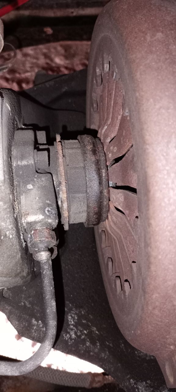

On to the noisy clutch bearing then.

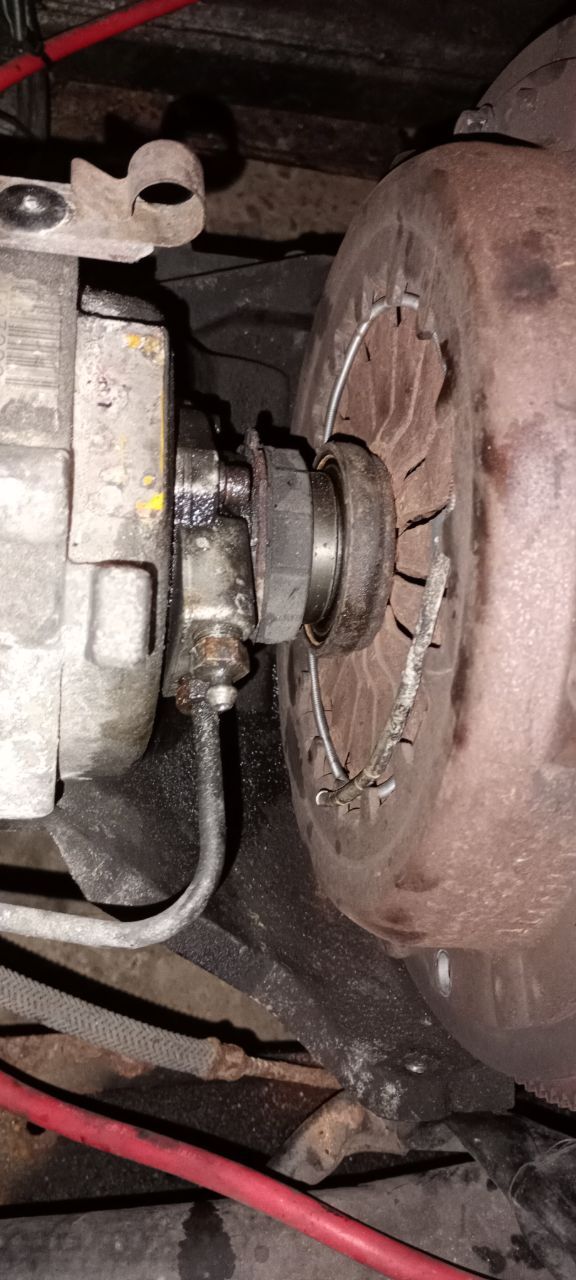

900 clutches are a strange beast, you can do the whole job without ever even having to bend down, let alone grovel on the floor. This means it is a job I'm willing to tackle these days!
Plastic cover off and this is what you see
All looks original, not bad for 34 years and 112k. The bearing in question is in the middle.
Fortunately the hydraulics still worked (turns a simple job into a right pain), so with the assistance of my 11yr old I could compress the clutch and insert the special* tool (might look similar to a bike brake cable).
Everything unscrewed and eventually pried out - one dowel on the flywheel put up a bit of a fight but eventually lost to the crowbar.

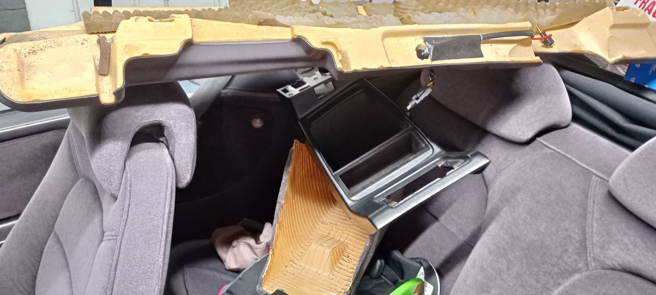

From bitter past experience I've found that replacing a slave cylinder on a neglected hydraulic system often leads to a premature failure from crud in the master cylinder, so I decided to change the master and the clutch hose whilst in here.
Access is needed from under the dash so some brief* disassembly later and most of the dash was in the back seat
Another worthwhile job, this hole on the clevis fork should be round, that's probably about 20mm of excess pedal travel accounted for!

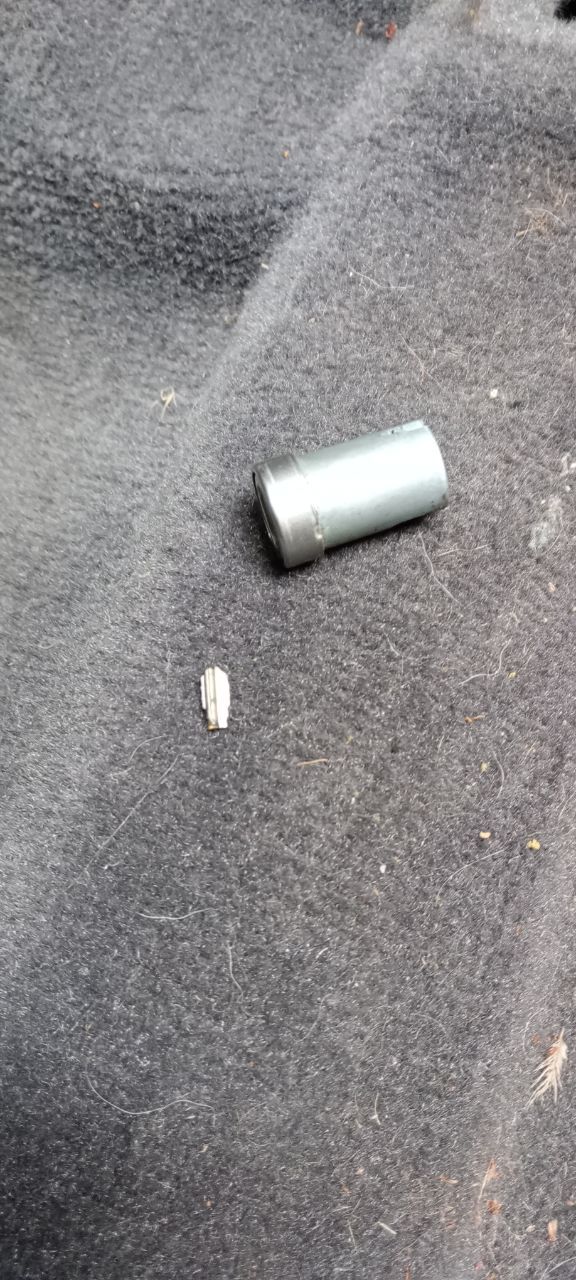

This was the ignition key supplied with the car
Less than ideal, and one of the reasons my other half refused to drive it (it's operation wasn't guaranteed!).
This was cause the original key had broken in the barrel and a bit was still jammed in there.
The barrel was eventually extracted (once again thanks to internet advice) and I was able to extract the key remnants.
I proceeded to blast 30 years of grit, crisps, bogeys and skin cells out of the barrel and was rewarded with a lovely smooth action with a fresh key. Result!
My solution to having a key break off in the ignition barrel was to just use the rest of the broken key to start the car and have a complete key on the keyring for the other locks.

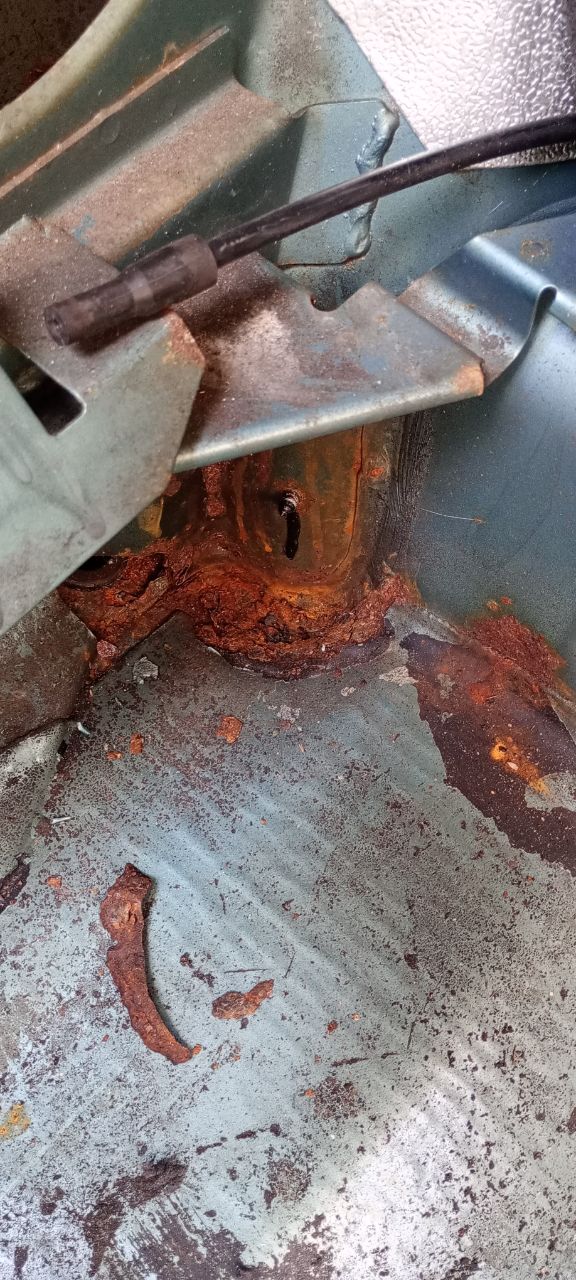

Double arses, that looks crusty!

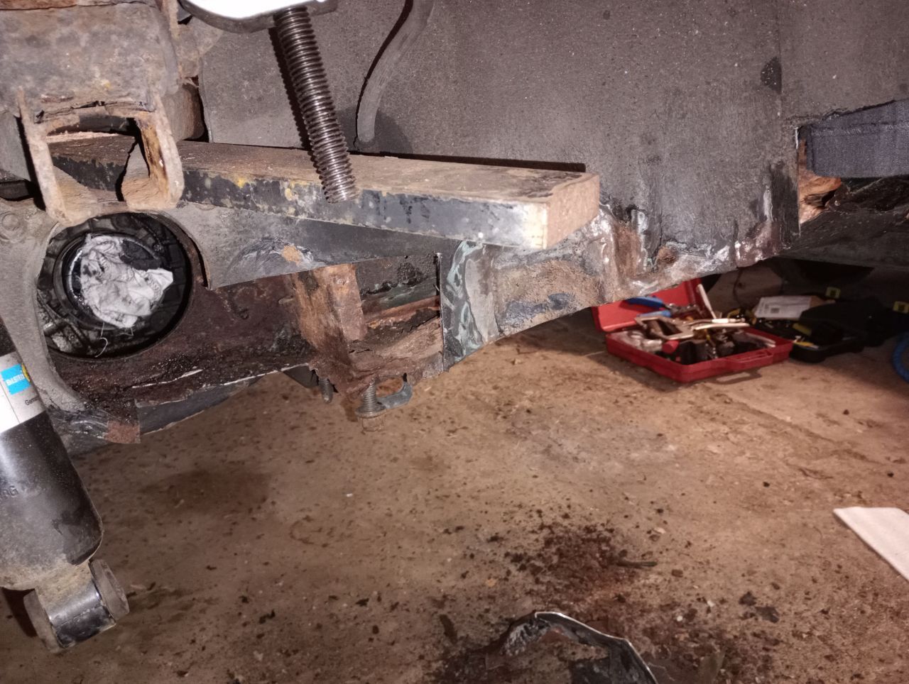

Anyone who's had a 900 knows that this bit around the driveshaft is their Achilles heel, renowned for being a bastard to fix. Looks like this has had some previous attention in this area, maybe just a tidy up and fresh underseal?
  • Sad 2
Of course not!

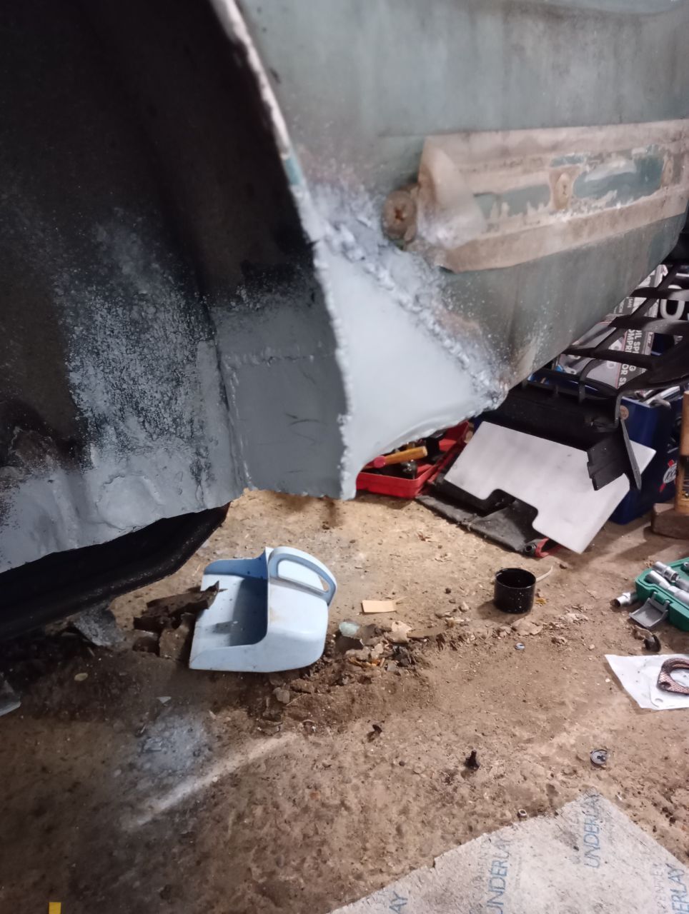

It's had an MoT standard* repair previously and the more I probed, the worse it looked.

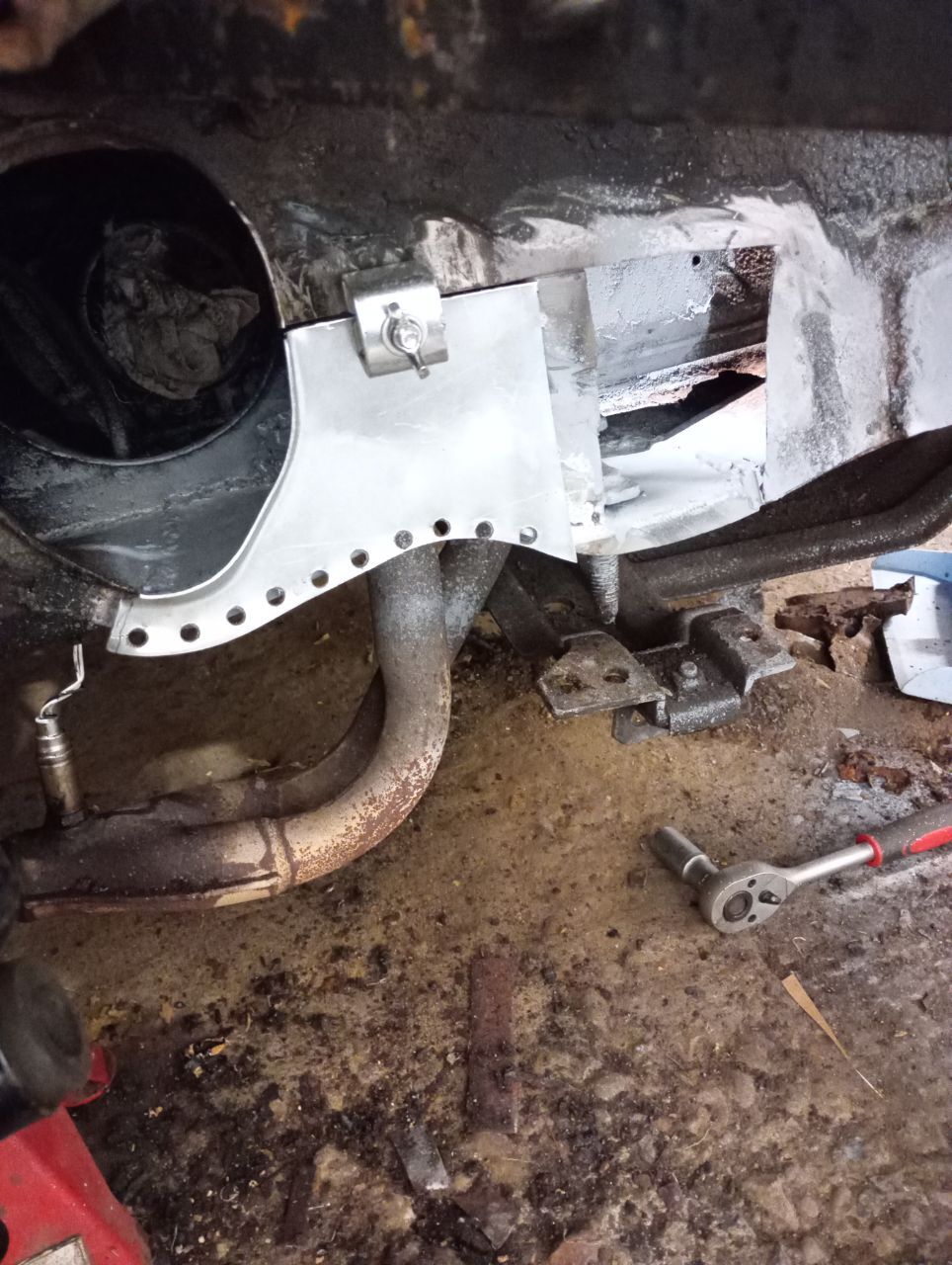

Ended up getting medieval with the grinder after some minor* disassembly of the front suspension.IMG_20251101_150751.jpg.9b6d88964140907e87cbfef9e21741d9.jpg
When you've chopped that much out of a structural bit of your car, you start to question your sanity. In order to avoid the descent into madness and signing up for a PCP on  the latest Leapmotor Squirrel or whatever, it is essential at this stage to start gluing bits of metal back in.
That way I can tell the wife it's nearly* fixed.
I thought it best to start with the bottom of the inner and outer wing as at least they weren't holding the wheel on and I could get my eye in again with the sparkly stick.
I'm glad I did as I was having loads of trouble with the wire burning back to the tip. It made for slow and frustrating going and I was at the point of getting on the phone to Clarke to give them a piece of my mind about their welder as it's only a few years old....
Quick bit of maths, actually it's 25 years since I bought it, where the hell does time go!
So, a brief interlude for a new tip and shroud and I was back in action with a lovely controllable welder again. Oops.
Enough procrastination, on to the tricky bits.

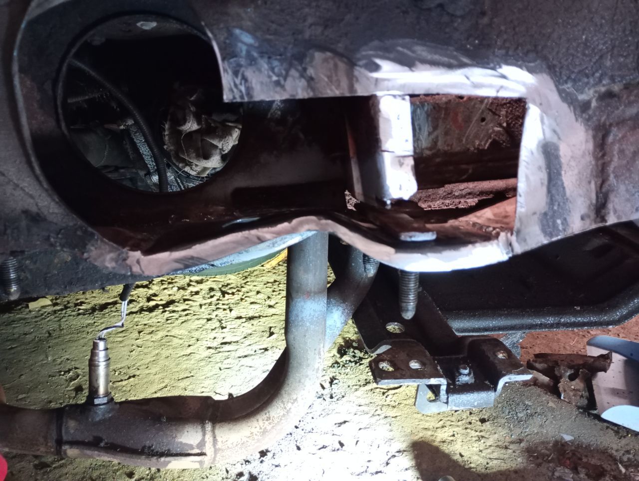

I had to do quite a bit of cleaning up before I could work out my approach. That inevitably led to a few more holes and a few 'thin' bits. All got chopped out - I don't want to have to do this again!
That bolt you can see dangling down in free air is one of the captive* wishbone bolts. Obviously it's position is pretty important if you want to retain any kind of directional control.
This meant fitting and removing the wishbone so many times my ratchet eventually gave up!
After a brief memorial service (I'd had it since I was 15!) progress resumed.
IMG_20251115_144959.jpg.6bb64b8dedec3651f28c0cd1024c8cd4.jpgIMG_20251115_145029.jpg.94920db78c20df18e7d763b008305ffb.jpg
By this stage I was starting to feel confident I wouldn't totally stuff this up.
Don't worry, it's meant to be that shape underneath. No, I don't know why. Probably the reason they bloody rot out really!
Anyway, that's where I'm up to now.

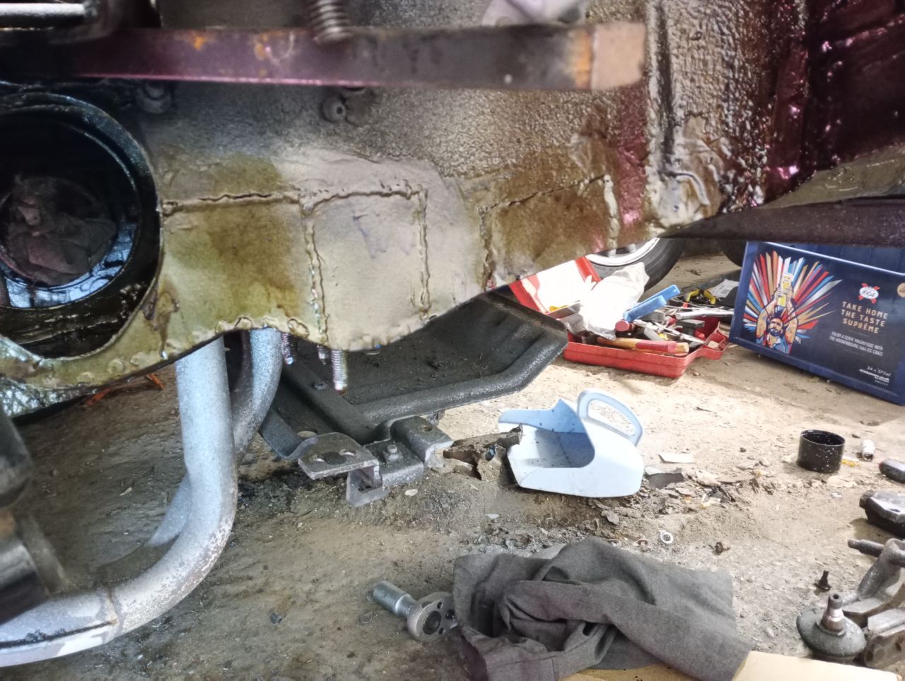

Managed to squeeze a few hours in this afternoon.
The eagle eyed will have noticed a bit of a gap that needed filling between the vertical panel and the bit I welded in previously. This required a couple of small sections letting in which was quite fiddly due to limited access.
Eventually it was ready for the closing sections, these were really pleasing to fit.IMG_20251116_141151.jpg.310fe3408d9273268b8ce18469e2c971.jpgIMG_20251116_143801.jpg.df473955f868950e432de8a87e9ed7e9.jpg
Does anyone else work like this? I honestly don't know what is wrong with me.
I actually stood up yesterday and immediately tripped up as the wire for my sander had got wrapped round my ankle. Don't be like me, FFS tidy up your work area!
I digress, the final* bit!
I've smeared around some seam sealer and will slap some paint on tomorrow.
Then I get the exciting task of reassembling it all.
I really hope it fits!

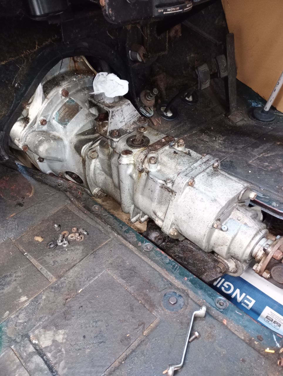

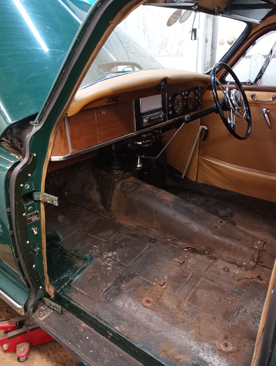

As there seem to be a critical mass of brokenness in the vicinity of the gearbox, and having seen Lankytim make the removal look easy, I thought I should start there.
Removing the box simply* requires the removal of; both front seats, carpet, transmission tunnel, clutch linkage, propshaft, passenger door (too tight in my garage), and jury rigging an overly complex gearbox hoist made from all your trolley jacks, a scaffold bar, and a ratchet strap.  You might not need the hoist if you don't have a soft office body like mine.
Ta da!

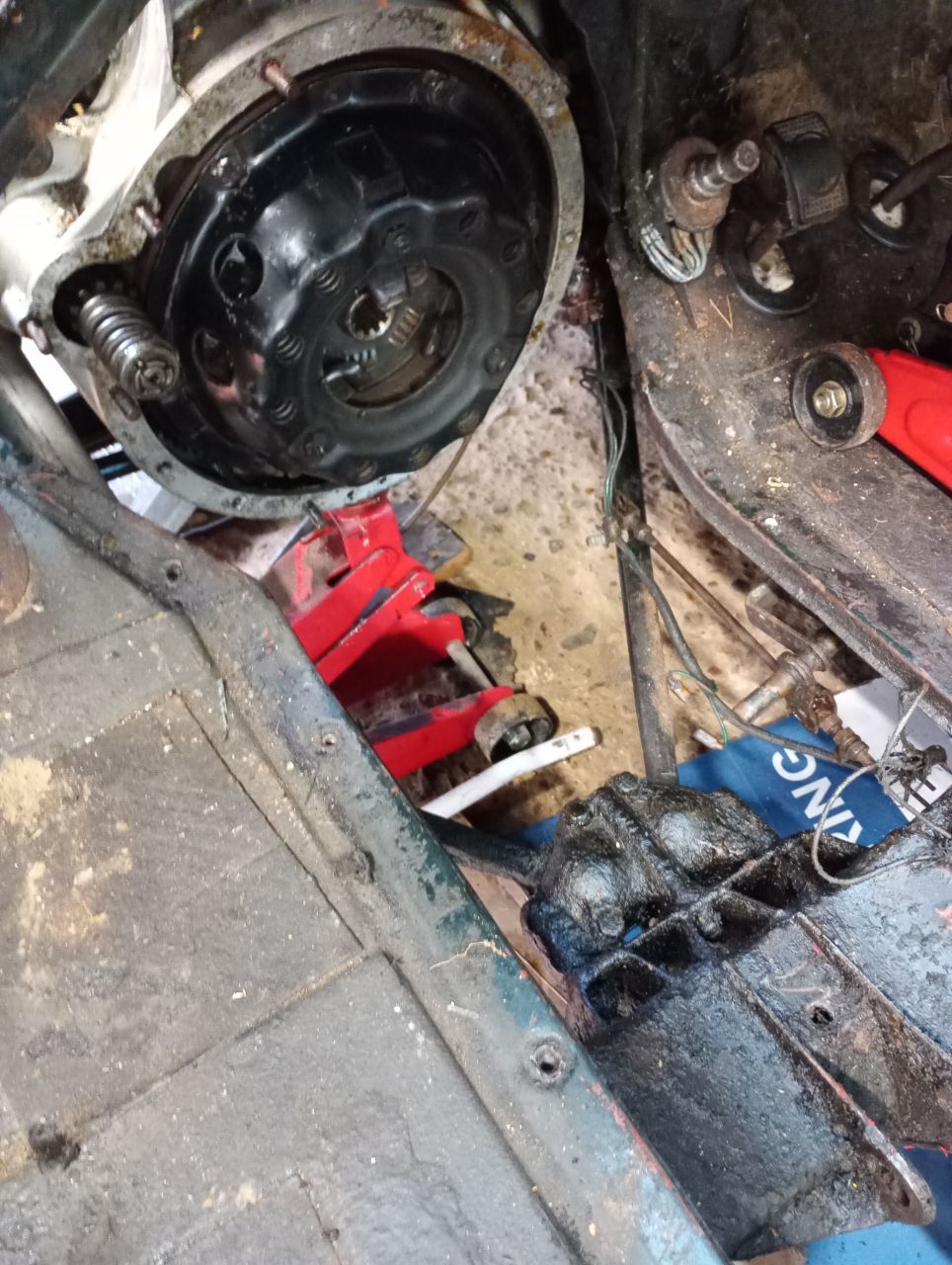

With the gearbox out, examination for signs of borkage began.
I was pretty convinced it was the release bearing making the racket when the clutch was in and cold.  Lankytim even sent me his spare bearing gratis (true gent) so I could replace it.
What I hadn't realised is that the release bearing is actually inside the gearbox, and runs in oil. Consequently it looks and feels like new.
I'm happy to be told otherwise, bit I don't think this is the problem.

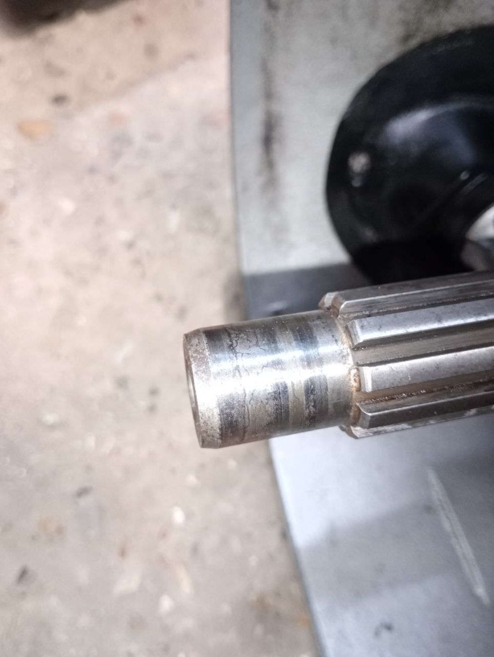

Further examination focussed on the spigot bearing.
This looks pretty rogered.
I'm not sure how, but it seems to be worn on one side, and it is very rough inside. The gearbox input shaft is a bit shiny but doesn't seem damaged, so I'm hoping it is just this bearing that is the problem.
Whilst pondering this development, I took a look at the rear gearbox mount and was relieved to definitely find one source of a problem when it fell out in my hand.
Totally fucking fucked mate. Big time.
It was pretty easy to press a new one in. Everyone needs a 44mm Citroen rear hub socket in their toolbox (even if it's never actually been used on my Citroen).
I also pressed out the spigot bearing, and it didn't look much cleverer. I'm wondering if it went in a bit wonky originally?
Anyway, I've ordered a new clutch plate, a spigot bearing and am awaiting their arrival.

Nice to see some progress on the P4, I wonder if maybe its partly the clutch not being aligned properly last time, or some flex from the damage rear mount has put uneven pressure on the bearing causing the wear?

If only all RWD cars had removable transmission tunnels.
On 25/05/2025 at 10:29, Surface Rust said:
watching countless videos of people filling orifices with bread(!) and grease and things I had resigned myself to removing the flywheel. One last look and the algorithm threw this up
It only bloody worked! Whipped it out in seconds and new one tapped in.
Sorry I'm late to this thread. But it's great reading.
Could you elaborate on what exactly your removal technique was for the centre / pilot bearing please?
It's so simple, but it relies on there being a blind hole behind.
You place a nut on a bolt behind the bearing, then stop the nut from turning with a flat screwdriver. As you then tighten the bolt against the bottom of the blind hole the nut jacks the bearing out.
Video summarises it far better than I can:
https://share.google/cp0df1vZu1YFQnJ3b
