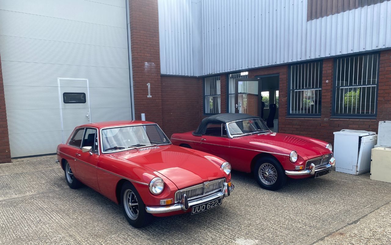

Today I took the MGB to Spencers Wood, to meet with a client who has had his 1965 MGB Roadster for 40 years. He did a nut and bolt restoration on it many years ago and it's still pretty mint. Puts my GT to shame!
In total, I've clocked up 129 miles in the past two days.
I would like to say they have been all trouble-free, however when I got home I noticed an oil leak from the differential input shaft seal. Bollocks. I'm off on holiday on Thursday so the MGB will be left in the garage until I'm back and find time to sort the leak.
I'm still having problems with my right shoulder and the MGB's heavy steering isn't helping matters. I've done more research and a lot of people praise this mod:
