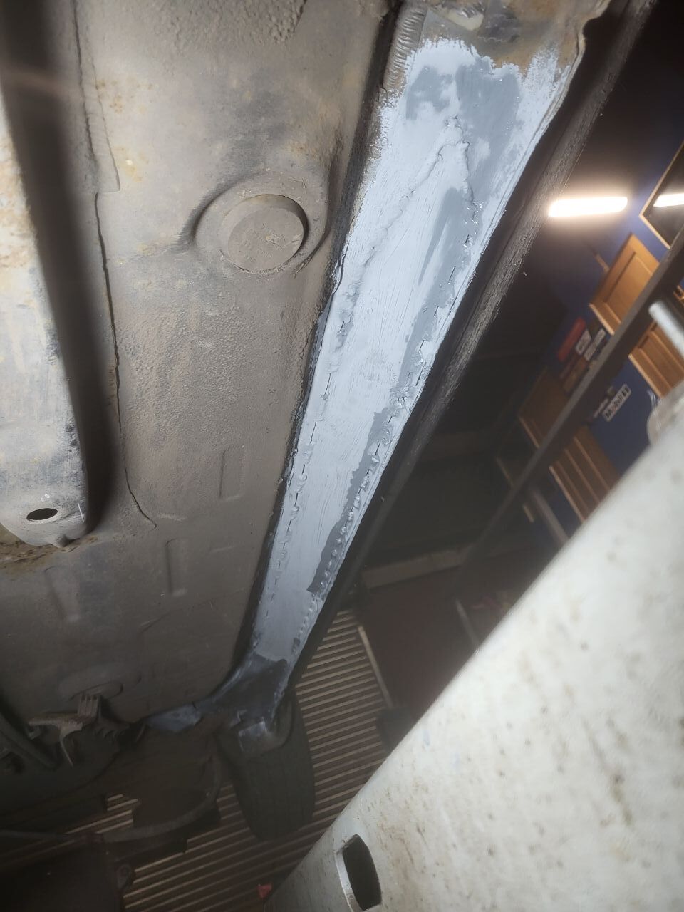

The 107 i bought got a good weldathon
20250319_202306.jpg.bc4a4249517a71d5de41c84a406bdd86.jpg20250320_192237.jpg.bf7a0dad4fe3fb4603ba90a5e8e81277.jpg20250320_191757.jpg.138f3eac900f2a8b7b7cd385a4d7e91d.jpg20250320_192222.jpg.385726b51756b5e2769f8f1c0a0444f3.jpg

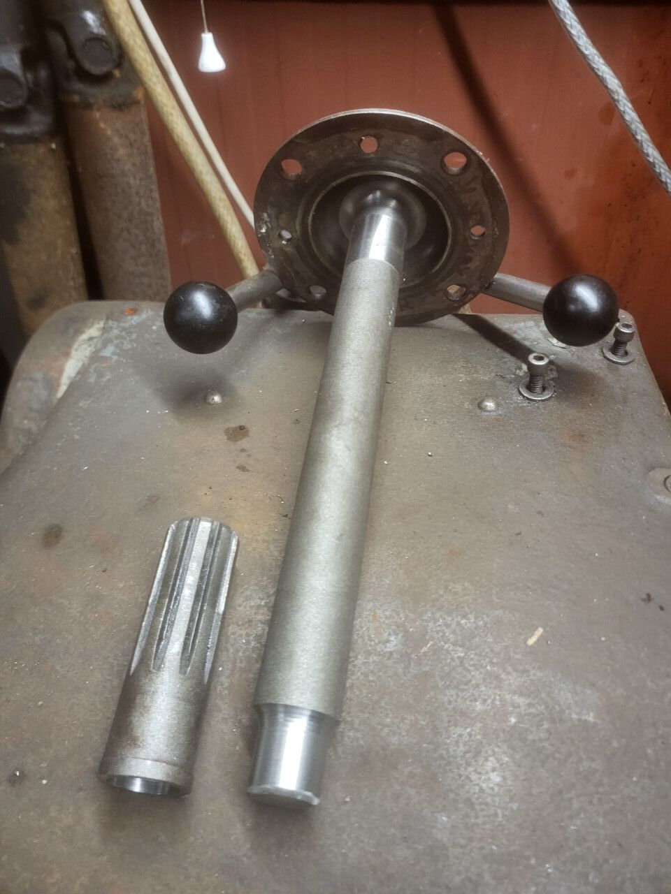

I had this transit in before for a clutch and as such it had gone again 2years later, with this being a smf conversion the disc and cover plate is not available on its own but nevertheless this time i elected to drop the subframe rather than take out the rack, i remember that job being so grotesque i still feel the pain months forward simply because the bolt was siezed in the suspension arm bush crush tube, the subframe crush tube and the captive nut in the chassis, i split open a 22mm socket, then snapped the head off, then had to cut the chassis wide open and alternate between drilling and pressimg the remains of the 160mm long m14 bolt out,,the bastard 20250326_142736.jpg.b6059745a3324ab373ad27a674a0271d.jpg20250326_155553.jpg.4b0054d93d999557a74184c15cf2a74b.jpg20250326_170327.jpg.c113e7e9d776d89a48fe0a6db45eb3be.jpg

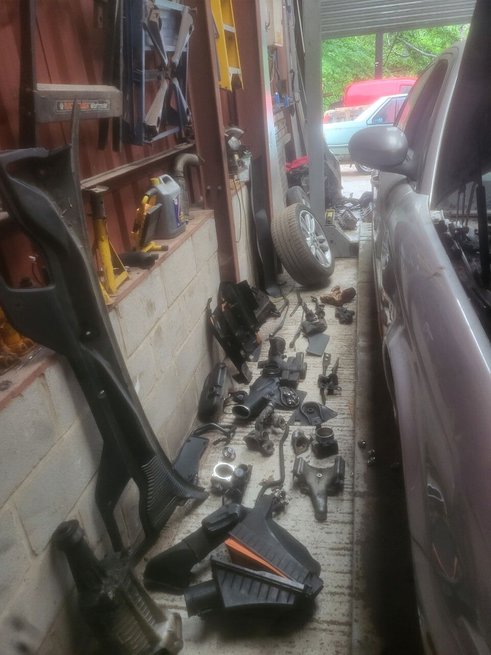

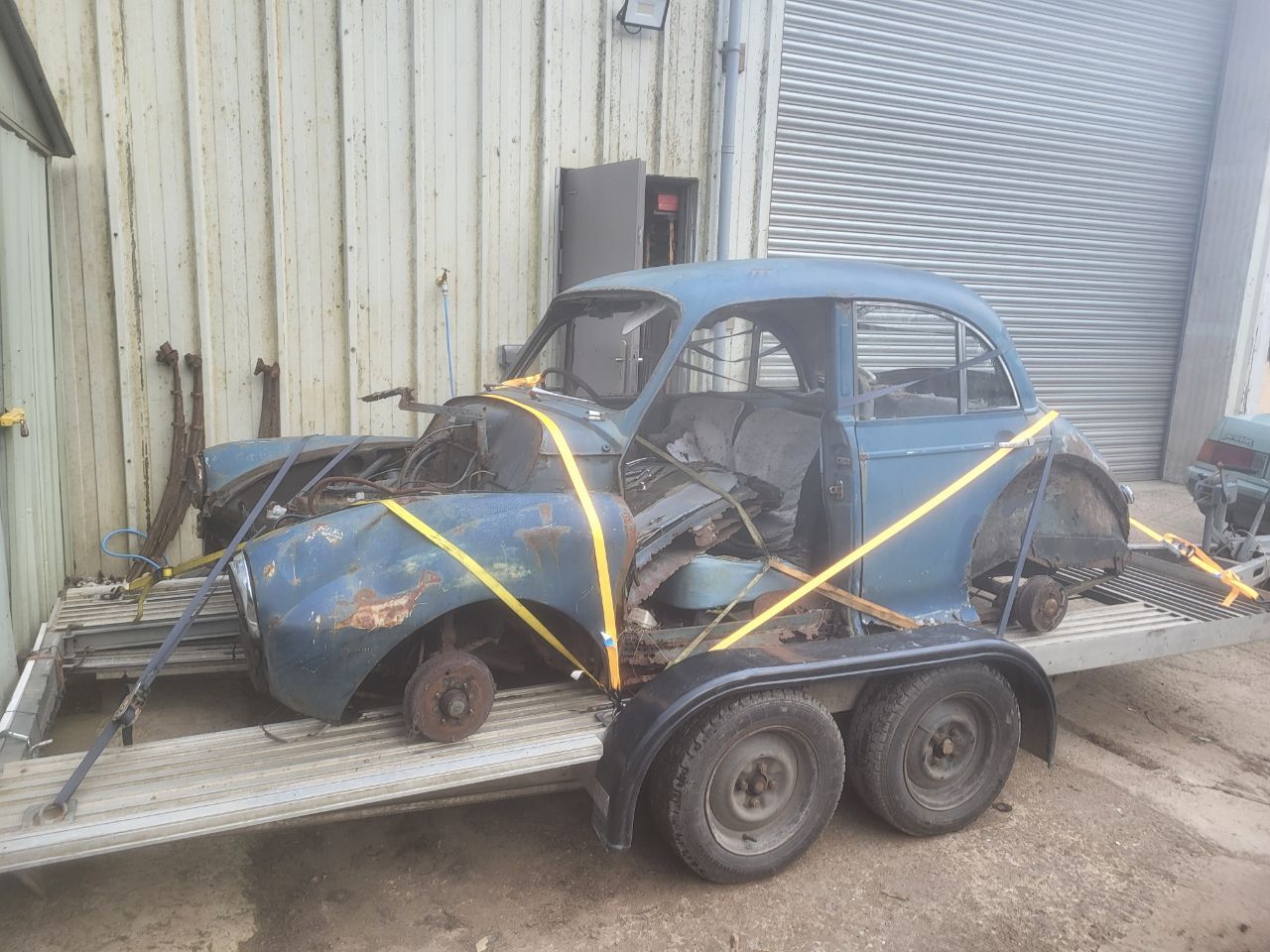

A third minor came along and was promtly stripped for parts which almost everything from it went quickly
20250331_144800.jpg.bd0e7ec4d43a8cd05934463afd3efe2b.jpg20250331_195522.jpg.15675484b4bf8511998c621288813c9d.jpg20250331_201050.jpg.5626544ec076c429461809ac5d2de0e6.jpg

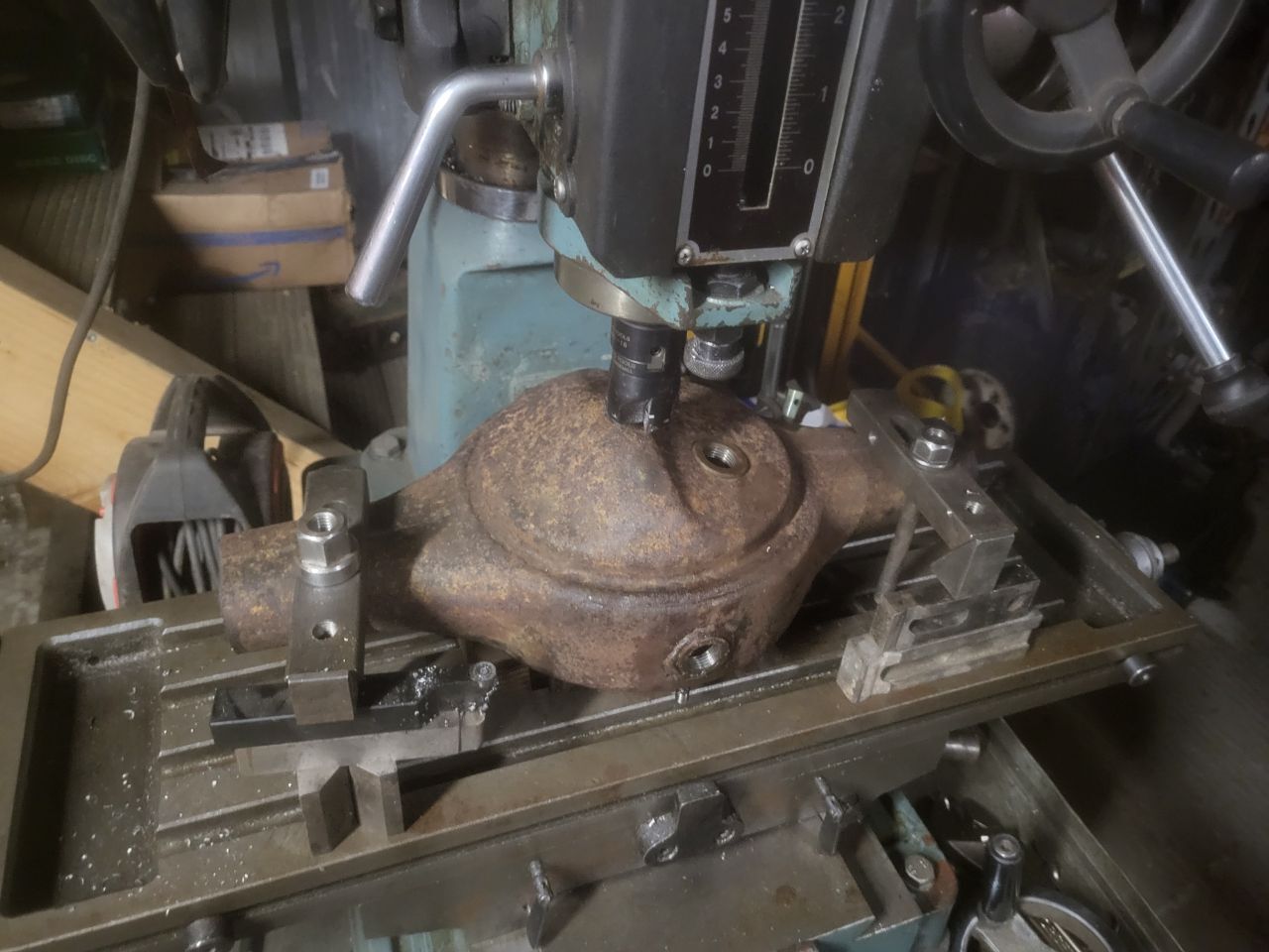

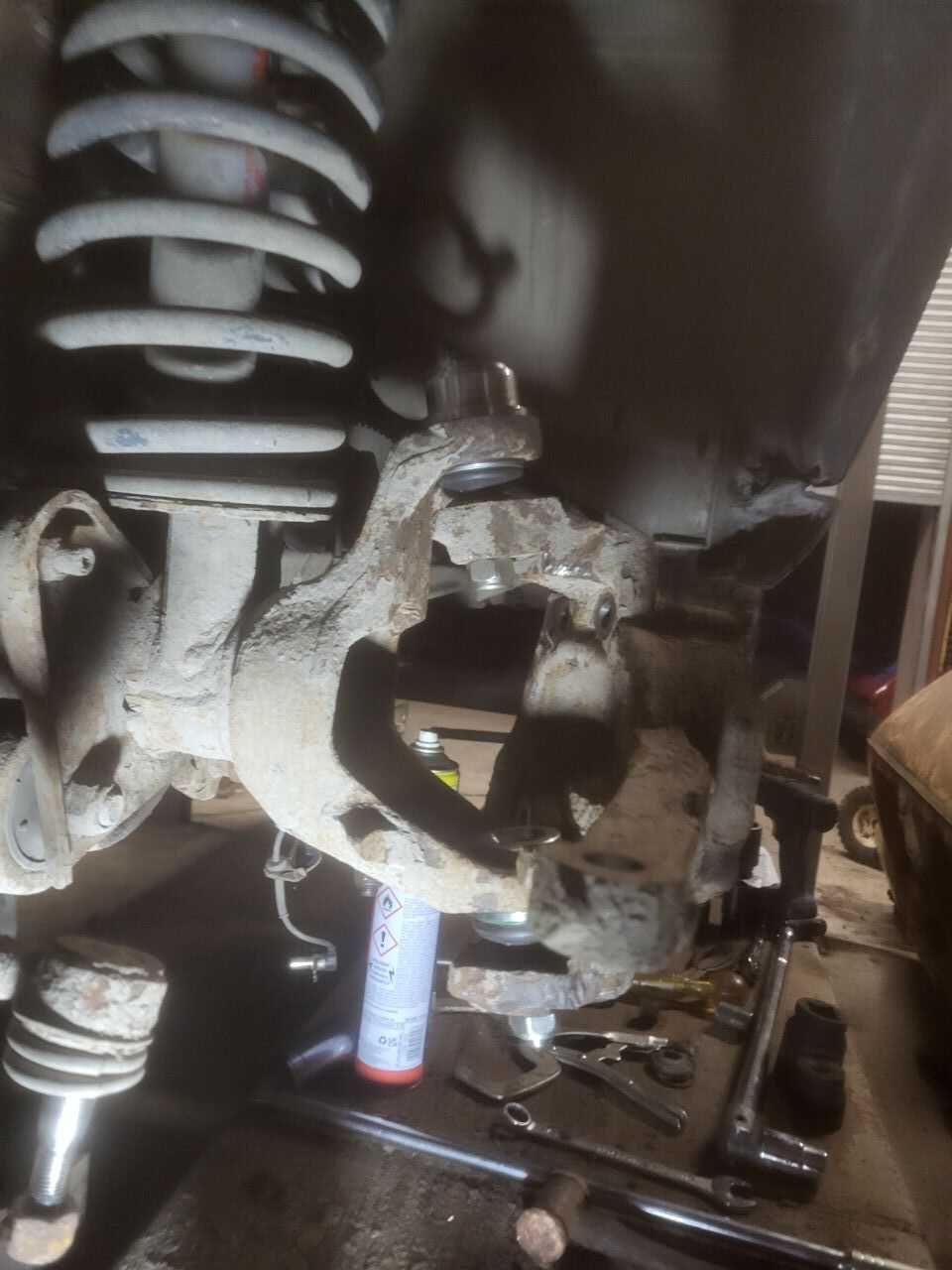

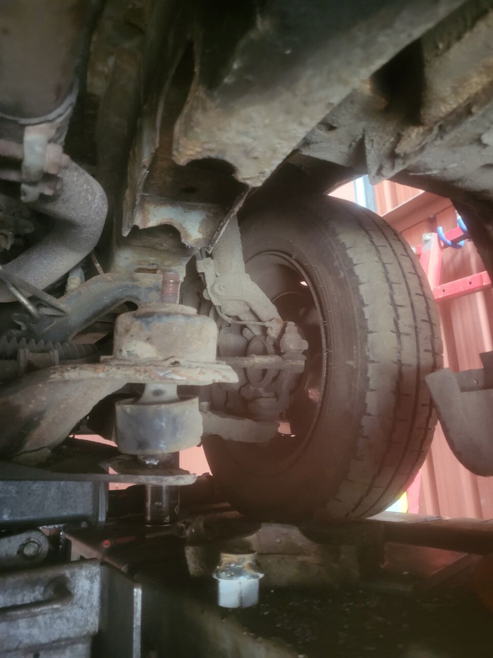

A disco 2 came along for swivel joints, and as typical the design of the castings are the same but different to the P38 so i had to modify the profile of the mandrels further, also of note the wheelbearing was shot so i got a britpart one which warned of abs faults if i didnt recant some sort of spell, sacrifice something or other wiring wise, so i pulled the sensor from the old hub and just fitted it in the britpart one which worked no bother!

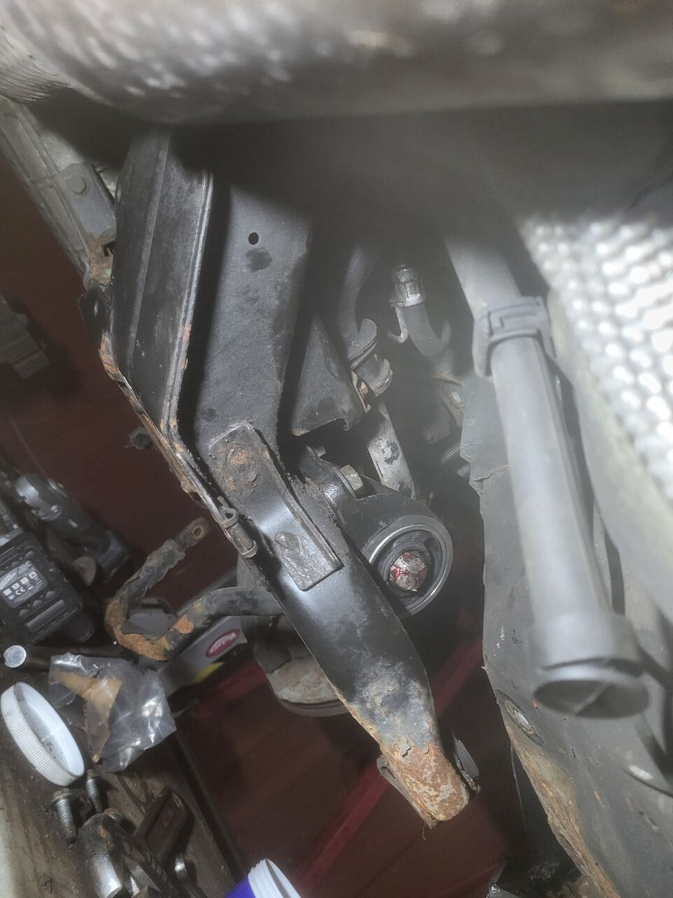

A mk2 mx5 sill required some basic repair work as they all seem to then a boxter wanted some bottom arms changing and of course theyre alloy which meant no hammers allowed20250410_192034.jpg.17983a63b07f45e9fec02d4a3fc4c044.jpg20250410_192058.jpg.190ea6c98fa6517bc04f9bc788e44a0b.jpg

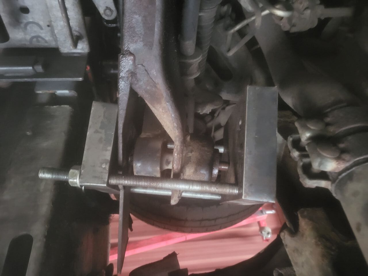

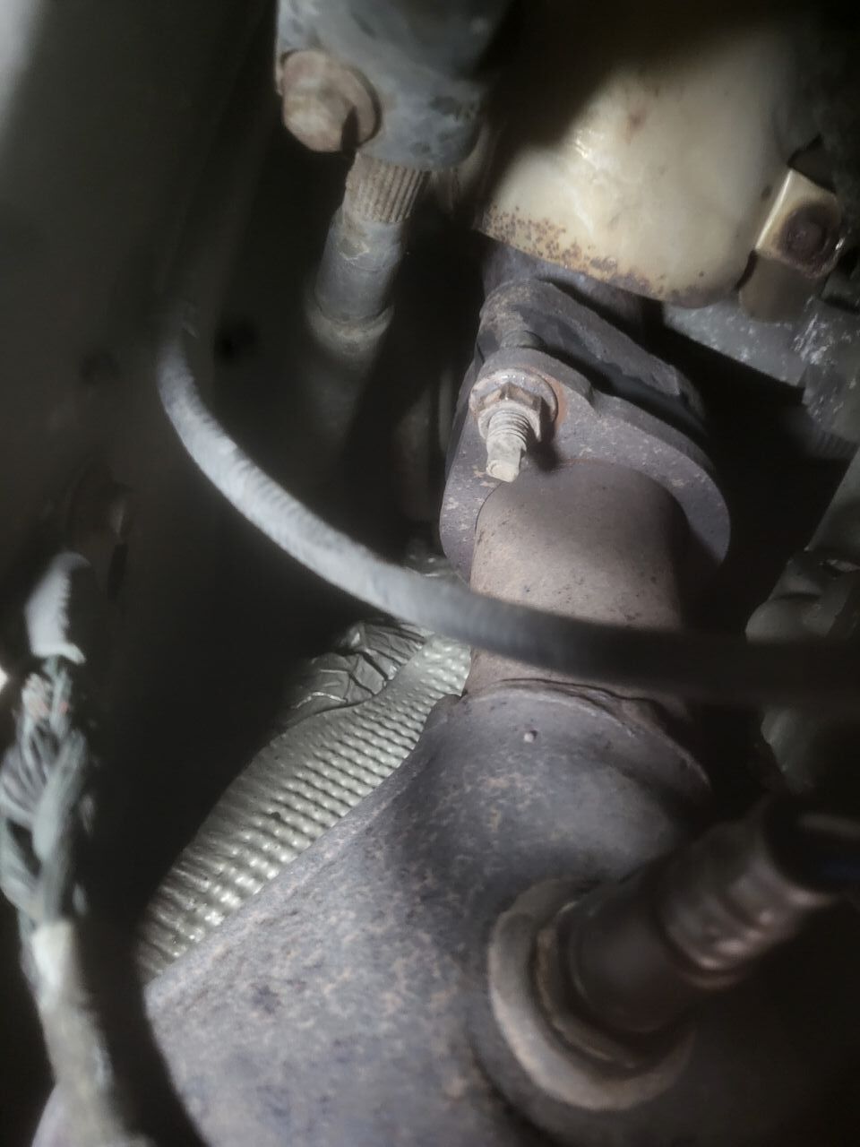

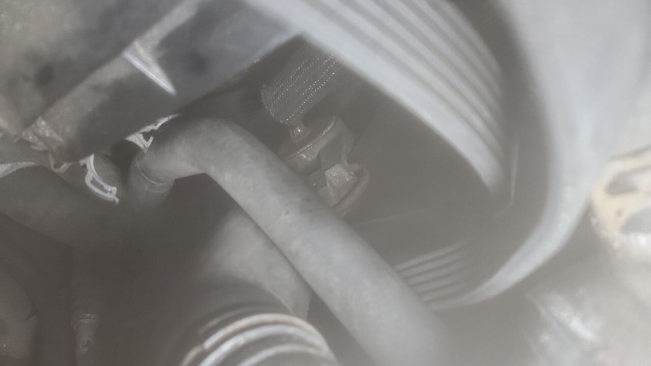

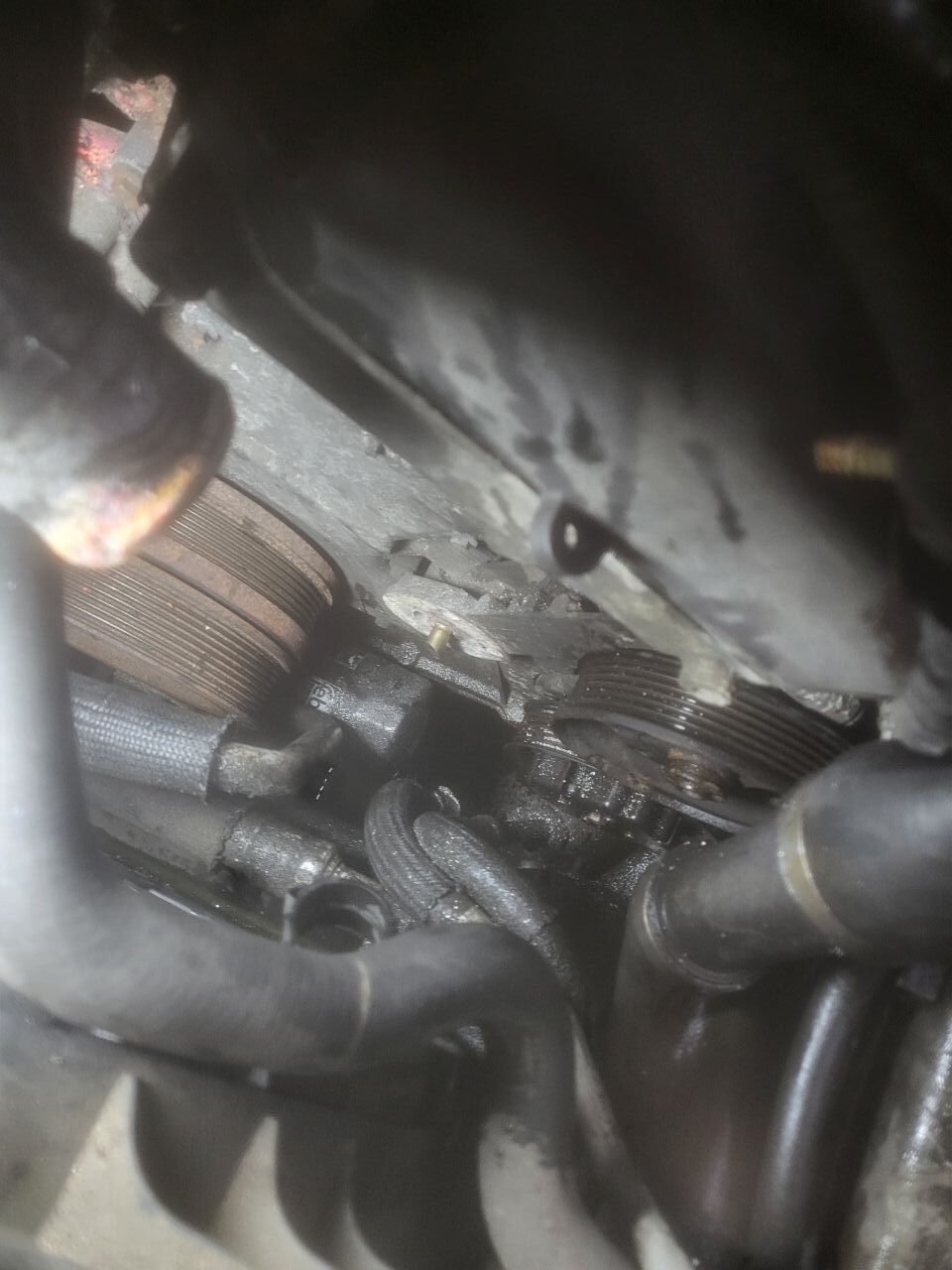

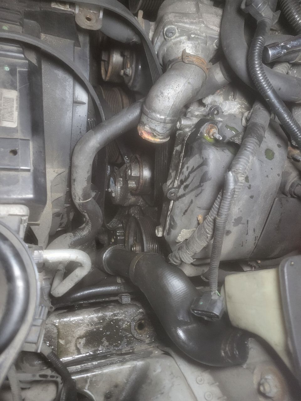

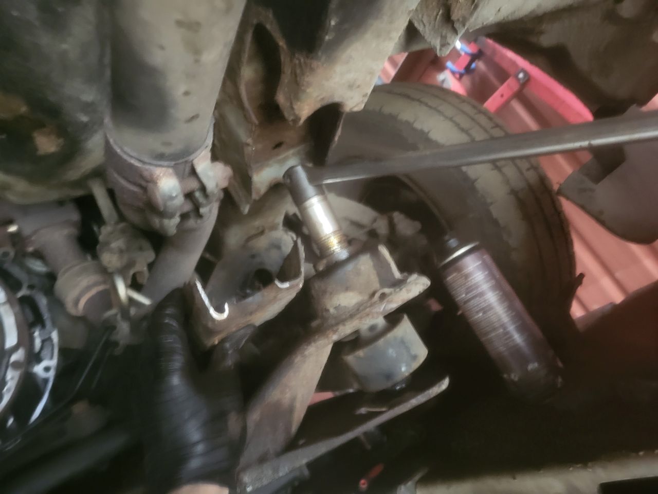

Then back to the jag which wanted a drivebelt fitted, unfortunately the thing is buried in a vault of awkwardness so in typical form i tried to get the belt offby struggling around all the crapola in the way IMG-20250415-WA0005.jpeg.240965225f2c6c5cf25a589300c16097.jpegonce this scene was determined to be beyond sensible hope i took some bits off to find the next conundrum, the belt is captive behind the tensioner so that has to come off20250415_182037.jpg.ea64df5499294e45c69e3920b94e3b23.jpg
Theres the bastard there with its 13mm way undersize bolt head and being steel on alloy the friction was almost like bonded fusion 20250415_183057.jpg.16d766b405f3ea5d04c88c25789d6fd3.jpg
So it got cut off and removed for a replacement m10 bolt of sensible design go hold the fort

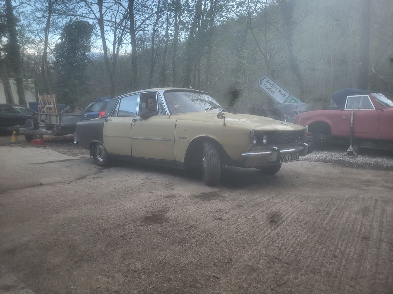

Then we bought this 71 2000 to replace the proton as a tow vehicle however its taken so long to get it to run right that the replacement process is on going, so far its had the head off, clearances done twice, valves seats messed about with, temporary fuel lines and tanks fitted,the carb looked at multiple times  exhaust fettled many many times and alot things that didnt work, vibrated and clonked sorted out which will become more apparent as i catch the thread back up, the current verdict of the p6 is that the steering box and the unrewarding when revved 4 cylinder engine is abit of a let down for otherwise a brilliant car, ive loved everything else about it, particularly the ride and broken surface cornering
That rover is great, be a brilliant advert for your business!
"You know, that bloke with the Rover P6...."👍
Glad to see the P6 is running again, rather than us juggling buckets of fuel underneath the car 🤣 Looking forward to hearing how you fixed it.

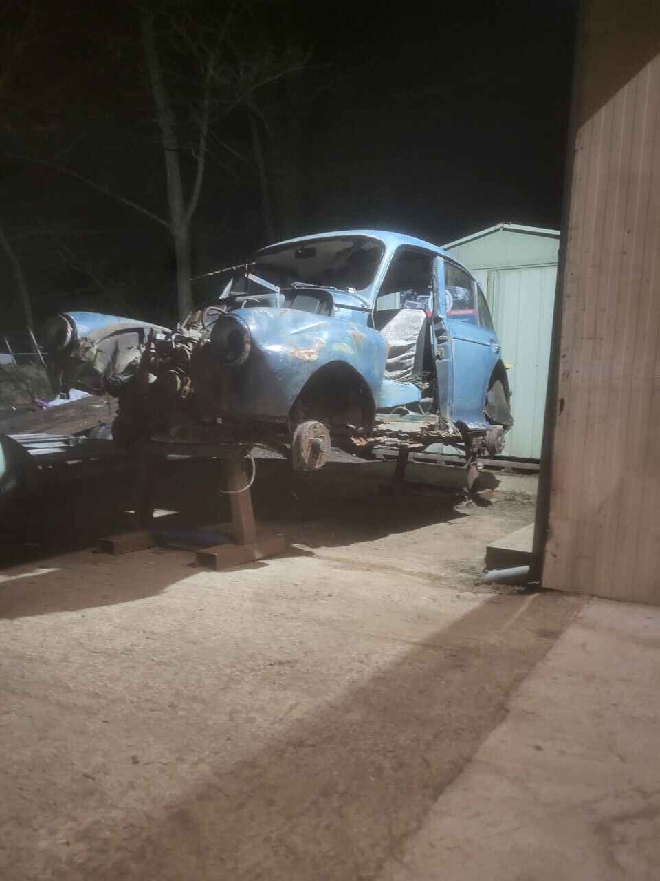

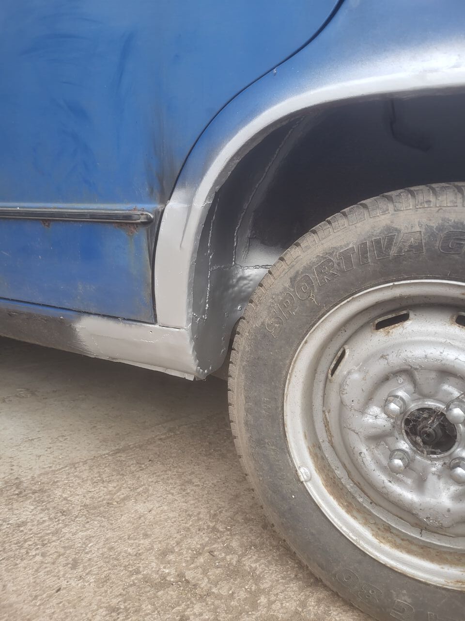

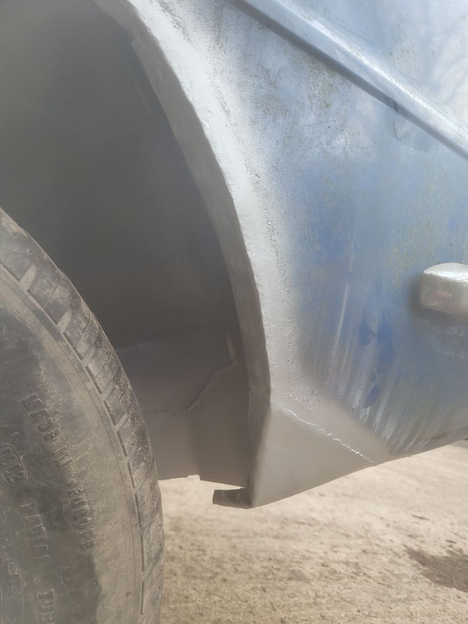

This is about May so the start of summer, i made some basic start on welding the k10 , the sill wanted doing but the wing was annoying me way more so i made a template and bashed some metal roughly correct for it , the wheels got blasted and primed ready for some new uniroyals, ive since worm  out the fronts completely and worn the subsequent tyres out20250516_174144.jpg.5cea8d08ad18d3c33847caf79c8907af.jpg

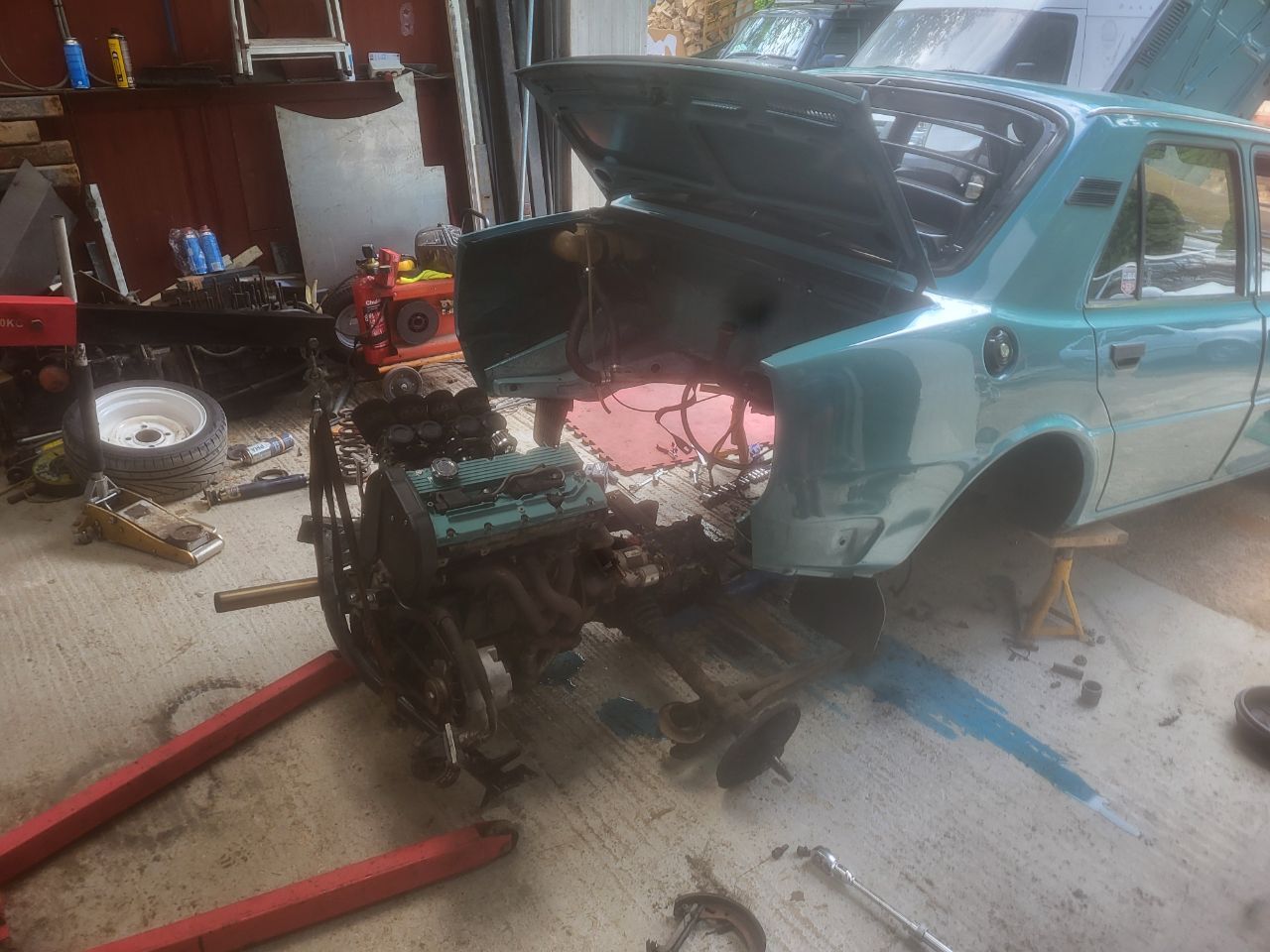

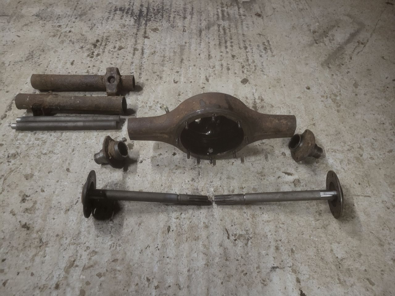

A Pals skoda came in for a conversion to semi trailing suspension, a 5 speed gearbox which was abit like when a bag of pasta is unexpectly ripped open and all the esoteric minutea spills out into  every step , powder coating on faces that need friction/tolerances, missing narrow form washers, silent blocks squashed into forms that needed matched to position, a gearbox that had thicker webs so the K series adapter plate bolts all needed changing and heads clearanced for, floor needing a special extra plate to clear the 5 speed nose cone and on and on it went
old swing axle and 4 speed coming out20250519_134021.jpg.9818adeecdd2d7001f94200e24cb4837.jpg

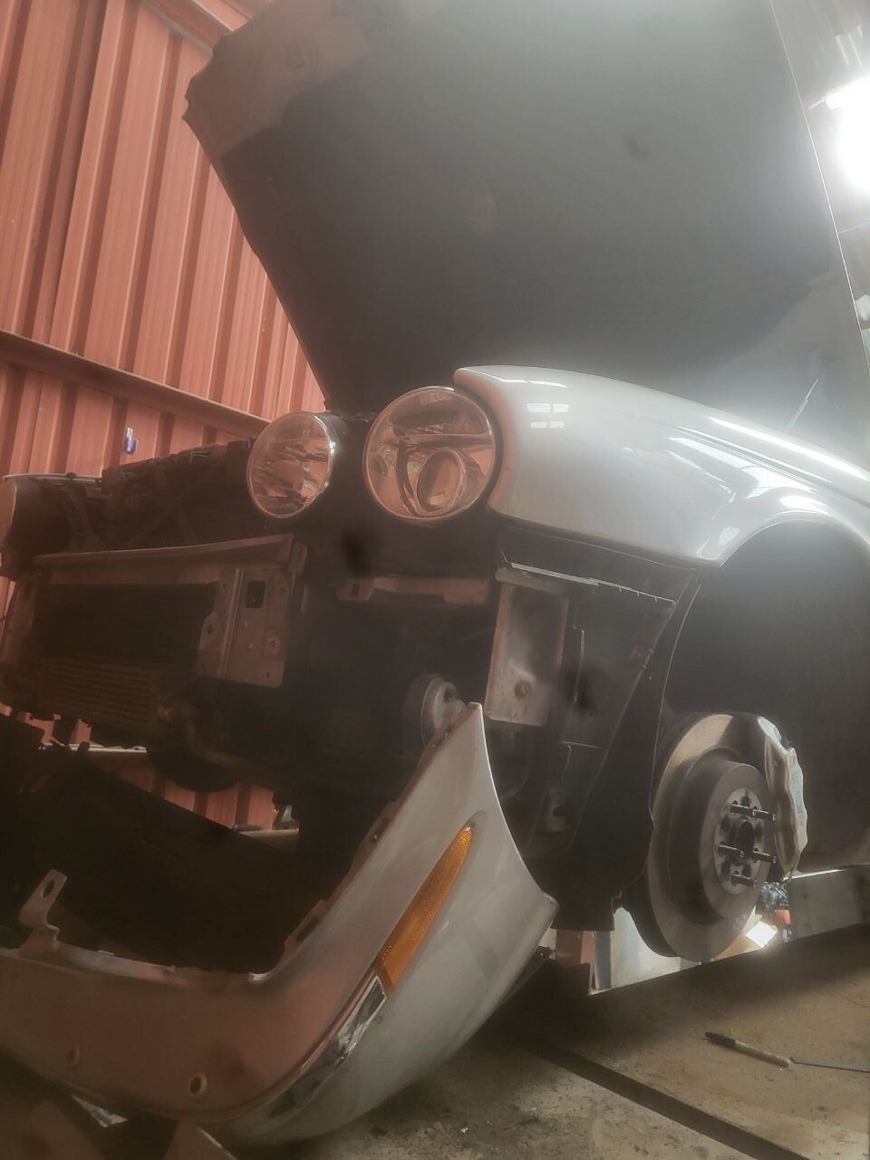

Then after that the jag of many challenges went for an mot but choose that moment to rain coolant all over the ramp , the hoses had all taken on a charcoal like feel so after a short wait the pipes tipped up and 25% of the engine bay was evicted to get at the 'valley pipe' amongst the other 12 or so20250519_161905.jpg.19b8f5d205b7b3b451d9416318e0b3a9.jpg20250527_163019.jpg.6a5c7631464e37c434241d39a9ea6a4d.jpg20250527_163025.jpg.ccb750bb082ef9d00331366c8c44fbf2.jpg
This felt like difficulty was deigned into this by way of everything being massovely in everything elses way

Fancy talking me through how to get that bumper off.....
...guess what I need to remove to change the bulbs, fix the earths, and the new bonnet release cable 😭
Prepare for alot of WTFs , alot of the 'captive' nuts siezed horribly so there is alot of bits where cable ties have substituted gaping holes left by spun out nuts, basically the top cover and grill come out via those plasic pop rivet things and snap apart clips, then there are some intact fasteners in the front arch to undo, cable ties might be able to be left in place at the bottom if only releasing the bumper top edge abit  , the joint at the wing requires a level of what feels like inapropriate violence to pull out from the snap clamp , then the headlights have a push down button to release the rest of the bumper hopefully to reveal whats required
Thanks @Jikovron will give it a go. Then I need to work out how to get out the headlight unit, hoping thats some simple bolts that arent seized🙈
