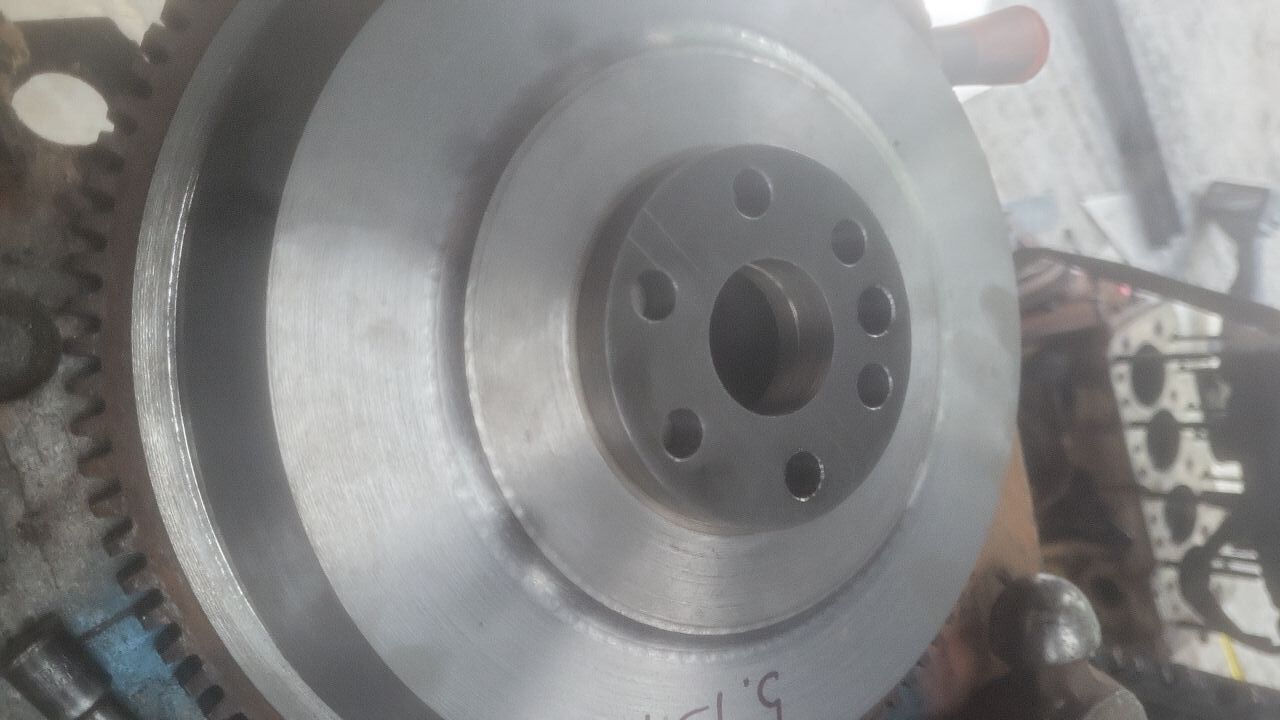

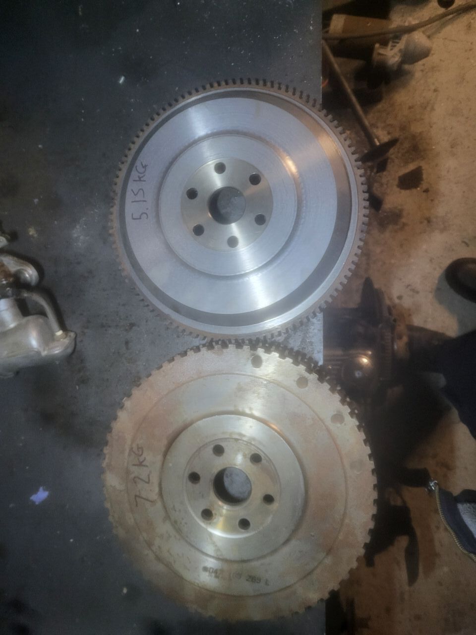

Then a chap reminded me that i needed to complete his rover K series- skoda estelle swap so i got the lathe going, reminded myself of the dangers of a big lathe and ripped 3kg off the outer edge and resized it for a rwd estelle ring gear rather than the larger id one it came with 20250606_000140.jpg.407d7e1eae3c351c29a62f65e6c72369.jpg

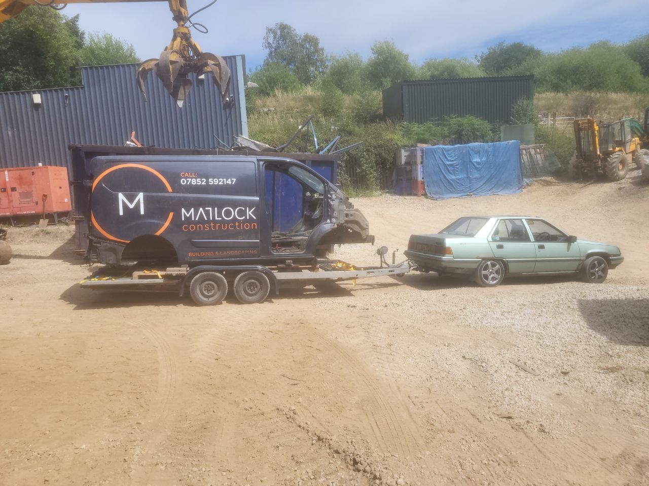

Also we broke up a transit custom which had turned on its side, then weighed in the shell , whilst it looked overweight it actually was on 10 over, 680kg for the shell on a 330kg trailer 20250704_143128.jpg.38e7cabab822461130aecbe6d5938e8a.jpg

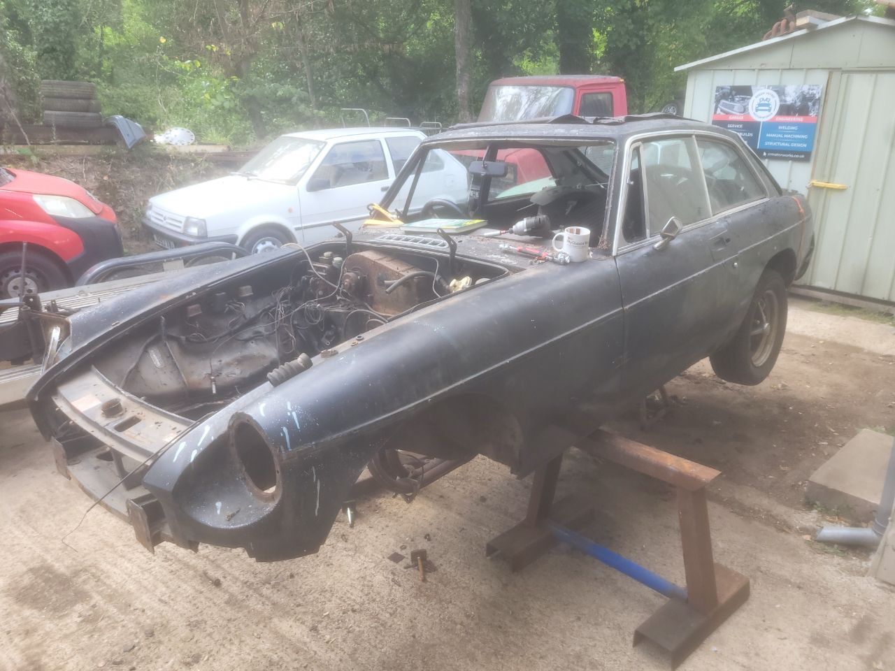

Then we bought and stripped a knackered mgb which everything sold fairly speedily20250705_170230.jpg.e015b3b71422412d9841b6f76ff4a8e5.jpg

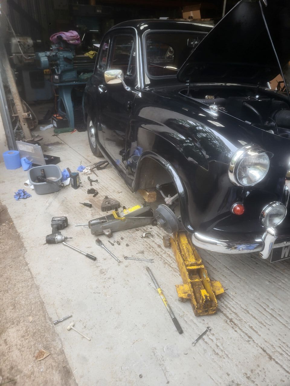

Then we got some real work in which actually isnt that common, a clutch change and oil seal swap on a A35, the 948cc plant was actually slipping the clutch!!! 20250708_132344.jpg.29971335cfea8291f46f5fcc8295f834.jpg20250708_153245.jpg.bac9828c05681ad1e383b5f553380f03.jpg
note the thickness difference20250708_153255.jpg.68dfca248e2da22b6bf7e5292b0878c5.jpg
Of course initially i removed the gearbox, then couldnt get the box past the steering rack so whilst the arms gradually failed in the task i racked the mind till i remembered reading in a sprite manual 25 years ago that you had to rotate the box 45 degrees clockwise to let it come out!

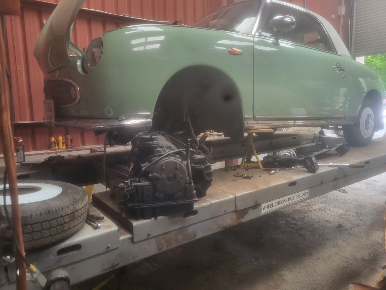

20250708_210619.jpg.eecdbbda55c52714186375a3cb484b66.jpg Then straight onto an auto box swap on a figaro, thos was tense as the gearbox turned up mad late, was missing the torque convertor and had abit of the bellhousing missing,  the symptom was the gearbox slipping horribly so it barely moved, i couldnt be arsed dealimg with the 'reconditioner' so just said best to swap it really, so it was swapped over anyhow and thankfully it drove excellently !!

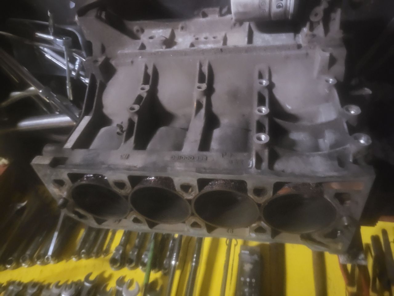

I made a start on rebuilding up the K series engine for the skoda swap to hopefully minimise the issues that often afflict the otherwise excellent power unit in this picture i was checking the liners for wear and height20250728_222330.jpg.406029ccb4f845cc1b234d6e2e424af5.jpg

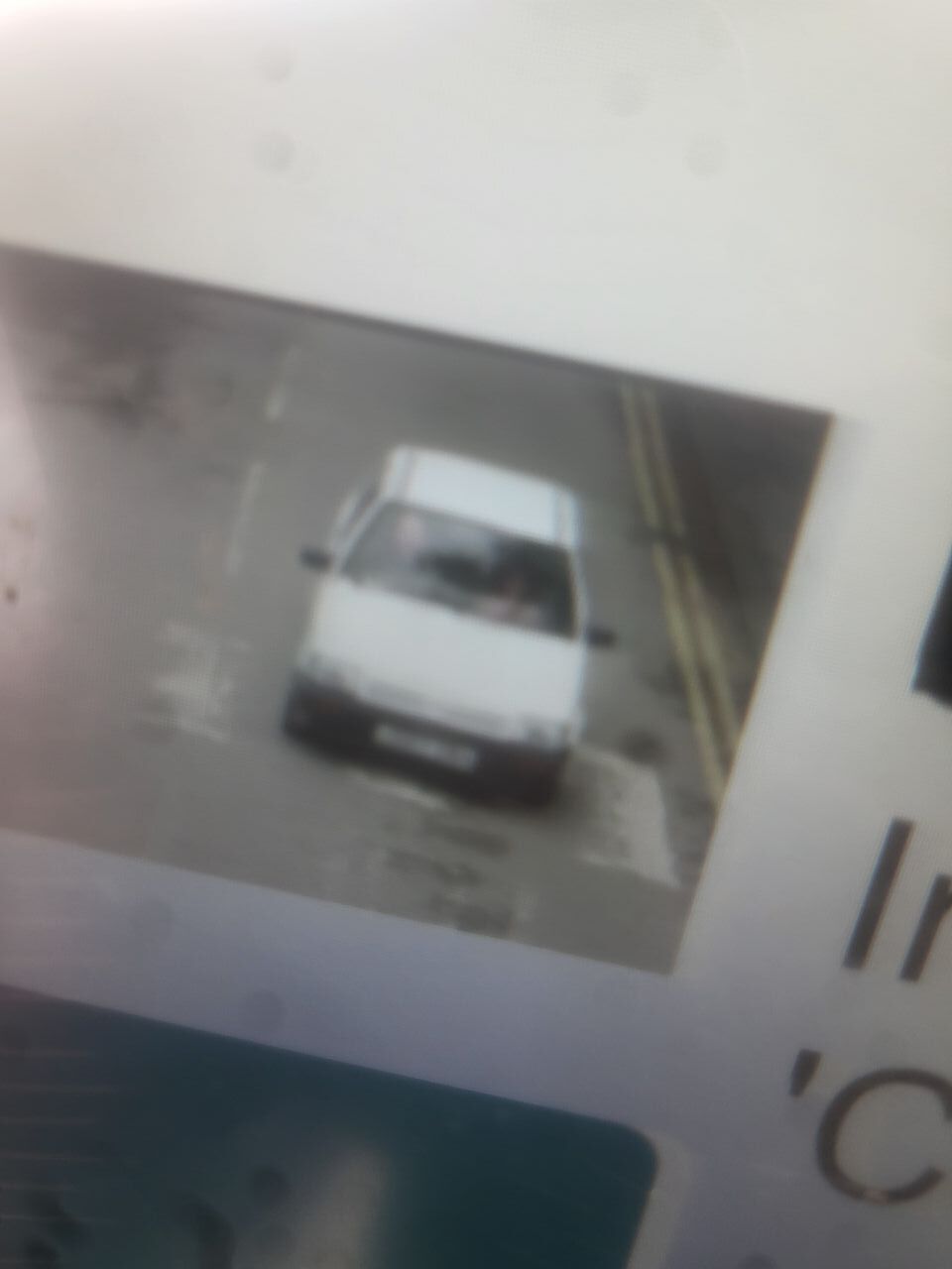

Also i visited Carsington water and one of my favourite features was the image it took of the car, so being a insufferable dad i pressed my face on the windscreen and encouraged the kids to do the same , unfortunately the picture isnt that clear20250730_114507.jpg.a523ec35ef6c4c5a23a605fcaa70d063.jpg
Bet it's clear enough for them to fine you for wrong parking tho! 🙄

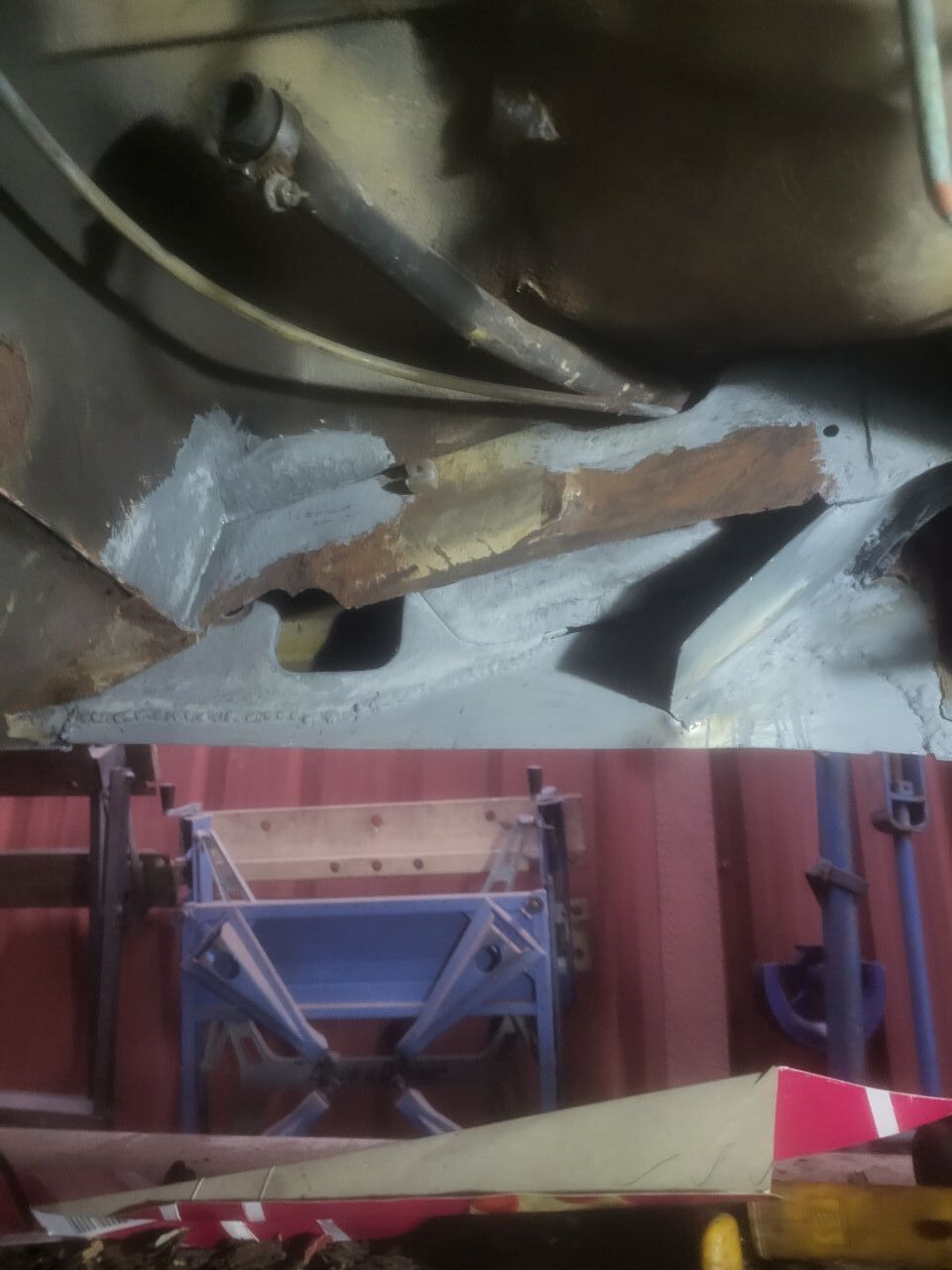

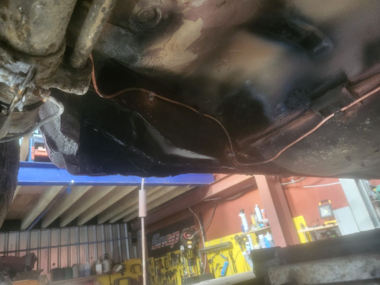

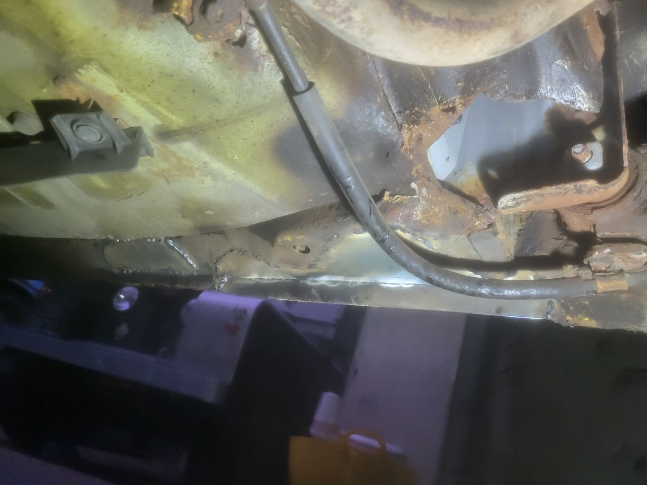

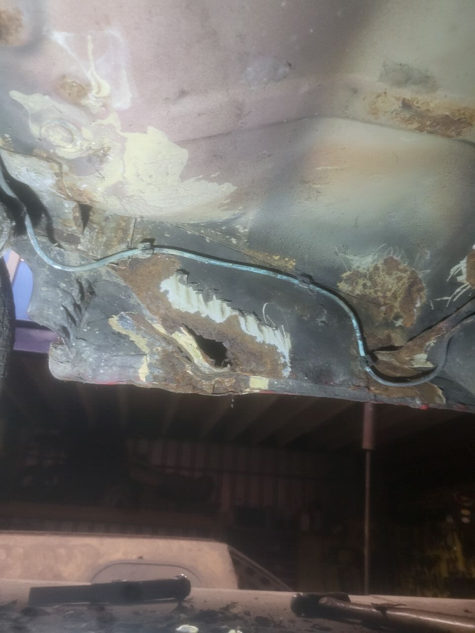

Next up the 205 diesel which i thought was clean actually had alot of daft bits for rot at the back of the sill and in the front inner arches so after some chuntering and laudable language i just dropped the fuel tank and got on with it 20250807_192813.jpg.5f31f873ccd3283797f7b6ca3f2c320b.jpg20250807_192804.jpg.259f8580b9a23575e4d86fad93b397d6.jpg20250807_211655.jpg.5367da33343f94a848b3784945795bab.jpg20250807_211701.jpg.38ec9ba14b58fcce649812500881bcb5.jpg20250809_180704.jpg.6295d92a2ab28310397637b9e182130c.jpg

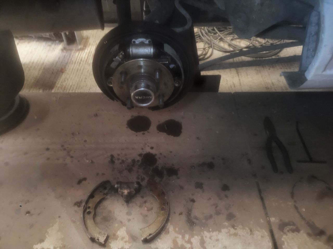

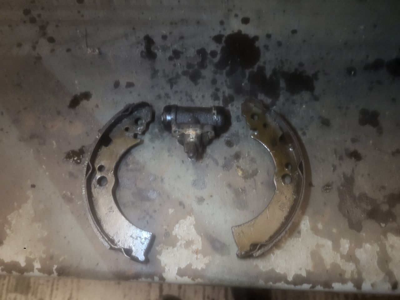

The best course of action i felt was to just get the worst bit done so i could weld the other bits with the car still mobile at least which was good as the k10 micra brakes started to spew out fluid from the wheel cylinders, these had objected to being put back into use so i rebuilt the drums with new everything 20250813_202206.jpg.5f6c6664231c8abe96f035ed9f8493d6.jpg20250813_202201.jpg.51c7e6d7aa0cf257639399cb757c4e7d.jpg Straight of the back of that the A35 came back to sort a steering box which was leaking ep90 all over the inner wing etc20250819_153617.jpg.c3f4df231b56d17eefbb8dd6abfe3b43.jpg

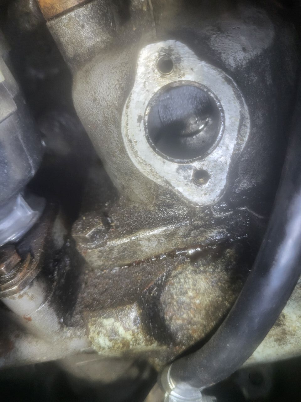

These have a combined box with column so its a dash strip and suspension partial strip to get enough space to withdraw the unit 20250819_153658.jpg.8df0f720f482466013ebb4469f7f657c.jpg

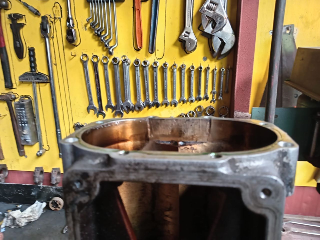

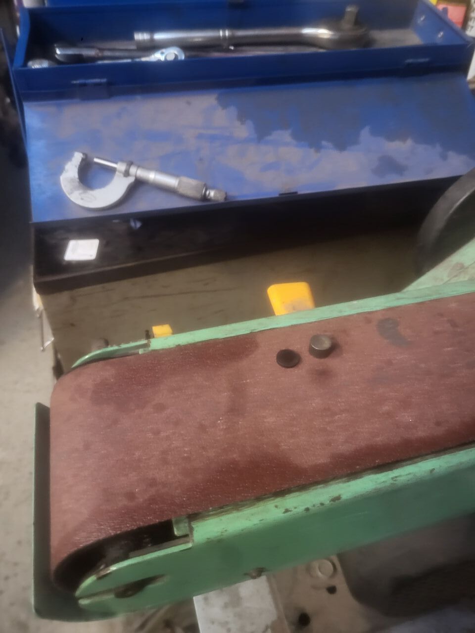

As noted the cork ring gasket was shrunk, and the surface looked like the moon with craters all over, so i covered it in superglue, them smoothed it back with emery cloth such that smoothness was achieved, also the club had some tiny lip seals procured which sorted the leak no bother once reassembled and the lash adjusted

This rot box came in for a 'quick' weld up so i got started ! Suspension mount and its connection to the outersill was cut and patched over with a view to working decency

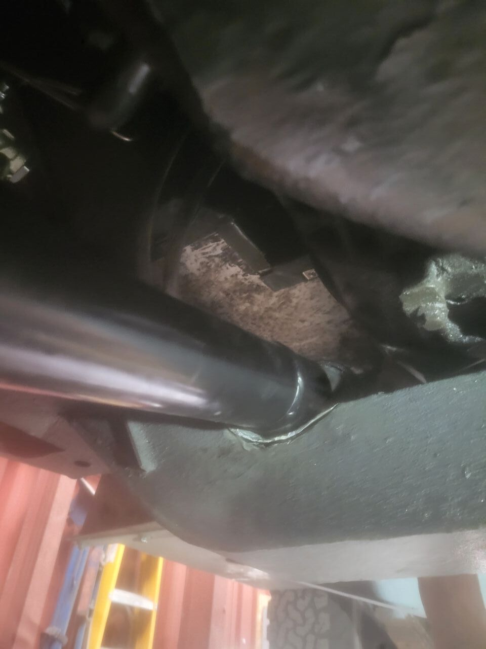

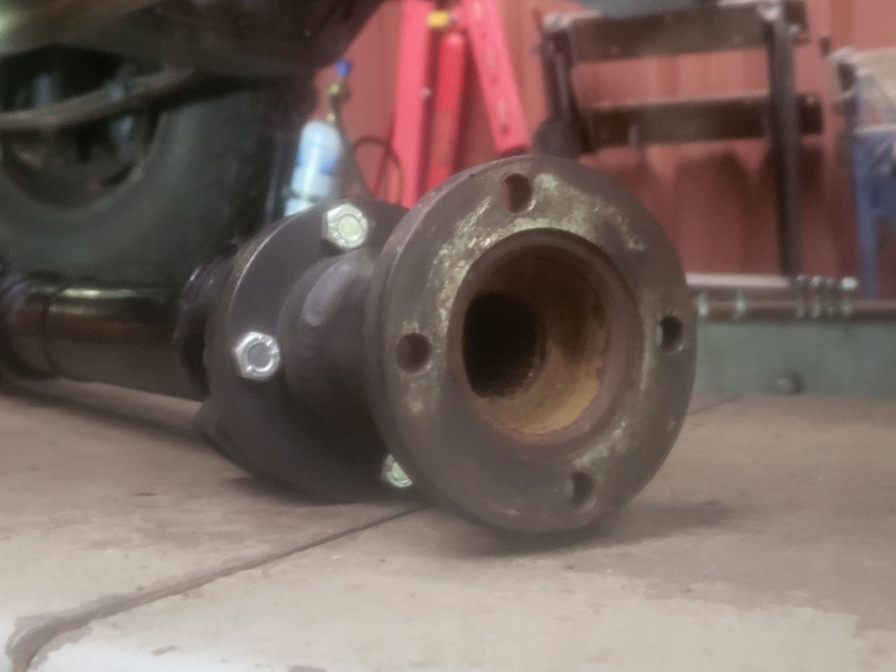

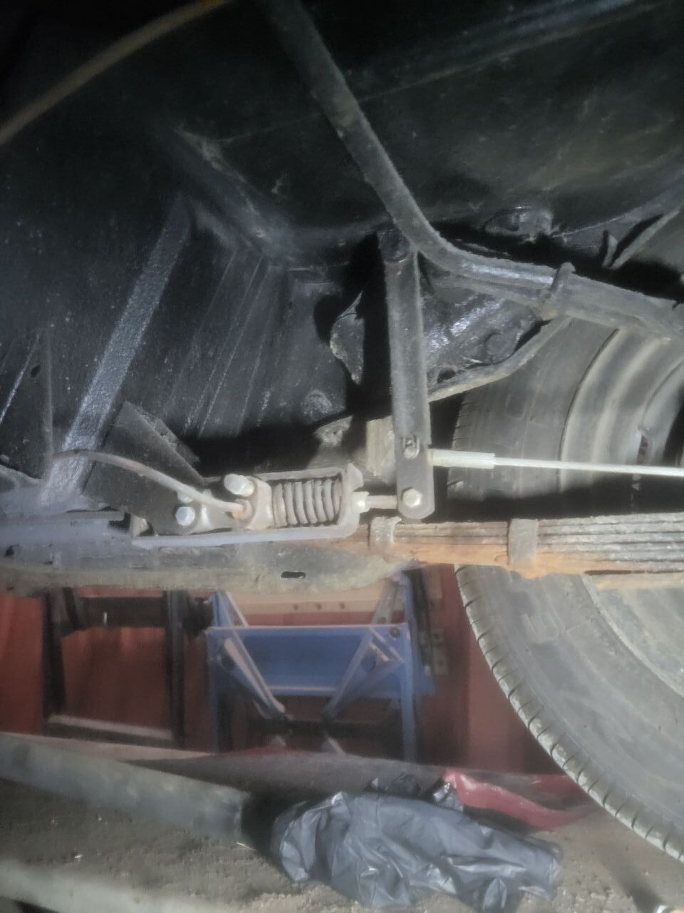

Next up was the S2A landrover back in for further mild tweaks, id suggested the short prop with a 100mm spacer was abit hopeless, and give it was made from 2 axle flanges and centered on the front only by bolts was alarming, so a longer prop is in the offing, however as the chassis was to interfere with a longer prop i cut abit out to clear it 20250822_161320.jpg.525241c14d1b7152f8eb80ca88f00de7.jpg20250822_161518.jpg.f087cd5b15719b3299a94b4d8fc3da5a.jpg
Then as the lt77 only allowed a 16inch prop at the back the angles where bonkers so i dropped the axle to fit some wedges, then didnt as he wanted to try other possibilities !20250822_213610.jpg.20450a41ae3f44f280a3151b6a8b6489.jpg

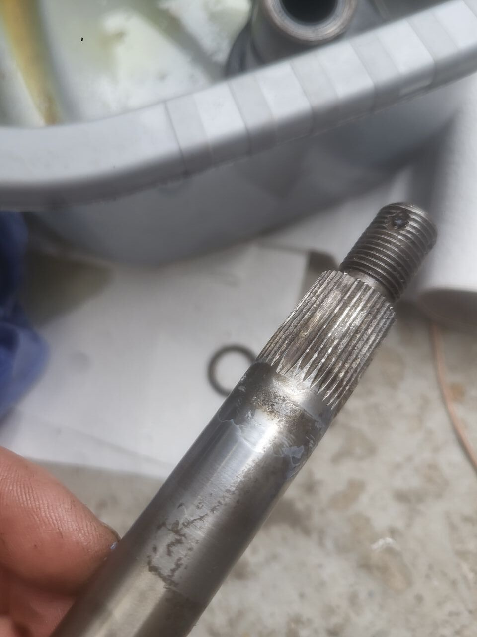

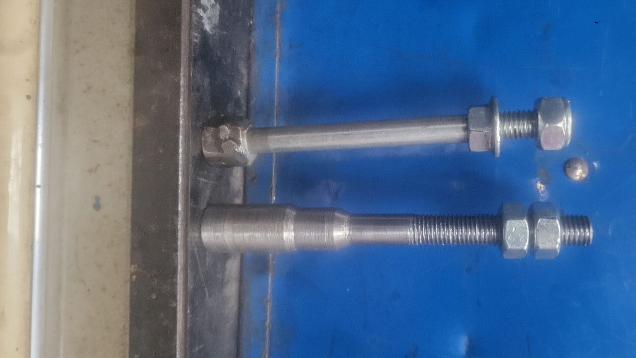

we made a new Hi/Lo selector shaft which meant buying some bsf taps and dies to make it to his brief IMG-20250823-WA0000.jpeg.98e1fd0adf783e4a5254c204834cd5a2.jpeg

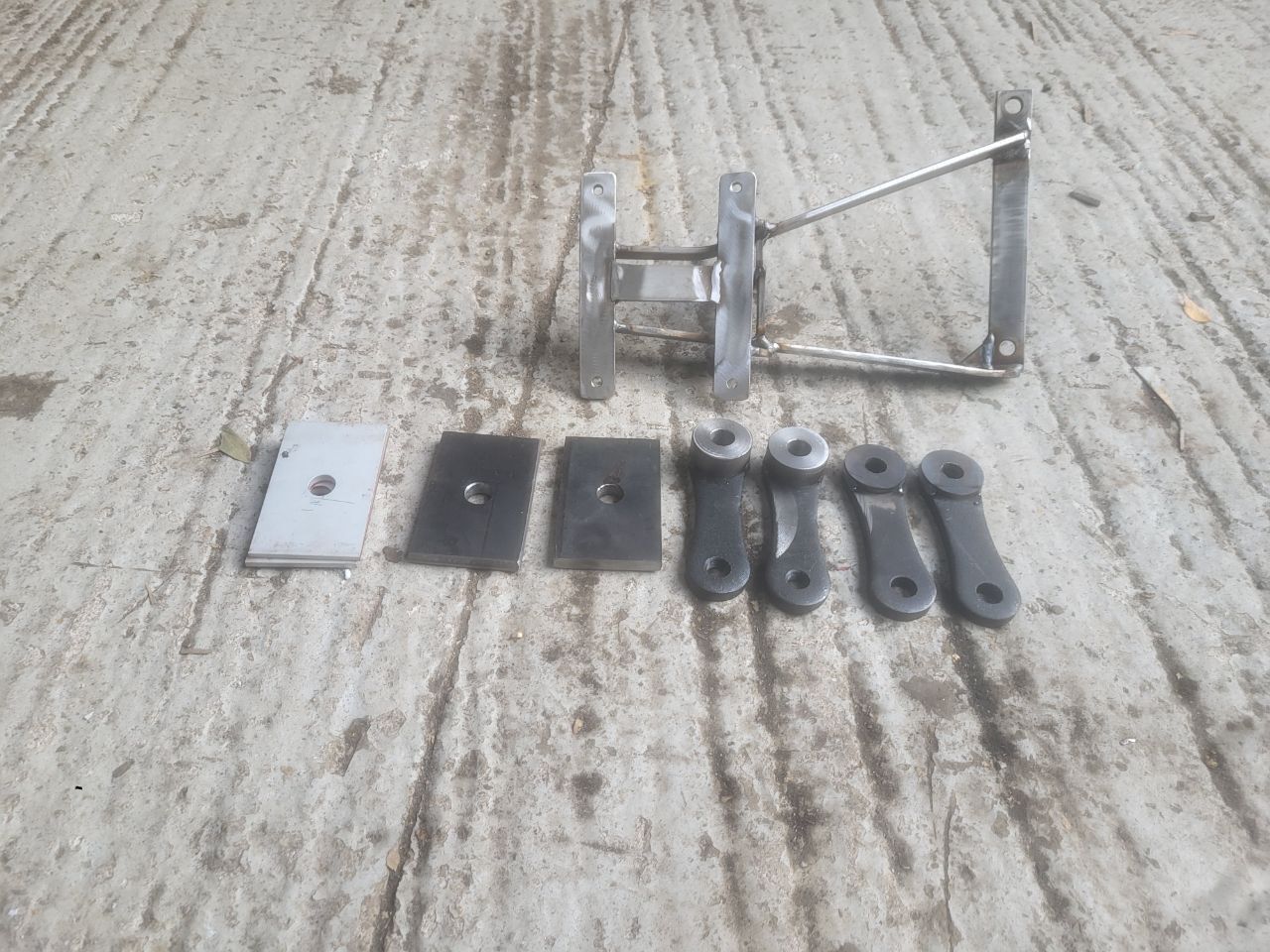

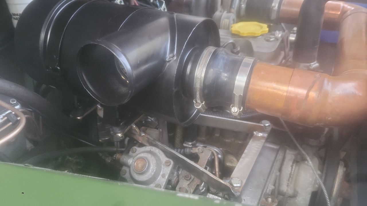

Next up was to make a stainless frame to mount a 300tdi airbox in place of abit of box section and plate such that it didnt hide the injection pump so badly

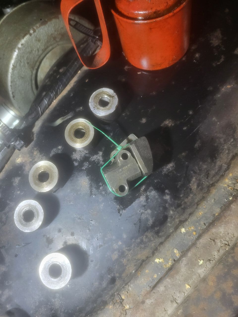

Also made some full face spacers for the leaf spring plates so the poly bushes has something to bear against properly and some 10mm leaf spacers which were to be used later

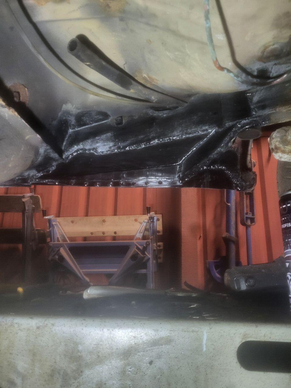

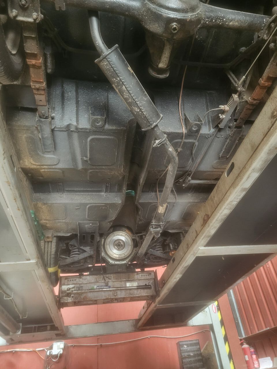

Sometimes you get in a job that is no bother at all where all is ok, the task is finite and nothing goes wrong, as in this excellent example of a pre capri,,,capri, it haf been welded all over underneath and looked really tidy despite being overlapped joints all over, this was just wanting some cavity wax blasting in and a general check over for any bother of which i found nothing amiss  1500 pre crossflow still in place

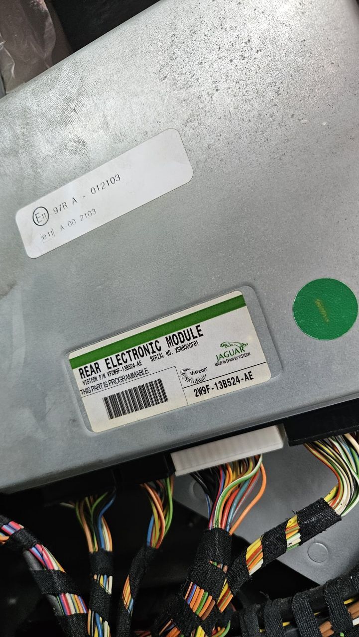

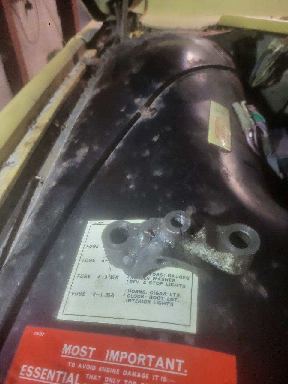

Then the jag of many electrical devices was looking ready for an mot upon which the air suspension and rear lights were found to be inoperative, or in the case of the lights monofunctional , a long bit of research uncovered bother with the fuse boxes on these and rear modules as pictured however in this case a replacement boot fuse box restored the workingsIMG-20250826-WA0009.jpg.528f32faddb0714ae6ba29858bf00874.jpg

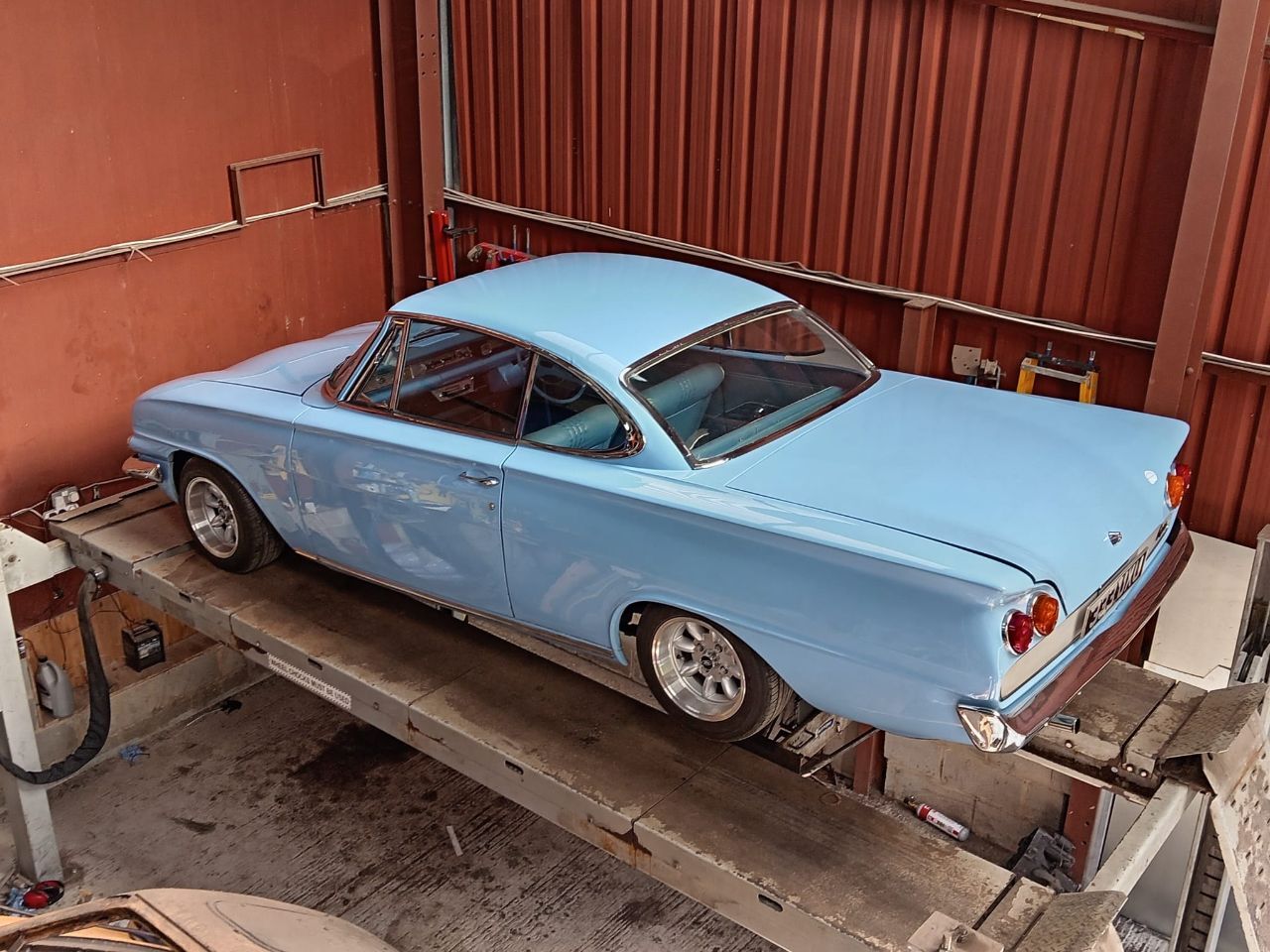

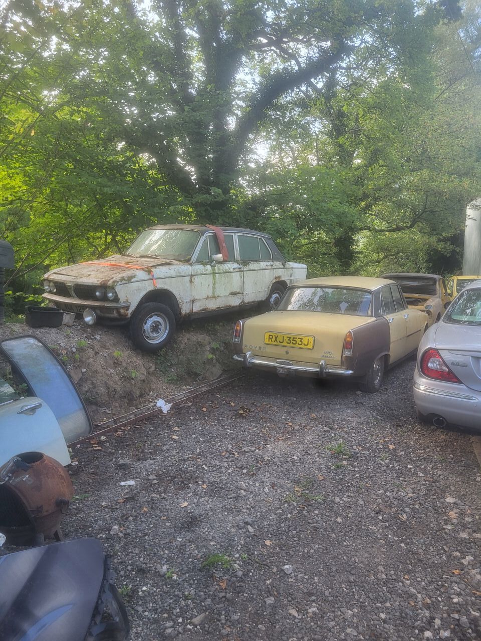

The P6 tow car was playing up terribly by severely spluttering and cutting out which was really annoying given it would barely top 30mph at times

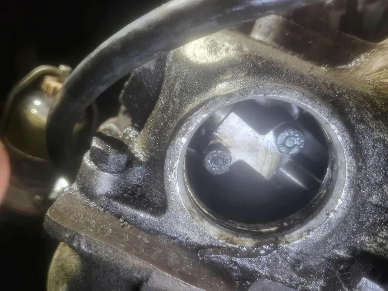

already the fuel system was ruled out as i fitted a temporary 10l tank, the ignition sparked fine so i checked the engine by way of a leak down which revealed dodgy valves on 2 and 3  a futher check of the cleaeances revealed a very tight inlet on 2 such that it never actually closed20250903_182525.jpg.7ea8fbf9740dc8aa4d8b981dea1da12f.jpg20250903_182555.jpg.e93d2aa67784cf68c52933223fdbf2a6.jpg20250903_182624.jpg.006f55a166c1aff835e76ea336448d87.jpg20250903_191858.jpg.f1d2dfede94d71ad51ebe7fedbf30ccf.jpg20250903_195006.jpg.82ec0be0dc265bd0b47f8c5dae3055af.jpg20250903_202026.jpg.a70f9184fb1b4d8507cfc6a1843ab47b.jpg
on these the head bolts hold the cam box down so when removing the cam caps you have to use spacers to retorque the head back up as you go along removing caps, what a palaver
i sanded the shims down a few thou where needed , then had to manualy  rewind the ratcheting hydraulic  tensioner as it didnt have the grub screw feature to unlatch the ratchet
obviously it ran basically the same after

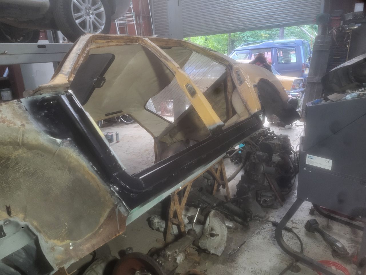

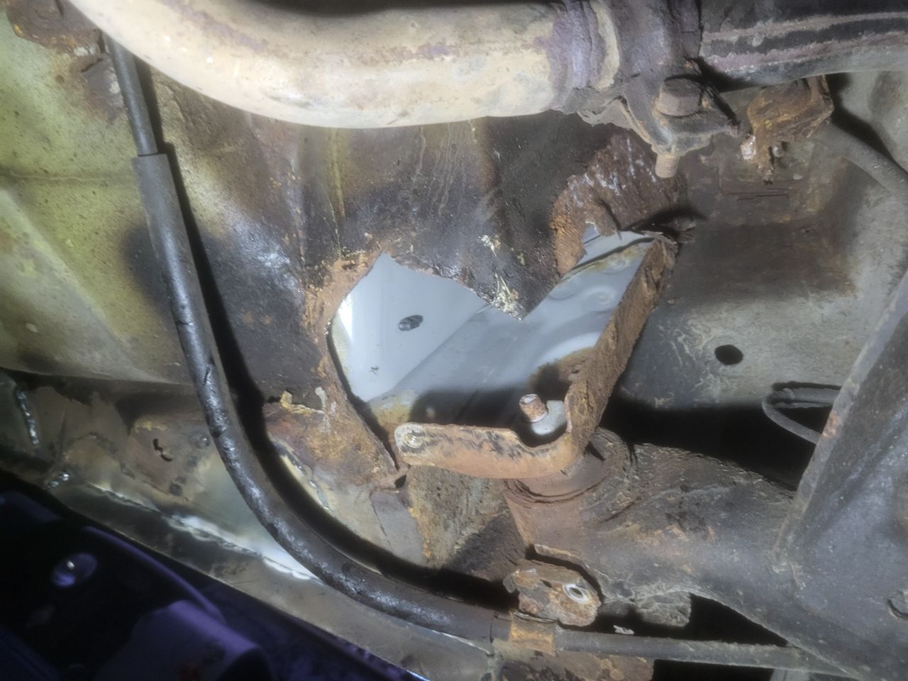

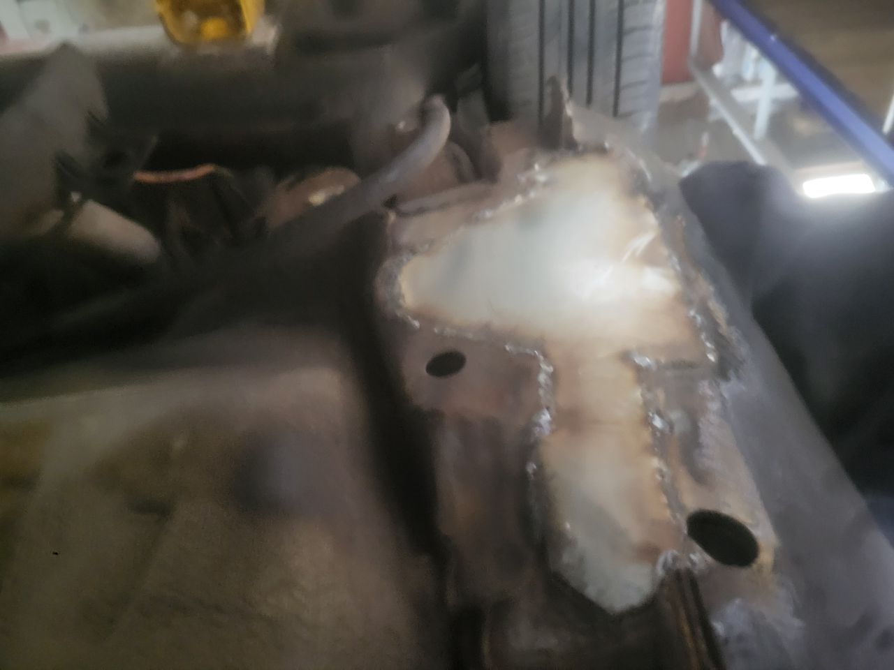

Next in was to weld the floor of a disco 1 300tdi, seatbelt mounts and the inner arch joint to the floor was buggered

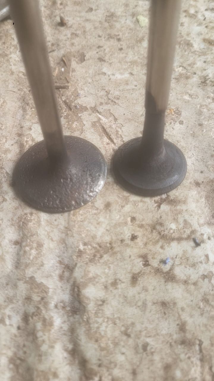

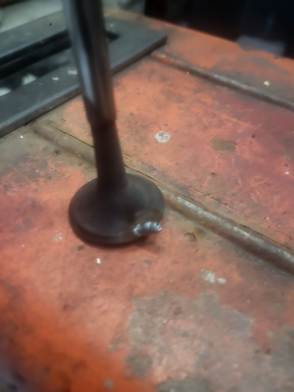

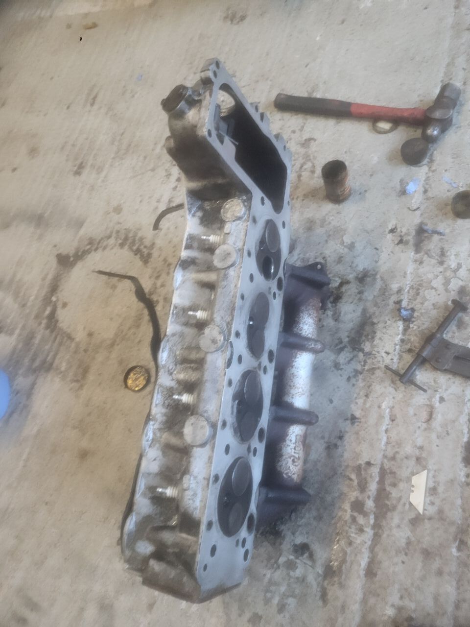

The rover remained barely driveable so after another round of 10mpg and heavily missfiring i noted cyl one and 2 were unable to take a leak down reading beyond hissing air out loudly through the carb and exhaust so i took the head off, found the exhaust valve burnt and.cracked and the inlet of one horribly pitted, evidently getting parts for a rover 2litre quickly is a none starter so i welded the exhaust valve and hand ground the seats them with an angle grinder and drill till they could be lapped back into the seat, as the valve was now massively further in the seat than before i elected to grind the end of the valve with a view that a gap maybe bigger than desired is better than no gapFB_IMG_1759243257523.jpg.4d8177322541205e1737e846e88c6fcf.jpg20250917_184840.jpg.73b8ce8877d4b3b51f9360c057b4d815.jpgFB_IMG_1759243272681.jpg.0b434f2b67dcd21b577f875cf5afe80e.jpg20250917_184854.jpg.a6aa517971913bbe49068209d3281ded.jpg
After all that it regained compression and ran brilliantly before intermittently bogging massively,,,FUCK sake , anyhow a second look at the points given everything else was sorted revealed that the spring had lost its temper and was barely closing the points leading to it sparking randomly, so swapped those for actual lucas ones which cured the problem finally,,
