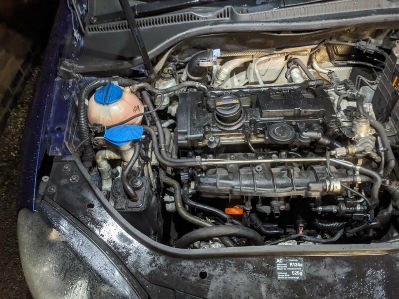

Dave_Q Posted February 15, 2024 Posted February 15, 2024 Just checked back and I did take a couple of pictures showing the access to the stat. This is with the alternator out, you can kinda see it. This is what you can see from underneath. The gap between the engine and the radiator isn't huge. Compared to this one with the inlet off. mk2_craig, Tickman and SiC 3
SiC Posted February 15, 2024 Author Posted February 15, 2024 I might pull the alternator to get a better look first anyway. I'm wondering if the o-ring on this bit has failed. Given it's sitting bang on 90c, I reckon the stat is almost certainly not original. Maybe even replaced recently. However if that o-ring hasn't been replaced then it could well be the source of a leak.
SiC Posted February 15, 2024 Author Posted February 15, 2024 This is a video of it at a different angle. Looking along the engine. Alternator is just below. I can't figure where the leak is but to me, it doesn't look to be at the block side but in the middle of the stat housing. Obviously replacing an o-ring is a lot cheaper than a stat. Also only half the job too.
Dave_Q Posted February 15, 2024 Posted February 15, 2024 Could it be spraying from a pinhole in the short flexible hose number 14? 16 and 19 in the diagram are metal pipes and these are the ones bolted to the front of the block.
SiC Posted February 15, 2024 Author Posted February 15, 2024 Nah it's here. Fuck knows how this can happen. Looks like a split in the plastic mould line Just fighting to get the boost pipe out. Taken longer to get this pipe out than get to the thermostat.
EyesWeldedShut Posted February 15, 2024 Posted February 15, 2024 14 minutes ago, SiC said: Nah it's here. Fuck knows how this can happen. Looks like a split in the plastic mould line Just fighting to get the boost pipe out. Taken longer to get this pipe out than get to the thermostat. Bini does that - I think it’s a combination of age, over tightening the bolts to fix*a leaky o ring and fitting the pipes in a confined space. It finds a weak spot by the mould lines and goes from there SiC 1

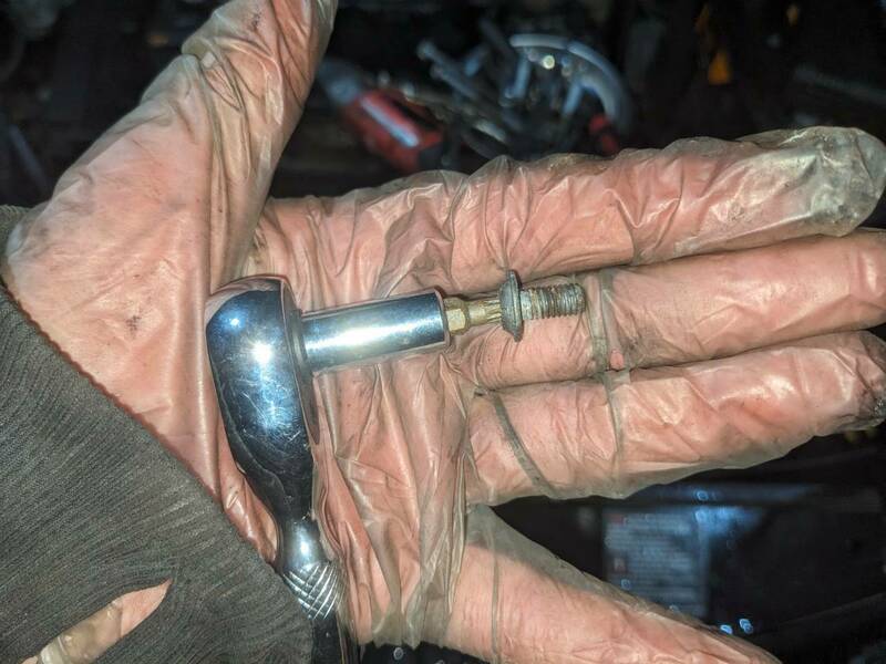

SiC Posted February 17, 2024 Author Posted February 17, 2024 Not much last night as I'm still waiting for this thermostat to arrive. Supposed to be today. Picked up the Merc, so I have wheels again now. Brakes feel the same, which is no surprise as the system is brake-by-wire in normal operation and the feel is artificial. Old pipes were hanging and definitely needed replacing asap. Annoying that whoever worked on the brakes previously busted the caliper bleed screw. Makes you wonder if they were trying to bleed it, broke it and then just ignored it. Anyhow I dug out my alternator clutch pulley tool and found this spare pulley. It came in the kit of pulleys that I bought for the 2006 A4 TDI I had for a few months (iirc @grogee owns it now). I couldn't get that one off and tbh it looked new while working perfectly. So I didn't change it. Luckily it's a direct swap and matches up part number wise with this alternator pulley too. Removal is a special tool that is a torx in the middle and then a splined bit on the outside. Took some figuring which way to turn what. The collet piece is the lefty loosey part. You're not allowed to use air tools on this as it smashes stuff. Brute force didn't work, so I trod on the spanner. Crack and it was off. Doing up was easy enough and just needed 85nm on the centre tool in reverse. Replaced the pollen filter as it's an easy job and often neglected. This however has a fancy Mann one that filters PM as well as other materials. I use one in our Civic and can recommend if you have allergies and/or asthma while doing a lot of city driving. These are quite expensive filters! So again someone has spent money on this and it's not that dirty, so not that old. The replacement was a much cheaper Bosch carbon filter. Removed one of the plugs to do a quick inspection. They've definitely been there a while. Wasn't easy to remove and took a bit of back+forth as I really didn't want to snap anything. I'm not a fan of Bosch plugs either and prefer NGK. I'll replace these in due course once I've put a few more miles on it. (Basically I've spent far too much on this so far this month). Had a quick peer into the wheel arch as I noticed the springs looked new. Shock doesn't look that old either. Nice to see a quality Sachs damper than some random name rubbish. Hopefully that thermostat will arrive today and I can get it fitted tomorrow sometime. GMcD, mercedade, FakeConcern and 9 others 12
