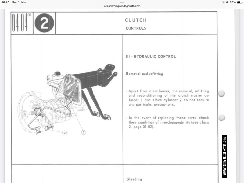

Asimo Posted March 11, 2024 Posted March 11, 2024 I think I would start by removing the engine and gearbox from the car. And then cut / drill the cylinder out. Resist violence because that casting does look vulnerable. Manual isn’t helpful.
EyesWeldedShut Posted March 11, 2024 Posted March 11, 2024 9 hours ago, meowmeow said: Does it look good? No. Is it passable? Maybe?? Bluntly? Dodgy as fuck imho To get the slave out - cut ends off as advised with big, manly tool. Then reverse a hacksaw blade through the remaining ring, plumb into hacksaw and gently start cutting (like getting a fecked bush out). A decent reciprocating saw might also do but I've never had one of those. meowmeow 1

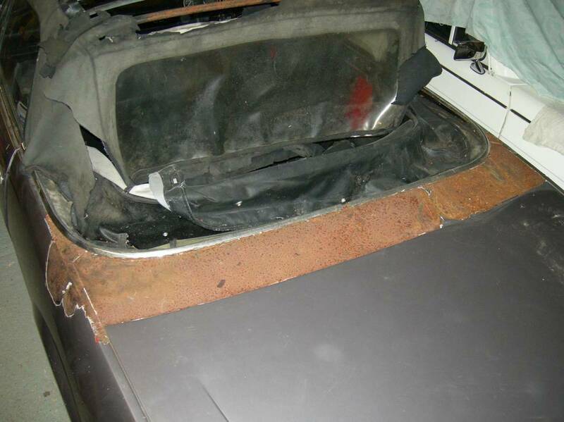

Six-cylinder Posted March 11, 2024 Posted March 11, 2024 I don't know how I missed this thread with the word "504" in the tittle. Great job we need more 504s. At Rustival yesterday there were two, a RHD 1.8 Auto Saloon and a LHD Diesel Estate. I have a 504 convertible which while taken on as a project has not run properly in the 15 years I have had it. The accusation is that it is the Kugelfischer injection at fault and then there was the wheel falling off incident! meowmeow, Lacquer Peel, Datsuncog and 8 others 11
meowmeow Posted March 11, 2024 Author Posted March 11, 2024 20 hours ago, junkyarddog said: Be very careful with that cylinder,because if you twat it too hard with a hammer it's possible to break the casting it's housed in from the gearbox. Ask me how I know........🤣 Yeah this was my main concern, not exaclty that easy getting a replacement casing if it cracks! Only got a coping saw at the minute so either I go tool shopping at some point or this is going to take a while...

Six-cylinder Posted March 11, 2024 Posted March 11, 2024 48 minutes ago, meowmeow said: Maybe someone on here can bid on this equally rusty (albeit in different places) RHD coupe? https://www.ebay.co.uk/itm/305437635963 Our convertible had been previously restored before we got it, but painted badly and the paint fell off allowing some rust. Worst was the rear deck panel where the water sat between the steel and the paint with the result of thousands of little perforations. I had to have a new panel hand made at vast cost. Since the wheel fell off it has reveals a bit of rust on a front inner arch/floor that needs repairing. tooSavvy 1

meowmeow Posted March 31, 2024 Author Posted March 31, 2024 ok followed everyone's advice and cut the clutch slave cylinder out of the gearbox casing with a hacksaw, which actually went quite smoothly 'New' part arrived but the rubber dust cap was cracked, so am waiting on a replacement for that now Serves me right for buying stuff that's likely as old as the car is, just becasue it's cheap... In the meantime sanded back the OS rear floor and painted just to protect it for now. There are of course a few small holes which I'll sort out later, And some pretty big ones as well: More fussy shit to waste my time, unbolted the seatbelt, cleaned up and painted the bracket: As you can see I've upgraded from wheelie bin workbench to wobbly mouldy old bathroom cabinet. Seatbelt mech is jammed (of course) - looks like it was soaked in rat piss - but I don't have a 3-point screwdriver bit to get it apart, so will have to find one of those. At least I got some of my money back, 22p Then to investigate the rust in what's referenced to in the workshop manual as the 'buttress' suitably unpleasant. But removing all the mangled rubbish out of the way reveals it's not too bad underneath Top piece has a return just under the lip where the bulkhead is, so doesn't go under the floor. Might be interesting trying to support the car by the front subframe whilst cutting chunks out of a structural member... Thought about moving the axle stands to behind the rusty bit, but the workshop manual is pretty explicit about not doing this: Tried it anyway because I'm stupid but it started making some pretty ugly noises so I stopped. Anyway looks like the engine's gotta come out since I can't squeeze my hands and a welding torch down there Think there's enough space to position an engine crane down the side of the car, not sure how I'll actually fit past it but we'll cross that bridge whenever. Unfortunately can't put the crane at the front of the car as there'd be no way of closing the garage doors, and it'd probably just roll down the drive and away down the street.... Finally my excuse this time for slow progress is that I was putting up 50-year old wallpaper in a stanky bathroom: Not sure if it actually looks much better, but definitely feels less grim Shite Ron, Tickman, Rocket88 and 20 others 22 1

Mr Pastry Posted April 21, 2024 Posted April 21, 2024 46 minutes ago, meowmeow said: And the casting is an awkward shape so will have to see how to remove them, drilling out from the back might be a challenge. If you have to drill them out, cut them off flush first and drill from the front. bunglebus, meowmeow and tooSavvy 2 1
Scruffy Bodger Posted April 21, 2024 Posted April 21, 2024 What he says ^ Centre punch them first, central as best as you can, then start off with a smallish drill and eye it for centre. You can make small adjustments one way or other with the bit to get it as central as you can, then go for it. Hold it level in a vice if you can. Pierburgs were rubbish 25 years ago. I was throwing them in the bin and replacing them with Webers as a matter of course when buying different cars to prevent hassle. BorniteIdentity, meowmeow and N Dentressangle 2 1
