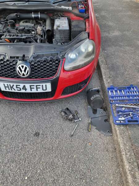

So, much like the l322 of great liability, this has been being used with very little in the way of needing to be fed and watered other than fuel.  It's been living at the unit but I want to put something else in so I asked other Dave to bring it home tonight.
He's just messaged me to say it won't start outside his house..turns the key, dash lights up but nothing.
I suspect because of the starter being at the front of the engine the wiring to it is in a mess.
Power to relay is good, relay is relaying fine, so either the starter is fucked or the solenoid has given up.
Suppose I'd better go over to his with the spanners after work.
  • Sad 2

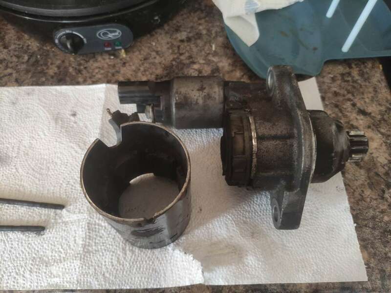

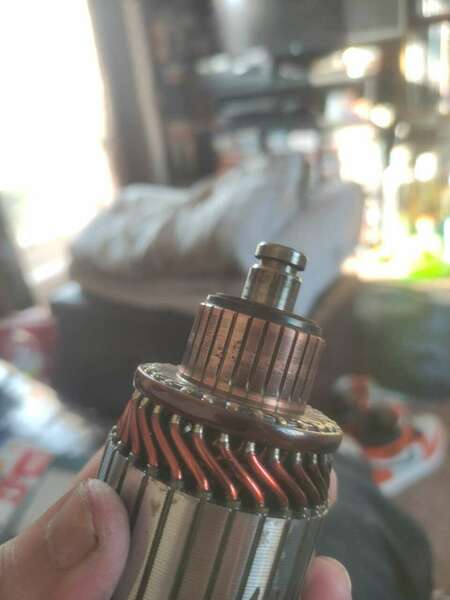

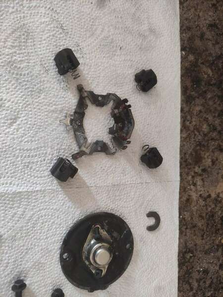

Right..
Power to starter is OK so, wiring is corroded that I can see, so let's get this fucker off and have a look to see if it's repair, refurbish or replace for this starter motor shall we.
Ram air filter means easy strip and access, so starter off in less than 5 mins.
If this was the only damage I'd just repair it but ..
Two of the four brushes have been arcing out and this one is dead.. arse..

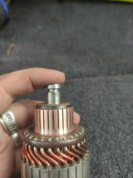

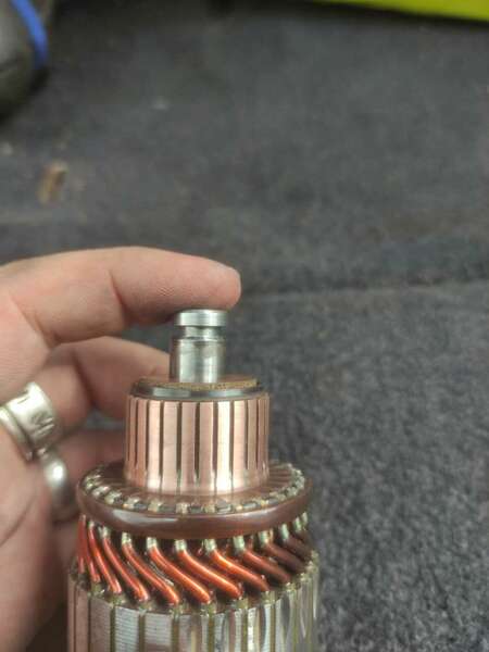

Waiting for parts show up is tedious.

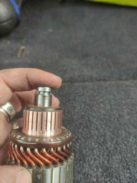

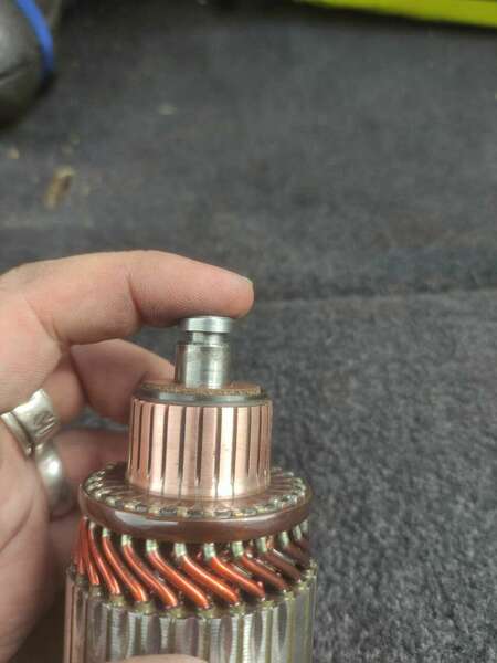

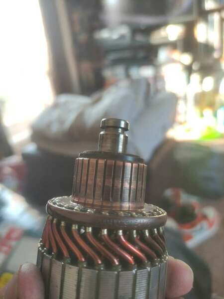

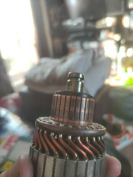

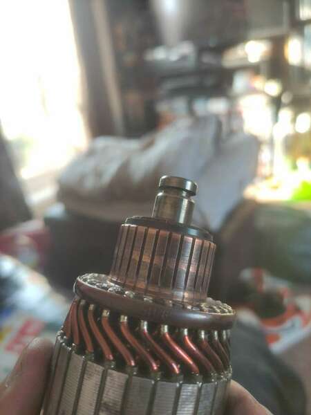

Gave me a chance to clean up the armature, it needs a bit of work to be perfect, there as signs of it pitting on the brush contact area, which would have lead to the overheat and failure.
IMG_20230917_094333.thumb.jpg.5af26abcc2b9ef19be6e0f65e242b752.jpgIMG_20230917_094330.thumb.jpg.56c3e93dbf45b59077cad090d4fa950a.jpgIMG_20230917_094323.thumb.jpg.d255a9e9cb3fa6b3895c67e3338f6976.jpgIMG_20230917_094317.thumb.jpg.09d2dfc70dbd0bdbf591cd41a2d5c67d.jpg
I've removed as much contamination as I could with wooden toothpicks and given it a quick once over with plastic bristle brush and a rinse off, which as you'll see has revealed the worst of the pitting.
I'm going to see if I can dress it down a bit, clean the body of the motor off a bit and wait for the brush pack to arrive.   Brushes were well past their best too, very small, two looked like they've broken up, which might explain the pitting😄
I've edited this post four times now and it keeps inserting an erroneous armature picture at the end.. I give up!

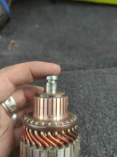

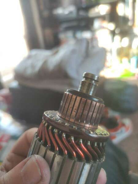

No, but I do have a pillar drill and a steady hand 😂
Results of a pillar drill press and a few grades of abrasive.
As you can see the worst of the pitting is still there however it's smoother now so I don't see it causing any issues, if not ideal.
IMG_20230917_133738.thumb.jpg.f06e54e85e8e51eb2c092de340503602.jpgIMG_20230917_133736.thumb.jpg.3c4bc02fc318f881137467870a9ca897.jpgIMG_20230917_133736.thumb.jpg.3c4bc02fc318f881137467870a9ca897.jpg

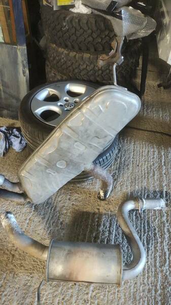

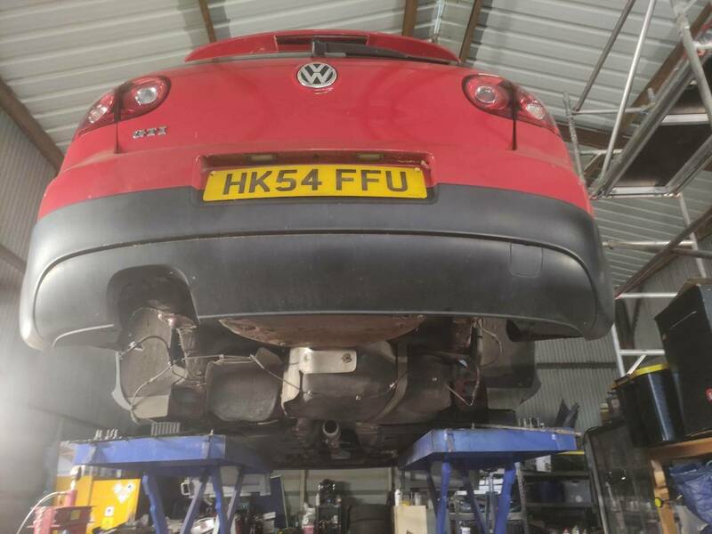

Since starter motor gate this has been absolutely fine but the MOT is looming at the end of the month and last year it had advisories on the rear bushes and subframe corrosion as well as a minor oil leak and a loud exhaust.
The exhaust is a sports cat and big downpipe, 3" into a reducer and then a stock resonator and silencer.. as you can imagine it's lovely until it gets to the cobbled together shit at the end of the car, so I've taken that off to try and make it a bit better than a series of claps, exhaust paste and bodge repairs as it is now.
I've been giving it death and it doesn't feel baggy at the back end, but it also doesn't feel incredible either and usually these are are really good.

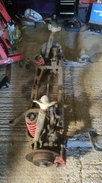

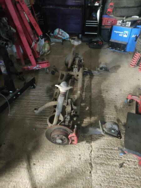

Since doing the brake upgrade to Porsche calipers I've been meaning to get the rear suspension sorted as when you stab the pedal hard it will lighten the back and you can invoke oversteer if you're being a bit of an idiot.
Given I am an idiot, this happens a fair bit so..

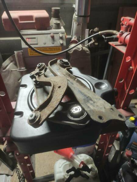

While I had that lot off, I decided to prod at the underside, it's for a fair bit of surface scabbing, the rubberised underseal has trapped water, so that's all going to get dug out, along with the seam sealant and I'll get some raptor on the underside.  It's remarkably solid given how this era golf tends to go.
Subframe is scabby as hell, it's easier to sort it, refresh all the bushes and bolts and repaint it off the car so.
IMG_20231014_152759.thumb.jpg.835c677509bbdb1793a486164d008790.jpgIMG_20231014_152755.thumb.jpg.df6c0e9c71579e458a96a45b4a1f9020.jpg
I guess tomorrow I'll strip the subframe in readiness for cleaning.
I've got a set of PU bushes coming for it, so I'll press out the old stuff as I remove it and I'll see if any of the bolts come out, if they don't then I'll cut the fuckers off and buy new ones.
I could buy a bolt and bushed arm kit for the 11billionty bushes and bolts I need for £200 but when the arms are actually serviceable and because I hate waste (and will end up doing it again next year because modern rubber parts are absolutely horse shit) I'm going to spend more money than I need to and fit something with more than 18 months of life.

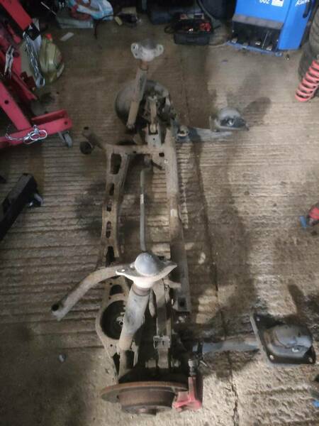

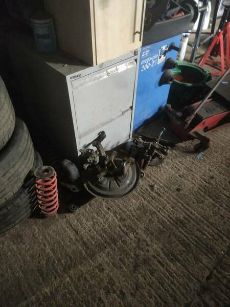

Really poor progress today.  Sarah made some blackberry vodka, it's very sweet and goes down very well, unfortunately it also means that I'm hanging, but stuff needs to be done.
As such this:
Is now reduced to this.
One absolutely stuck bolt means a banana arm at top is still stuck there ,that needs cutting, which is a bit too antisocial for a Sunday afternoon when my workshop backs onto the landlords house and he keeps a gun.
But these bits are off.
So I can at least remove some bushes and clean up some things tomorrow evening.
