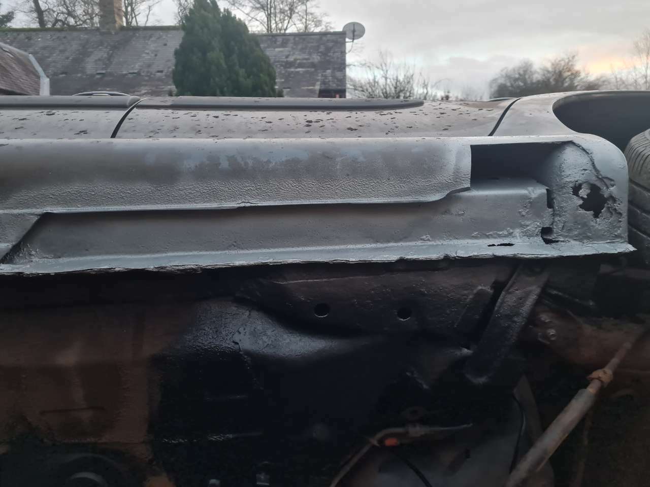

RoverFolkUs Posted January 19, 2023 Posted January 19, 2023 Check the rear brake pipes, the one inch going from the body to the union at the beam which they decided to leave unprotected 🤷 As above, keep an eye on the oil level, they will consume a bit as age/mileage increases. Keep an eye on the clutch adjustment. They can and do rot out, so it's worth treating any surface corrosion you may find especially along the sills They can burn the valves out, causing blue smoke, but the timing chain is generally bulletproof I seem to disproportionally have to do a lot of rear wheel bearings on them compared to other cars so bear that in mind if you notice a wheel bearing noise, they're pretty prone to it. Hardy little cars, I'm personally not a fan but I can see why people like them @St.Jude of this parish has owned one from new (I think? 🤔) So should be able to give a pretty good run down St.Jude 1

Broadsword Posted January 19, 2023 Posted January 19, 2023 I've had a few and they are usually pretty handy things, I think they are brilliant little cars. Above is a buyer's guide type thing I did on the last one I had which was from this parish funnily enough. I learnt from this one to pay attention to the fuel sender unit. They can have weird fuel leaks there. On this one it leaked like a bastard depending on the angle the car was pointing at. Crazy thing was that the culprit was the return line had just slightly uncliped from the union. I pushed it home and the problem was fixed. If you sit hard on the back seat you can bash the fuel lines out of the sender it appears. davehedgehog31 and rainagain 2
