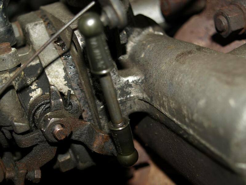

Not sure how useful it is, but the throttle cable to fuel pump linkage on my 1990 Mercedes T1/TN (OM.601 engine) uses very similar looking ball and socket type joints.  I don't have a decent photo to hand I'm afraid.

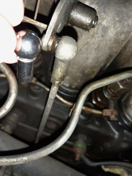

On 8/17/2022 at 7:12 PM, Dyslexic Viking said:
Don't know if you've found a result for this but my old Volvo Amazon had quite a few of these in the throttle linkage assembly, being a similar age they might work? I imagine Amazon parts are reasonably easy to come by in Norway.

Here's a rubbish one from 3 years ago from when the throttle cable holder snapped.
Can try to get a better look at the linkage over the next couple of days, most of the linkage is buried behind the pump.
The Mercedes 190 and W124 diesels are full of those little ball and socket joints in the throttle linkage.
My Dolomite uses the same sort of thing.
When I first got the car the nylon ball sockets had snapped and the linkage had been substituted with some random bent wire...
Thanks everyone. I am waiting for the 2 original joints and I will have to wait until they arrive before I can do anything more. If they don't fit, I have to look at alternatives.

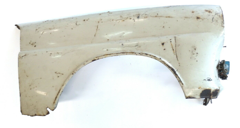

I'm tired after yesterday so have a slightly quieter day today. So I'm looking for a passenger side wing and there's not much to find, there's maybe 1 in Norway and I'm waiting for the seller to come home from holiday.
But I found this one on ebay for sale in Germany which is worse than the one I have and with shipping it will cost over 600 pounds and then it also needs to be fixed and painted. So this doesn't make sense.
1486466914_Screenshot2022-08-2110_24_37.thumb.png.24139dd0f3a5a99f8383848a7f6478a0.png
But what I also found was a repair panel for the bottom of the wing. This is a much better option to fix the wing I have, I just need to find someone to weld this for me.
1037974520_Screenshot2022-08-2110_26_43.thumb.png.3a08f2fae8fa8d2b4a954ebac4ed51fa.png
So I'm leaning towards fixing the wing I have now.

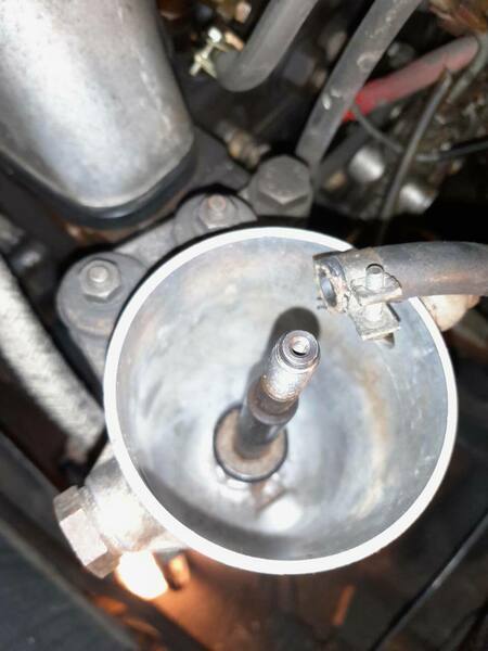

Tried today to change the engine oil and oil filter and the diesel filter so it is ready for when the new lift pump arrives.

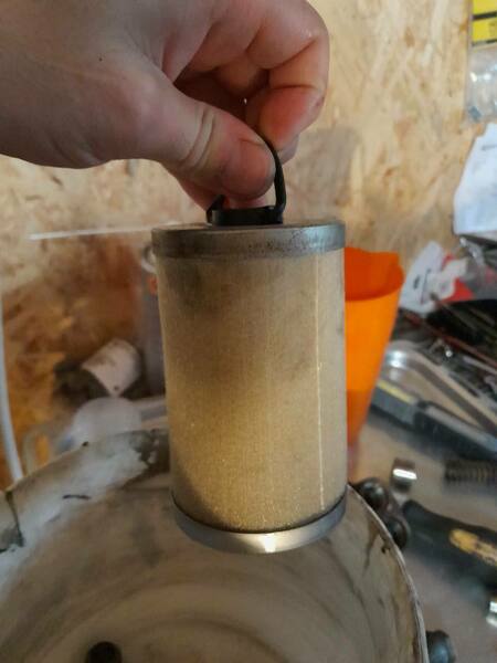

Started with the worst first and that is the oil filter which is in a very inaccessible place. The filter is marked with a red arrow.20220821_131757.thumb.jpg.394877d06701ce2f6b30d4973a8a54b2.jpg
And immediately encountered a problem. Considering the age of the car, I would assume that the oil filter bolt had a normal bolt head, it didnt, it's also very tight here, so this was the only thing I could use to unscrew the oil filter with.
And when the oil filter housing came off, it was clear that it had been a while since the oil filter and oil had been changed.
Then the next thing was to clean the oil filter housing. This also has a drain plug which is smart.
Then the next problem for the day. The new oil filter does not fit, it is too big.

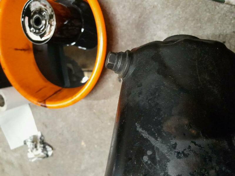

So after that failure I chose to drain the oil and I encountered another problem. The drain plug requires a special tool which I don't have, nor have I seen this before.
So after this I chose to try changing the diesel filter which didn't look too bad.
And then I cleaned the diesel filter housing. And there was some dirt at the bottom that came out.

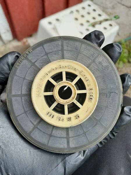

Then I tried to put in the new filter and this doesn't fit either.
So it seems there are several types of filters for these. What came out was oilfilter Fleetguard LF3364 and diesel filter Fleetguard FF5053 I have looked these up at my Norwegian parts company and have found filters that should correspond to these so let hope it is correct an they shuld arrive later in the week.
And when it comes to the oil plug, I think I'll have to buy a set like this.
A set of Allan keys should see it off.
Had a set for years had common on vw
13/16 spanner from memory.
If you're stuck without the proper tool, you can often use the head of a bolt to engage into the the drain plug, with a couple of nuts locked together on the threaded part to twist it loose.
Thanks, that's a good idea, but this was solved as I got hold of the necessary tool.
