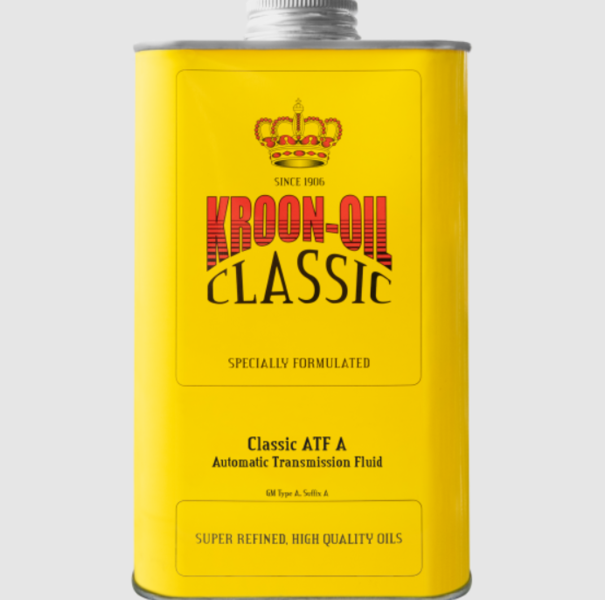

I personally would not go for DEXRON-III. And I would be a bit wary of the Mobil ATF 220 which is more for DEXRON-II, compatible with DEXRON but a generation apart from Type A Suffix A so can't be sure it's actually tested as fully compatible. Then again Manual Transmission is not as picky as Automatic and it'll probably work okay for a long while. Type A Suffix A haven't been available for many years anyway and people have to go for substitute anyhow.
I have to say I'm one of those people who're picky about GL4/GL5 gear oil, although most cars on the road are on GL5 anyway. Your mileage might vary.
From the list it seems Mobil ATF 200 is the "correct" fluid, but may be difficult to find these day.
Maybe I misunderstood something, struggling to understand ATF oils it seems like a complicated mess.
Mobil ATF 200 is difficult to get hold of, but I'll do some searching and see what I can find.
Kroon oil actually has the Mercedes W110 in its oil selection guide and gets Kroon Classic ATF A there, but like other oils, this is almost impossible to get hold of.
I just have to keep looking.

I looked at the Total version, but the only place I saw an ad for 1l bottles is Bulgaria. Everyone else only seems to sell 20l containers.
Thanks for looking. After much searching myself, I found that Autodoc has Kroon oil and they have Kroon Classic ATF A which Kroon recommended for this and fulfills Suffix A and MB 236.2. So I think I'll just buy that from Autodoc.
I have now ordered gearbox oil from Autodoc which is the oil recommended by Kroon and which matches what @Conan said. I also ordered Kroon's recommended oil for the diff, among other things.
Big thanks to @Conan your help helped a lot with this.
If I've made any mistakes here, don't be afraid to say so.
If others are struggling to find lubricants for old cars, check out Kroon https://www.kroon-oil.com/en/ another thing I like about their classic oils is that they come in contemporary metal containers. Which is very nice and they will not be thrown away after use but put on the shelf for decoration.535532921_Screenshot2023-04-2012_51_32.thumb.png.bf051b1378afe47aa6bb50ca0bcb1855.png
