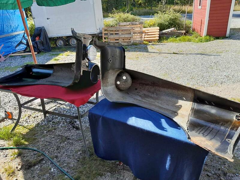

It has now been backed into the garage and the front wings removed. There will be a lot of work for several days ahead. And since rural Norway had almost only gravel roads in the 60s and 70s, there is a lot of gravel removal followed by scraping off old underseal and rust work where necessary.
And it is very clear where the arch liners were.

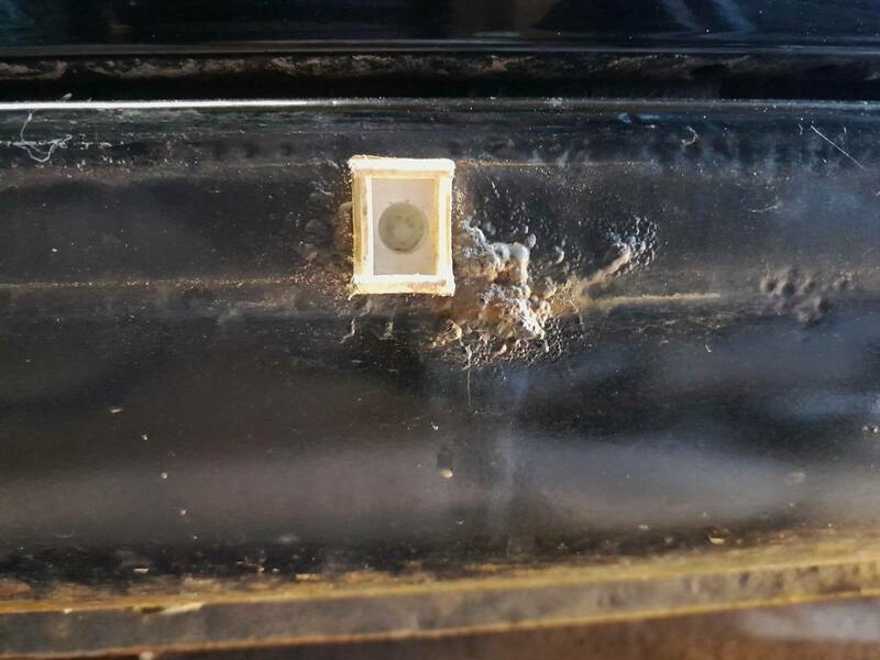

I've spent the last 3 days on this and got a lot done. Have had a lot of gravel scraped off and then sanded down and painted the inside of the front wings and the bodywork behind them. But this one needs some proper body work in the future. The passenger side sill will probably need to be replaced in the future, among other things. But it helps that this has thick and good steel. And this is well demonstrated in the picture below.
On cars with thinner steel than this, this would probably have been a rust hole when you have sanded it, but not on this one. There are craters and it is clear that the rust has eaten away at the steel, but it is still solid. The picture below shows the same point after sanding.
So I will treat it and then paint it and it should take a while before it rusts through. Will probably also apply Fluid Film to the inside of the sills, it will also help with rusting.
