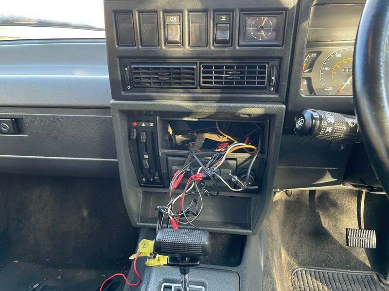

Ok. So today I had the morning spare. And the weather is ok. And it’s been over 24 hrs since I had a bowel movement so I spied the chance to start rebuilding the dash. BOY what a shit job it is. And it’s been months since I stripped it. Two of the clips to hold the bottom of the matrix to the blower box went missing…. Looked everywhere. Nope. Gone. So I did the right thing and made new ones from old Volvo headlight clips.
it was also a pain to get the vent ducts to the windscreen back on. But they got there in the end.
the lower of the dash was a pig to get back in. These things have a real specific way of being dismantled and rebuilt, of which none I could remember. But I fought all morning with it.
The main loom that runs to the gearbox down the centre console caused issues with the vent duct that runs under the glovebox. That needed waaay too many swear words.
the radio is going to be the next decision to make. I love it, but the bracket that holds it in is crap, doesn’t fit right, and isn’t secure. So I don’t know yet.

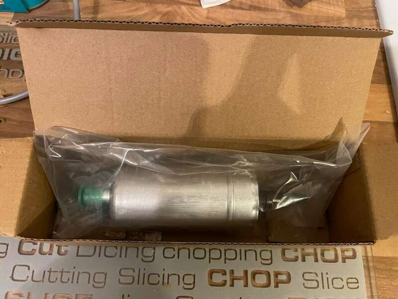

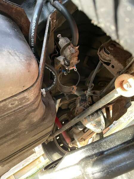

then while the sun was doing sun stuff, I scooped a jack under the back and pulled the temporary fuel pumpalator off and put the new one on. She runs better now, and much quieter.
the blue one I’ll keep for a bit incase I need to do some more fluid transferring, it still works but it’s noisy.
