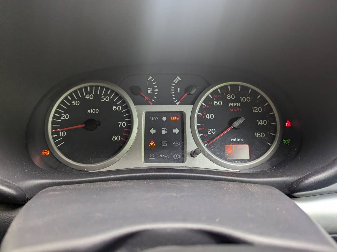

Got in the Clio for the first time driving it since coming back from New Zealand. The Burd had used it last week, no issues.
Lumpy start from cold ( it does that). 300m down the road, flashing EML.
Cyl 3 misfire.
Went home and got another car.

Took it out a test drive. Only things left to fix for an MOT are
Back brakes - free off fully and get handbrake working.
Headlights - need polishing
SERV/ABS/TC light on the dash - likely the steering angle sensor.

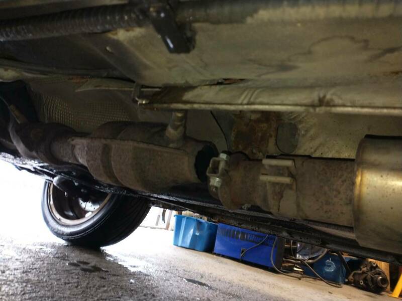

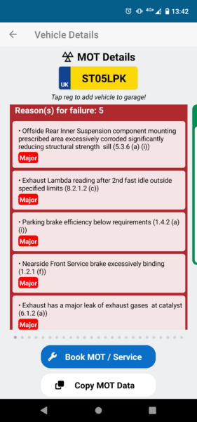

Took this for an MOT on Wed last week.
Bastard, especially as I've done the rear brakes - looks like the pivot at the handbrake lever is the issue.
Got it to the unit today, and had a quick look
Exhaust "leak"
The pipe out the cat has rusted through - fitting a new cat would resolve, except...
The downpipe to cat joint looks ropey too. This uses flanges, so would need to fit a new one to the downpipe,as there is NO WAY I'm attempting to pull the downpipe off!
Additionally, the cat would need the Lambda removed, so I would expect that to be ruined and need a new one.
The sill doesn't look the worst for welding
No doubt that will develop into a bigger job!

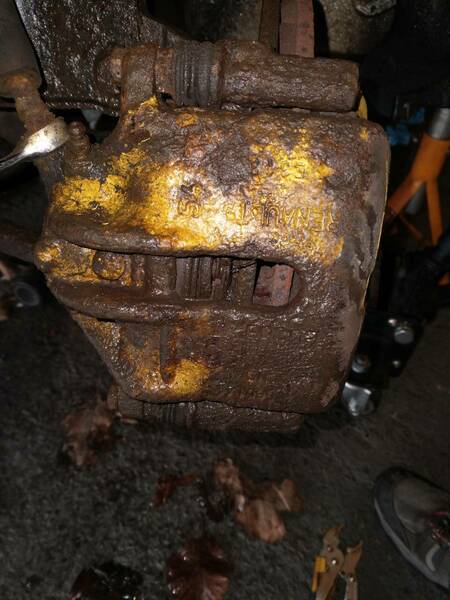

The caliper retaining bolts and the Flexi all loosened off no bother.
I'm away to price up bits..
Bloody hell! I know this isn't the quietest Clio but surely you would have noticed the exhaust getting a tad* louder.
It started to blow on the way to the MOT and failed on the ramp.

First up, a new caliper and pads (and caliper carrier bracket) for the front left.
All good!
Time for the new Car and Lambda sensor ..
@jaypee modelling what £170 buys you
And fitted
Brilliant, great stuff. That's the Cat and front brake sorted.  Clio Stu has done the steering angle sensor and the rear brakes. Only welding to go...
Think I'll fire it up and see how it sounds/check for any blows...

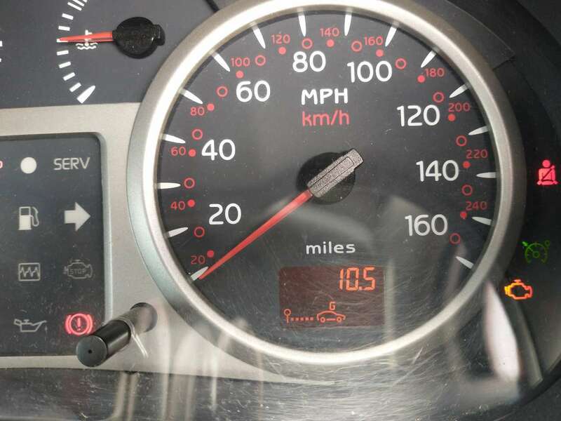

Ok, time to fire up the scanner.  And do some test driving.
On start the lights stayed off, but came on when braking.
Code reading pointed to a brake light switch issue.
Removed the switch and exercised it - got brake lights and the dash lights stayed off. Result.
New brake light switch has been ordered.

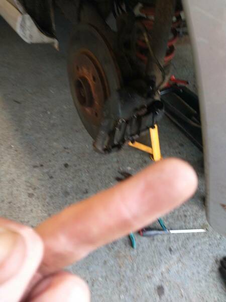

With the rear brakes having been rebuilt I was hoping some adjustment/checking the pivot that the cables go into would get me a functional handbrake...
As you can see, it went well*
The cable is siezed - so the inner cable doesn't return fully. This meant that :
1. The handbrake lever on the caliper was not actuating correctly - so the handbrake was shite.
2. The cable stopped the lever returning correctly. Hence the caliper would stay partially on.
time to get the cable out.
We really* enjoyed that! A new one will be ordered.

Got the hand brake cable mechanism stripped down on this today.
It got cleaned up, greased and refitted. Now have a balanced handbrake functioning on both wheels.

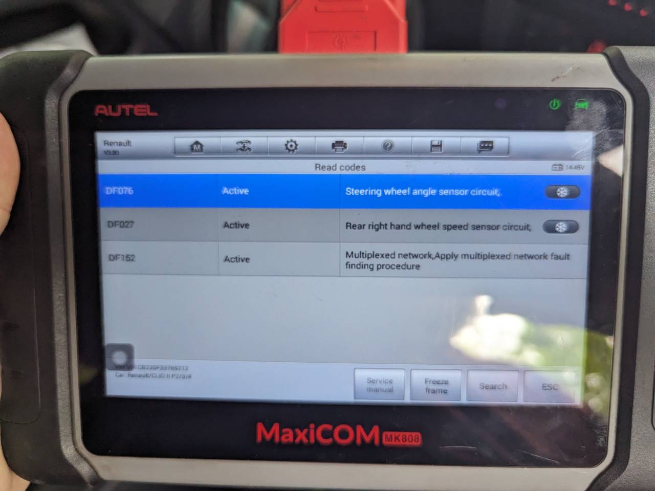

Started right up and proceeded to greet me with:
Fuck.
Time to scan
It had a replacement steering angle sensor 100 miles ago..
-3280degrees. Surprised the bonnet hasn't hit the boot!
Anyway, a bit of high idle charging and a code reset put out everything bar the Right rear ABS sensor.
