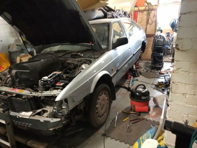

Rover 827 update.... Fueling around...

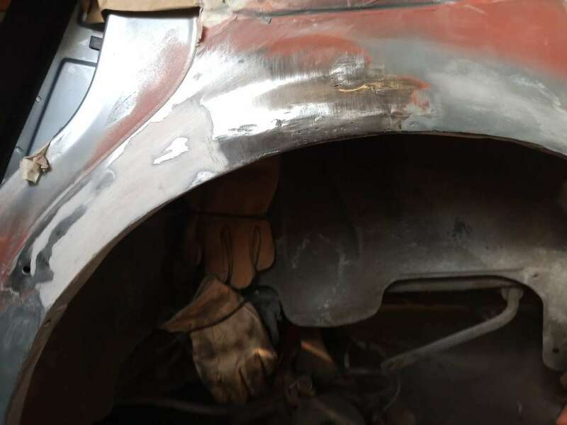

July update time.... Thanks to my Subaru repairs and other family related maters, this project has inevitably got delayed and delayed some more.  Its got me really wondering. I am starting to see the Rover as a never ending time and money black hole, rather than a car. There are things about the Rover I like but I don't feel emotionally attached to it. It wasn't supposed to be a big project really it was supposed to be backup for the Subaru and it utterly failed at that, hence I now own a Honda Acccord after the Scoob let me down!
It's also stopping me getting to my actual projects (The Scimitar and the Freight Rover Coupe...) My motivation is pretty low! I have decided to finish the sill, wheel arch repairs and any other rust repairs but after that I may well park it for a while but maybe I will sell it as an unfinished project, not sure really.
Anyway, more welding, the final part of the inner arch, yes I forget to take a picture of the rot or the hole were I cut the rot out. So basically just new metal welded in...
And tidied up a bit.....
Still quite enjoy the process of welding and making repair panels though.

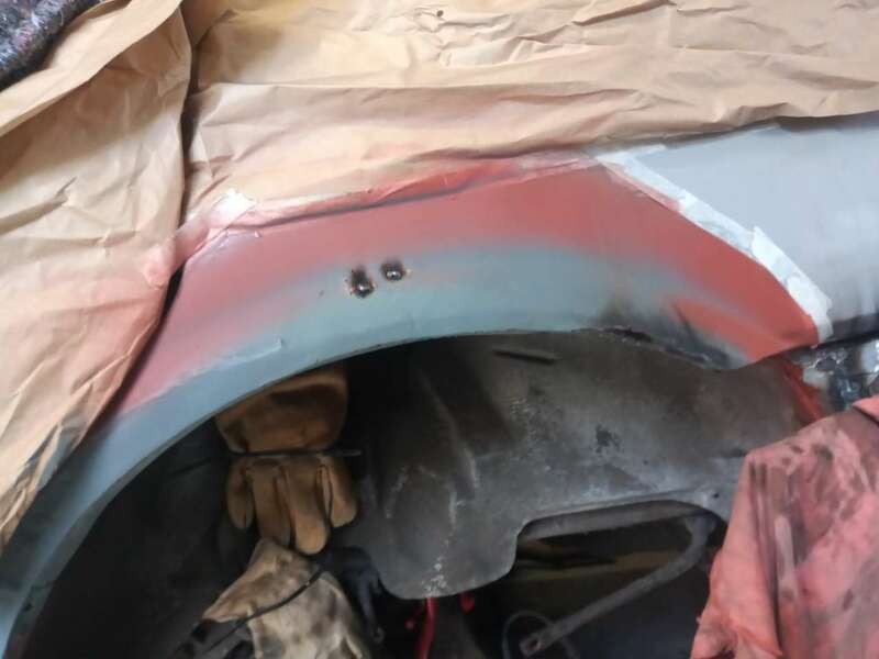

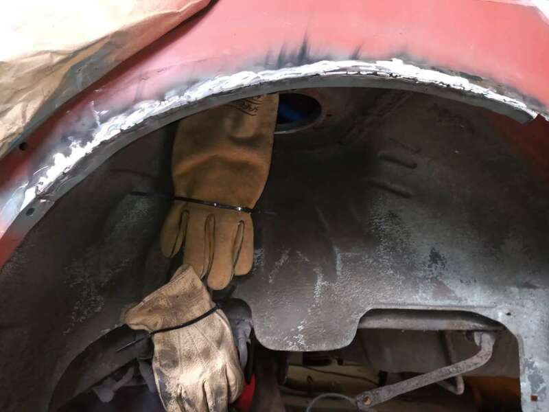

Another Rover update, more sparky, zappy grindy work. This time I am attempting to put the lip back  on the wheel arch, yet again I have failed to provide a decent before picture but suffice to say the wheel arch looked like this but in red primer - pic borrow from page 2!
IMG_20230302_165716187.thumb.jpg.411609f2f21fd62afeb68a252be84c34.jpg.d1a818924f3bafaea8eb85a864103e13.jpg
And as you cannot see, cause the angle is wrong, there is no lip!
After a bit of head scratching I managed to clamp a strip of metal in place and started tacking.
Then slowly worked my way around it. Cleaning up the welds as I went.
I ended up with a slight issue the, the strip of metal making up the lip is pretty straight the arch curves back in at the rear leading to an overlap.
I attempted to cut this off with shears, couldn't get a good angle of attack, so I took the grinder to it with a slitting disc. This started to cut nicely then caught the metal and twisted it out of shape! A bit annoying I ended up having to cut the very last couple of inches off so I will need to to the last but separately.
Oh yes and I managed to blow an annoying hole in the arch and couldn't fix it as I ran out of welding wire! So I painted it with weld through and ended it there for today.
Spot the mistakes!
That's all until my next bit of spare time.

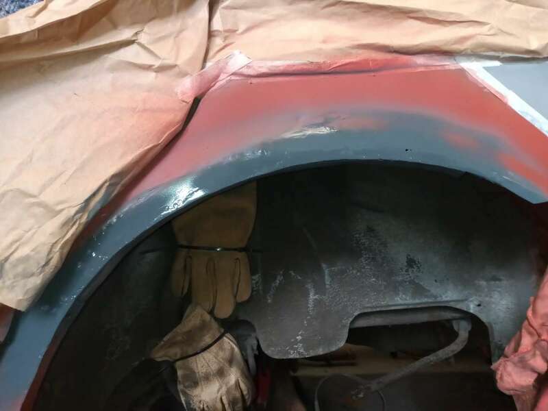

I have to confess I got a bit fed up with the fillering, not helped by the fact I had to undo some of my work to expose a hole in the wheel arch which is a trim fixing point.
No fixing point
Now with some primer and a hole, just by the door trim.
It took ages to get to that point and my second go at fillering really wasn't as slick as the first but at this point I  did not care!
More primer, then paint (allegedly the correct colour) was the applied....
Just try not to look to closely at the pictures..
The good news is that the metal is now slathered in nice protective paint and the sills also have a load of dynax wax oily stuff in them, they have no excuse to rust. The not so good news is it just doesn't  look that great.

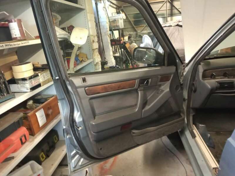

With that kinda done, time to re fit the drivers door. Theses doors are heavy and awkward, my method was to sit the door on a sturdy box then lift it roughly into position whilst my better half carefully fitted the bolts, definitely a two person job. So no pictures to document the processs as we both had our hands full but here is a sort of before and after....
Ta dah... Ta door ?
Starting to look like a car once again! Also if you look at the wing you can see the two tone effect, the supposed correct paint doesnt look very metallic and isn't the same colour......

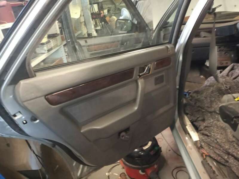

Door wiring looms re fitted... It took me a while to figure out all the plugs on this. After plugging in the electric window motor and the central locking connection, I still had this little lot hanging out of the door.....
For starters the plugs in the dark blue circle are for the wing mirror but one of them is redundant! The multi plug in the red circle is for the window switch, the green circle is for the speakers, with little extra connections you cant see for a tweeter that was hidden in the door handle surround and finally the oval I figured is the door light.  This makes canbus looks like a really good thing....
Door cards back on...

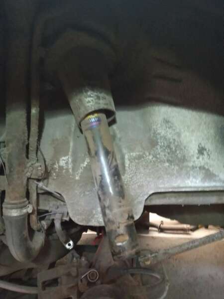

One damper back in, managed to find 2 out of the 3 nuts that secure it at the top 🙄

Slinging the 827 back together continues....

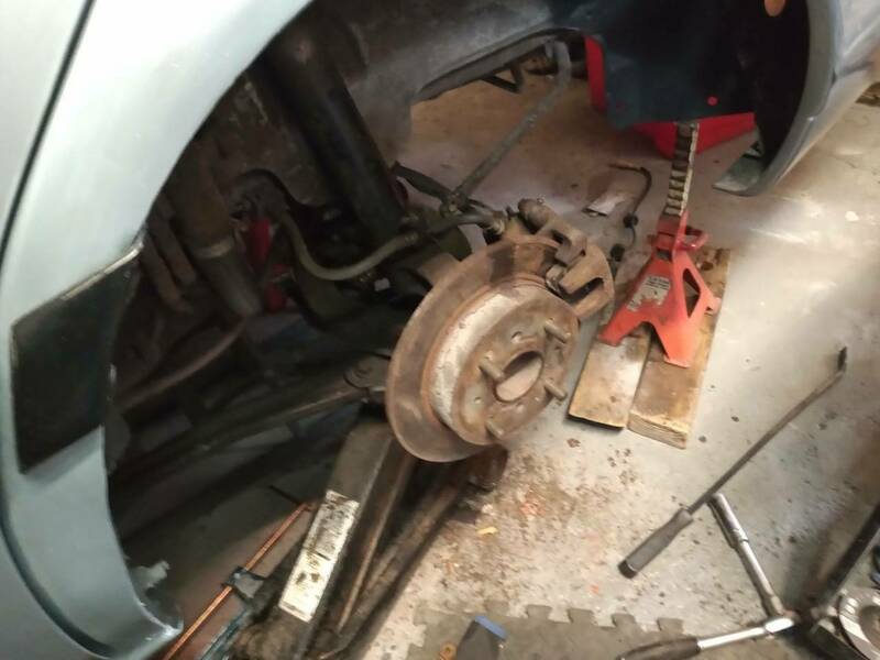

Suspension assembled, ignore the state of the brake back plate!
Brakes back together and trailing arm on....
Front wing wanged on.....
Wheel back on, bonnet shut, you could be fooled into thinking its nearly a car??
Fin!*
*For today
