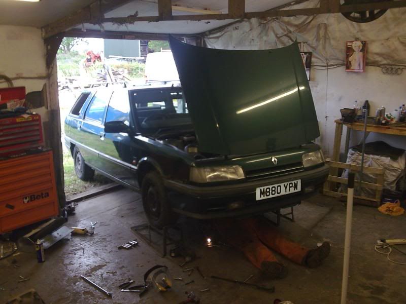

A little bit later than planned, this £40 21 gave up its gearbox...
Posted Image
Posted Image
Car looks okay in the pics admittedly, but had rotten front wings, crossmember, backs of the n/s sill too. Interior soaking wet as it'd been laid up on a farm for a year with a broken window. And full of dog hair. £150 over the weighbridge though.
