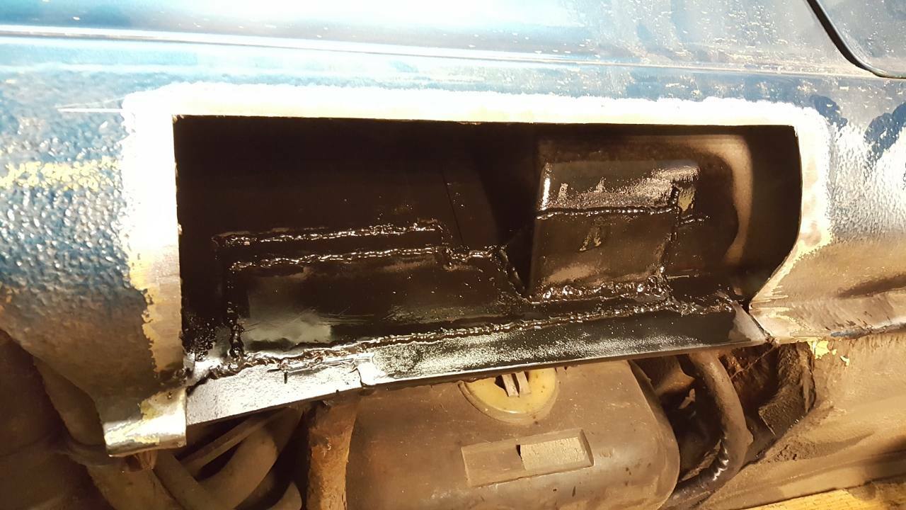

I've got quite a few pieces of sheet metal, making the pieces should be ok. It just won't be pretty.
I've cut back this far, can't do any more until I figure out how to remove the fuel tank (Haynes manual ordered) .

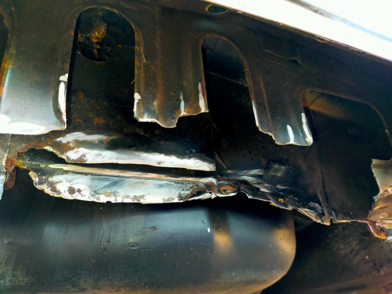

Unfortunately found this when working, this will need attention too.

Making a sill radius like that is a piece of piss without tools, even in .9mm zintec.  Just stick it on the edge of something approaching a decent workbench/kitchen worktop and push down on either side. Then beat a return onto it if needed or stick it in between 2 bits of angle in a vice if available.
As suggested earlier I'd personally cheat and stick a bit of flat bar in as a bottom edge and fill in the gaps using as large a piece in each spot as you can get away with to minimise work.
Set the piece back by a Gnats knacker, skim of filler and it'll disappear*.

Think yourself lucky it's not 4 feet of inner sill repair plus various other bits and 6 foot plus of full sill on both sides you've got to do, while keeping it ripple free.

Bloody hell, thats great work! Its much better than I thought it would be. To me, the two best times when doing a repair like that are when you've got to the limit of the rust and can sweep all the sparks and crap up, and when the welding is finished with the welds dressed and ready for filling and painting. Again, when you sweep all the sparks and bits of stray welding wire up. It's all good therapy!
