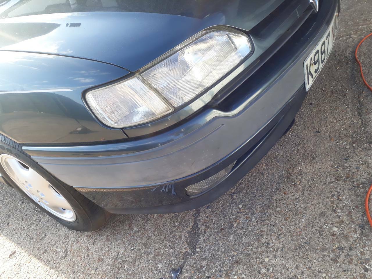

I cant help myself really. The car got a very quick wash down yesterday ( a bit waterspotted now but meh! ) but the wheels are just so far gone. Seems they would have had a machined lip when new. I this isnt a pressing issue so With me setting a limit of about an hour a wheel and whilst drying between coats i cleaned up the brakes i gave them a quick refresh.
They do seem a bit "car dealer silver" but its fairly close to the original paint.
With the front wheel off, the brake caliper on this side was siezed up. Some in and outs and a bit of lube has got it good enough to allow the wheel to roll and the brakes function . A full strip down or replacement will be needed.
The Faded trim recieved some goop and the front wheel got a splash of silver. Both wheels are 8 footers but so is the rest of the car!

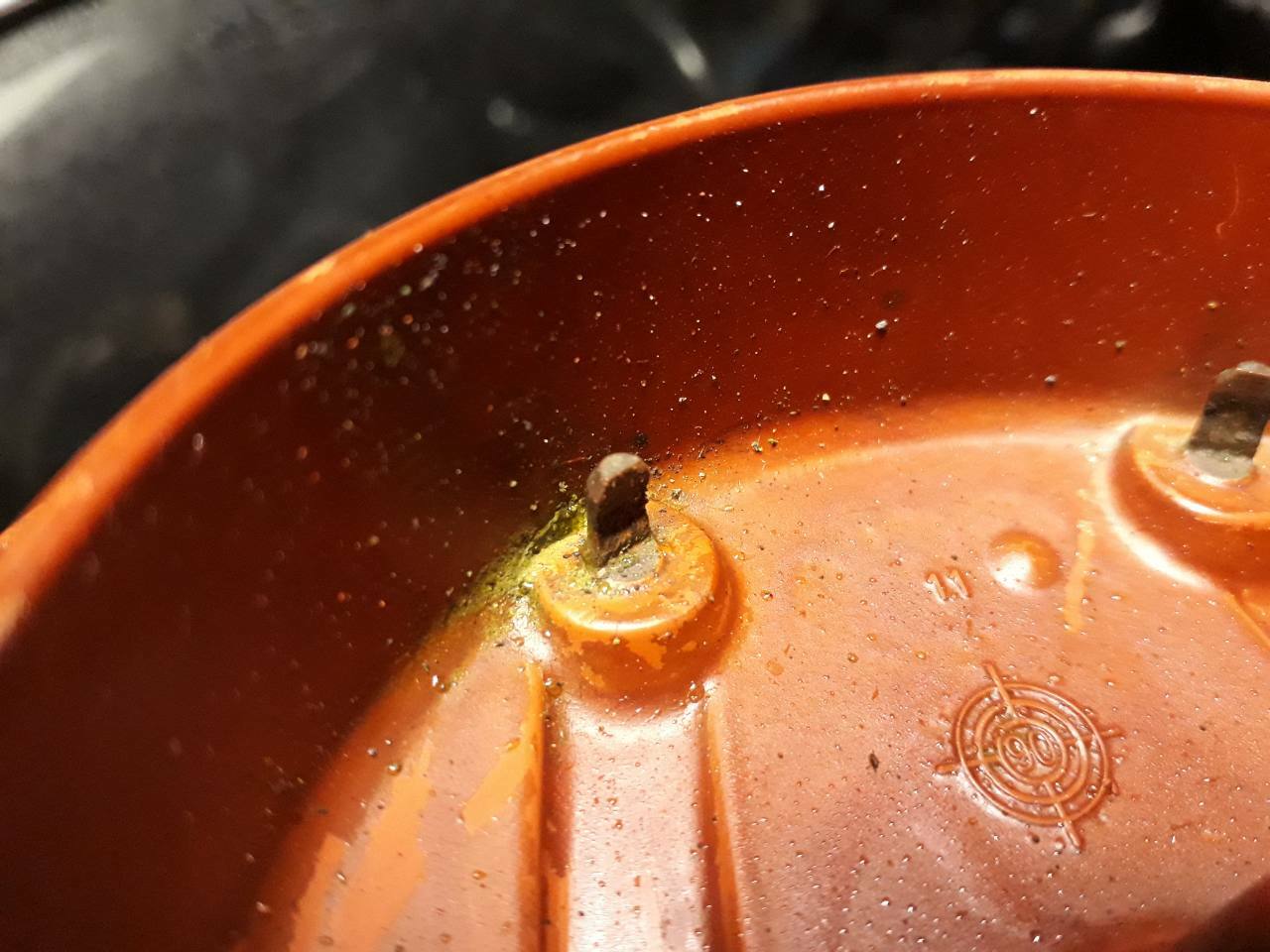

I can't imagine it'll be anything other than a tuneup. There's definitely some corrosion going on there that shouldn't be there...
The photos a bit blurry but the contacts are all worn away aswell.

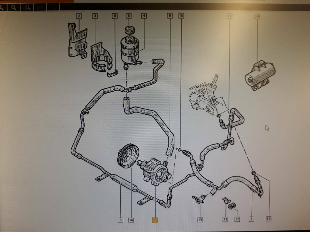

The steering appear to be leaking from two places. The tray under the rad is full of PSF.
The main point of concern is a pipe that seems to expand and go across the bottom of the rad area to something under the n.s headlight. Its very heavily corroded near a flexi part.  But i cant see a returning line?
I couldnt see any deets for rhd set up in the books but did see it mentioned about power steering  that adjusts its assistance with speed and other factors. So im wondering it its going to some control unit.
Untill i get the car up on the lift and the undertay off im at a bit of a hault.
Hopefully i can repair the pipe or if it goes off to some uneeded tat module then maybe i could blank it off?

So the leak appears to be on the low pressure side . The main leak i can see at the moment is at the little 90 bent near the yellow square. This is handy as i was dreading it being the high pressure side!
Handily the details all work on our partlink24 system at work so i can get diagrams etc etc for the car.

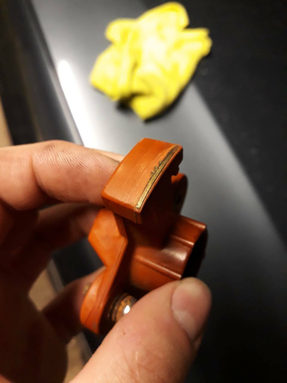

I also found another dizzy cap and rotor arm in facet brand on ebay as i had the part numbers to search for them.  So that go those down from nearly 60 quid! to £27.45. So it lucky it has no fuel or id have fitted the more expensive ones already.

A rotor arm, a dizzy cap and after realising it had a remote keyfob to deactivate the imob.  And . . .

No , the cap was shot to bits so would cough and splutter.

Glad to see this is now moving under its own power again - funnily enough, when my Mk1 Laguna failed to start after being laid up for a couple of months, it turned out to be down to the central contact in the distributor cap crumbling to dust. New cap and rotor arm saw it right. Hopefully you're on a winning streak now!
