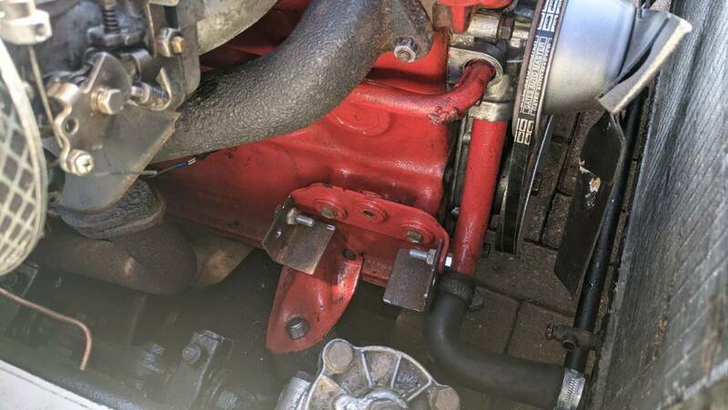

Fitted the remaining coolant pipes and dynamo.
Then realised I forgot to fit the oil pressure switch which is right behind all that..
Screwed that on and.. for fucks sake!
How I managed to snap that by tightening by hand is anyone's guess.
Off with the manifolds and dynamo again to get access..
It did however come out easy enough with a torx bit hammered into it. Thank fuck.
Also, thankfully I have another working switch.

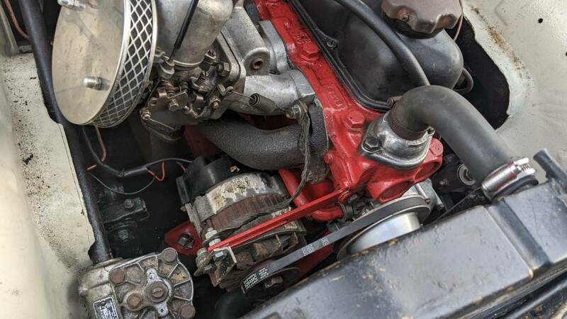

And now to see if all the work that has went into the engine has paid off. Filled engine with oil. Hooked the multimeter into the oil pressure switch, then hotwired the starter motor to turn the engine over.
Success! The oil pressure rose quickly and cut the pressure switch. Can also clearly see oil being pumped through the rockers.
Next I thought I'd do a compression test. The results here were inconclusive as the starter is turning so slowly. I got pretty much the same 50psi on all four cylinders. I suspect the engine is just turning too slowly to get an accurate reading, but them being all the same is encouraging.
Why the starter is turning so slow is another issue, it might just need a better ground point.
Still, not long off till I can start this off a fuel can.

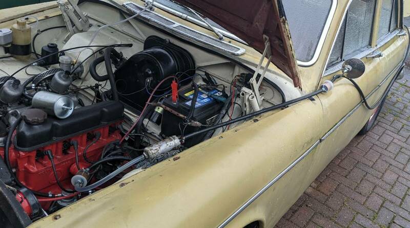

I'm not going to build up the dash just to turn the engine over so I've hotwired the ignition using croc clips and jump leads and taking fuel from a jerry can.
Firstly couldn't get fuel up then realised the pump is leaking. I fitted a non return valve after the pump which was enough to get fuel to the bowls.
Well that's the very first turn with fuel in the bowls, and it's very encouraging. It really wants to live but it sounds like it's pinging like mad.
19 BTDC? Really?
Let's sanity check that by nudging the dizzy back to around 8 degrees.
Holy shit.
I'd planned to spend the entire day messing round with this and it only goes and starts and idles lovely. At this point I was really thrown and didn't know what to do.
A few issues. A couple of coolant leaks that just need nipped up.  Valve cover throwing oil out everywhere. Float bowls could do with new gaskets.  But very minor things and I'm well happy!

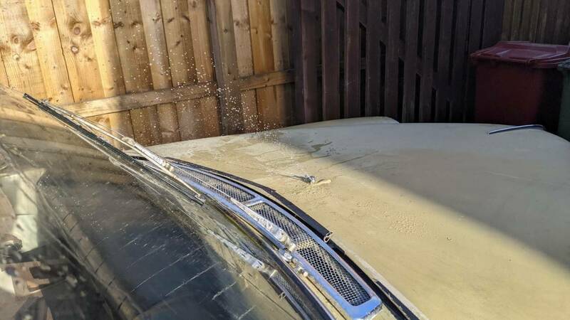

Voltage regulator and washer pump.

Well here goes.
Out of the naughty corner at last.
Some issues.

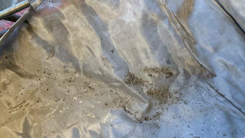

The fuel filter very quickly looked like this.
And the contents of the float bowls.
Cycled the contents of the tank through a series of filters for around 3 hours using an electric pump.
The next attempt wasn't much better.
Could go through a pallet of filters in no time so I set up a syringe with a bit of hose that I can use to backflush the filters with petrol and refit them.
Have also stuck an uberfilter on. This is a fuel injection filter for a Volvo T5 so it should stop this shit getting into the carbs.
Seems to be working. Here is the contents of the filter flushed twice.
Float bowls are still clean so that's something.
Still plenty of work to do.
