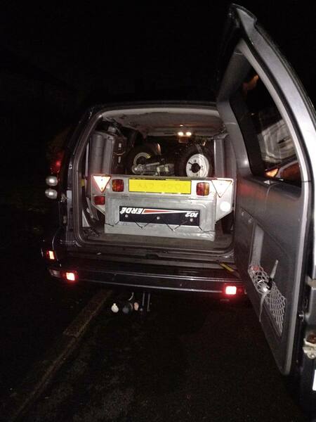

Hooked up the trailer and we had a total of 1 intermittent light.
Not sure if this is trailer or vehicle electrics and not really wanting to try and figure it out in the rain we dismantled the trailer and whanged it in the back of the mighty Land Cruiser.
Our correspondent was dispatched in the general direction of The South with a packed lunch of GT85.

With the help of Dave though, and copious amounts of GT85 (now with added PTFE) they freed themselves up. So yeah, probably sat there for lockdown and seized up. The seller knew something was up with it as he told me he changed the wiper blades, as Dave can testify the sound was like the blades screaching. So I wouldn't say the seller was totally at fault, I would just say it's one of those things.
Any way, here's aubergine cam of the trailer...

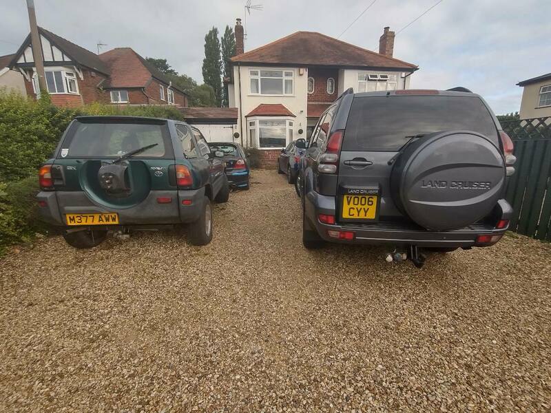

The morning always puts a different light on things. As one comes in, the other must go:
As the RAV4 gets collected today.
What I didn't realise though is that my new Land Cruiser is near enough the same colour as my Peugeot!
Like Twins really!
