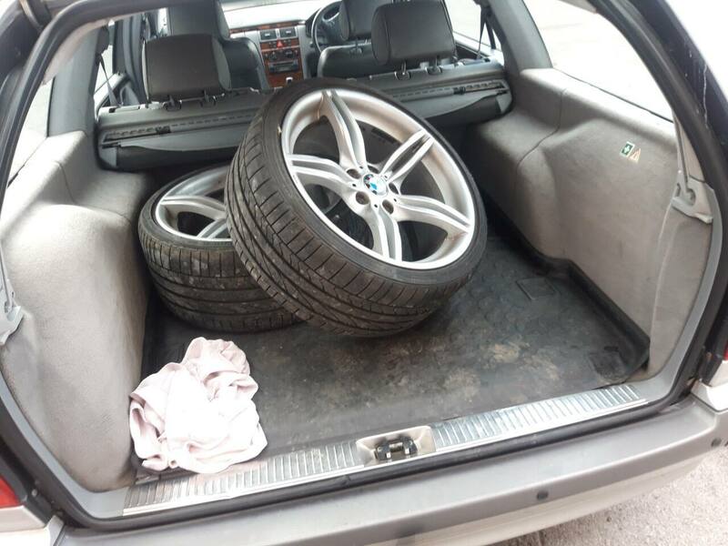

I just had to take some wheels to be welded on the most modern and shite car in the fleet!
A quick look on the internet confirmed this is a very common problem on the ridiculous oversize wheels modern cars come with.

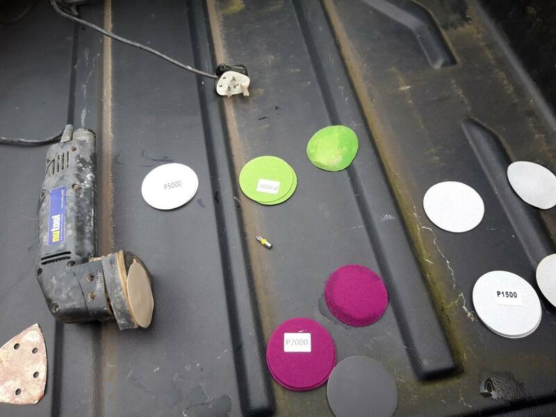

They came out quite well but I need to give them another polish before applying a UV film.

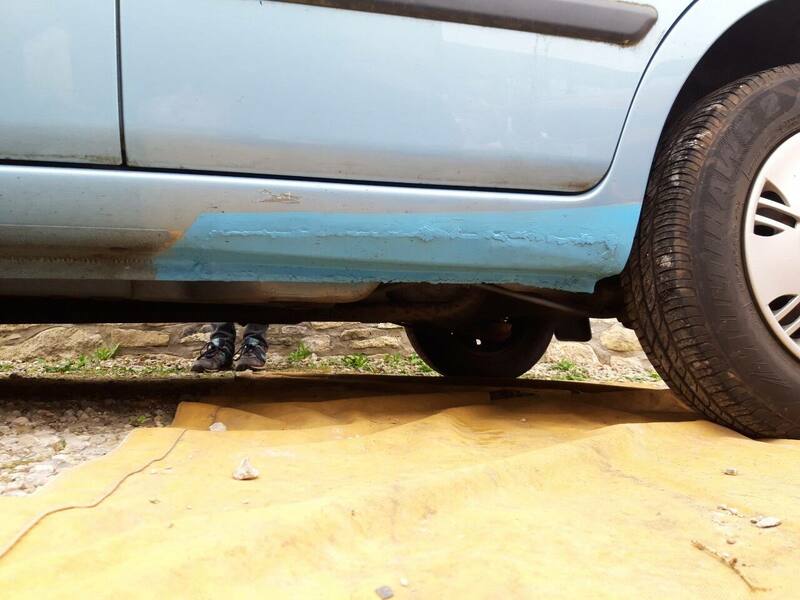

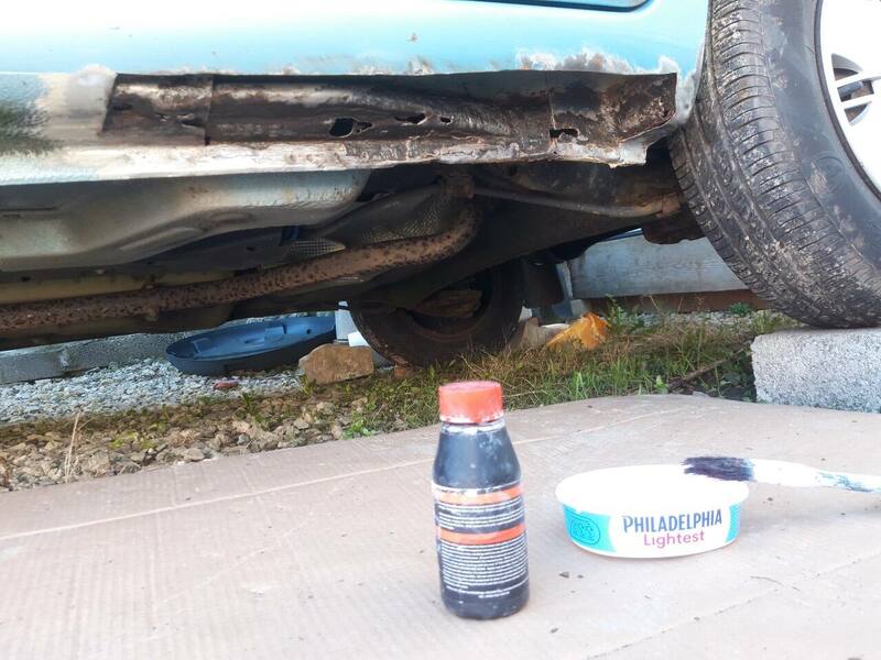

The panda failed on brake imbalance and welding
I had paid a garage to get it through an MOT a few years back and the bodge lasted longer than I expected to be fair. I know the car needs a new sill but considering it is over 16 years old I am Impressed that this is the only welding it has needed. The garage quoted £300 to patch the sill, I bought a new welder over a year ago and had not yet got it out of the box so the saving o doing it myself paid for half the cost of the welder. There were two tiny holes either side of the plate which you couldn’t fit your little finger through so out came the wire wheel:
No idea why the picture is upside down, but it would have made the job easier!
I partially stripped the interior
Then started cutting and cleaning
A template was made using a weetabix box
Then some suitable metal was found and repurposed
The area was then cleaned and painted with zinc primer before welding:
I didn’t take pictures of the welding but am impressed by the R tech although I should have adjusted the settings using some scrap metal rather than as I went along.
I applied some primer then the closest spare top coat for protection. I may tidy it up again with stone chip and a better colour match if I ever get the time. The brake issue was a pad jammed in the caliper so all pistons were checked, the pads cleaned up and refitted with copper grease. It seems the pad got warm so I will buy new pads soon to fit but the Panda passed its MOT yesterday so is back in use. It took nearly two months as I was working outside and two very nasty storms caused damage to the two polytunnels so repairing them also took up some of my time when we finally had dry weather. Then when the car was finally ready the garage were booked up for the next 10 days until they could fit it in.

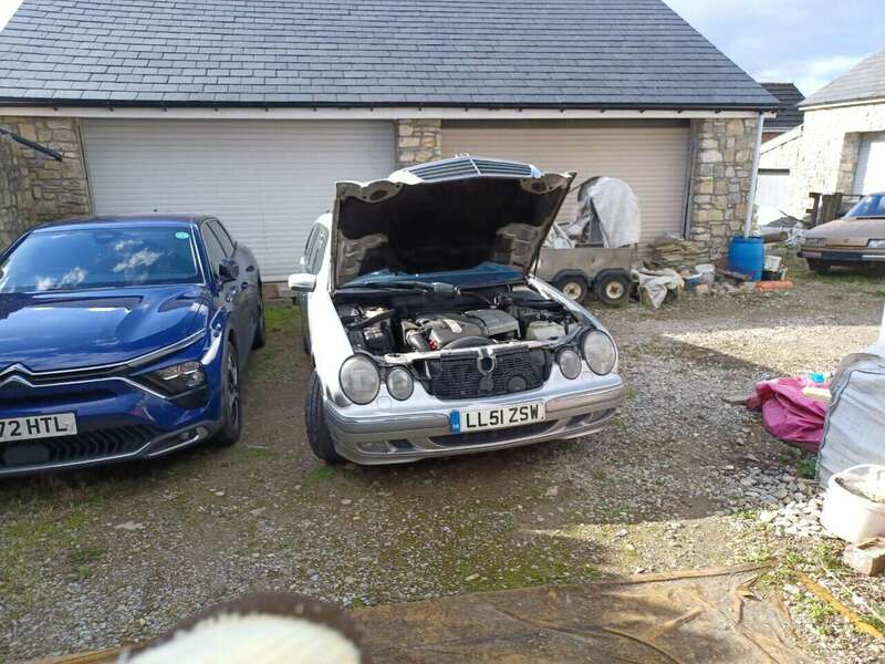

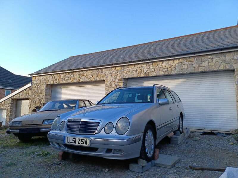

Sunday I thought I should make a start on the Mercedes and have a look at the welding, first I had to move the Rover,  l managed to push it on my own but  was not strong enough to move it the last two feet on my own so came up with a plan which surprisingly worked well:
With the Rover moved it was time to get the Mercedes in a position to work on but the battery was flat so I had to jump start it off a spare battery.

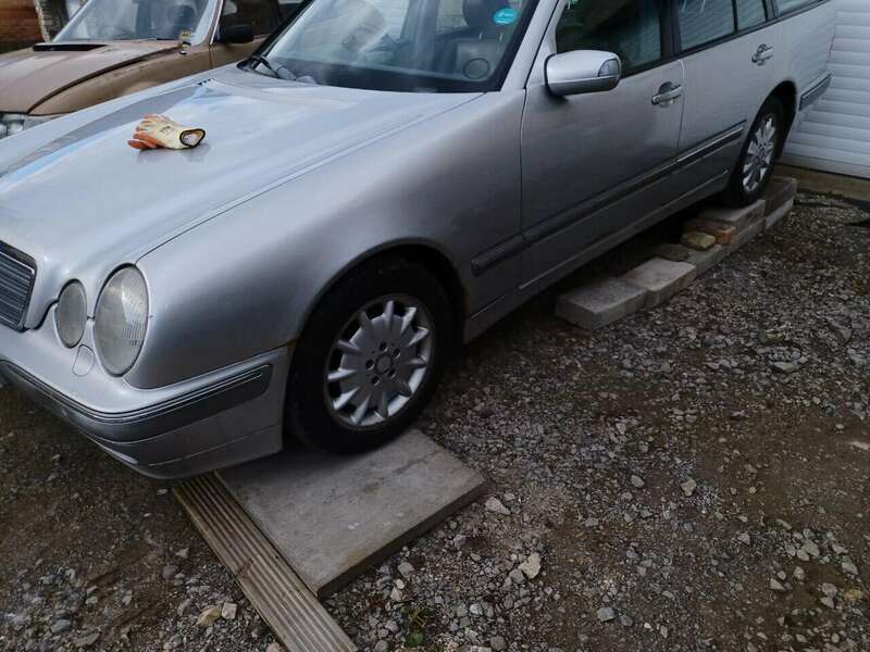

Once started it was time to get it high enough off the ground to get underneath and investigate.

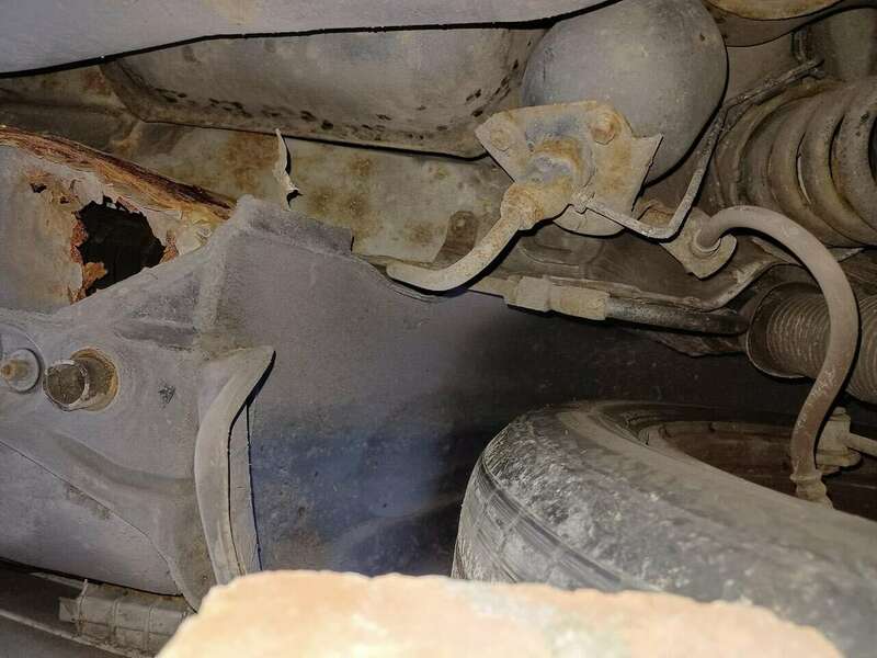

After crawling underneath and having a look around the area described there was no yellow crayon and the only hole was this:
This hole was here last year and noted as non structural which is clearly correct. Am I missing something or is the tester a complete tosser?  I am thinking the latter as although the tyres are on the limit there are certainly no canvas or wires showing as written on the failure sheet. I will weld the wheel well as it is something I was intending to get round to but do not see how this makes the car unsafe and unroadworthy!

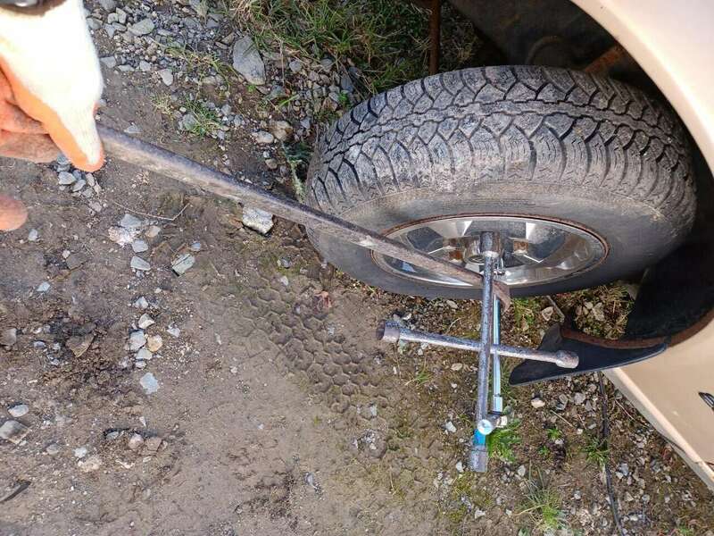

Whilst removing the spare wheel to gain access to the other side I had a helper

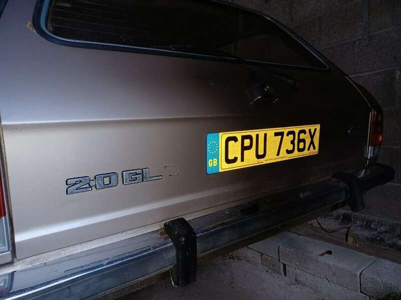

Before clearing space to get it in a garage I tackled the stickers.
Much better, all stickers are now removed but I didn’t  take a finished shot.

I used fancy plates online for period correct font plates for my ‘97 ZX. Results were very good.

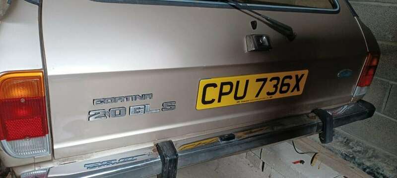

Weird re the badge alignment as all the photos I see show it like this:
I’ve found PB Blaster to be really good and penetrates so much better then WD40 which isn’t really a penetrating fluid. Think is American but easy to get on eBay.
I’d also like replacement “dealer” plates so will look up @GregZX  supplier he used.

Sorry, I just wanted it to be correct, as I’m sure you do:
Thanks for posting the picture, it is not one I have seen before. I agree that it is important to get these things right the Venus Gold car you posted first is probably correct as the Cortina badge is around 10 mm to the right of the 2, I was not too careful on fitting the badge on mine and it is probably a few mm too far to the right but closer to correct than being in line with the 2. The badges all need replacing when the car is sorted but better than nothing for now.  I am very happy with constructive criticism so nothing to be sorry for.
