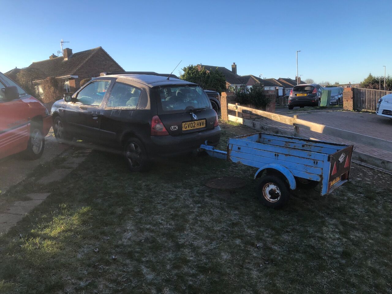

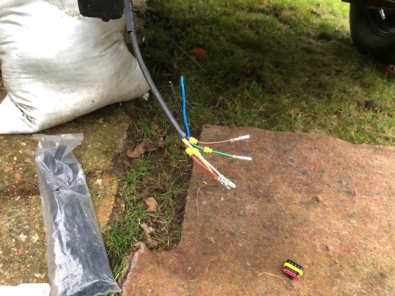

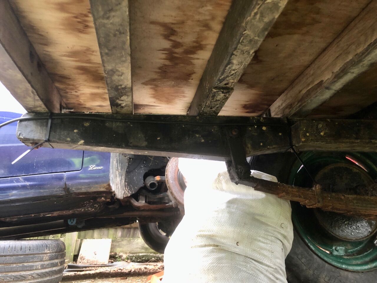

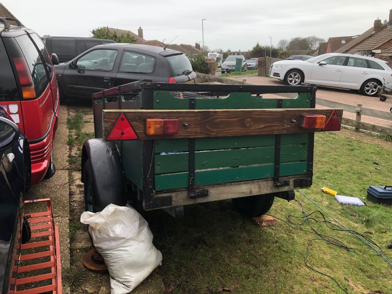

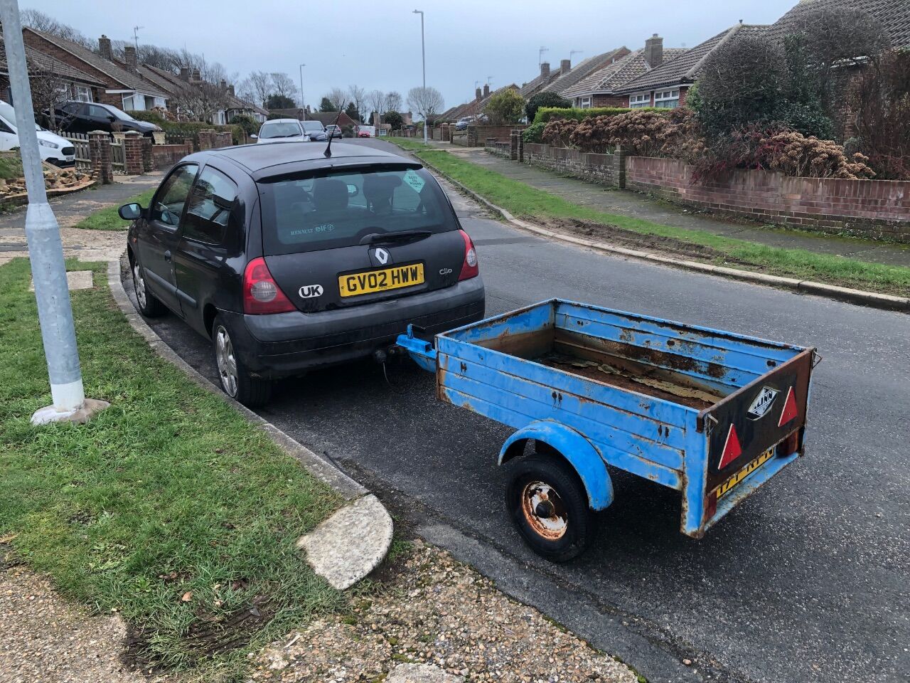

Rust Collector Posted January 11 Author Posted January 11 This weekend I spent a bit of time on the trailers, as I’ll be needing to do a few tip runs and so having the trailers in a useable condition will be a big help. Plus, we all know what happens when I bring in a project and then don’t get straight on with it. First up was the small trailer. From my quick glance over it when I got it, the points that needed sorting were: Sort out the wiring for the lights. Service the bearings. Pump up the tyres. Fit a safety chain. I set about the wiring first, as this is normally the most tedious job. My first impression was that the plug had been cut off the wiring, but when I was unable to pull the wiring out the draw bar it was revealed that the plug was lodged inside. I had to get a bit creative to pull it out. What then took place was a complete faff of bad earths, bad connectors, and me mistakenly assuming that the trailer plug on the Clio worked correctly. After realising the car was throwing an unknown variable into the mix, I made this fire hazard and did a bit more diagnostickery. I bodged in a waterproof connector temporarily* too. This dicking around, plus some contact cleaner, resulted in a full compliment of lights. I took the trailer for a run around the neighbourhood just to see how it towed. Verdict: I can probably ignore the bearings until I want to do longer journeys (the tip is about 5 roads from my house). Fuck me do small trailers take off when they hit potholes though, I definitely need to get a cargo net for it otherwise it will be vomiting my junk out along the way. Big trailer next then. It had a trailer board that was made for it, so I took off the caravan board I had on it and fitted the wooden one that it came with. It looks a bit derpy, but the width matches the wheel arches and the height has presumably been determined to avoid smashing the lights when the tailgate comes down. Wiring next then: To my amazement, when I tested the wiring I found only one bulb wasn’t functioning. A splash of contact cleaner later, and I had all the lights working. Again, I fitted a waterproof connector. When I can be bothered to find my heat gun, I’ll shrink that heat shrink. I had a length of 7 core cable with a plug on it in the garage, so I ran that under the chassis of the trailer and cable tied it on. I followed up by throwing on the other end of the waterproof connector. Job jobbed! I’ve tested them from the plug, and they’re all working correctly at present. I need to clean and grease the bearings on this, as they’re missing their caps… I will replace them (the bearings and dust caps) prior to any long runs, but again tip runs shouldn’t be an issue. Longer term, I need to replace a bit of woodwork, sort out the floppy wheel arch, and fit a safety chain, but otherwise we now having working brakes and lights which is a bonus. Speaking of brakes, I did free up the handbrake on a lunch break earlier in the week. I’m struggling to ID the brake drums, but I have a feeling they take 10” shoes from a series Land Rover. If anyone can ID them from those pics then go straight to the top of the class. Meanwhile, I’ve thrown some crap in the trailer and then chucked a tarp over it to make it slightly less of an eyesore. Another storm is blowing in here, so place your bets now as to whether I still have a tarp in the morning or not. rob88h, Split_Pin, N Dentressangle and 12 others 15
N Dentressangle Posted January 11 Posted January 11 The big one is a real farmer's job IMO. Those wheels aren't LR Series so maybe something else of the era? Will probably manage a ton if you're brave enough. Usually to be found with a 2" ball hitch IME. The little ones bounce around like a mad thing, aye. Still not had one roll itself, mind 🤣
Rust Collector Posted January 11 Author Posted January 11 2 hours ago, N Dentressangle said: The big one is a real farmer's job IMO. Those wheels aren't LR Series so maybe something else of the era? Will probably manage a ton if you're brave enough. Usually to be found with a 2" ball hitch IME. The little ones bounce around like a mad thing, aye. Still not had one roll itself, mind 🤣 That was my first impression too, but having been under it the chassis and bed were built with more thought than any of the home builds I've seen so far. I checked the coupler before towing it - it's a Bradley and it's got 50mm cast into it. It's on cross plies rated for about 800 and something kg on the axle - I think I'll keep it under that though! Yeah, I never managed to roll my other small trailer, but I did think it was coming through my back window once when I forgot it was there and took a speed bump enthusiastically 🤣 High Jetter, adw1977, Noel Tidybeard and 3 others 3 3

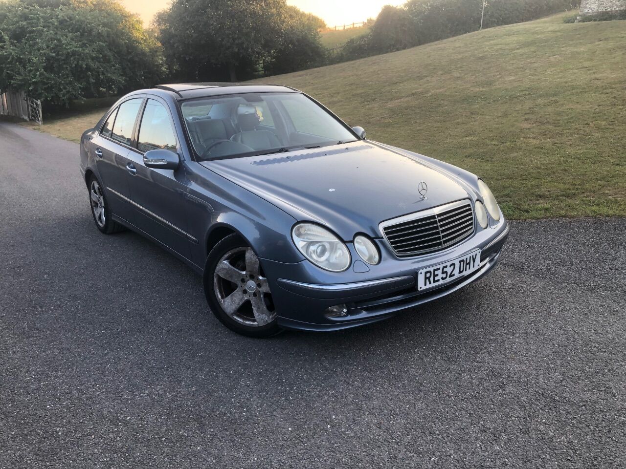

Rust Collector Posted January 17 Author Posted January 17 It’s finally judgement day for this old bus. Wish me luck… rob88h, JMotor, CaptainBoom and 4 others 7
Rust Collector Posted January 17 Author Posted January 17 Thanks chaps. I’ve treated it to a bath, complete with mood lighting. I’m now wandering around Lewes to pass the time. Shame I can’t stop for a pint of Harvey’s! Brigsy, Coprolalia, Tickman and 2 others 5

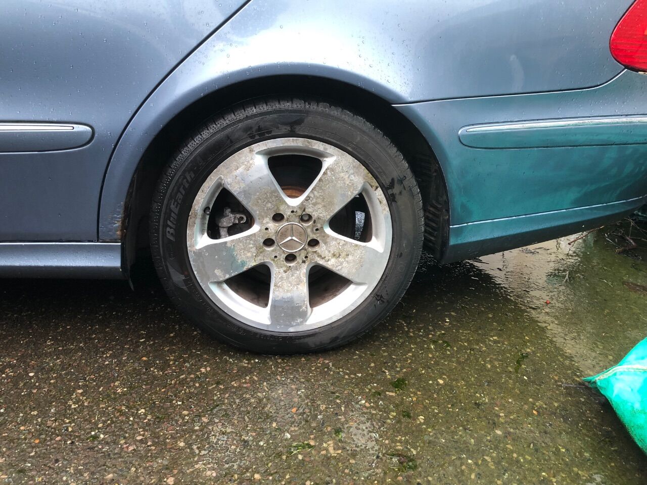

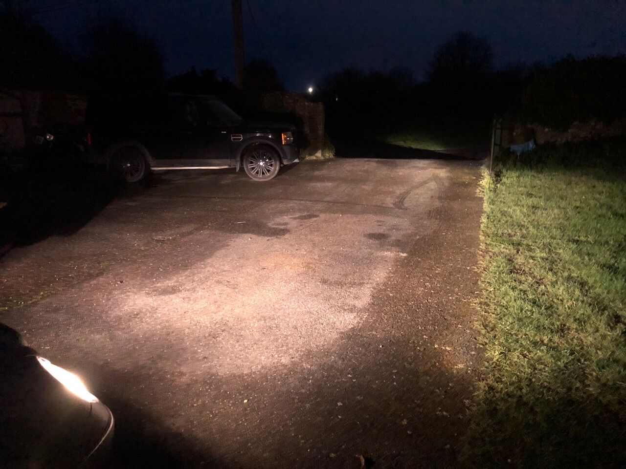

Rust Collector Posted January 17 Author Posted January 17 Close! But not quite there yet. I noticed the headlights were pointing at the floor on the drive there - I suspect seized linkages. Otherwise I just need to order and fit some suspension parts and we will have a useable E320 again. Considering it’s not the biggest engine in the world, it moves itself along pretty quickly - I was definitely enjoying the drive home, and look forward to this one being roadworthy again. Surface Rust, Tickman, catsinthewelder and 15 others 18

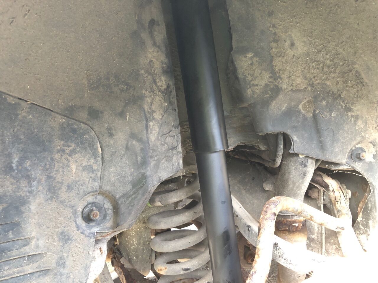

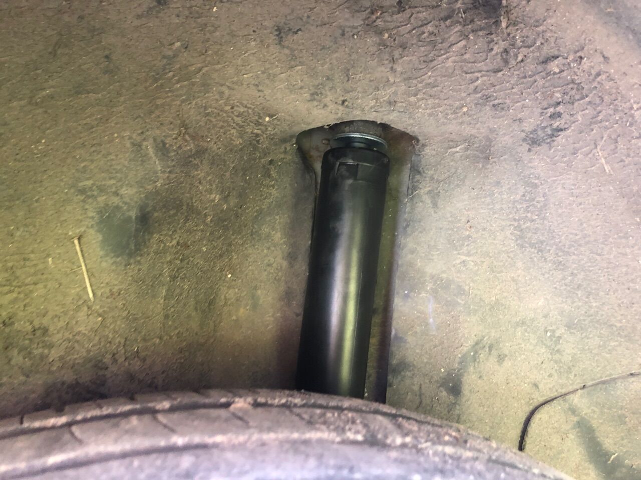

Rust Collector Posted January 24 Author Posted January 24 Some parts arrived (emphasis on the ‘some’, as the ball joint didn’t turn up whilst I was working today), so I decided to crack on. I got a pair of shocks from Germany for £notmuch, so these are now fitted to the car. The old ones were fucked, they were properly crusty and had oil pissing out the tops. I noticed that the car sat a bit low on one side afterwards, and so had a look through some video footage I took (this job will also get posted up once I edit it, sorry folks 😅). Lo and behold, the offside rear spring has snapped. Not sure if this happened after the test or before, but is presumably a problem if it goes back for a retest and the man from the ministry sees. Finding the right springs for this Mercedes is agonising, they are all coded by the weight of the car and options, plus if they’re lowered or not. I’ll have to figure that out sharpish. Also, I noticed that the rear lower control arms aren’t great. I definitely wouldn’t be happy to sell the car with them as they are, so will need to replace those too. I can’t really afford to do both in one hit though, so it may just get a pair of springs then get launched in the yard whilst I sulk. Coprolalia, Brigsy, Tickman and 13 others 16

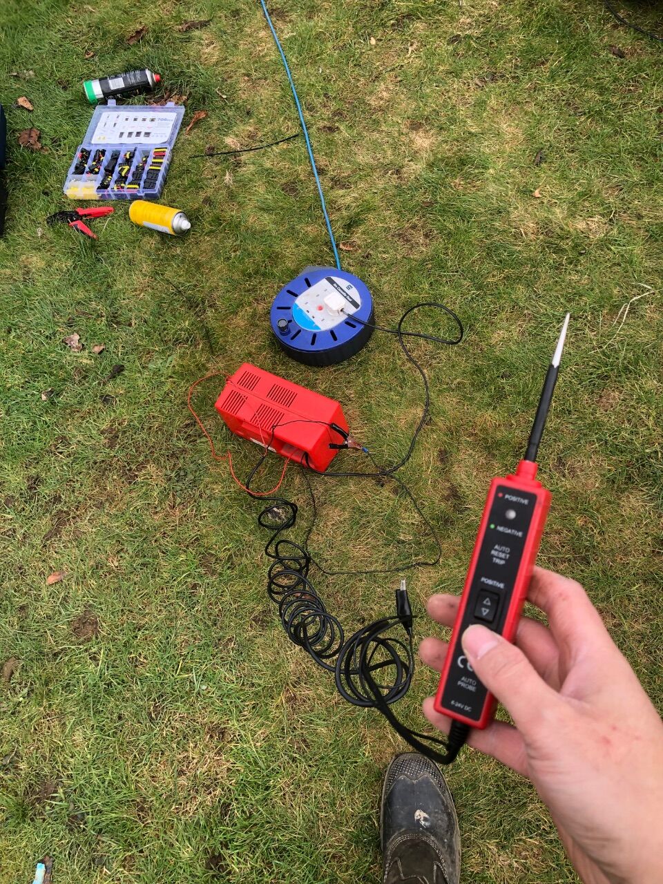

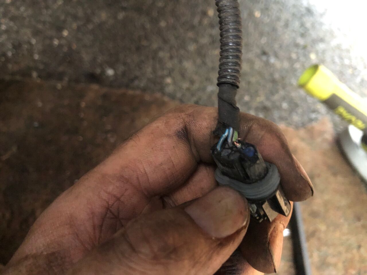

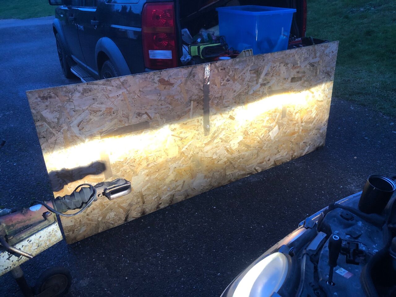

Rust Collector Posted January 25 Author Posted January 25 Fuck me, I don’t ever want to change one of these ball joints again. The amount of leverage needed to press it in was a bit silly. I had previously resigned myself to removing the whole knuckle and putting it in the press at home, but the larger ball joint on the front arm had other ideas. RIP my biggest ball joint splitter. We got there in the end though. I also investigated the problems with the headlight levelling system. The connector was feeling a bit sorry for itself. I’ve managed a bodge that’s fixed it, but it kind of works. I then cleared the code in the headlight unit, adjusted the lights and I think it’s good* enough. Possibly. Thats much better than before. Split_Pin, grogee, jim89 and 16 others 19

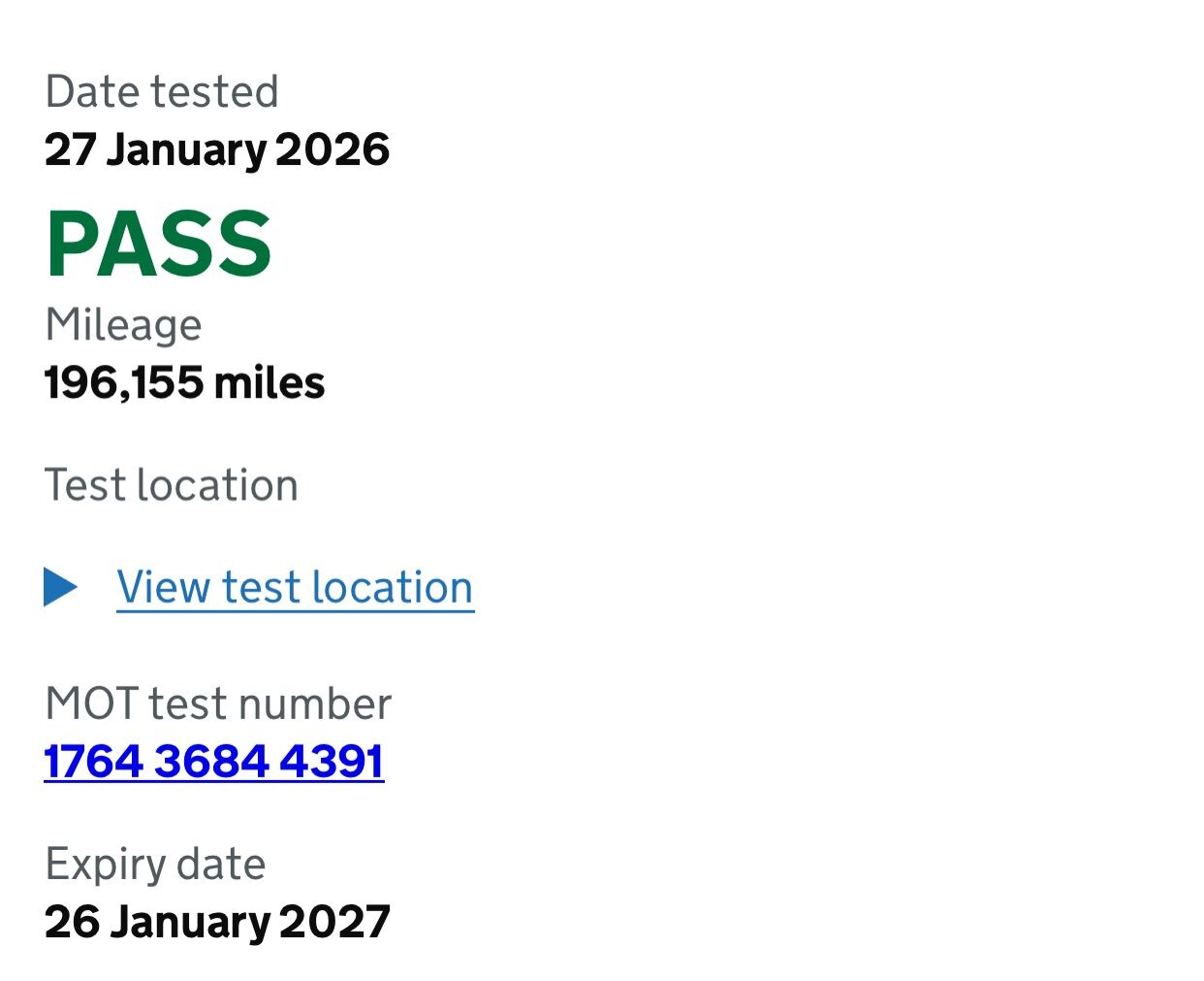

Rust Collector Posted January 27 Author Posted January 27 Good news everyone! The Mercedes now has a ticket. I will replace the rear springs and lower control arms before using it in anger though. Once I’m happy that it will run reliably without the imminent risk of shitting its pants then it’ll be ready for a new home. rob88h, Matty, Tickman and 16 others 10 9

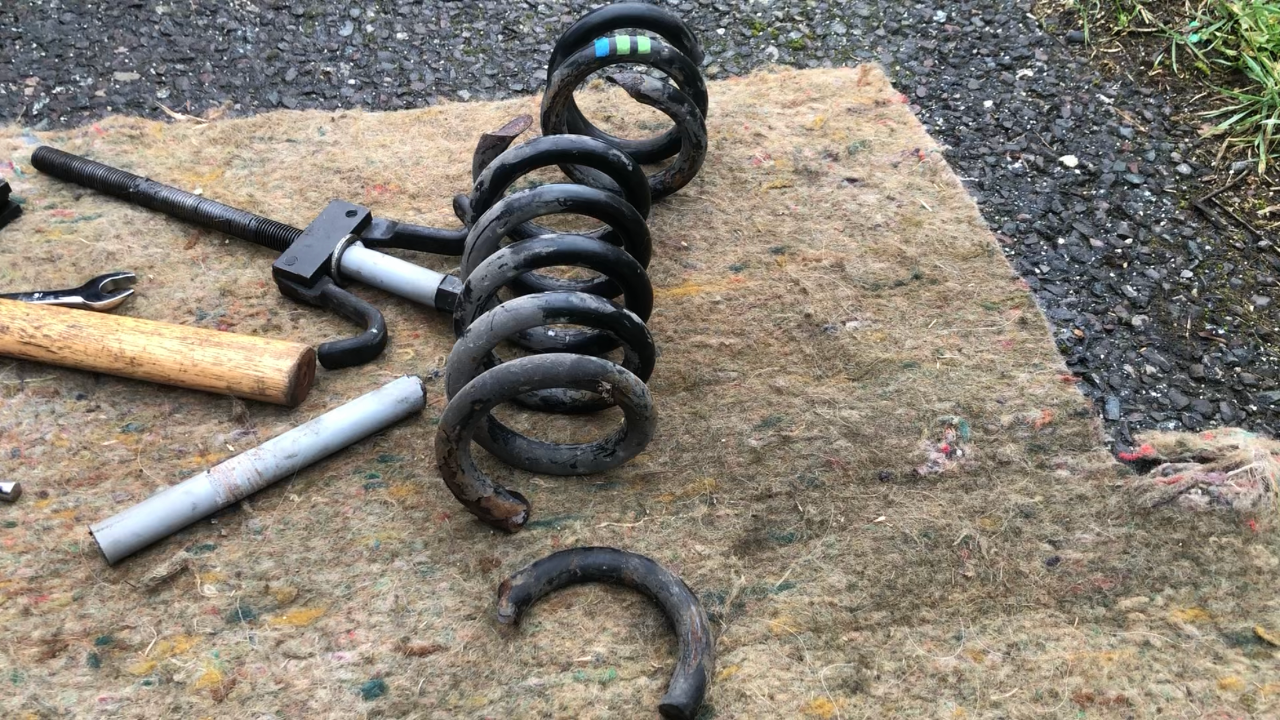

Rust Collector Posted February 1 Author Posted February 1 It’s the first of the month, so I wanted to start using the merc. I thought it best to replace the obviously broken spring first. The best* tool that could be bought for next to no money was employed. I’d have preferred a Chinese copy of the proper* tool, but that will have to wait for another day. I will point out that whilst this tool was about a quarter of the cost, it was probably 8 times the effort to use, so I probably should’ve just spent the cash. The tool I’ve got would’ve been absolutely no use without the metal tube spacer I made from a lawn chair. Next time I’ll use an old jack handle or something as the force of the spring was rolling the thin wall tube over. The old one was worse than I thought: Broken in 3 pieces but still in place on the car has to be pretty good going. Fitting the new one was an absolute bollocks, again I should’ve just spent more on a better tool and then I’m sure it would’ve been easy. The lower control arms are properly crusty, and definitely need doing sooner rather than later. At any rate, the immediate problem is fixed. Before: After: I can’t say I noticed any difference in how it drove afterwards, and I’m not sure if that says more about me or the car. It’s a nice place to be though. Part of me can’t believe it’s back on the road and useable, as it felt like it would be a back-burner project forever. I’m looking forward to taking my son to nursery in it tomorrow, he’s been excited that we’re getting ‘grandad’s car’. crad, Sigmund Fraud, LightBulbFun and 16 others 19

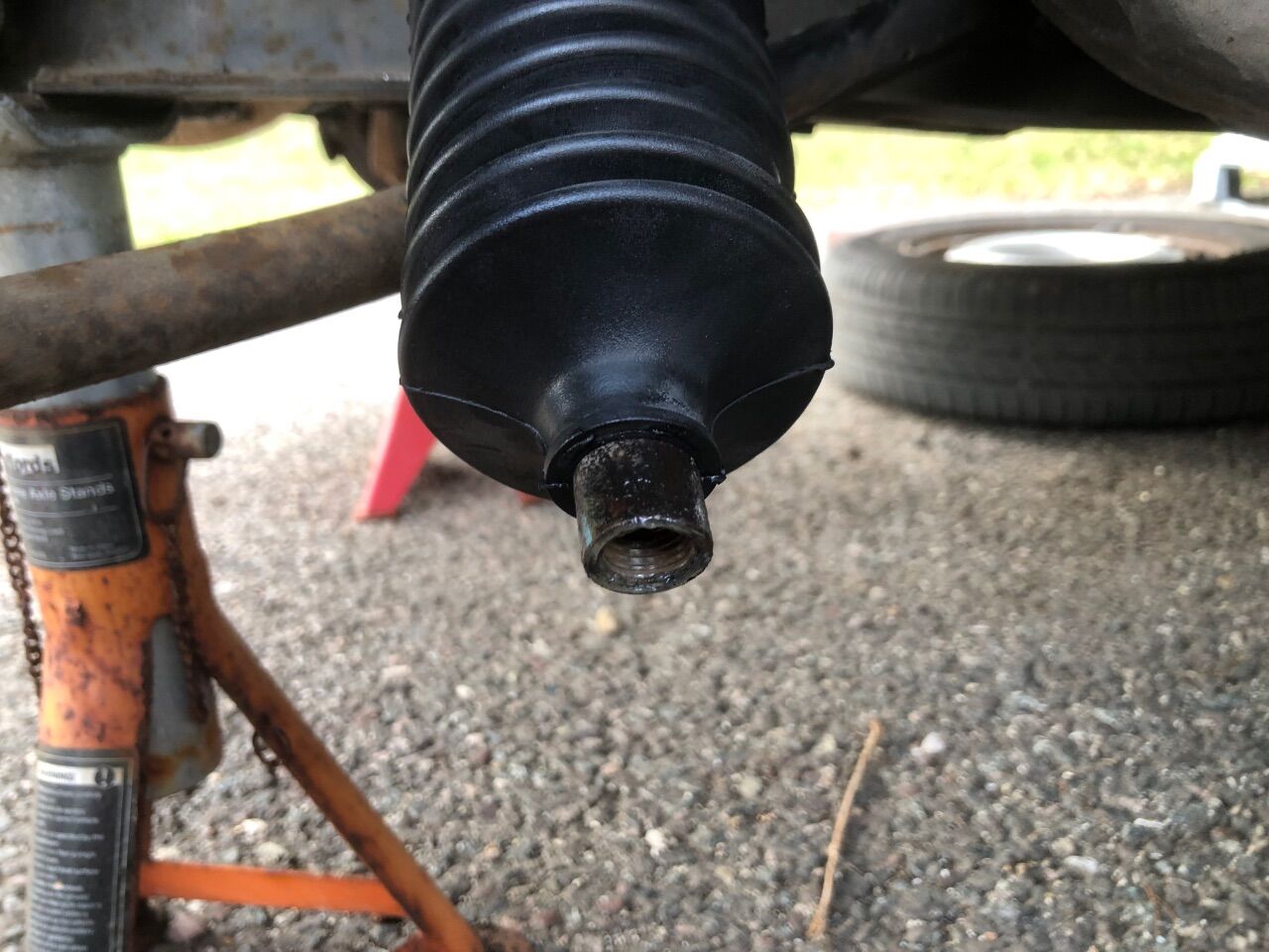

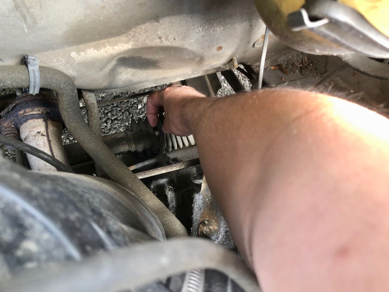

Rust Collector Posted May 17 Author Posted May 17 Adjusted the parking brake this eve, and that has also improved the mildly terrifying brakes. it’s pretty easy to get to the compensator, and I’m wondering if I should nip it up a bit more just to be safe - the guidance in the manual is really vague. After that I got on with sorting the steering rack boot. I am in love with how easy to work on this car is. The old boot was split at the top: I had looked before the test, but hadn’t noticed that. The hardest part of fitting the new one was getting the small end of the boot over the inner track rod end. The clips were a bit fiddly, but it was nice that they’re re-usable. Ive fitted a new track rod end as the car came with a pair. There wasn’t any real play in the old one, just a tiny bit of play in the rack. I’ve adjusted the carb again as well. I can’t remember which shiter gave me the Orbit tester in the pic below, but it’s something I’ve found useful! I’ve set it by the Haynes guidance for working without a CO tester. It’ll be interesting to see how close that gets it when I do put it on a CO tester - that’ll be the last step before I get it back in for a test. I’m a bit worried that the brake imbalance isn’t purely the handbrake, but we will see I guess. I still can’t quite get over what a marvellous little thing this car is though. 11/10 would recommend a 205. Brigsy, Datsuncog, adw1977 and 27 others 30

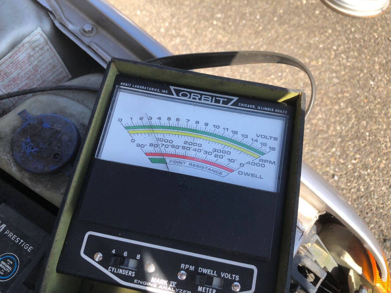

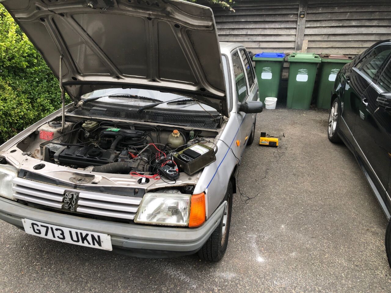

Rust Collector Posted May 20 Author Posted May 20 The exhaust gas tester which @95 quid Peugeot kindly posted to me arrived today, and so all the high-tech equipment was brought out this afternoon. After letting both the car and tester warm up, I calibrated the tester and took a reading. That’s a bit high! The book said to get it to 1.5% +/- 0.5% @ 700rpm. The adjustments needed were tiny, and I didn’t have to adjust the throttle screw, so the method for setting it without a tester hadn’t been too far off at least… This is where I got it to in the end. Now we just have to wait for the re-test to find out if it’s accurate! Sigmund Fraud, Tickman, Stinkwheel and 7 others 10

Rust Collector Posted May 23 Author Posted May 23 I went in for the retest today. No photo I’m afraid as they took the 205 straight in and I’m too shy to ask if I can photograph whilst they’re testing. However: We will take that! Check out the emissions: The book figure is 1.5% +/- 0.5% for this car, so that’s bang on the money. Big thanks to @95 quid Peugeot and @Christine for supplying surprisingly accurate emissions testing kit! I will post about the saga of the rear brakes at some point, but adjusting them made me lose the will to live so that’s a job for another day. For now, I need to briefly enjoy the car before it gets listed for sale. RoadworkUK, Tickman, Coprolalia and 14 others 17
