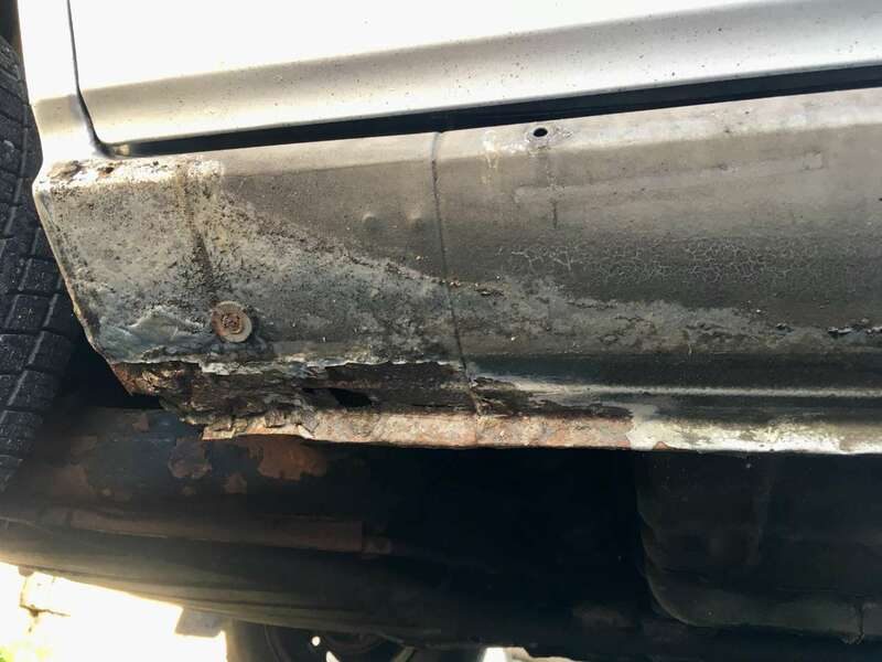

Talbot Posted April 11, 2023 Posted April 11, 2023 21 minutes ago, Rust Collector said: What is it they say about rust; plan for double what you see and then it will be double that again, or something like that... Yup. All of that. If you assume it will be an order of magnitude worse, you'll probably be about right. IE: This: Became this: So be sure you're ready for it to all get worse. theshadow, Rust Collector, chodweaver and 1 other 4

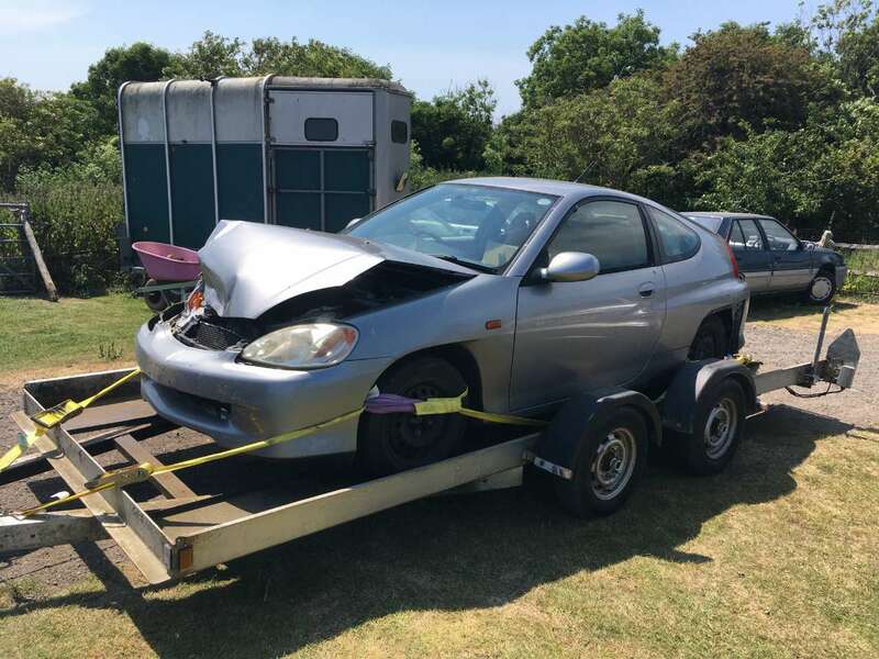

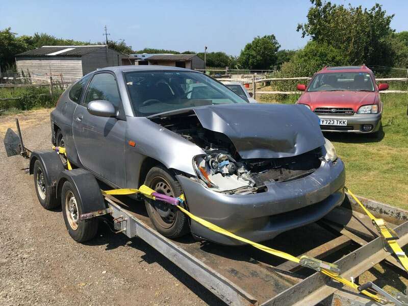

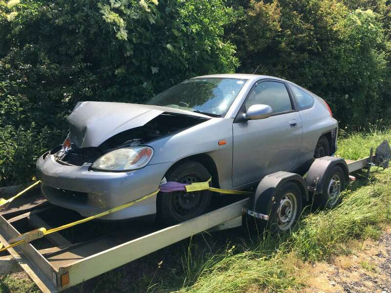

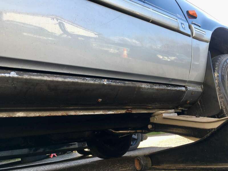

Rust Collector Posted June 9, 2023 Author Posted June 9, 2023 I’m really behind on my thread (as ever), but now is probably time to catch up on current events. As you may have seen on the News 24 thread, my Insight has not had a good day. I’ve gone and recovered it myself to the stables, so here are some photos for your viewing pleasure: I’ll pull it apart another day, but at a glance it looks like I went under the other car somewhat and so the bonnet and slam panel took the brunt of the impact rather than the crash bar. The radiator carriage has tilted back and is pushing the engine back on its mounts. The crash bar is bent down, but apart from towards the joint with the crash bar the chassis legs look straight. The car has a lot of sentimental value, so I’ll do my best to save it. For now though it can sit here for a bit. The main thing is I’m fine, and so I’ve taken the day off work. Coming home to this is what’s what’s important after all, everything else is just stuff: We will go out a little later and have a nice day out. What a beautiful day to crash a car 😅 Back_For_More, AnnoyingPentium, TheOtherStu and 16 others 5 14

TheOtherStu Posted June 9, 2023 Posted June 9, 2023 1 hour ago, Rust Collector said: I’m really behind on my thread (as ever), but now is probably time to catch up on current events. As you may have seen on the News 24 thread, my Insight has not had a good day. I’ve gone and recovered it myself to the stables, so here are some photos for your viewing pleasure: I’ll pull it apart another day, but at a glance it looks like I went under the other car somewhat and so the bonnet and slam panel took the brunt of the impact rather than the crash bar. The radiator carriage has tilted back and is pushing the engine back on its mounts. The crash bar is bent down, but apart from towards the joint with the crash bar the chassis legs look straight. The car has a lot of sentimental value, so I’ll do my best to save it. For now though it can sit here for a bit. The main thing is I’m fine, and so I’ve taken the day off work. Coming home to this is what’s what’s important after all, everything else is just stuff: We will go out a little later and have a nice day out. What a beautiful day to crash a car 😅 As you say, the main thing is that you're safe and unhurt. The Insight might live to see another day. Otherwise, I can imagine the spares are fairly limited, so parting it might not be the worst idea. Rust Collector 1

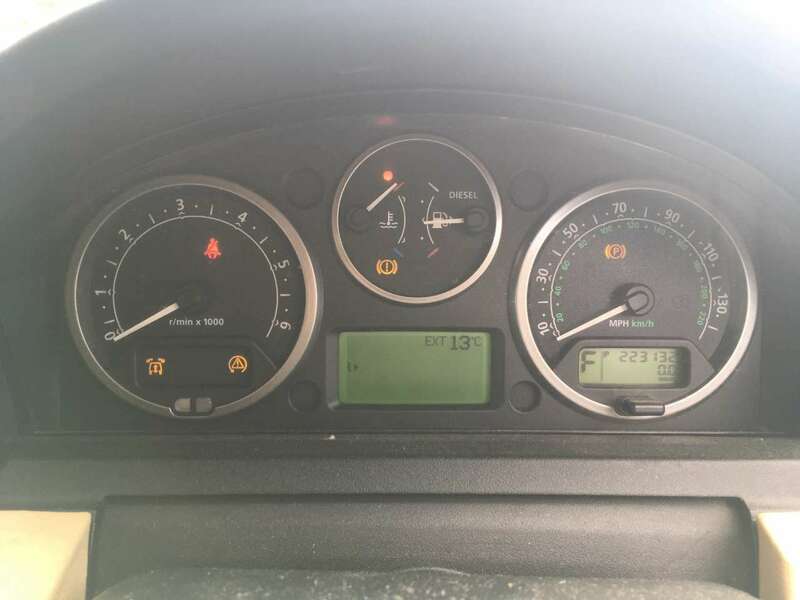

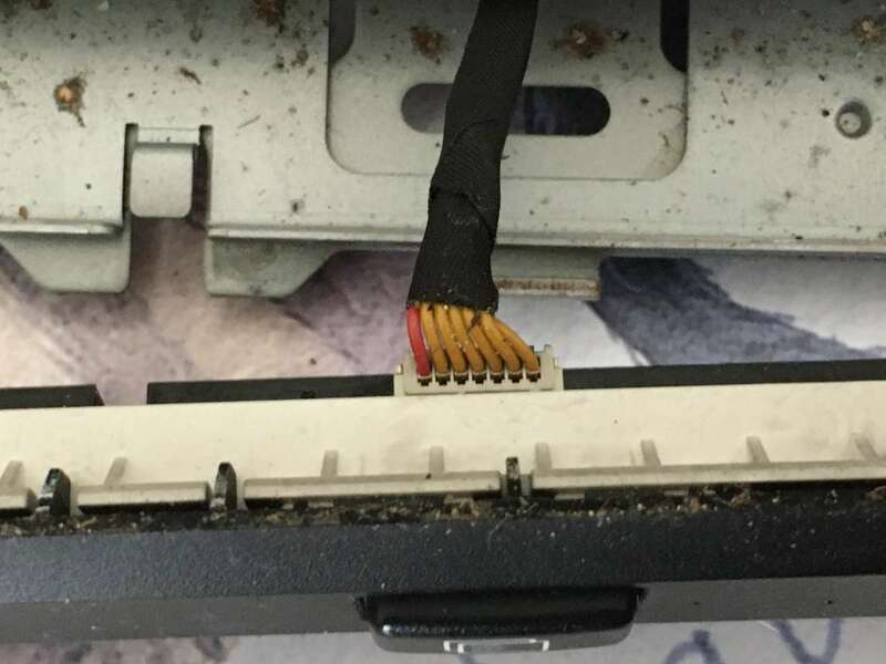

Rust Collector Posted July 11, 2023 Author Posted July 11, 2023 I think it's time for some more car content. I'm late as always, so I think we're going to do this on a car by car basis over a few posts. First off then, against all good judgement I got myself a Discovery 3. I've mentioned it elsewhere so I won't bore you all again, but this one belonged to my mate who passed away. I'm not a huge Land Rover fan, but it's important to me that this one is kept. Collection attempt number one did not go well. We jump started it for loading, and the dash lit up like a christmas tree and the Disco assumed the 'face down, arse up' position. This was followed by discovering that it's too wide to fit on the trailer. Fucker. Attempt two, I came armed with a battery and mentally prepared for a bandit run. No expense wasn't spared and the Yuasa was ejected in favour of the cheapest replacement I could find - Powerline, come on down! It ran, albeit with the dashboard doing these things, the gearbox in limp mode, the doors randomly locking and unlocking, the hazards occasionally flashing, and the suspension locked in drag race position: Luckily I only had to cover a few miles, and I made it home without the thing dying completely. I made my peace with the fact that I'd need to spend some money on diagnostics, and ordered this: It's cheap* chinese stuff, but it works and I'm pleased with it. The fault codes on the Disco were endless, but one common theme was units complaining about a lack of comms with the transfer case module. Trying to speak to the transfer case module resulted in an error. Internet research revealed that the transfer case control module is located perfectly for the encouragement of water ingress. Oh dear: Contact cleaner and a toothbrush to the rescue then. Some time later, and with a total lack of belief that it would actually sort the problem, I refitted the control module. I had some help: Fuck me, it actually worked!! Unable to quit whilst I'm ahead, I pulled the nav unit apart to do the modification that gives me Range Rover menu screens (and also makes the screen permanently fucking dim). Happy days! We then did some lifestyle activities: This is one of the rare 'Partner Approved' vehicles: It came in with a month of MOT and a noisy wheel bearing, so best to fix that one evening in the dark: I fitted a tow ball for car park protection and shite recovery: It needed lowering in the end as the trailer was looking like it was going to take off with the tow ball at that height. I let the MOT lapse as I had no real time to do any more work, but then one night shortly before a collection I decided to book a ticket for the next morning. I emptied it out, took it in and happily it passed. A couple of days later I took it out for a 300 mile round trip with the trailer, and I'm pleased to say it performed admirably: So, I say I'm not a Land Rover person, but truth be told I really like the thing. It's lovely to drive, if not thirsty and slow, and it's brilliant for towing. I'm really pleased to have it as part of the fleet. Tickman, chodweaver, wesacosa and 10 others 13
somewhatfoolish Posted July 11, 2023 Posted July 11, 2023 Impressive rescue of that control module; it really looks like a frisbee into the bin job. Rust Collector 1

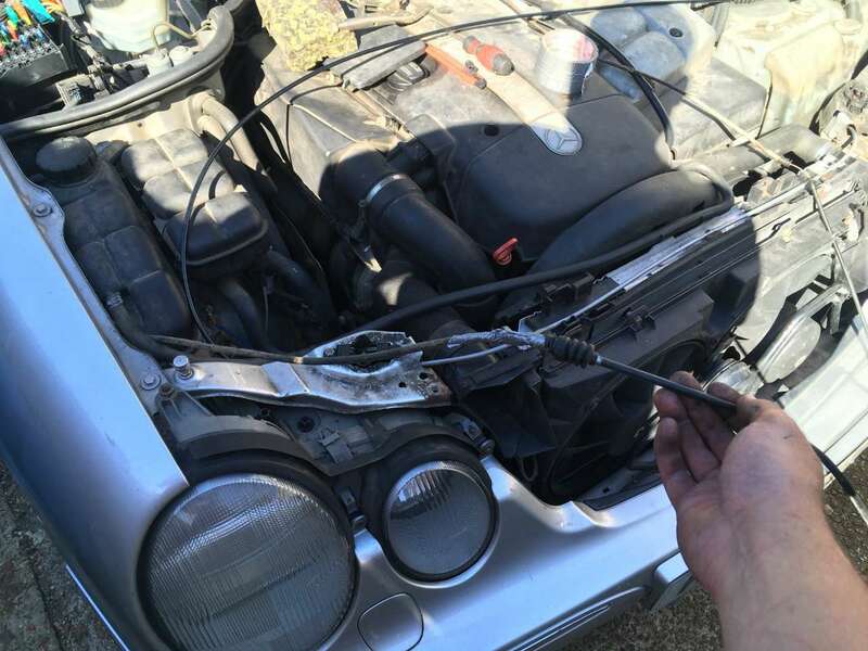

Rust Collector Posted July 11, 2023 Author Posted July 11, 2023 Next up is some fuckery with the Mercedes. It became apparent after we started running it that there was some sort of injector seal leak. Parts were ordered and eventually fitted: The internet had promised me a traumatic experience, but this one wasn't too awful. The worst part was cleaning as much of the carbon off as I could be bothered to do needed to do the repair. I did have a suitable slide hammer and I'd bought an adapter for these injectors which I think you'd struggle without. Plus I had a seat cutting tool already. I did have to buy a tiny torque wrench for the job as well, as I snapped my last one in a bout of fucking idiotery. The boost hoses were held into the intercooler by cable ties, so I put some new clips on. The Gates ones have a square profile which looks more secure. I then found out my radiator carriage was pushed so far back it was pinching the boost hose. I pulled it back in to place, which broke it free from the chassis leg. I then welded it on badly. I then used the car for some trade shows up North. All was good, and I was pleased with the fuel economy: I was not pleased with the fact that I ripped the radiator carriage off again whilst leaving the car park of the Hilton Hotel Leicester. Who the fuck loaded this in?! Oh, never mind. Lucky there isn't a big sticker telling you what to do, that would be embarrassing: I welded it back on again, this time losing my patience and occasionally setting things on fire. Once cooled down, the work was then checked and signed off by a competent person. I adjusted the damaged sections of the leading edge of the carriage using Big Bastard(tm) set of mole grips, with the occasional encouragement from a hammer. It's as good as new* Other remedial work included plastic welding the broken headlamp and headlamp washer back together: The headlamp is now flush with the surrounding panels and the car no longer looks like it's having a stroke. Then I found these fuckers: I put a temporary plug in the first one, and the second one hadn't gone all the way through luckily. It needs tyres though. MOT time next! It failed on the bonnet latch not working properly, and the front brake pads being worn to the sensor (my bad). Luckily there was a heatwave and I was sunburnt like a bastard, so I made myself a suitable work area: Old bonnet cable: The replacement process is very technical: The grommet was a bit tight for the hole but luckily we had help at hand: That stuff is so useful for stuffing rubber things where they don't want to go that I think it's actually a waste to put it on your cock. brake pads next, looks like they were just about* due: It passed the MOT, but I fucked myself over by not putting new discs on as they fairly quickly started making all sorts of unpleasant noises. New discs have arrived, but the front suspension on the car is getting very noisy and we are meant to be using the car on Friday to drive to Italy, and then onwards to Slovakia. Obviously I have not fitted them, and started thinking about a different car... That's this Mercedes up to date though. In summary, the engine runs nicely but the suspension is clonking away, it needs 2 front tyres, the brakes are noisy. Plus I still can't find a front bumper for reasonable money which is pissing me off, as it looks like shit with the sides cut off. Once I'm back from holidays I'm going to replace all the front suspension, replace the front tyres, and try to find a bumper that isn't £200 and scratched to fuck. chodweaver, Popsicle, CGSB and 8 others 11

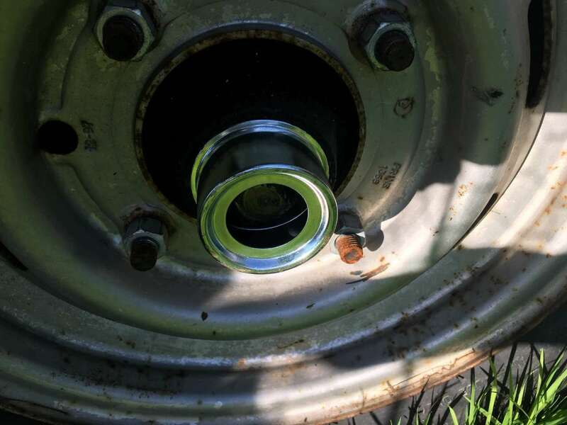

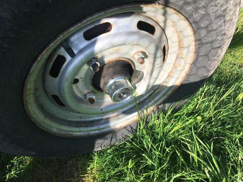

Rust Collector Posted July 11, 2023 Author Posted July 11, 2023 And now, for a brief intermission with some non-project but vaguely related content. The healing trailer mk2 has had some minor servicing picked away at whenever I had a moment. I greased the greasey bits, adjusted the brakes and re-greased and torqued the bearings. I lost a bearing cap at one point due to overheating the brakes (my pompt to adjust them) and seeing as the Peak style ones were some £15 a pop I instead bought the finest* examples that amazon had to offer for about a tenner. The little inspection bung/window is handy: I've since used it to drag a couple of stalled out projects away from my house, and also to recover the Insight... I'm trying to focus on a single project at a time, so dragging a load of shite off my driveway helped clear my head a little. I then got offered this for £2,400 It had no ramps though, and I felt it was on the expensive end of the scale for something I couldn't use straight away. I will replace the trailer with one like this at some point though, as I would prefer a flat bed with no sides. The baby trailer was used to clear a load of my shite out of a mate's unit: Can't remember what half of it is, so I just dumped the whole trailer in the barn and filed it under 'sort later'. The Mitsubishi was packed out with crap as well... I did find some useful* bits though: I definitely need a Nato hitch stashed away. I found a nice Dixon Bates drop pin hitch too, attached to a substantial drop plate. That will go on the Disco nicely I reckon - No pic sadly. Tickman, Popsicle, Shep Shepherd and 3 others 6

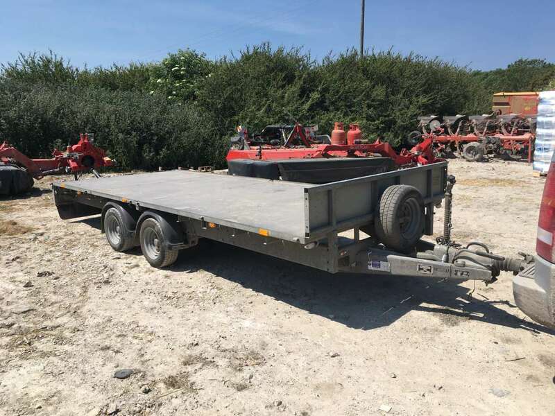

Rust Collector Posted July 11, 2023 Author Posted July 11, 2023 Let's get back to what we came her for: irresponsible car purchases. The mission at hand was to sell a car and reduce the size of the fleet. The mission was about 30% successful. The success was that I did sell* a car, and it has gone to a good home where it will be enjoyed. The BX Leader is now with @rob88h which means I have kept my commitment to my partner that it would leave the fleet as promised. So what went wrong then? Well, firstly @Stinkwheel offered this up for free recently and I was unable to stop myself: So at the start of this month I had a day out to collect that, which went mostly to plan and was a pleasant day out. It was great to meet stinkwheel and I'm incredibly grateful for his generosity, and I'm really looking forward to working on the car later this year. For now, it's in the spot where the Proton should be sat for the sill to be welded. As I said before, I'm much more focused* now. The second snag to my fleet reduction plan was that Rob88h was selling his LS430 and it looked like a really lovely thing to drive around in. I've been driving around in a 3rd gen Clio with no aircon since crashing the Insight, so again I wasn't able to help myself here and this happened: There's a bit of an early noughties executive car vibe going on outside my house now: One of the main things that swayed me on the Lexus was the Merc playing up right before we needed it for our holiday. I'm done rushing to get a broken car diagnosed and fixed for a deadline, and so I've decided that we are going to do our Italy/Slovakia trip in the Lexus. Wish me luck 😅 Schaefft, Shite Ron, BeEP and 14 others 17
