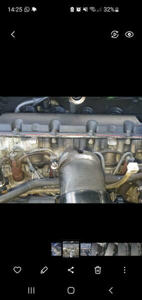

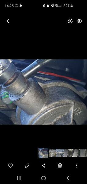

D) Car will make it to the MOT station with minimal smoke but a puddle of oil, thankfully not enough to warrant a fail. The MOT man noticed a weep from the cam cover gasket so I think I must have caught the back of the gasket under the cover when putting it back together
Thankfully he also didn't find any other problems so we now have 12 months ticket. Yippeee.   Car drove pretty nicely on the 40 mile round trip, the suspension is usually quite floatly but does sometimes feel not so floaty on pot holes and those kind of imperfections.  Not sure what a Hydropneumatic Citroen is supposed to feel like but one to keep an eye on.  It had only done 200 miles since 2013 so perhaps just needs a bit of use to free off some of the linkage etc.  Thankfully with the MOT pass I can now do stuff like that
