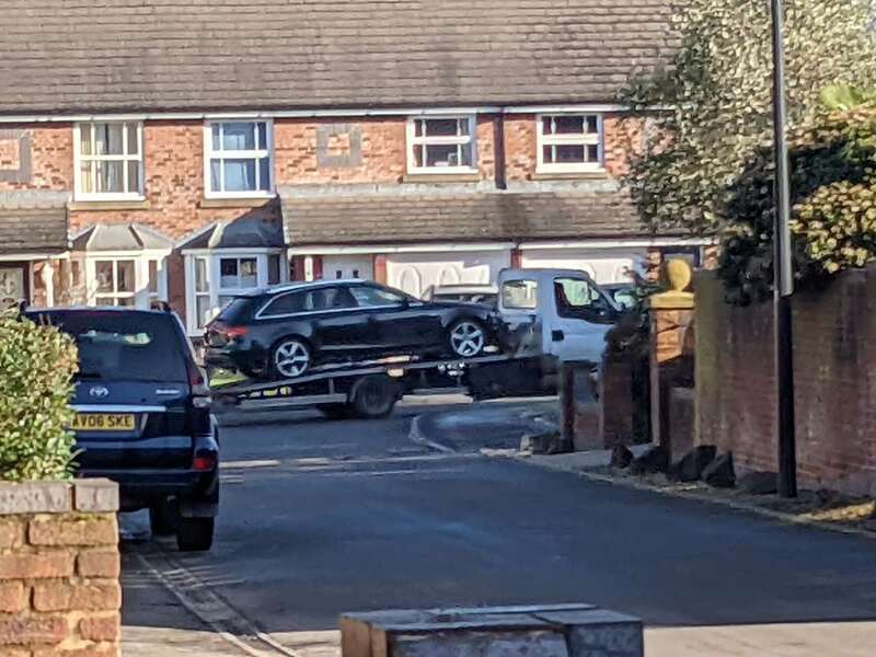

I have news, and it is Not Good™️
High pressure fuel pump is lunched. Estimate is between £2000 and £2500. If it's filled the injectors with swarf and killed them, then that'll be another stack on top.
Going to lock myself in a darkened room for a bit while I figure out how to approach this, I think.

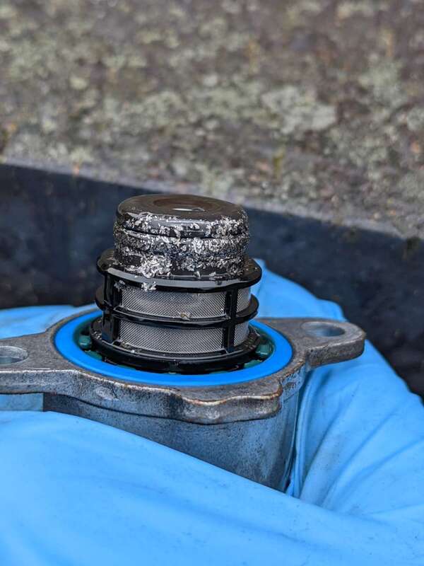

The fuel filter needs to be carefully examined for any trace of metallic swarf.
If none is found, then hopefully it shouldn’t have contaminated the injectors and a replacement with one of those refurb units linked to above shouldn’t be too spiteful.
If sparkly bits are found, then it will unfortunately become significantly more expensive.

Problem is that the sparkly bits go through the return line on the injectors as they become blocked and the pressure is too high. Likewise return valve on the rail.
Minimum you need hpfp, injectors, return valve and fuel rail pressure sensor. Rail, pipes, filters, tank, any low pressure pumps (steel sticks to the magnet) need all need tremendous flushing. Main dealers replace them all.
Get any of those sparkly bits back into the pump or injectors if not utterly flushed then game over again.
Some have found some of the sparkly bits are so mushed finely (remember 2700+ bar of pressure inside that pump), it can get through even the best fuel filters. Honestly not sure how true that is.

I recall that the filter was before the HP pump and therefore for any metal bits to be in it they would have gone through the pump, the injectors, leaked off and gone back to the tank, through the LP pump and the lines to the filter?
While the presence of metal here would indicate a failure I would be hesitant to use the lack of metal to confirm that everything else was fine.
If it were me I would take the pump off, strip it down and see what it was like to determine the exact cause of failure, if any swarf has entered the system then new injectors will almost certainly be required and getting swarf out of the rest of the system, the lines, tank etc. is absolutely critical.

The main filter is pre-HP pump, yes. Not sure if there is another mesh filter on the output side of the HP pump which could be inspected for swarf, I can't see one on a parts diagram.
The more research I do, the more it looks like I'm about to make a £6k loss. Good.
If you look in my pictures above, you can see the pressure control valve that I removed. I believe that's on the output side of the pump.
This is the XF diesel pump and has the same thing. Two pumps unlike mine because of more fuel to pump being a V6 Vs I4.
Under there is where to inspect for swarf. I imagine the garage has already looked there though and given the diagnosis.
