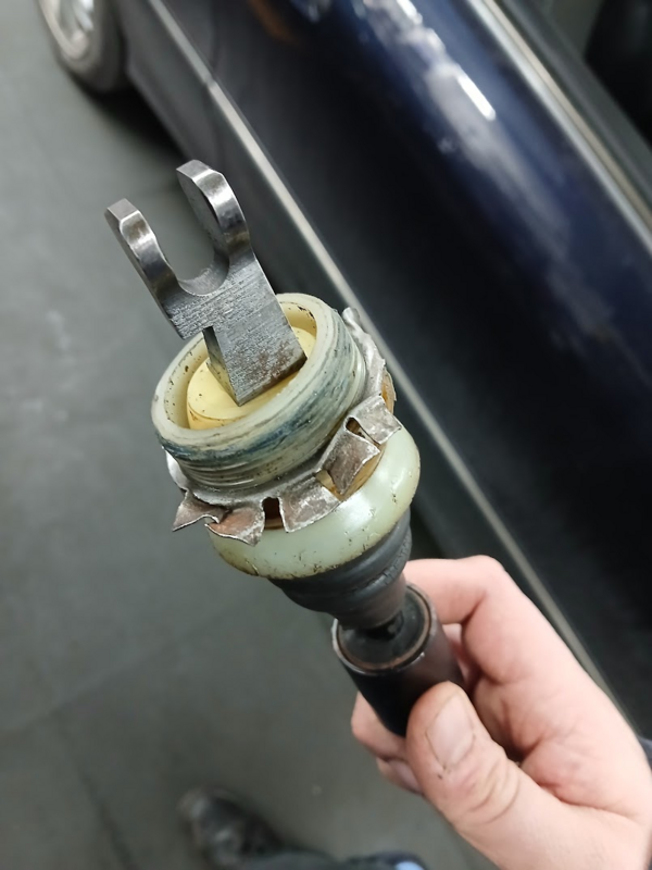

1 hour ago, N19 said:
The only glitch occurred when I returned to the garage, and selecting reverse, the gearstick came off in my hand.
I thought I'd got it sorted and in properly, as this happened a while ago. Some people have suggested aralditing it in, but I'm not sure if that is a wise idea!
Very common., do not glue it in you will never get the threads clean again.
You can get them but..
https://www.ebay.co.uk/itm/235824869563?_skw=capri+gearstick&itmmeta=01JHBJZC11QKHRD6J0DC5BKK73&hash=item36e841f0bb:g:oBAAAOSwWZFnMKMu&itmprp=enc%3AAQAJAAAA8HoV3kP08IDx%2BKZ9MfhVJKl%2FkoKaQRF6xRAKlPO5yRrXhh%2FzyAGhokSi%2FrMaWkEw1RORSNbjlWrkn%2B0PHcS%2BDZzOS5A55JO%2FlQ1VWZb%2FvkpamkfiS%2Bo6LApZujAMzy5iQBLddsRWVpFI8QlzFreVOt12%2FQFkdS7BqT0%2BY%2FwYo%2BpVRHSw76%2F2tn2LnmL570iPqWhd8q%2BQGr2SA4K51tsMcjpvCIOHdza%2FJMHhjs6Lv%2BG5OPMxoMll1Fd7AtcKShHQBdePJ5bE%2BX3hE4Z5vuVzZHq0G0Z7nRSLgmUWOUR6hzTopRKs38WenxlLkHcutDGrsA%3D%3D|tkp%3ABk9SR9jA_fKKZQ
Gear lever off, cleaned up, can see that the thread is slightly mullered.

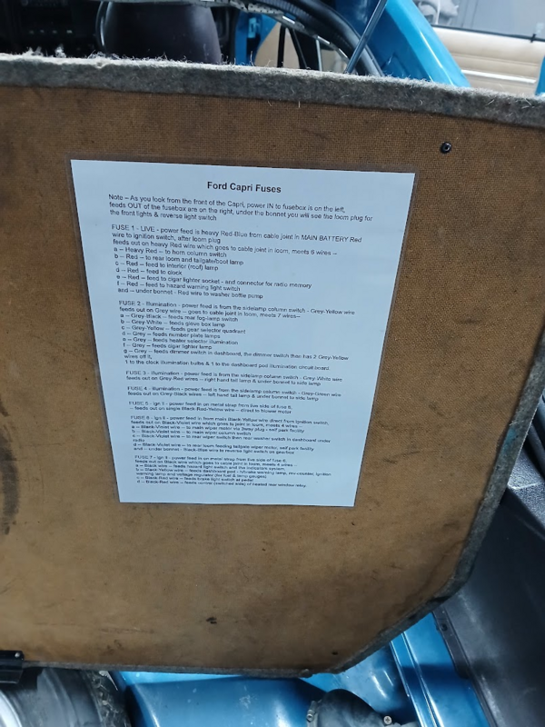

For the benefit of future fault finding, I printed this off, laminated it, and stuck it to the underside of the spare wheel board. One day it'll come in handy although I have a copy of this in with the workshop manual too.
Frustration abounded with the gear lever. Despite trying PTFE tape and threadlock, I couldn't get it to engage, and several of the locking tabs broke. This was given up as a bad job for discussion next week...

The ongoing gearstick hassle continued but may have been solved, if I'm lucky.
Threads cleaned out and scribed(? is that the word - little tool for sorting out threads bigger than what a die goes up to) and one of the mechanics refitted it. Now feels very solid and safe and, crucially, has been tightened up with a plumbers spanner. (So naturally I'm going to still worry, but that's just me!)

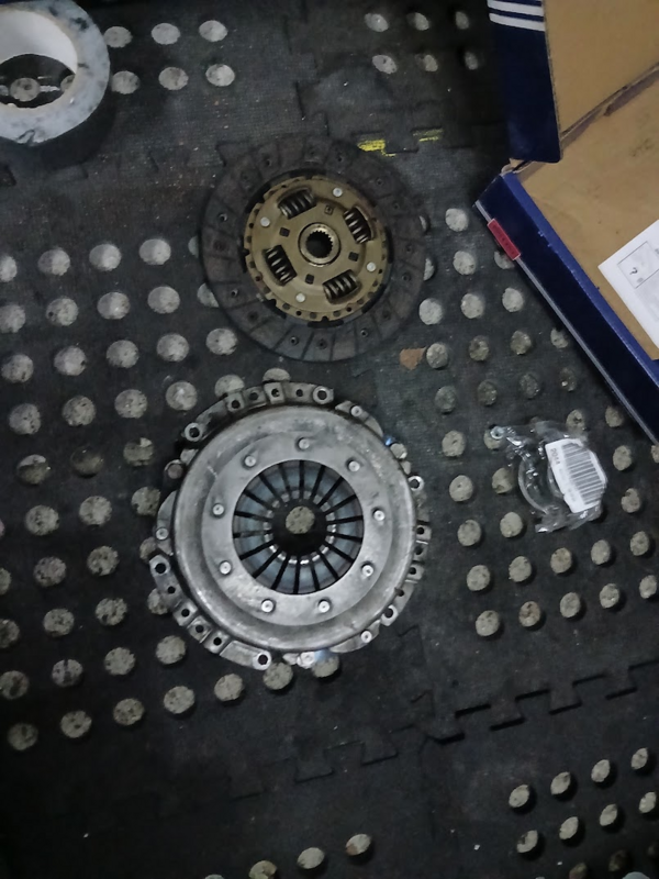

I spent a bit of time at the lockup, tidying up bits and pieces.  The clutch was changed despite the old one only having 16000 miles use. It did make sense to do it while it was out, though, and gives me a used but good spare for the shelf.

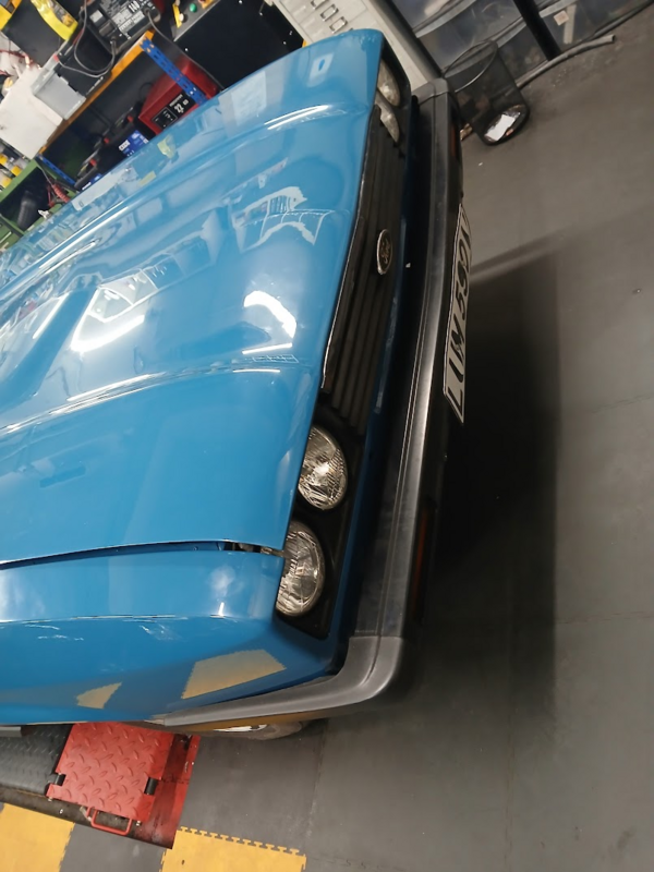

The back wiper switch/contact was replaced which was causing the short, thus the wiper now works fine, and the boot trim could be reinstated.
Also got some of the rubbing strips back on. It's not especially easy with clips in the rails, I used blu-tak blobs to stop them from flying around so much. The ends are screwed in. The smaller ones have two studs which go into holes in the bodywork. In a previous page I showed replacing these, which had knackered, with bolts set into tigerseal. This gives a little bit of leeway if things aren't perfect. A bit of acrobatics can then help fixing the M4 bolt from behind.
As you can see there's no strip on the left of the door here yet. There is one of the holes through which the studs protrude, but the other one isn't there - as there was bodywork repairs in this area. This means that I've got to drill into the body which is mildly terrifying.
The bonnet catch still doesn't engage, another thing to sort out.
The cable may be sticking not allowing the catch to fully retract, worth checking and lubricating the mechanism first before dismantling it all.
When I refitted mine it was playing up. Took me ages to work out why…
Turned out I was missing that little clamp that holds the cable to the slam panel! The one that bolts in at the front.
There was just so much movement in the cable it couldn’t pull the latch properly.

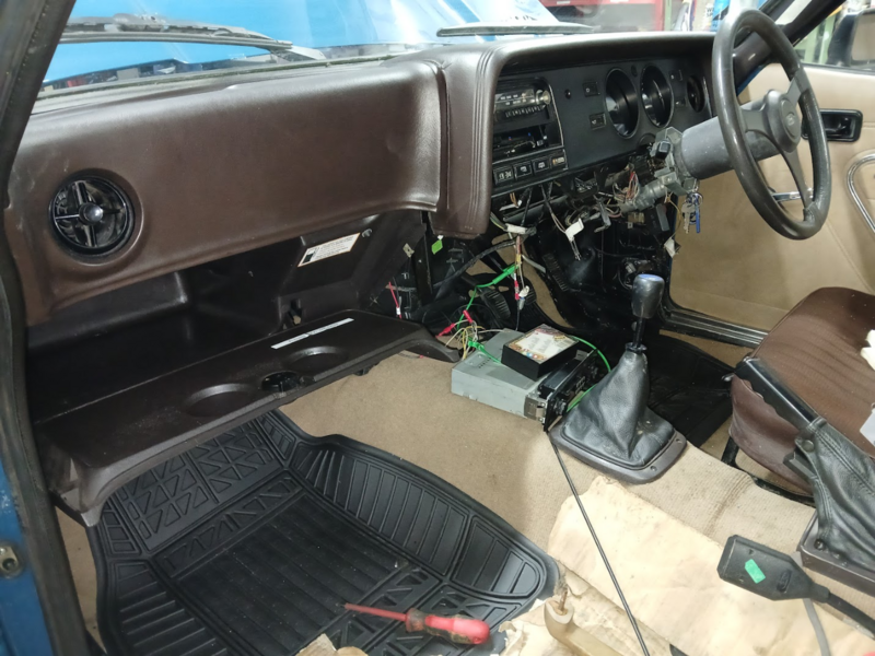

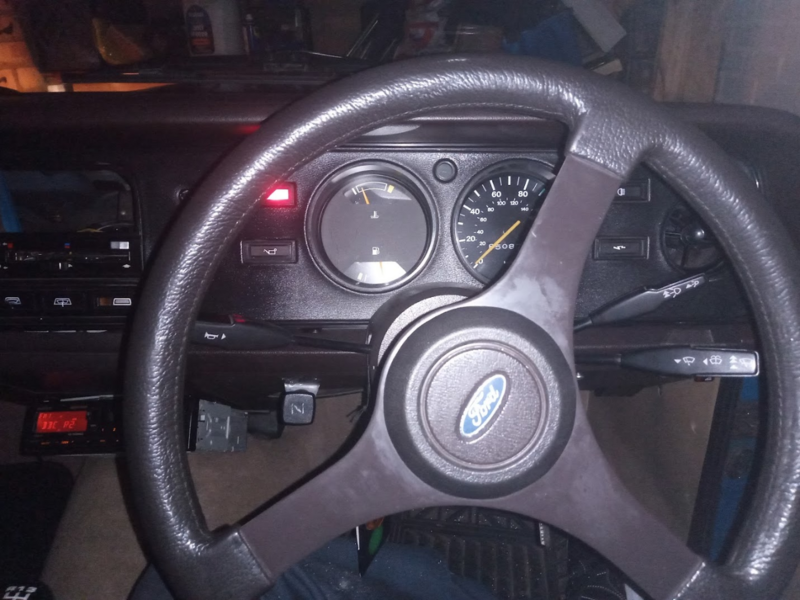

Back in the garage, with the car once again turned around, the glove box was next to go in.
Radio-cassette tested and verified as working before I threaded everything through to the new location....
Now this might seem a bit odd, especially when you look at the original location for the cassette. The problem is that the original Capri radios were slotted into the dash in the location shown, but were smaller than a standard unit. As time went on and they were replaced for other units, due to failure or desired upgrade, the dash was cut to accommodate. Un-cut dashes like mine are therefore less common.
This archive picture from 2019 shows the previous set-up, where I had the radio screwed to the underside of the ashtray panel.
Although this worked fine, I didn't want to risk damage through putting force on the screws (eg when ejecting tapes), and it didn't look especially great. So I chose to reinstate the non-working radio, and secrete the functional one in the glovebox. The only disadvantage that I can see is having to reach over to adjust the volume or change tapes. I might see if I can put a hidden mute button somewhere easily accessible to the driver.
Now 4 provided test music.

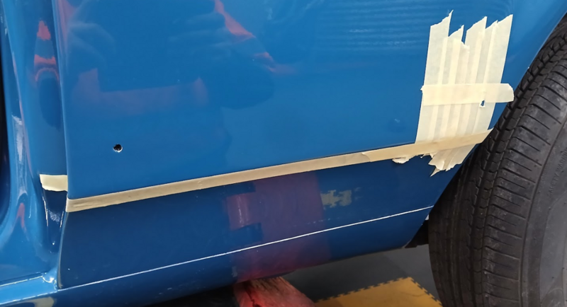

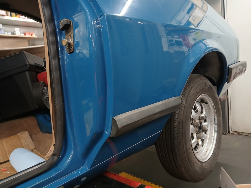

Next, I turned to work on the side rubbing strips. This bit was utterly terrifying. Some of the mounting holes had been filled or covered when the bodywork and respray happened, so I needed to re-drill. Yes. Drill, into the beautifully repainted and long awaited car.
Eek.
I covered the target area with masking tape, got the part and located it properly using one fixing in the existing hole, then with the aid of a spirit level got it in the right place. Once done I pressed on to the masking tape to create a mark. This I then checked ensuring that the distance was roughly the same from the bottom, albeit there is some flex in the rubber sealant holding the fixings in, so nothing is exact - there's an element of adjustment when it comes to tightening them up.
Hole drilled, bare metal protected with a dab of touch up paint, strip fed in and bolted up from behind.
That's now 5/6 of them done. Left the last one for now as it needs both fixings doing, so a bit fiddlier, and I was getting tired.
