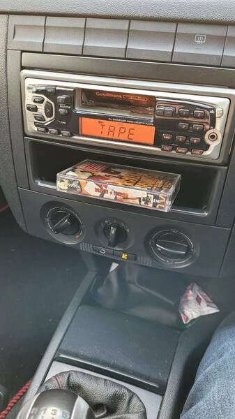

The cassette player in the Bluebird at the moment needs work (azimuth is off), so when @AnnoyingPentium offered a cheap working unit it was perfect timing. Postie dropped it off this morning ("which car is this a part for, then?").
It's a late 90s or early 00s model I think - based on the phone number on a sticker (which starts 0113, so must be after 95). You can tell the difference in sound quality compared to the 80s head units I normally have kicking around! Mr Pentium also included a couple of 80s cassettes foc which will start off in the Bluebird (start off? yes, every so often I have a good old shuffle around of tapes, otherwise I find myself thinking every car has a soundtrack. Tonight, Tonight, Tonight by Genesis or Heart by PSB tends to make me think of the Bluebird - whereas Burning Bridges (Quo) reminds me of the Capri and Stop! (Erasure) the Mondeo)
Glad to see that it's getting used as it wasn't when I had it. Good to see the illumination is working properly too. I place that head unit around 1997/1998 just out of best guesses really. It's redeeming feature is the CD 'aux' input for me on the front as well since I could plunk the iPod in if I didn't have something on cassette.
There's a little bit of history around that unit too which I gave you a brief synopsis of in our chats via PM. I bought it c. 2015/16 off of a guy at the boot sale in Ayr for a meagre £5 or so in the original Goodmans box with all the fitting gear. The original intention was to buy one that I could hack the wiring up on to run in the house with a pair of speakers within an old Ikea unit we had kicking about.
I got it home and used a power transformer from an old model railway controller to get it to run. My Granda and I initially ventured to Shewalton breakers in Irvine to procure ourselves a set of speakers for the stereo to use. However, we couldn't get them out of the Y-reg Civic we hacked to bits, so just bought a set from a car audio shop as cheaply as possible.
Fast forward a few years and I put the wiring back to ISO/DIN standard (with some soldering) and fired it in the Fabia. However, it wasn't what I was looking for, so got retired once again.
I like to think it's in better hands now with you instead!
P.S. Don't ask me how to set the damned clock, I have no clue. You can change audio settings with the recessed 'SEL' button if my memory serves. With a good set of speakers it can produce some nice bassy outputs along with some clear highs. Once again, enjoy. :)
EDIT - here it was in the Fabia...
Cheers mate. I think for proper audio quality I should replace the NSF speaker that is in two bits - I did order up a new one and it is somewhere in my belongings...

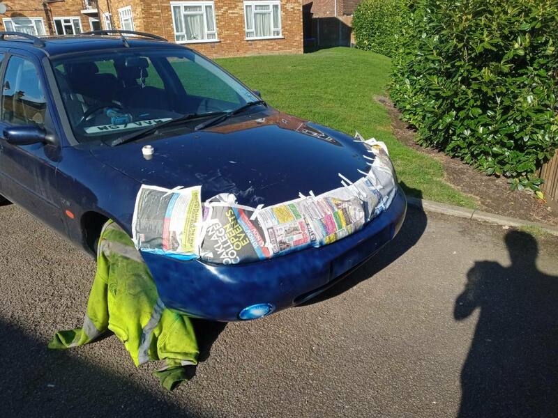

Used the rattle can I had in the garage. First coat... Need to get another can for coat 2 tomorrow.
It doesn't exactly look great but the car as a whole is definitely a ten footer anyway.
I sprayed one once in same colour, just concentrate on getting it even with no banding then whack the lacquer on top.

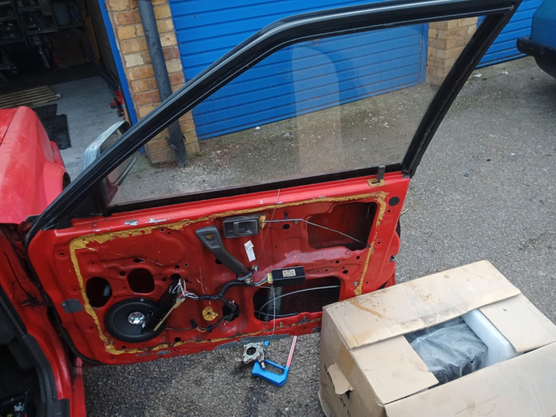

New window regulator arrived yesterday. In a rare display of common sense, I set it up on the bench with the motor and gave it a good test first.
In we go,
Replace some rubber washers to give some cushioning (previously it was vibrating)
Put the trim back together...
Hurrah. There's still excessive play in the track mind, despite that being a new part itself - something somewhere must be awry. But it works.

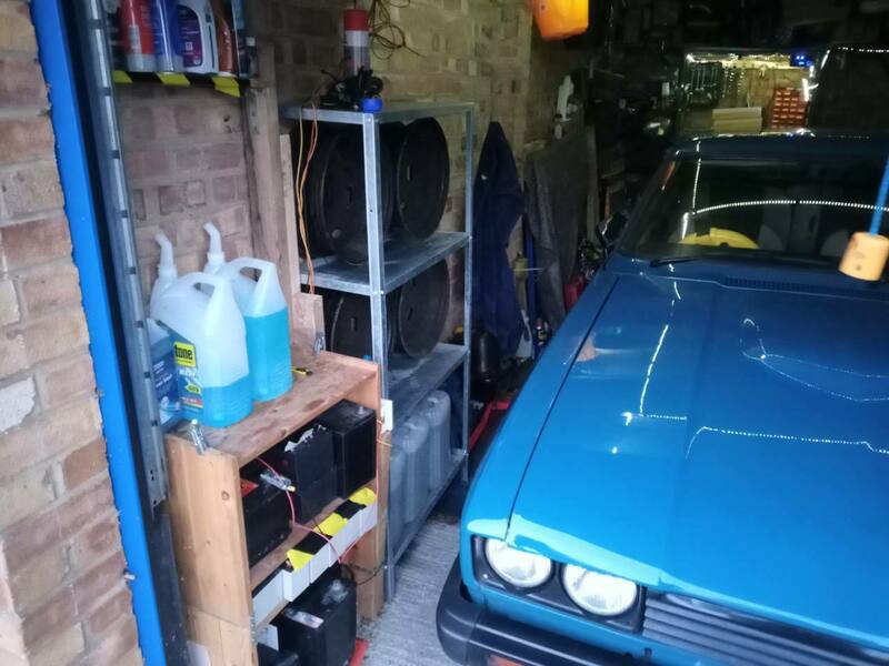

I did get a bit of garage re organisation done though, these shelves were kicking around at home. Wheels are spares for the Bluebird which I don't need but would otherwise have been thrown out by a friend as surplus!

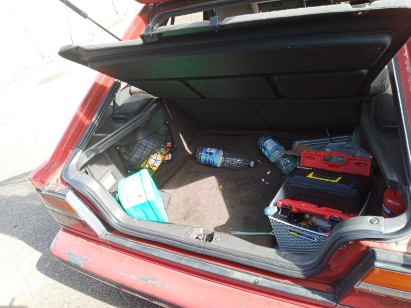

I got some replacement gas struts with different fixings for the Bluebird, the originals were past their best.

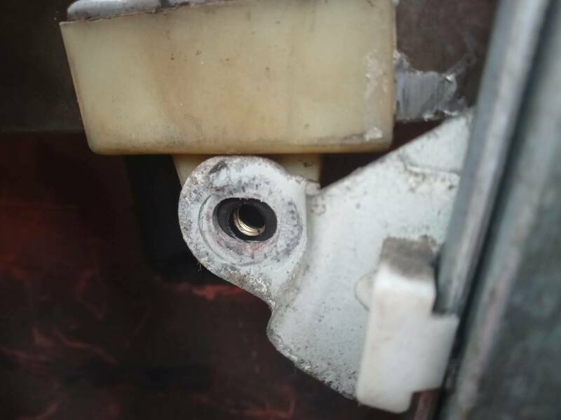

Naturally, the studs sheared off and resisted all attempts to remove. Had to drill this one out. I thought there was enough thread left to be able to screw in the new one - but it doesn't hold under load. Think I'll have to nut and bolt from the other side.

Back to the Bluebird's struts. I'm sure I had a tap set kicking around, but it was nowhere to be found. Picked up a new one from Screwfix which was put to immediate use and solved the issue, so the boot now stays open.

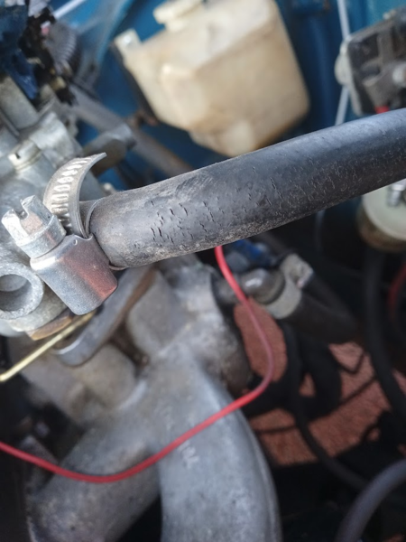

the good weather this morning gave an opportunity for some checks on the Capri, which I haven't really touched this year, having only gone on a few trips to keep everything going.
but what's this?
...fuel hose I installed two years ago, if that! Looking inside it doesn't seem to have any cracks that far in, but still not good at all. Now being a paranoid sort I always keep some fresh lying around, promptly put into use, then went out for a spin around the back ends of Herts and Bucks.
