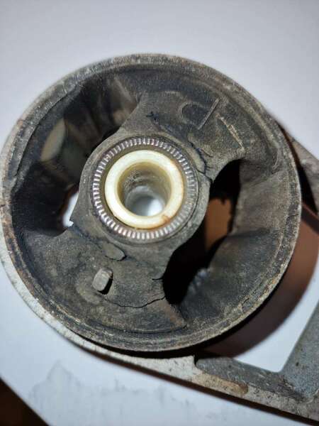

Did the lower engine mount today. Old one clearly past its best.
Pretty straightforward job, especially as I already had the undertray off. Jack up, remove two bolts, weren't too tight. Only issue was one bolt fouled the exhaust manifold which required a bit of jiggery pokery, jacking the engine up from the sump until I found just enough clearance.
Out driving and it is much, much improved. There is still a mild clunk at points particularly changing up at about 25mph.  Dunno if it might be the third mount I haven't changed...
Frustratingly still getting a bit of clunking, not much when going into drive or reverse anymore but at certain speeds and much more violently if I drive quickly.   Could it be the third mount I haven't changed, though it looks visibly fine? Something else? Perhaps I didn't get the lower mlunt tight enough no space to use torque wrench on rear bolt

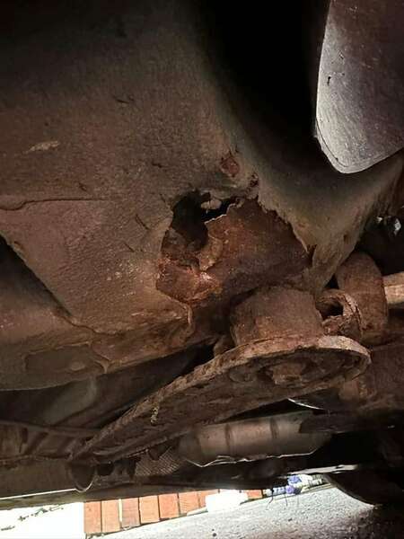

Hey 75 apologists, check out the state of this:
I've never seen any with rust on the main chassis rails at the front subframe.
Obviously this is an exceptional case as this car has been left standing a long time. Spares only but at least the deep sea green Personal Line interior has been saved.
