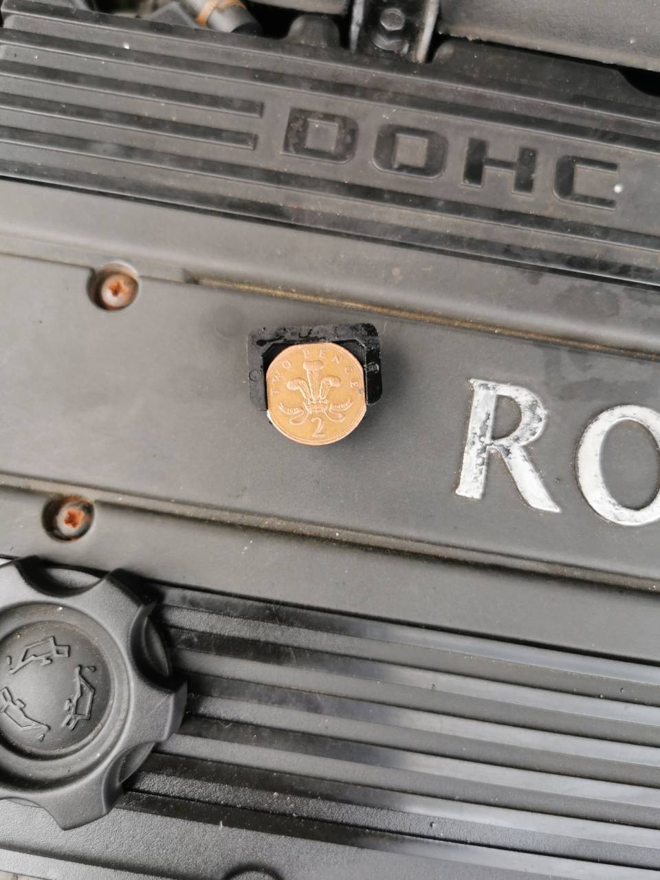

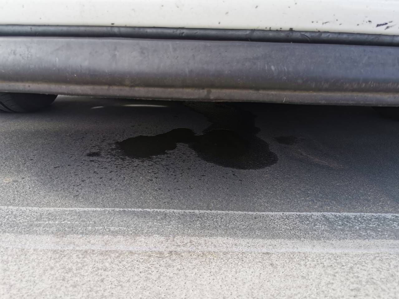

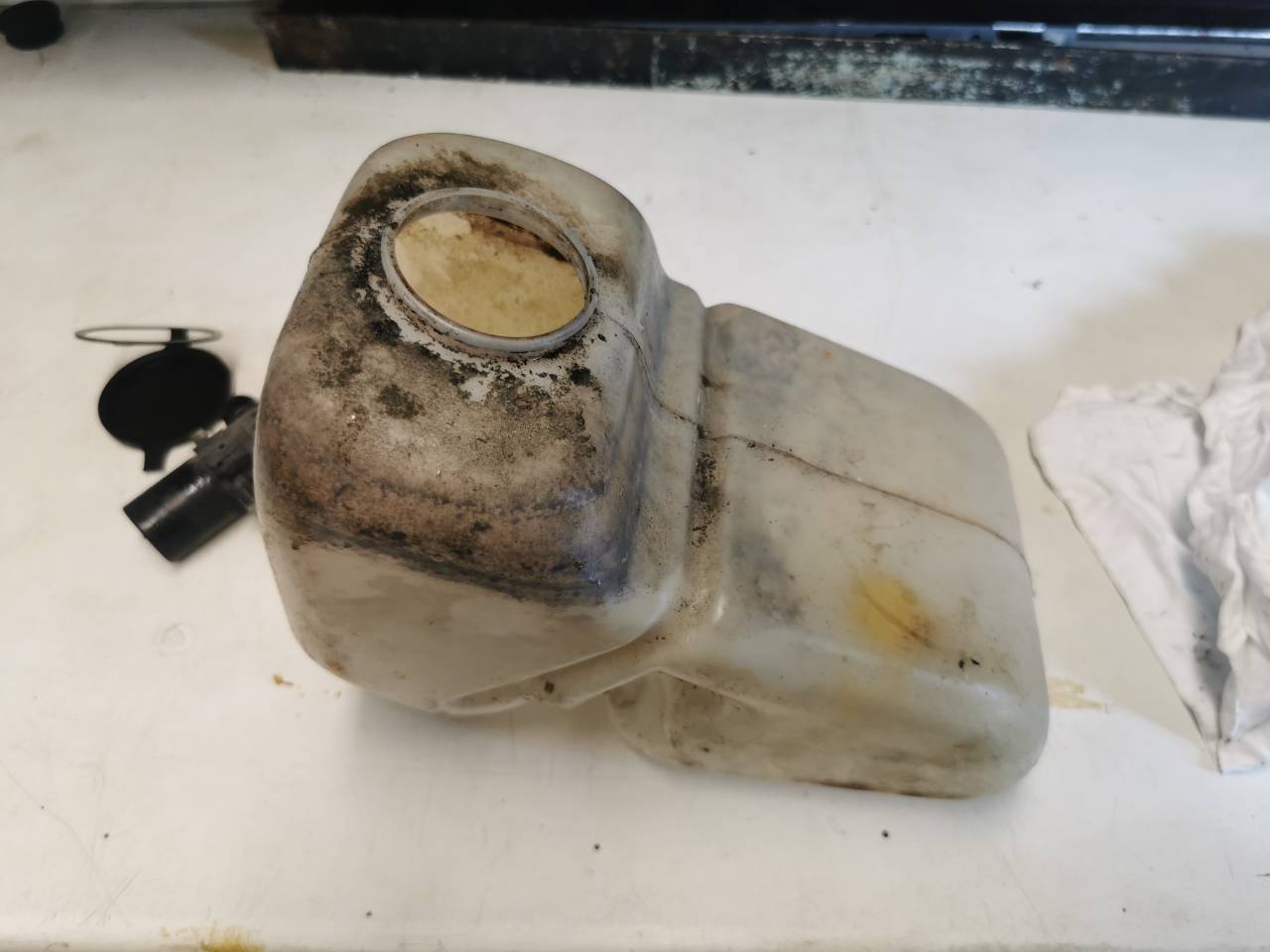

Has a long enough driving period to highlight another coolant leak.
Same area as last time, from the plastic bung-sealed one. The 2p fix is still bone dry, and I only changed one to see if cleaning the bung and seal up was an effective fix. That clearly wasn't the case!
Luckily, I was already prepared for this and had a second 2p piece filed down and in the car in case the plastic bung ever leaked.
Two seconds to swap out and minimal coolant loss this time, I've dried up the area and will monitor it over the next couple of days.
Ha, spoke too soon didn't I?
I think it's sorted now, I gave the seal another wipe and flipped the coin. It was dry after a 20 mile drive home, but I'll watch it like a hawk.

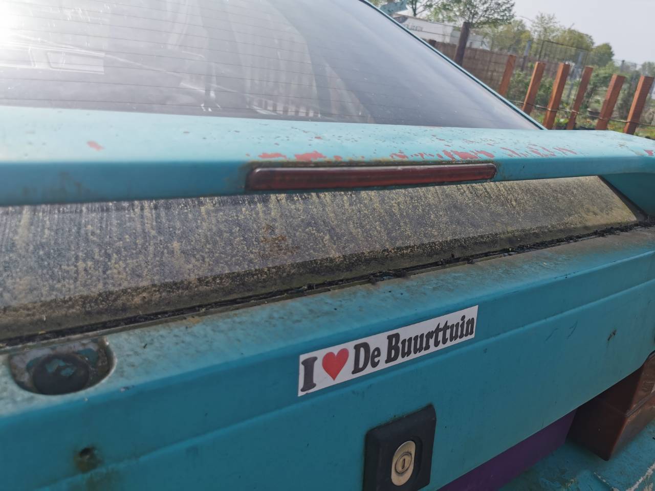

I spotted this BX (the only one on the trip so far!) parked up at the bottom of an allotment. Got chatting to the owner and it transpired it was getting scrapped next week and offered me any parts I wanted from it.
I didn't have any tools with me, but I happened to be on a Facebook group for BXs in the Netherlands, so I made a post on there and a few former owners popped out of the woodwork and shared some pictures of it in a previous life! I believe someone is going down there to get a few bits and bobs off it, so at least it's not entirely going to waste.

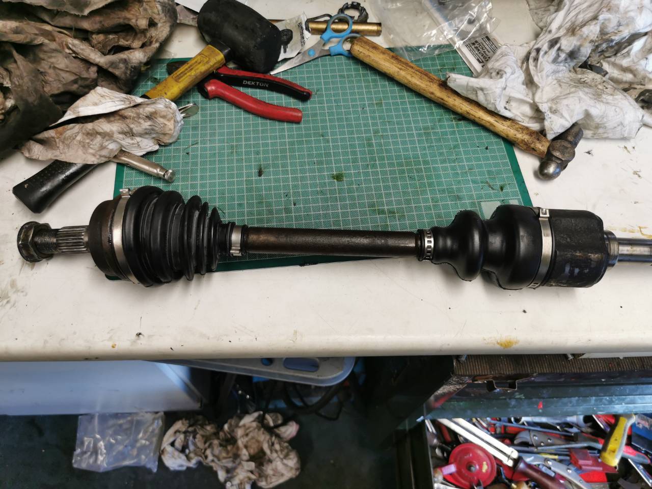

As I didn't have the engine back yet, I cracked on with one of the more unpleasant jobs.
Bloody hate the grease on this, spreads everywhere, stinks and is a bastard to clean off.
The CV joint was putting up a fight to come off, but eventually gave in.
There was a plastic ring in the old boot, so I transferred it over.
There was only one driveshaft boot that had actually torn, but it made sense to get them all replaced now whilst it was all in bits.
Onto the next one.
Both done and ready for fitment.

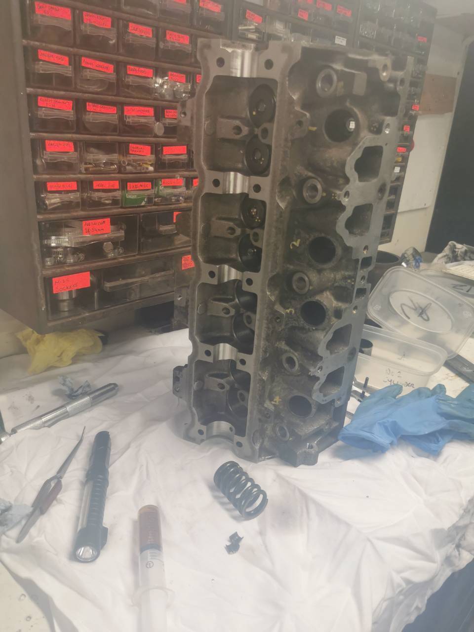

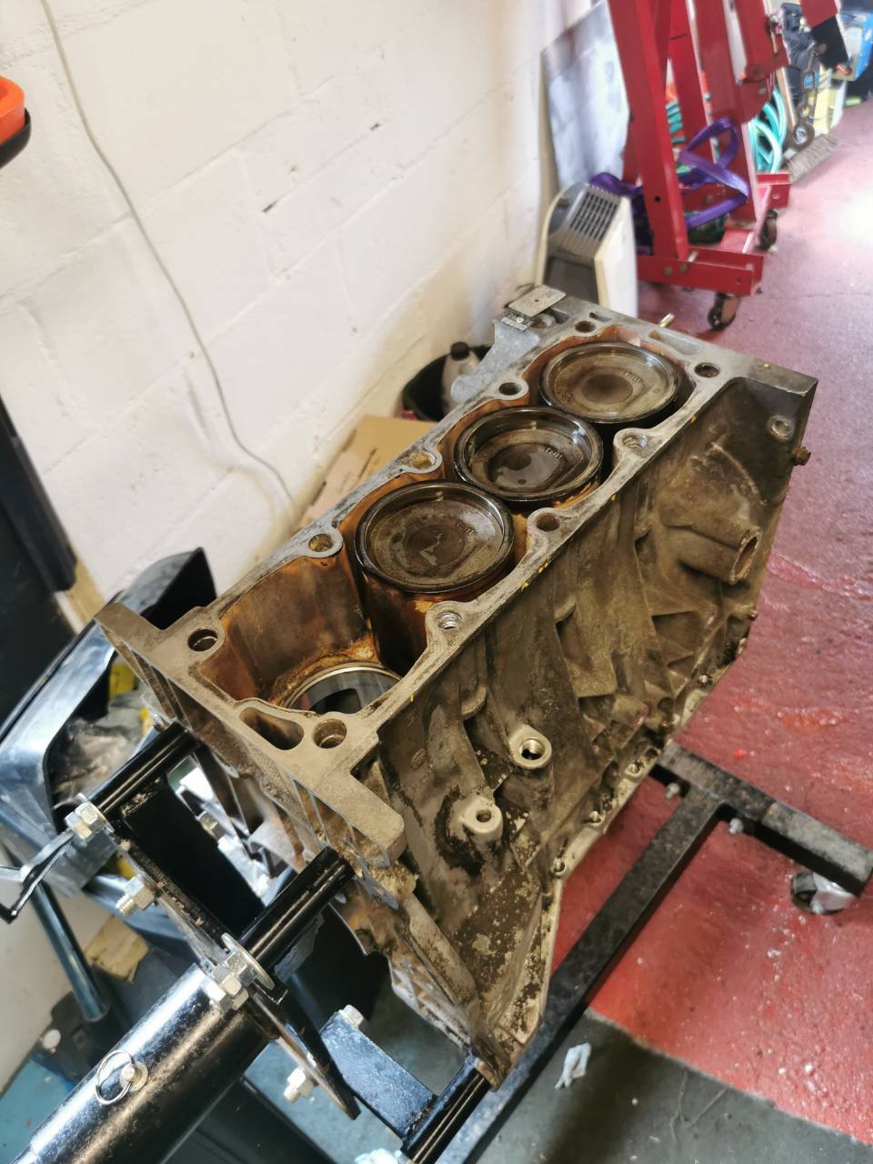

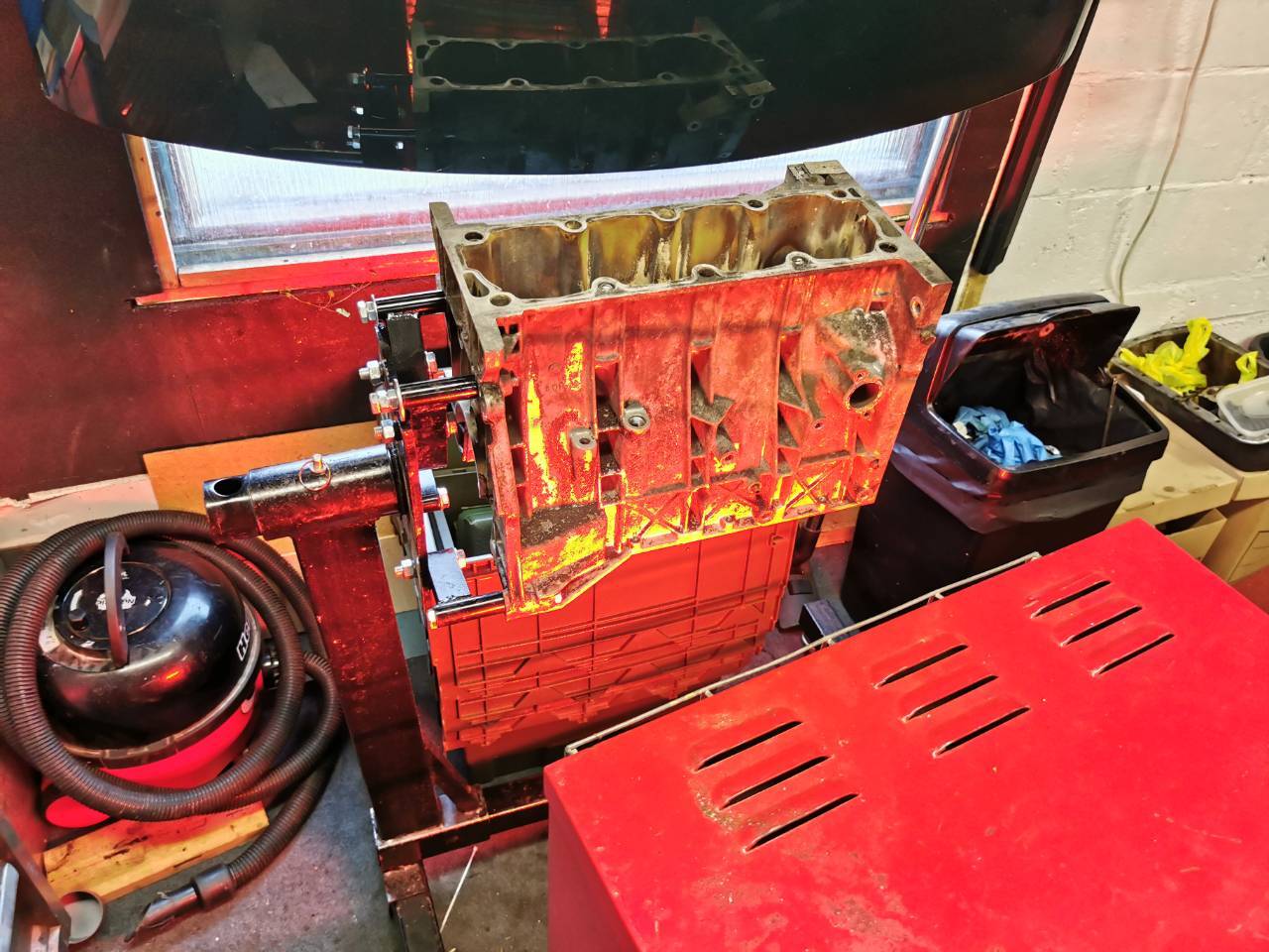

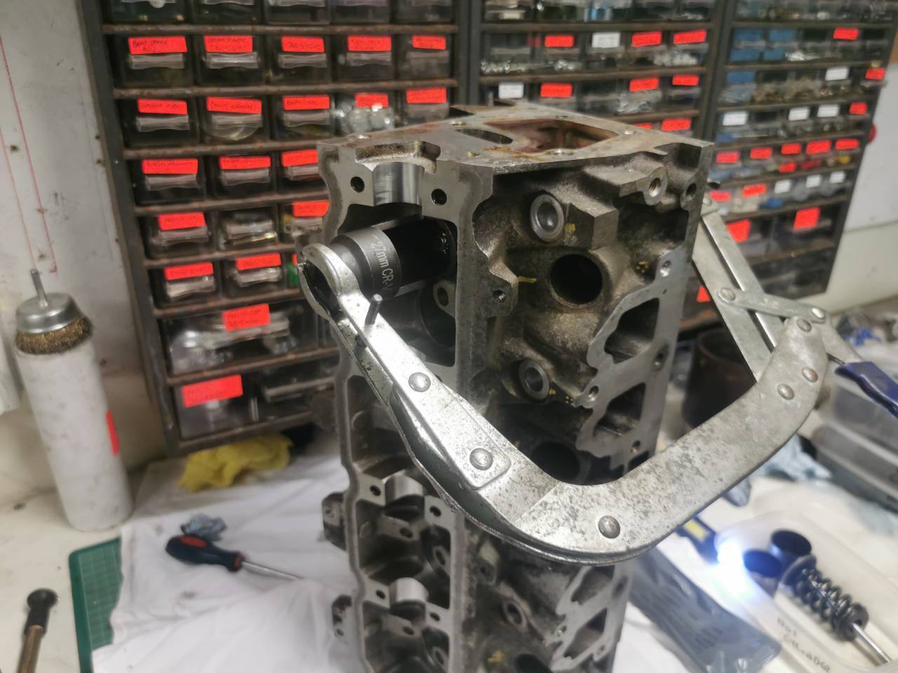

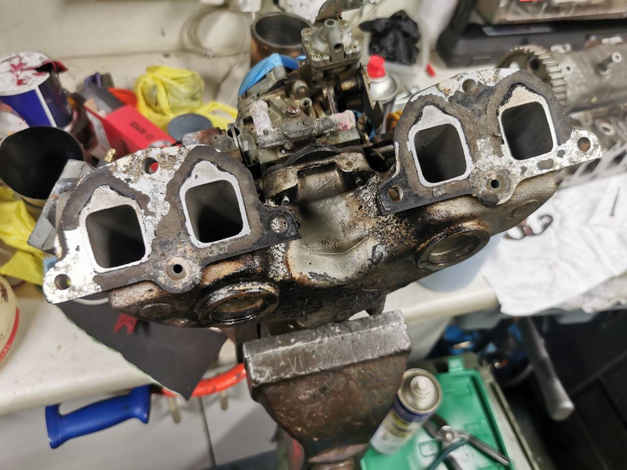

Both the block and head have loads of swarf and debris in the chambers so they'll require a thorough clean before assembly.
As it's late and I have work in the morning, I tried my hand at removing the valve stem seals. Tricky little bastards, but heating them up with a heat gun helped free them.

Thought I'd get a head start on it by dragging the block out to clean it of all the swarf from the machining. Covered in neat degreaser, brushed on and pressure washed off.
Popped it in front of the UV lamp to fully dry it off.
Then, I loaded the piston rings onto the first piston.
Then, the fuckery came in waves. Firstly the two piston ring compressors I had wouldn't tighten the rings enough to get in the liner.
Then, big problem.
The liner was found to have a crack in it. Granted, I'm not sure if this occurred when it fell off the bench earlier or wether it was always there, but it put me in a proper foul mood, so I stopped for the evening before I did something I regretted, fired up eBay to get a new one, and went inside for lots of booze.

Well, the block is on hold until I get the new tooling and spares, so may as well crack on with the head. I've moved my leave at work one day later to Tuesday and Wednesday to work on the block - hopefully everything arrives before then 🤠

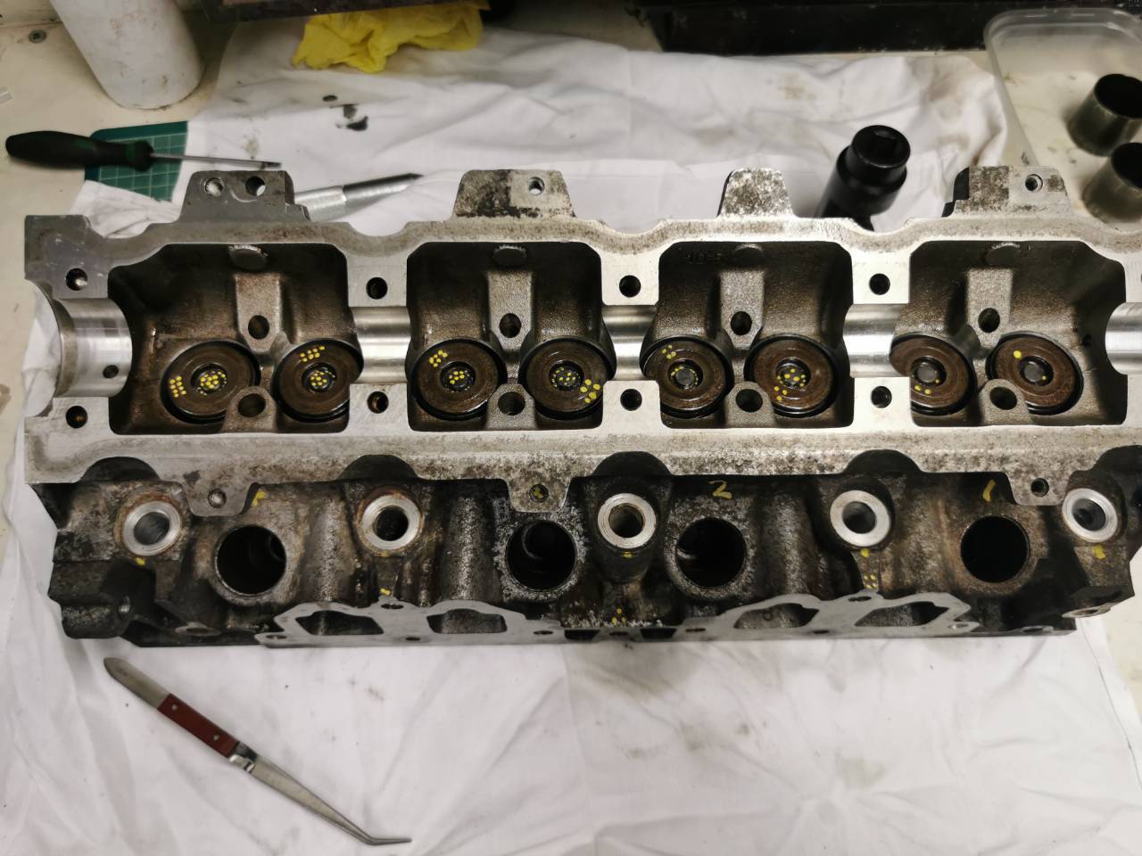

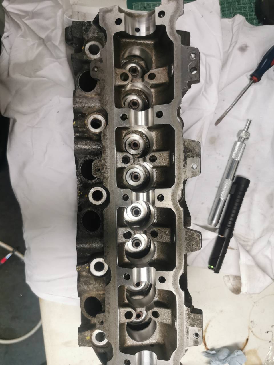

Starting with lapping the valves.
This was actually one of the most relaxing jobs I've done on this car. Nice and steady, and taking my time.
Results are promising too.
Should help keep the head a bit more gastight!
After a lot of tweezer action, fangs, and the air gun, I got the majority of the swarf out of the head chambers, I installed the valve stem seals - piece of cake with the insertion tool that came with the removal pliers.
Finally, it was time to re-introduce this haggard lash-up to reassemble the valves!
I was unsure if this was going to work this time around, but thankfully it did!
With the stems lubed and the collets greased, everything came together nicely and all 8 valves were fitted.
After that, the tappets and shims were greased/lubed and fitted, and the camshaft studs fitted. Going to check torque them again with the advice from @red5 (Thanks mate!).

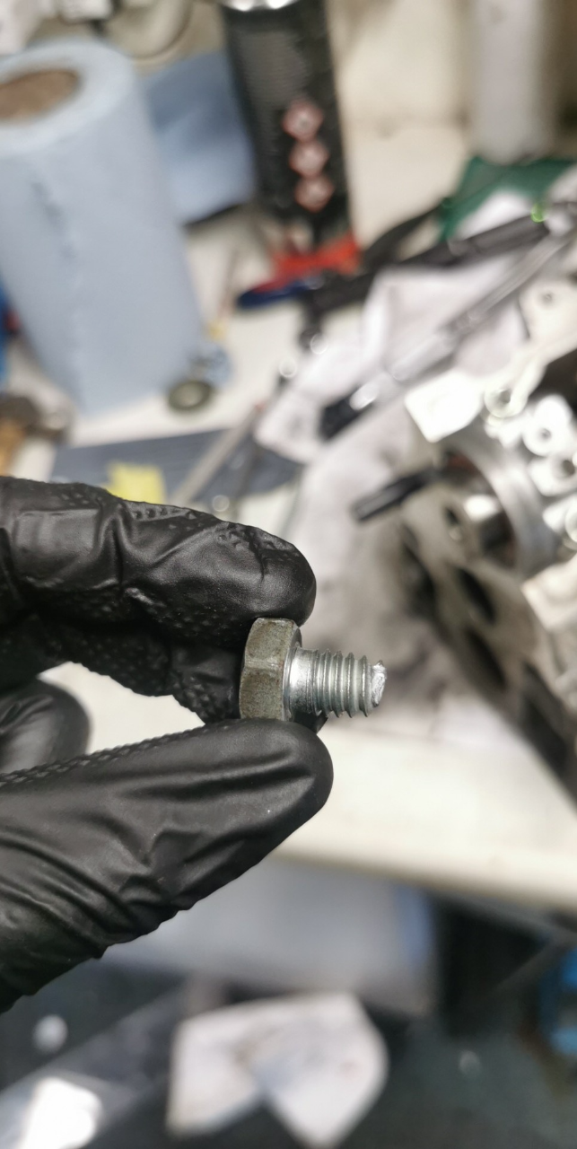

First up, trying to torque the camshaft cap studs was a pain, 15nm was simply not happening, even with the two nuts tight against each other, it was still turning down the shaft when close to 15nm. Tried adding a third nut to see if that would help matters, but ended up stripping the threads on the nut.
In the end, I went for 10nm. It'll be fine, I hope. Fitted the cam, and new front cam seal before I torqued down the caps (minus one nut).
Then it came to the camshaft pulley. Following the torque figure, I didn't even get close to the Haynes figure before disaster struck.

And getting this dirty bottle cleaned up as much as possible.
Which cleaned up alright, but had highlighted how big the crack in the side of the tank was:
As it was the rarely-used rear washer tank, I elected to try and repair it rather than replace. I used an old soldering iron to re-melt the plastic along the crack. It's not pretty, but it's sealed up and shouldn't leak so that's a win.
The bottoms of these bottles have a sharp lip around their manufacturing joins which has been suggested aids corrosion by chafing through the paint - these were sanded down prior to install. The scuttle area had already been heavily lanoguarded about six weeks ago so all should be well there.

Eventually, I decided to carry on with assembling the 3 pistons and liners, I'm still awaiting parts to assemble the final cylinder but this is a good start.
Turns out I needed to order another set of piston rings too, thanks to my ill-fated attempt to fit them last time:
Annoyingly, this was a pain in the arse. Autodoc did them at a reasonable price, but the delivery time takes the piss at around a fortnight. I found some on eBay with a two day delivery, so I placed the order on Sunday. I then sent the seller my details, and they cancelled the order! Apparently they weren't compatible. I've told them I want the rings and will assume the risk - the manufacturers of the piston rings list the set as compatible for every 1.6 XU engine except the XU52C. I can't see what difference there would be though, so I guess we'll find out in a couple of days.
Anyway, the ring gaps were checked prior to fitment, they were all bang on at around 0.50mm.
With the new set of plier-style piston ring compressors, I was STILL having issues with the rings.
I asked Phill for advice, and he very gently pointed out I was being a bit of a fuckwit and assembling the oil control ring at the bottom incorrectly, which in turn meant the ring wasn't compressing properly.
With the correct advice dispensed, and a slight tweak to the piston ring compressor, we were finally making progress! A fresh seal was fitted to the base of the cylinder liner before slotting it into place.
Eventually, I got all three complete assemblies in.
And clamped the liners down.

I decided to crack on with bolting in some external components, so the oil pressure switch, water pump and timing belt tensioner pulley went on (the old one was really rather grumbly and rattly)
The pump came from Autodoc and was their own brand (RIDEX) and it seemed pretty well made.
Next up, the crank bearing seats were cleaned, new shells were fitted, and the crank lowered into place. This was a pain in the arse with the liners and pistons fitted as the conrods were in the way, this was aided with some steel wire to hold them in the middle position.
The crank bearing caps had fresh shells and an oiling before being loosely assembled.
I'm still awaiting the seals for No.1 bearing cap so I've not fitted that yet.

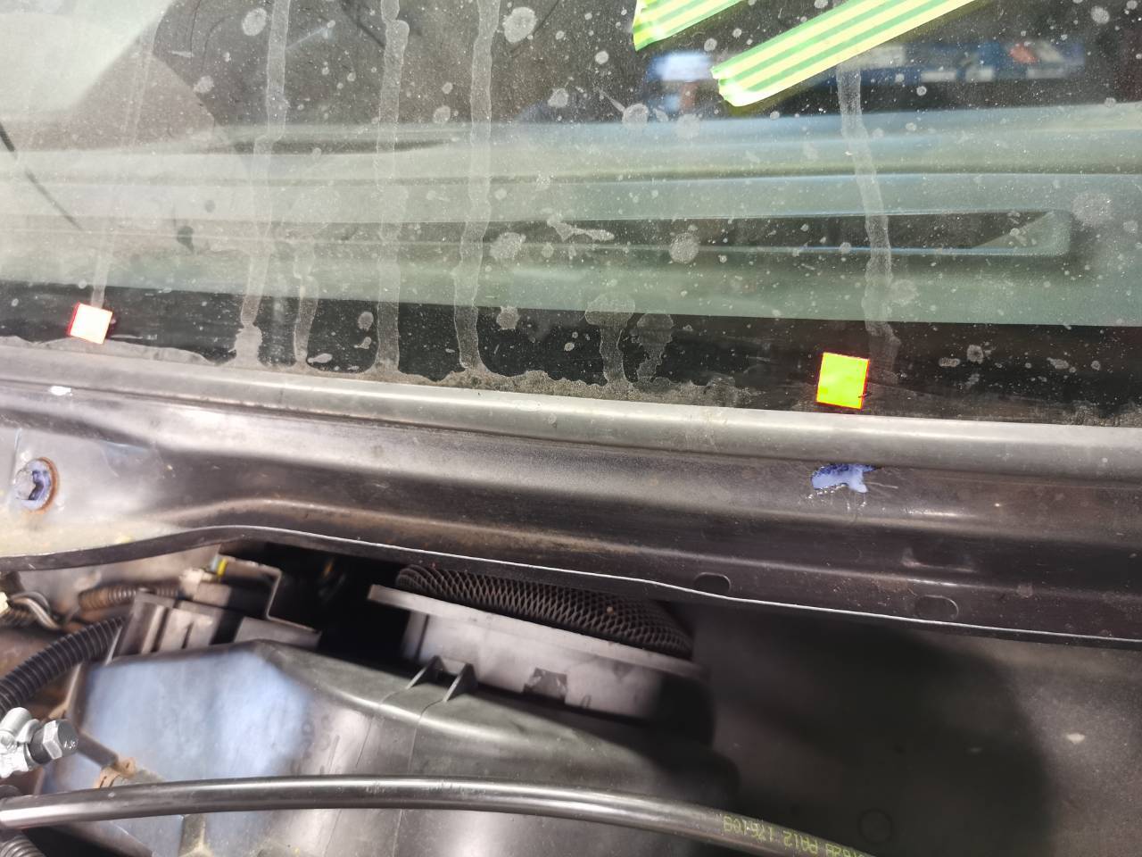

After that, it was applying the last coat of lacquer to the windscreen frame rust spots. The paint colour match is pretty poor, but it won't rust and that's what matters.

Got home and checked the nut - it's a good fit, a bit taller and with a wider flange than the originals, it feels much more substantial. The nut is originally used to hold inlet manifolds onto various BMWs.
I started checking valve clearances but this ended up being a pain to rotate the camshaft without the sprocket bolted in. I checked the first 4 and found them to be juuuuust within limits, I'll check the other 4 later when I've got the camshaft bolt and torqued it in.

And the inlet manifold gasket was tackled.
This took an absolute eternity - it was properly on there! The mating faces were eventually cleaned with a scotchbrite pad and WD40 to get a smoother mating face.
