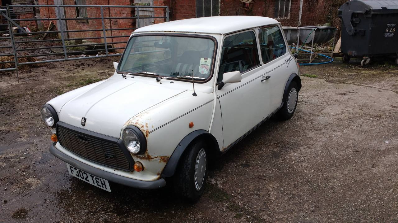

Blake's Den Posted December 21, 2020 Posted December 21, 2020 Hello all Long time lurker and occasional poster here. I thought that I would share my classic Mini Designer project with you. There seems to be a lot of love for old mini's on here plus everybody has had some connection with mini's over the years. I'm actually mid way through the recommissioning of this. I'm avoiding the word restoration as that would suggest I know what I'm doing! The pic below was how it looked when I bought it back in 2016. Doesn't look too bad for a thirty year old car but mini's can and will rust about everywhere. The wing was an obvious problem but there were lots of issues lurking underneath... The sills were a joke! Both drivers side and passengers side pretty much disintegrated. This picture shows the old versus the new. I recently went through a mini rite of passage by removing the rear subframe. Things weren't actually too bad under there although I did find a hole in the frame when I was poking around. The boot floor and heel board are surprisingly solid. If you aren't a one for reading words then you can watch my youtube video to see what I did. theshadow, UltraWomble, The Old Bloke Next Door and 34 others 37

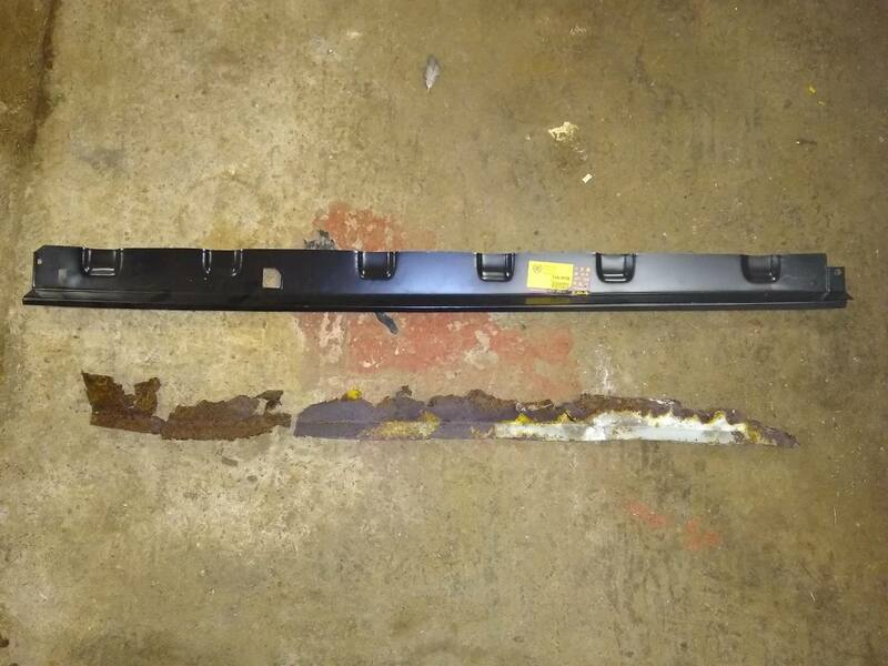

garellikatia Posted December 22, 2020 Posted December 22, 2020 Lovely car mate, good job in acquiring the proper sized sills. Nothing worse than peeling back dreaded over sills to find a pit of Rot and corrosion. Blake's Den 1

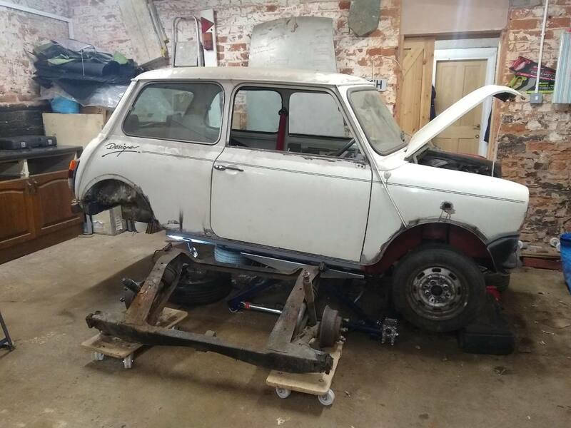

Blake's Den Posted December 31, 2020 Author Posted December 31, 2020 I've been making the most of those days between Christmas and New Year when nobody really knows what day it is. The plan was to remove the rusty rear subframe bolts which had sheared off when I was removing the frame. I thought that this would be an easy task but it soon escalated! I found that the captive nuts had failed on both sides which meant that a repair to the heel board was required. I’m still impressed by the lack of rust on the heel board. Hopefully I’ll make some more progress before I’ve got to go back to work ☹ Remspoor, Twiggy, FakeConcern and 1 other 4
Rusty_Rocket Posted December 31, 2020 Posted December 31, 2020 Nice work! We've all been there with the sheared subframe bolts 😬 If you don't want to disturb the heelboard, you can just about get access to the captive nuts from inside the rear bins, next to the rear seat base. If you look inside the rear companion boxes, you'll see a closing panel which appears to join the inner sill/ rear 1/4 area to the rear inner arch. This panel is lightly spot-welded into place, only down one side. If you drill through these and carefully prise the panel upwards, you'll be able to look down into the rear of the heelboard and those troublesome captive inserts will be revealed! That's why my '83 City E has 3x bolts going into captive nuts and 1x bolt with a nylock on the other side 😄 tooSavvy 1

Blake's Den Posted December 31, 2020 Author Posted December 31, 2020 5 hours ago, Rusty_Rocket said: Nice work! We've all been there with the sheared subframe bolts 😬 If you don't want to disturb the heelboard, you can just about get access to the captive nuts from inside the rear bins, next to the rear seat base. If you look inside the rear companion boxes, you'll see a closing panel which appears to join the inner sill/ rear 1/4 area to the rear inner arch. This panel is lightly spot-welded into place, only down one side. If you drill through these and carefully prise the panel upwards, you'll be able to look down into the rear of the heelboard and those troublesome captive inserts will be revealed! That's why my '83 City E has 3x bolts going into captive nuts and 1x bolt with a nylock on the other side 😄 Now you tell me! I'm quite happy with the repair. The heel board is in suprisingly good condition. I was poking around it today and was pleasantly suprised Rusty_Rocket 1

Blake's Den Posted January 18, 2021 Author Posted January 18, 2021 A bit more progress made this weekend. I did a bit of digging around to see how bad the rust was ar the rear end. It's a bit odd; the wheelarch is gone as expected but the battery box is solid. Normally these are the first things to go, maybe it had been replaced in the past. Unfortunately I've found some big rust patch on the boot floor / rear seat base area. I'm actually glad that I found it as it is right next to the rear seat belt mounts. There must be a moisture trap between the sub-frame and the body. The thumbnail makes it look a lot worse than it actually is! Mike D, Craig the Princess, Burnside and 4 others 7
