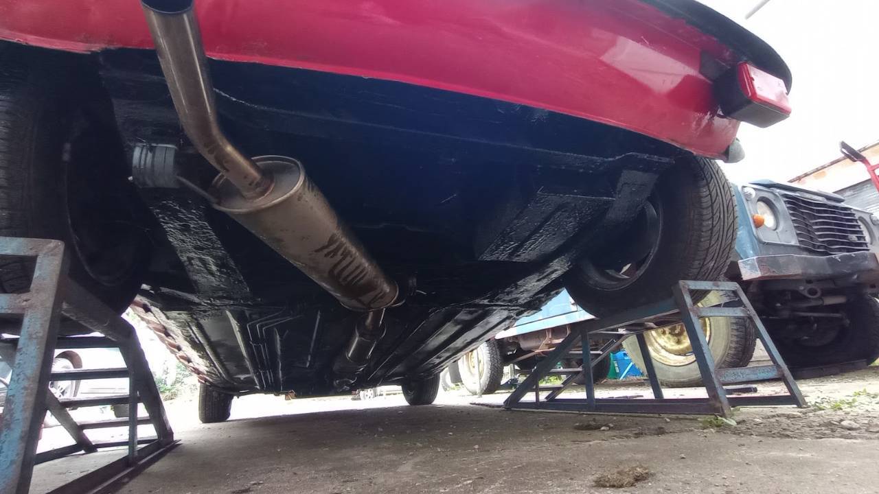

Blake's Den Posted February 17, 2024 Author Posted February 17, 2024 Back to Mini content. I've been making more progress on the Designer, I've finally got around to coating the underside of the boot floor with Gravitex. Top tip - it is messy stuff! I got it absolutely everywhere - over me, the floor, cupboard, wall, seat, camera, overalls and shoes! It is worth it though, I'm very happy with the result. The next step is to build up the new subframe. Remspoor 1
