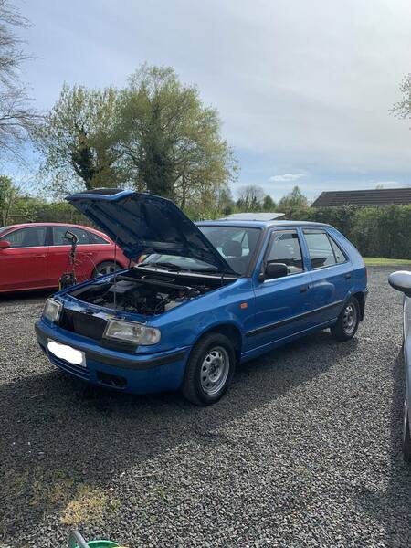

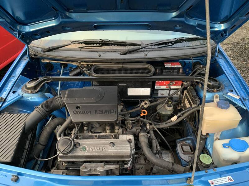

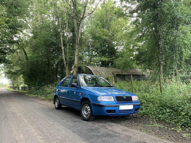

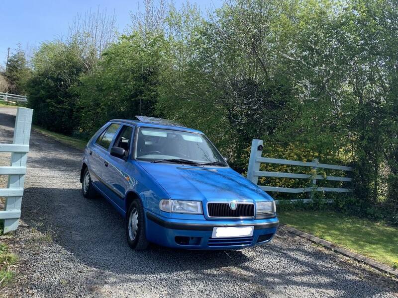

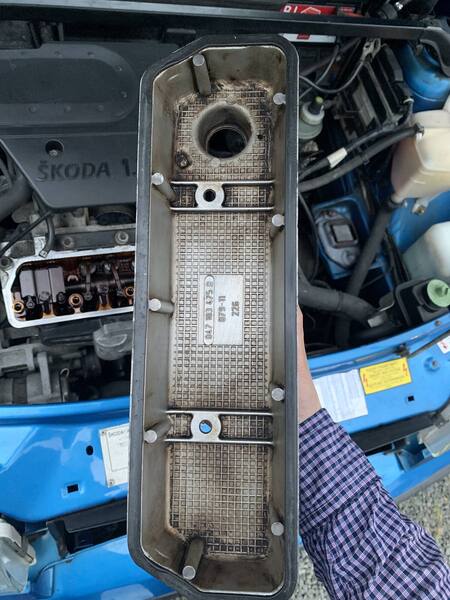

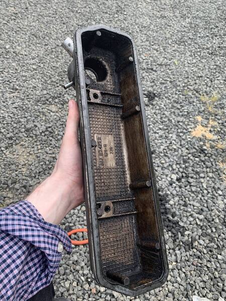

L fallax Posted August 7, 2020 Share Posted August 7, 2020 I’ve been considering making a topic for progress with my Felicia for a little while, I want to reflect on what’s been done in a more organised fashion compared to flicking through photos on my phone. I’ve had a keen interest on older generation Skoda for quite some time (100series-Facelift Felicia), I bought this 1999 T reg Skoda Felicia mid April. Would of loved to buy the pre-facelift model but sadly most seem to have been scrapped, however mine does come with the 1.3 OHV engine -the same used in Rapid 136’s, albeit slightly modernised and with Siemens multi point fuel injection producing 68bhp. First pic after a wash. Missing headlight trim, dinged rear OS door, NS fender is a bit bashed in as the original owner must of had a bit of a bash, the whole bumper sits a little lopsided. Hopefully can get the bodywork pulled at some point. Wanted to put in the effort to get her running smoothly with some maintenance: new oil & filter, air filter, coolant flush, wipers, bulbs, spark plugs, fuel filter, valve cover gasket etc. Drained the gearbox and refreshed it with new oil, was grinding going in reverse the odd time, and this solved it. Engine bay needed multiple washes to clean up, looked a right bombsite when I bought it, some neglect was evident from past owner! Blue Lagoon Metallic is the colour for anyone wondering. Next to do is fit new discs & yellowstuff pads which have been sat in the boot for a couple months, need to file the edge of the pads down a tad and find a way to remove the locking pin screw from the disc. The goal is to fitting some modifications, some stiffer lowering springs and alloy wheels with good tyres. Nothing too crazy. The ride is pretty good, very little body roll, the strut brace seems to work well. A very responsive little motor, town and rural road driving is good fun. Updates to come. BorniteIdentity, DoctorRetro, sdkrc and 27 others 30 Link to comment Share on other sites More sharing options...

wesacosa Posted August 9, 2020 Share Posted August 9, 2020 nice car. Apart from the HG , which is an easy fix if the worst comes to the worse, those engines go on forever. I have the single point injection version in my Favorit and did 2000miles across Europe to Monaco and back in almost 40deg heat last year and it didn't miss a beat Wingz123 and L fallax 2 Link to comment Share on other sites More sharing options...
Bitzer Posted August 9, 2020 Share Posted August 9, 2020 Yup. My sister had one of these old engines in her Phobia. New HG was, IIRC, some €10 and the only trouble was finding someone ready to lend me a 25 Nm-capable torque wrench, which I do not own. L fallax 1 Link to comment Share on other sites More sharing options...
barefoot Posted August 9, 2020 Share Posted August 9, 2020 Do they come from the factory with that strut brace? L fallax 1 Link to comment Share on other sites More sharing options...
Agila Posted August 9, 2020 Share Posted August 9, 2020 23 minutes ago, barefoot said: Do they come from the factory with that strut brace? I seem to remember mine had that. Mine looked factory installed. L fallax and barefoot 1 1 Link to comment Share on other sites More sharing options...
Kiltox Posted August 9, 2020 Share Posted August 9, 2020 48 minutes ago, barefoot said: Do they come from the factory with that strut brace? Yes! barefoot and L fallax 1 1 Link to comment Share on other sites More sharing options...
L fallax Posted August 9, 2020 Author Share Posted August 9, 2020 On 09/08/2020 at 09:35, wesacosa said: nice car. Apart from the HG , which is an easy fix if the worst comes to the worse, those engines go on forever. I have the single point injection version in my Favorit and did 2000miles across Europe to Monaco and back in almost 40deg heat last year and it didn't miss a beat Will definitely be keeping a close eye for any indication of oil and coolant mixing, after draining the oil it was just old and very dark. the rocker arms and valves were clean too (apart from old oil again). Wow though, what a journey! I'm looking forward to putting miles on Gave the rocker cover a good scrub as it was quite mank looking Replaced the gasket as it leaked a lil oil down the side of the 4th Plug but now all is well wesacosa, stripped fred, Yoss and 4 others 7 Link to comment Share on other sites More sharing options...
wesacosa Posted August 9, 2020 Share Posted August 9, 2020 1 hour ago, L fallax said: Will definitely be keeping a close eye for any indication of oil and coolant mixing, after draining the oil it was just old and very dark. the rocker arms and valves were clean too (apart from old oil again). Wow though, what a journey! I'm looking forward to road tripping very much! After taking of the valve cover I gave it a good scrub out as it was quite mank looking. Much of an improvement, the gasket is the one that I went and replaced. Leaked quite bad down the side of the 4th Plug but now all is well it's normally not the water mixing with oil on those engines, but the combustion getting into coolant. Check for header tank level change, oil or combustion smell in header tank and headed tank retaining pressure even after leaving overnight L fallax 1 Link to comment Share on other sites More sharing options...

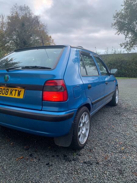

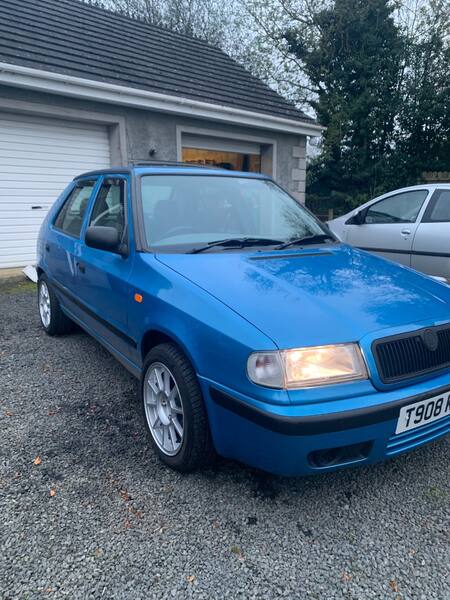

L fallax Posted October 25, 2020 Author Share Posted October 25, 2020 Update 1. Found some pretty mint alloys that were once on a MK2 Jetta but have since been refurbished with new tyres put on. Still need to source some new bolts before I can put miles onto them, a bolt has already snapped in the bloody hub when doing a test fit! Fitment looks good though, much chunkier tyres with a lower profile! Not sure if I’ll have the height for thicker springs now without some rubbing. Coprolalia, sierraman, crad and 4 others 7 Link to comment Share on other sites More sharing options...
loserone Posted October 27, 2020 Share Posted October 27, 2020 Alloys are a bit personal taste, but lovely looking car. I'd really like a go of one. L fallax 1 Link to comment Share on other sites More sharing options...
DoctorRetro Posted October 27, 2020 Share Posted October 27, 2020 Looks smart. I can foresee some arch rolling being required on the back if that is where they sit fitted, and definitely if you lower it. If you do roll the arches, just don't do it with mole grips like someone once did, it will look horrid. 🙄😂 L fallax and theshadow 2 Link to comment Share on other sites More sharing options...
