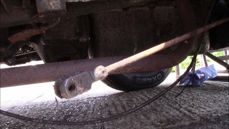

Then get yourself under the car and try and figure out how you're going to undo the three bolts holding the starter on without removing the exhaust.  I'd been advised removal of the exhaust was necessary and while it would certainly have made life easier, it turned out not to be needed.  The big problem underneath the car is that when I had the socket and ratchet on the through bolt and nut, I couldn't swing either far enough before I hit the chassis or the exhaust.  I didn't have the time to do this on the day I attempted it so packed up, put the car away, and waited until Pat was free of work when I was free of work to have another go.
The next free time we had the car was wheeled out again, put on a stand again, and Pat had a good look to see if inspiration would strike a fresh pair of eyes.  It did!  He found he could get in with the ratchet from above and get a bit more swing if I held the spanner from below.  After longer than either of us wanted, we had this one bolt out.  The other two were much easier.  As it happens, I managed to put this bolt back in from underneath the car on my own with a socket and spanner, using the spanner to turn the nut a tiny amount in the space available, while holding the bolt with the ratchet.  It took a while, but it was also less grief than pulling off the exhaust.  Our next obstacle was the bolt holding the main lead which we couldn't get any tools on.  Normally this bolt is really easy to get to by just going under the front bumper and undoing it, there's not even a need to jack the car up because of the impressive ground clearance and access.  Here's the view from the front with the starter removed.
That's right, we had to remove the starter to undo the bolt.  The reason for this was that the two wires that bolt on to the starter had been put on in such a way that the thinner wire with the crimped eyelet was acting like a locking washer and there wasn't any access to bend it out of the way.  It looks like when it was last done up, it had bent and locked onto the bolt head as it was done up.

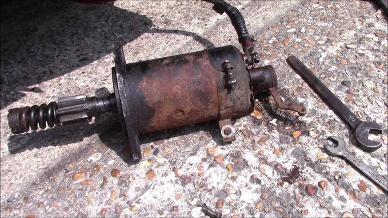

Ah, but I'm a little out of order here.  How did we get the starter motor out without taking the exhaust off?  Well, it was a lot easier to simply disconnect the brake rod.  The brake rod is held to a bracket via a clevis pin and cotter/split pin.  Remove the two pins and the brake rod simply swings aside allowing you to finegle the starter motor out of the restrictive gap it lives in between the exhaust and the sump.  Here you can see the offending crimp, the wire it was crimped to had gone very brittle and broke off when we first attempted to undo the bolt.
It had taken us so long just to get this starter out that it was all we did that day on the car because of course we had to allow time to pack up all the tools and push the car back into the garage.

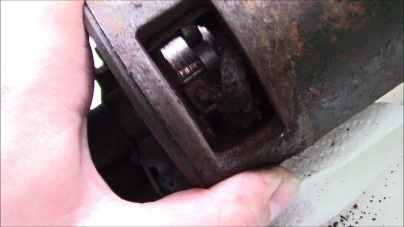

Inside we saw that the commutator and brushes were quite dirty.  Just moving the starter around to inspect it ended up with a lot of debris falling out of the case.  Our theory that the internals were corroded and dirty seemed to be a sound one thus far.

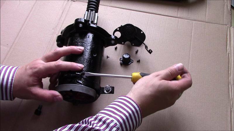

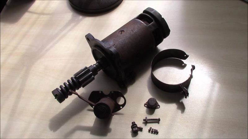

Next was to remove the end covers.  The smaller cover allows access to the main spindle so you can rotate and clean the commutator without removing the starter from the car, it is held in with two small screws.  The larger cover also houses half of the contact switch which is engaged by the starter knob inside the car by pulling the cable that's attached to the arm.  The larger cover is held on by two additional screws. These both came off very easily.
Once this was open another problem was apparent.  There was a contact being made between the disc and plates of the contactor switch but it looked to just be in one small spot for the most part which didn't seem ideal.
When you pull the starter knob in the car, it pushes the disc into contact with the plates on the starter motor, thus completing the circuit and allowing the starter to spin up and engage.
As you can see, while the lever does move freely, all the bits that should be clean really aren't.  After some time with contact cleaner, an old toothbrush, and cotton buds, I finally got the brushes moving freely in their sockets and got as much dirt as I possibly could off the surface of the commutator.  The commutator surface has got some scores in it but I doubt it will cause significant issues with the operation of the starter.  All of the copper components inside the starter are quite substantial and crude compared to modern equipment so I daresay the tolerances aren't particularly fine and will work perfectly well even when in quite poor condition.
With all of the copper components cleaned as best as I could, I put the loose parts of the starter in the ultrasonic cleaner to remove the grime and some of the rust.  It was quite effective.
I didn't put the main body of the starter motor in the ultrasonic cleaner in part because that seemed like a bad idea and in part because it wouldn't physically fit.  Instead, I scrubbed all of the rust I could off the body of the starter with a wire brush.  After that, it was time to paint.  I opted to hand paint everything with enamel rather than opting for faster aerosols.  I felt this would be more in keeping with the car and would save me the hassle of a lot of fiddly masking.  To make the painting of the parts easier, I used a cardboard box with holes in for the screws and starter motor, if you make the screw holes a little smaller than the screws, you can then wind the screws into the cardboard to hold them in place.
A coat of Kurust, two coats of red oxide primer, and a two coats of black enamel later and everything was looking smart if not new.  As with the water pump, this will give us both a quick visual reminder of what we've worked on as well as allowing the parts to be less than perfect and mellow out into the general look of the car.  Cared for but not restored.  Once the paint was hard enough, I reassembled everything and waited for the next opportunity to get on with fitting it to the car.

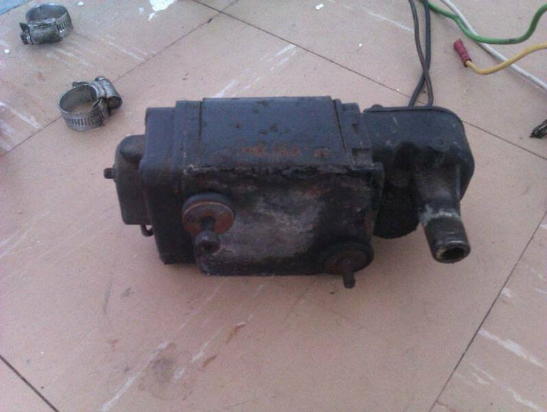

The core on the heater leaks, and looks to have been doing so for some time.  Pat and I have been warned that these heater boxes are sensitive to pressure, too much and they burst, so perhaps that's what happened here?
What came out of the heater wasn't too nice.  It smelled like overheated coolant and had a slightly greasy feel, like mayonnaise, while also being a decidedly unpleasant colour.  We're hoping we can get this flushed and repaired since it seems to be original to the car.  We know more modern heaters exist, and this one could probably be retrofitted with something of that sort, but it would be nice to retain this one if we can for the novelty of it if nothing else.
