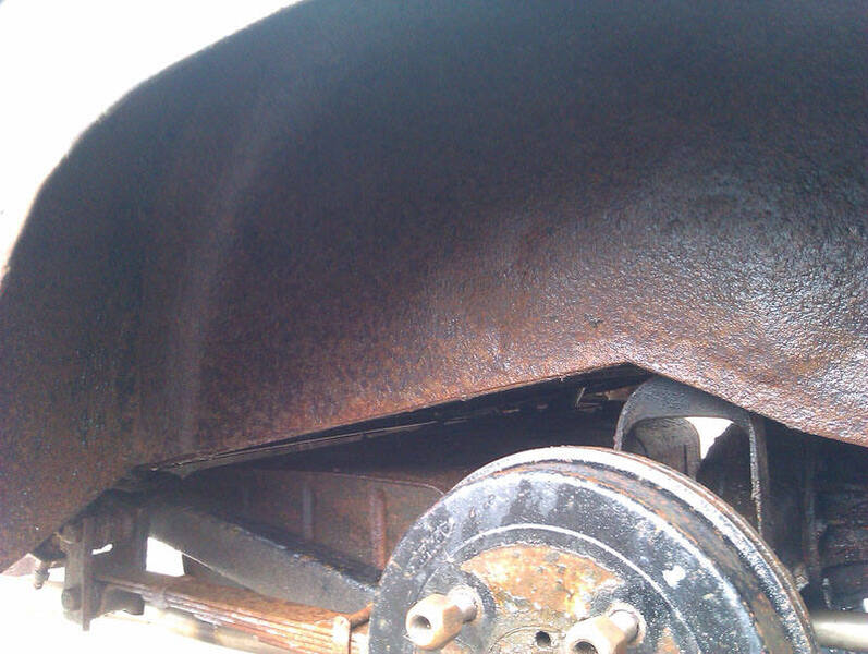

Today's update began with us getting the car ready to have new tyres fitted.  Obviously, everywhere is shut today so the tyres can't be done until tomorrow, and our schedules don't align tomorrow so we opted to take the wheels off the car today and leave the car outside overnight  until the new tyres are fitted.  Not a perfect solution, especially if it rains, but we have a solution for that too.  Then I discovered I only actually have 2 axle stands, not the four I was sure I had, so we improvised at the front with the ramps a neighbour gave us and they work just fine as an impromptu solution.
The first issue we encountered was one wheel nut taking the stud out with it.  We don't know why this stud is so much shorter than all the others or why the nut is stuck on it, or even if it's from this car.  It does hold the wheel on so it's probably perfectly fine.
Something to sort out another day that one, it can stay as is for now.  With the wheels and tyres loaded up for tomorrow, it was time to clean out the arches which, as it happens, really weren't that bad.  Surprisingly at the back the steel splash guards are still intact and in pretty good shape.  Here's a before and after to show how that all scrubbed up.  We plan to get some rust converter, black paint, and underseal in here to keep things solid.
At the front, much the same story.  Before and after of opposite sides due to a lack of forward planning, each side of the car was much the same and it was surprising just how clean it really was under here.  There's a little more red oxide on some of the edges on the passenger side, which is also the side with the newer looking wing so this is probably due to some old repair work, probably nothing serious since there's no sign of crumpled metal or panel beating so more likely just damaged paint and fixings from whatever damaged the wing.
