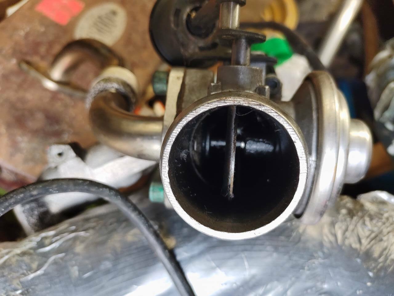

rusty998 Posted March 10, 2021 Posted March 10, 2021 I've got this EGR valve that came off my old Skoda Fabia 1.9 100bhp, I know that it was fully working before the car was written off, your welcome to it for nothing if you can cover the postage costlet me know if you would like it? Cord Fourteener and davehedgehog31 2
Cord Fourteener Posted March 10, 2021 Author Posted March 10, 2021 3 minutes ago, Dick Longbridge said: Fair enough. I knew the car had been through a few members on here; regardless of that I think I'd still be having a chat with the seller if the car was going into limp mode days after taking ownership of it. Unless it's complete coincidence of course. 😉 He says it wasn't, I have no reason to doubt him.
Cord Fourteener Posted March 10, 2021 Author Posted March 10, 2021 Just now, rusty998 said: I've got this EGR valve that came off my old Skoda Fabia 1.9 100bhp, I know that it was fully working before the car was written off, your welcome to it for nothing if you can cover the postage costlet me know if you would like it? Ok, I'm at work just now but I'll have look later. Thanks👍 rusty998 1
