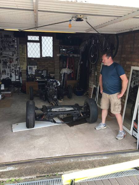

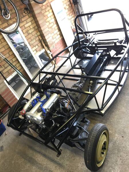

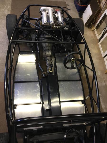

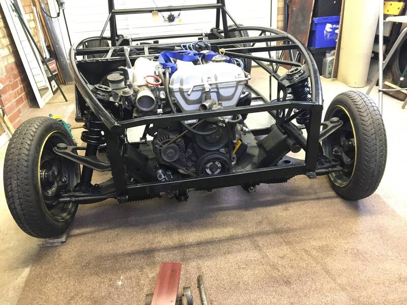

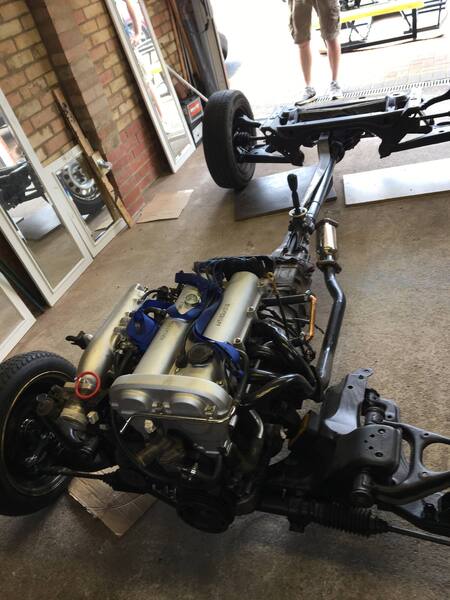

Quite a big day, the plan was to unite some running gear
with the Exocet chassis
fortunately, I had a keen helper in the form of mr Paulplom
so we did a bit of rearranging in the garage and got ready for a bit of a battle
but, without so much as a single sweary word being used,
BOOM ! There's your fupping kit car !
ok, maybe not quite so easy but it didn't take long to get it put together.
the rear subframe bolted up nice and easy
and we stood back to admire our handiwork
how about the front, I hear you ask ?
shit, fuck, piss, wank and bollocks !

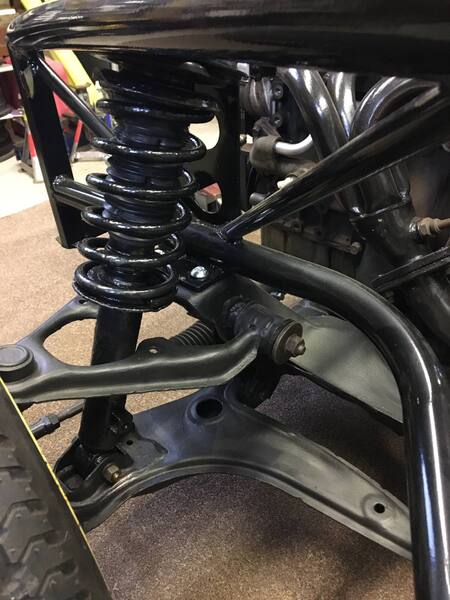

no matter what we did, the front subframe would not line up :(

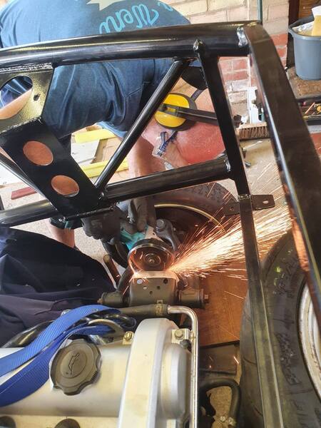

the geometry of the Exo has the front shocks at more of an angle than in the mx5, depending on what suspension you choose, drastic action may be called for

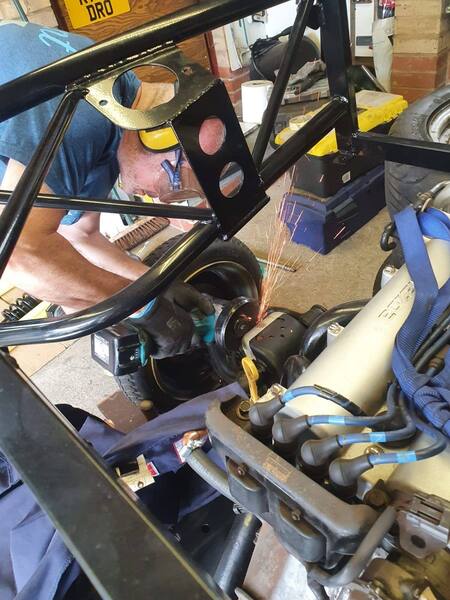

Paul had a rake about in his van and produced his angriest grinder !
fuck you, subframes !
There is a lip that sticks out and fouls the spring seat, a bit of choppy choppy chop chop and clearance has been made
the upper wishbones needed a similar approach and a slice was taken out
there are a pair of "banana brackets" supplied in the kit to replace the lost strength in the wishbones, I gave them a lick of paint ready to fit.
but still we couldn't get the front subframe to line up :(
a quick jaunt down to tescoos to grab a bite of lunch and a plan was hatched...
take the front shocks out, re-re-re-re-fit the chassis and put the shocks back later on.
ten minutes later...........

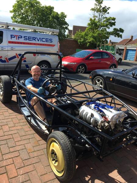

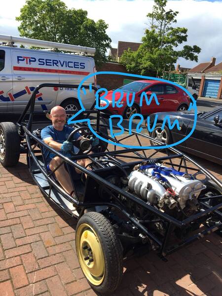

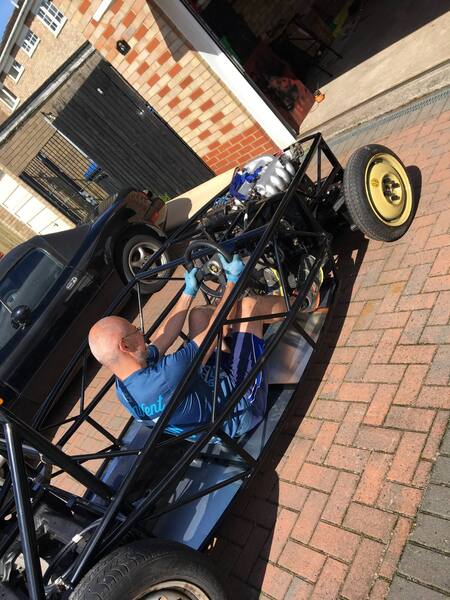

it only bloody worked !
how happy is this dude ?
ok, the front end is still held up with a couple of bits of wood where there should be shocks but that is a rolling chassis and I call that a RESULT !
MEGA-THANKS to @paulplom for his help today, there is no way I could have done this without you

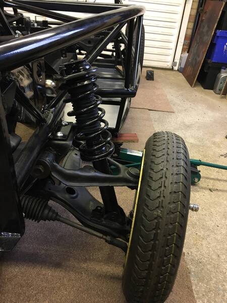

after a bit of a tidy up and a coffee, I had a look at those troublesome front shocks again - when changing front shocks on the mx5, the usual technique is to break the lower ball joint to give better access. I dug out the jacks and  started to lift the front end but noticed that the unsupported wishbones were sagging very low
so low, in fact, that you could just slip a shock absorber in there, as easy as that
lower the front end to the ground again, bolt up the top mounts and the jobs a good 'un - so simple, how could we have missed that
same thing on the other side and voila !
piece of piss :)

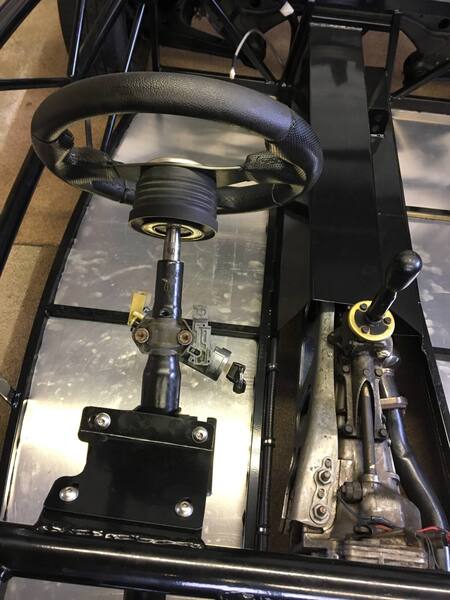

Last nights update was late because I had a go at fitting the steering column, which turned into a shambles :(
the column needs to be shortened by a non specified amount and the instructions are delightfully vague. Predictably, I managed to make it too short and had to take the whole damn thing apart. A couple of frustrating hours later, I gave up and abandoned the mess of bits.
With a fresh set of eyes, I got everything back together and, with a bit more fettling, got that column fitted :)
but wait a minute, what's that ignition key doing there ?
for fucks sake, how the hell did that happen ?
only a minor setback but so bloody frustrating.
still, wheel is fitted and steering works, another box ticked :)

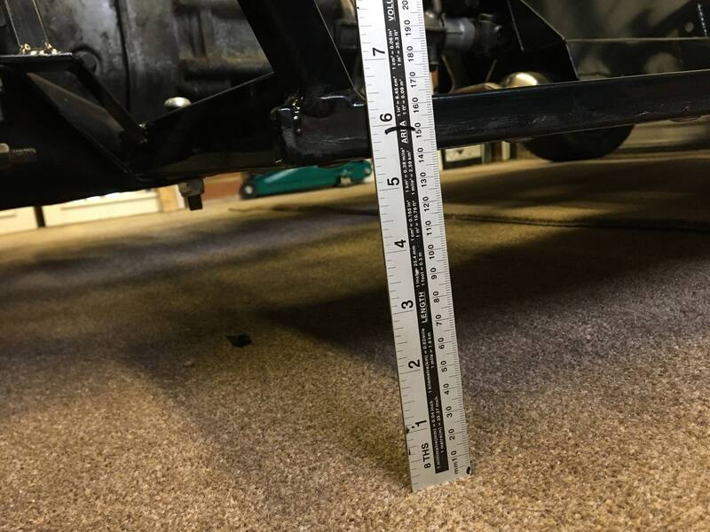

time for an easy job, I'll stick the proper wheels on and see how it looks, surely I can't fuck that up ?
looking good, how much clearance underneath ?
not much, it seems
front
rear
speed bumps will be fun*

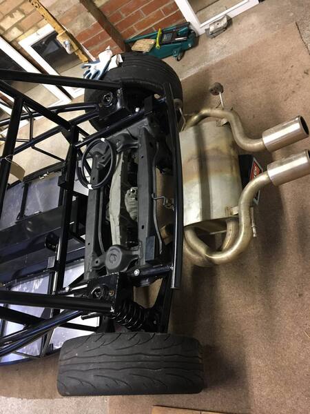

another quick job, let's have a look at that exhaust and see if it will fit ?
might* struggle at the iva with that one
but would look mental with a bit of a polish
i'll bung it on, at least during the build process, and see if I can borrow a proper one for the test.

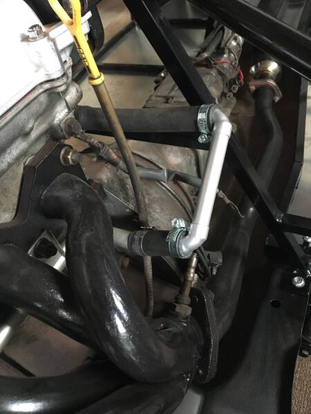

paulplom made me a 'steampunk' coolant bypass, neat but I might need to paint that one

1 hour ago, gm said:

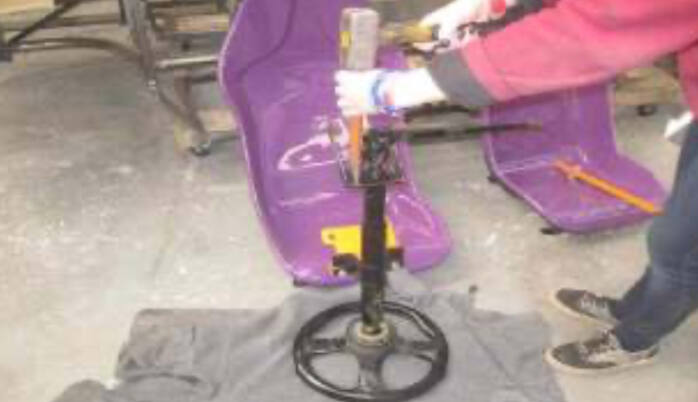

The column needs to be shortened by a non specified amount and the instructions are delightfully vague. Predictably, I managed to make it too short and had to take the whole damn thing apart. A couple of frustrating hours later, I gave up and abandoned the mess of bits.
How do you lengthen something you've shortened too much?
Shame the instructions are vague, might be worth passing that info back to the supplier to help future builders. I'm going to guess there are probably forums either for these kits or kit cars in general where other people have come across the same problem(s) before too - I know even YouTube has saved my bacon in the past when I've got stuck doing a job.
With great difficulty ! The column is telescopic, as is the shaft - this pic is as much info as I had to go on - I managed to compress the shaft too much so had to strip it all apart and very carefully (with a vice and club hammer) pull it back to size.
There is a good forum and a couple of decent facebook groups, a sensible person would have probably asked for help but I couldn’t resist getting stuck in and made a balls of it - lesson learned the hard way. But at least now I know how the column is put together - sadly no pics as I was getting really fed up by then.
It does occur to me how difficult it must be for those who make YouTube videos as they work, a lot of my time is spent puzzling things out or ballsing them up, wouldn’t make very good viewing, I think :)

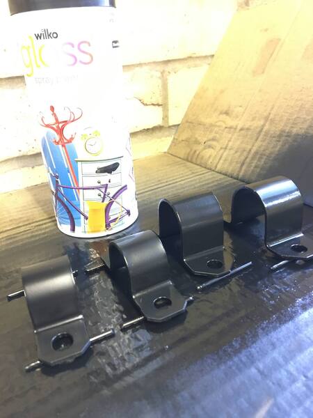

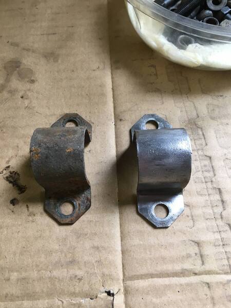

A quiet day today in terms of progress, just a little bit of painting - heater bypass pipe and the anti-roll bar brackets. I’m quite pleased with that wilkos gloss black paint, brackets look good as new.
