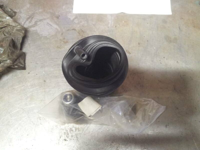

Having got this thing running properly I intended to move on to replacing the front wishbone bushes. Dived under the front to jack it up and found a large pool of oil on my newly-cleaned drive. I hate this bloody car! It looked like oil but was not under the engine or the gearbox, it was towards the nearside rear of the engine compartment, under the ABS unit, so my first thought was brake fluid, since I have already pratted about with this. But no. Turns out that the nearside steering rack gaiter had decided to split spectacularly and dump all the (new) power steering fluid. Another job I didn't expect, want or need. Should be straightforward enough though, right? Wrong! Bought a new pair of rack gaiters and set about replacing them. You can supposedly do this without removing the track rod ends by stretching the small end of the gaiter over them, but I didn't fancy risking splitting the new boots so I removed the track rod ends. Not too difficult, although once again I tried the "hitting with two hammers" technique to break the tapers and failed miserably. I have never succeeded when trying this, but fortunately I have a proper tool which did the job with no problems. Eventually managed to lever off the inner boot clips but access is very restricted because the rack is within the subframe, so surrounded on three sides by solid metal with various pipes above it. Removed the split nearside gaiter and attempted to fit the new one but no way I could get the inner end over the rack tube, not helped by the fact that the new gaiters were both distorted and nowhere near round.
Generous* working area:
High-quality* replacement parts (and almost circular):
No matter how I tried the boot either went inside the rack tube or turned inside out and it was impossible to get fingers in past the end of the rack tube to stretch it over. After much cursing and swearing I finally decided that the only way it would go on was if I could I slide it over without touching the rack tube, but the boot diameter was too small. The rack was about 60mm diameter and so was the boot, but, as per the photograph above, it wasn't round. After several nights sleep and some lateral thinking I found a round glass jam jar that was about 75mm diameter, dunked the boot end into boiling water to soften it, then stretched it over the jar and left it for a couple of days. When removed it shrank back fairly quickly but by being as fast as I could I eventually managed to get it on after 3 or 4 attempts. Now being an expert* I repeated the process on the offside boot, which wasn't actually split but was looking pretty manky and I didn't intend to lose another lot of power steering fluid at a later date. Since I had removed the track rod ends and they appeared to be the originals I decided to fit new ones, so it now has two new rack gaiters and two new track rod ends and I can move on to tackling the job I had intended to do in the first place.
If I am not learning anything else from this recalcitrant pig I am at least learning patience, perseverance and lots of new swear words.

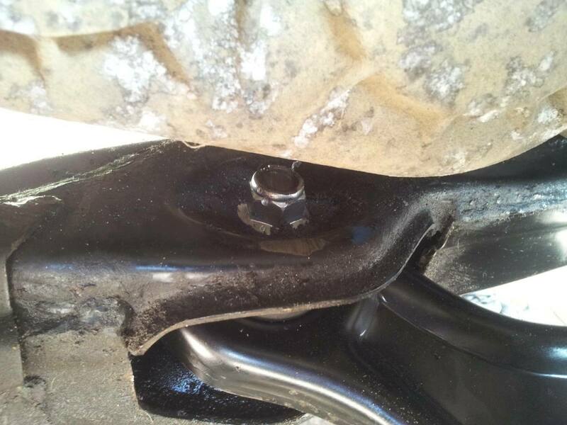

You don’t replace the wishbone bushes, well you can but there is no point, new old stock Unipart arms are only about £15. Easy job which is fortune as they go constantly. Bear in mind on the gearbox side if they are the original then the bolts under the gearbox will want cutting. The ‘proper’ way to do these was to drop the subframe a bit so the bolt went in from the top. I always fitted them bolt facing up, never had any problems with them, then cut the end of the bolt flush to avoid bollocksing the gearbox housing up.
The steering rack gaiters shouldn't have any oil in them at all, all they do is protect the track rod balljoints etc.  If there's lots of fluid in there, the oil seals in the 'rack have failed surely? 😕
Yup, mine were original when I bought the car, and my mechanic did the bolt facing up trick. Been fine.
You get some fuss pots sometimes that think the bolts will fall out. I’d avoid disturbing the subframe bolts on those if possible, quite common for them to spin the captive nut in the box section. Cue cutting and welding the box section.
Sounds to me like the seals have gone on the rack, sometimes especially on a car that’s sat the ram surface might have pitted through corrosion allowing the seals to piss out. That said could well be the seals, I’ve had success with the Slick 50 stuff to swell the seals a bit.

Done the wishbone bushes. All four bushes were shot and the rubber boots on both bottom ball joints and three of the four drop link joints were split, so I decided to buy a kit of both wishbones complete with bushes and ball joints, two new drop links and all new bolts for these.
Sawed the head off the front nearside wishbone bolt (the one directly under the gearbox) as recommended and fitted the new one from the bottom upwards. As @sierraman says, there are an awful lot of dire warnings all over t'internet about you, your family, nuns and kittens getting horrifically injured or killed if the nut comes undone and the bolt falls out, which they assure us will definitely happen. So:
Brand new bolt and Nyloc nut, threadlock, saw off excess thread to prevent it fouling on the gearbox, then peen the top of the nut over. That should do it.
