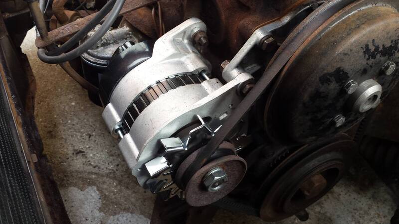

That screeching might not be the belt, it might be the tensioner bearing.  I only know this because the day that @dollywobbler tried to drive mine, the tensioner was screeching its tits off on the way home.  Short fix was to squirt some WD40 (other lubricants are available) into the tensioner, long fix was to use a worse looking tensioner off another car that's been lovely and quiet since.  Also, because of where the belts are, if you go through a puddle just so the auxiliary belt quite often screeches its tits off until its dried out again.
Nice to hear it running and great solution on the rear seat, looks just right.  On the exhaust, as @Mr_Bo11ox pointed out to me way back when, there's a stay that goes from the downpipe to the gearbox, it snaps, and when it snaps the exhaust blows, usually at the manifold joint.  If it's missing/broken, it's a good idea to replace it so you don't end up pulling out your own hair in frustration at trying to get the exhaust to stay sealed for more than five miles at a time.
Thanks, but there's no tensioner on this one, the belt goes to the alternator and waterpump and that's it, it's a pushrod engine so there's no cambelt.  Does at least mean there's only two things it can be, I hope it isn't my NOS waterpump but entirely possible it is.  I'll investigate today.  Thanks for the exhaust advice, I will be trying to sort that later today as well.
The alternator squealed pretty bad on my MGB when I first got it. Replaced it temporarily* with one of the cheap ones you can get off eBay and will rebuild the old one in the future. Old one is still on the shelf waiting...

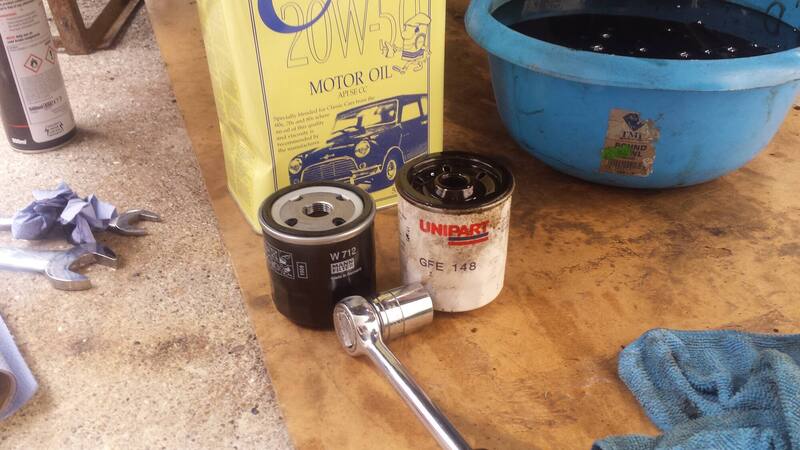

Much achievementing was done today.  I started off with the exciting task of getting the car up on the ramps I bought from an antique shop in town a few months ago - they've previously been tested out on my Granvia which has relatively chunky tyres and they were fine then, mildly alarming process coaxing the car up then as it struggled to pull itself up gently without a short run up so trying to balance that with not shooting off the front was interesting.
Oil change completed, many litres of mucky, ancient oil came out, this thing takes 5.8 litres!  I will have to order some more, I only had 5 although it's up to above the minimum mark, I guess this is due to it sharing the oil with the gearbox.  New filter is a smidge smaller than the old one but is a perfect fit - behold my 30 year old filter, which came off with minimal hassle.

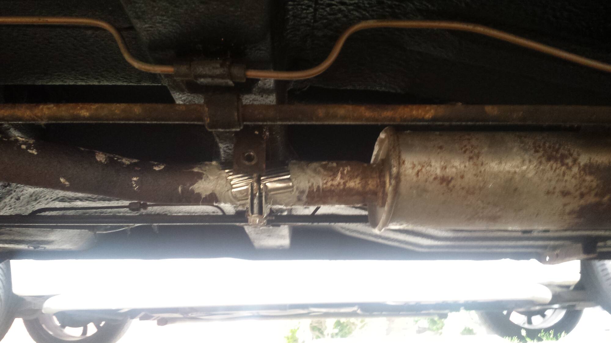

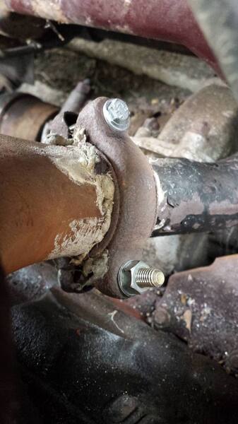

While I had access to her nether regions I could confirm the seller's description that underneath, this car is very, very solid - maybe the underseal's hiding something awful but there's no obvious signs of it, everything looks straight and pretty original.  The exhaust has been getting louder and louder and my inexpert ears led me to the join between what looks like the original front pipe and a newer rear section which the seller fitted.  It looks like the front section might have been cut back to get the old bits off, there is a gap in the flange and no option to move the pipe around to fix that.  In the photo below, there was a clamp over the joint, I'd already removed it to get a proper look at the joint.  You can just seen the little rectangle of open exhaust, matched on the opposite side as well.
I therefore deployed the time-honoured fix of clamping a bit of tin (Sainsburys Basics tomatoes if you're keeping notes) over a smothering of exhaust paste to hopefully seal it up.
Started it up and...it sounds the same.  Further investigation reveals that silencing this joint has highlighted the front flexi is where most of the noise is coming from.  I cannot find a hole anywhere, it looks sound so I assume the flexi section itself is just knackered.  However it looks like I can get a new one for £30 (it's the top one with the long flexible joint in the picture):

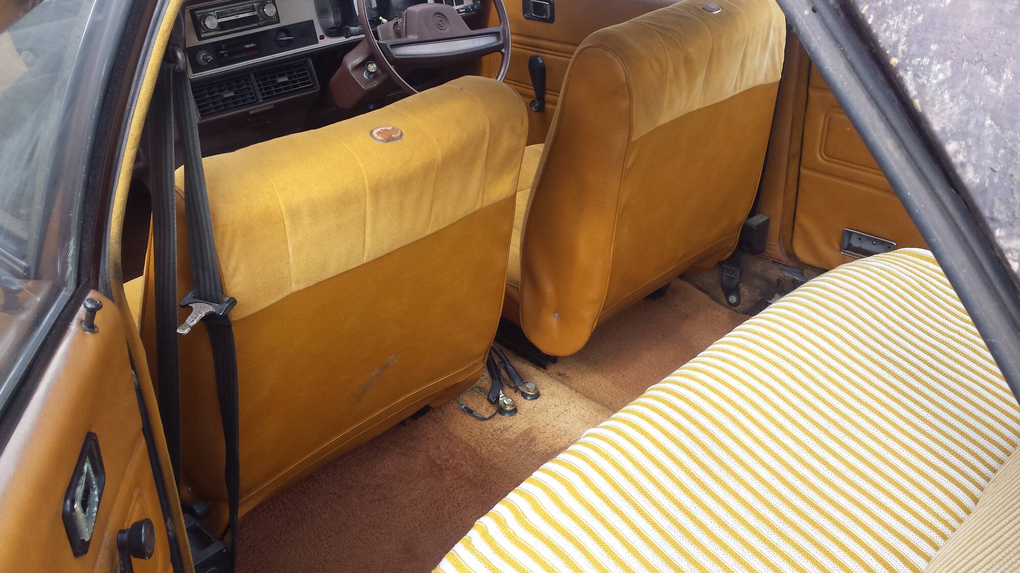

Finally to cap off the day's work, I hoovered most of the dirt out of the interior and refitted the nice clean carpets and dry sound insulation - really pleased with this, it feels like the car's coming together more and the inside is a lot more pleasant now.
Spot the colour different in the footwells where the original BL rubber mats have protected it - I've now cleaned and reinstated those.

Was it just that clamp around the joint? If so then the rubber support brackets which the clamp and exhaust are supported by are missing which will cause severe stress on the flexi joint, hence the noise.
One is hidden in the photo but is attached to the clamp, the other is broken.  It's definitely the flexi joint, I've ordered a new replacement for £30 delivered so weather allowing I can find out if that's done the trick this weekend.

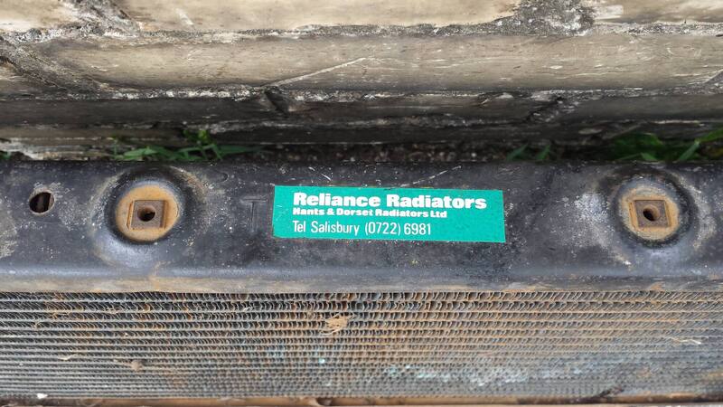

Today's job escalated somewhat.  As it didn't rain all day like it was forecast to, I decided to remove the noisy alternator so I can get it refurbished in town.  That was easy enough, I had to remove all the bolts when I changed the water pump a few weeks back anyway so it only took a few minutes.

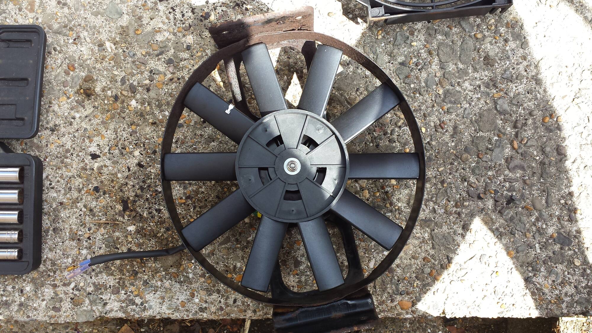

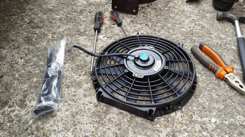

With that done, I thought I'd have a crack at replacing the knackered radiator fan.  This in turn required disturbing the radiator, which in turn lead to philosophical questions such as "why are my feet getting wet?"    The answer turned out to be because, not entirely surprisingly, a pin hole had appeared in the front of the radiator and was tinkling water out at a steady rate.  I removed it - necessary to get the bulky fan out anyway - and sure enough, it's looking pretty sorry for itself.  It's got one or two holes in it and the bottom edge is looking pretty rusty.
Honestly, I have a good mind to ring this lot up and complain - you get your radiator replaced and 35 years later you have to do it again.
I wonder actually if this might have been an emergency replacement, the car has lived near Reading since '79 so perhaps the original let go during a trip out west.  We may never know.
Any thoughts on the best way to resolve this?  There's a NOS one on eBay (https://www.ebay.co.uk/itm/AUSTIN-PRINCESS-1800-NEW-RADIATOR/402279540998?hash=item5da9baa906:g:JzYAAOSw3X1e0iNw) but it's £100 and I am a cheapskate, I may see if there's any local places that can repair it but no idea if that's feasible or cost-effective.  It definitely needed attention anyway, despite the cooling system being filled with clean water and a scoop of detergent a few weeks back, what came out was murky brown filth and there was a fair amount of silt in the radiator.  I had intended to give it a flush through with a hosepipe soon anyway prior to refilling with the proper coolant, there's a couple of original hoses that still could benefit from being replaced as well.
The old fan used to work when the car was first dragged out of the barn but since being with me hasn't been too happy, the motor is quite seized so it does this: https://drive.google.com/file/d/1KFXLLKtaZSISLMOdAaSFnYi9MMYOcR2J/view?usp=sharing (hideous noise alert, turn down your volume)
The new fan is a cheapo generic Chinese 10" job off eBay as recommended on the owner's club Facebook page, seemed to be pretty well made and it's a much more compact item than the original.

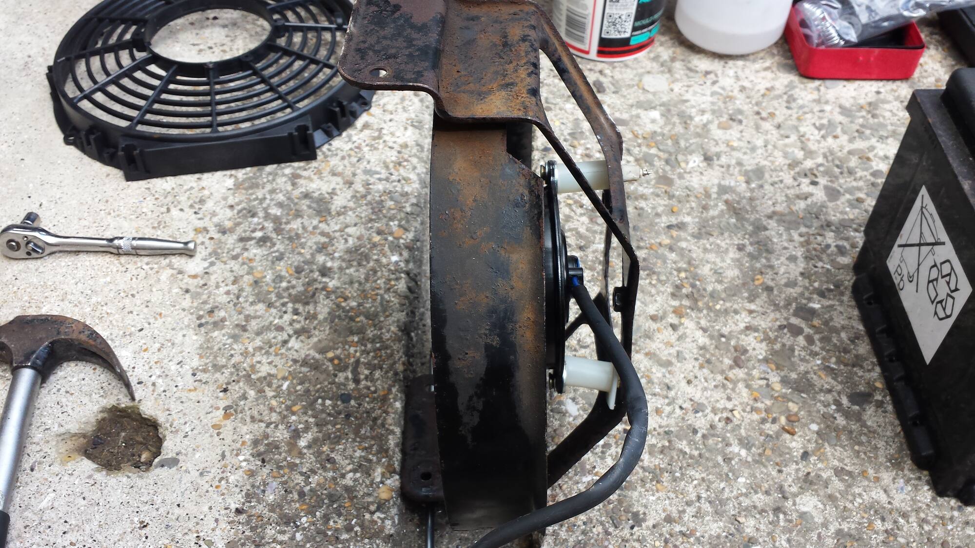

Fitting it to the original shroud was a bit tricky, fortunately I have several tubs of bolts and random odds and ends that might be useful one day - today was that day for a pair of interior trim mounts off my Granvia which when trimmed down and given appropriate mounting holes in the original shroud did the job perfectly.
Old fan removed from shroud...
New fan installed...
A quick test with some jumper cables to the battery showed that it works a treat - proof here if you feel you need it: https://drive.google.com/file/d/1KHCV7gFiOZQI6OWti4uIkw6tFljvlKjJ/view?usp=sharing.  It's nice and quiet and doesn't catch on the frame so hopefully this is a decent fix.  It's a bit bodgy but if it works, who's complaining?

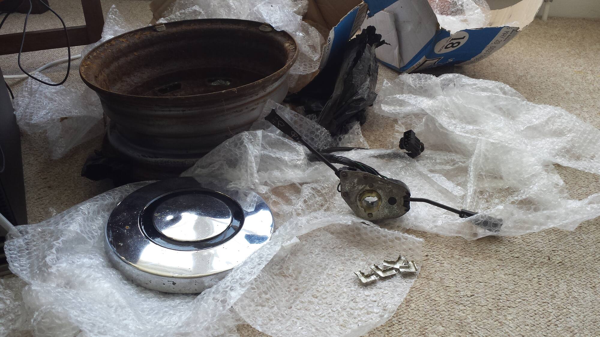

Today I received a care package from a fellow Princess sufferer.
@vulgalour was kind enough to send me a package of spares he had knocking around so I now have some rear window trims, a spare indicator stalk, an Allegro hubcap (Princess ones are hard to find and Allegro ones are similar enough to get away with)  and an Ambassador spare wheel - mine's missing its spare so I will get one of the new but mismatched front tyres mounted to that and match up the other tyre.

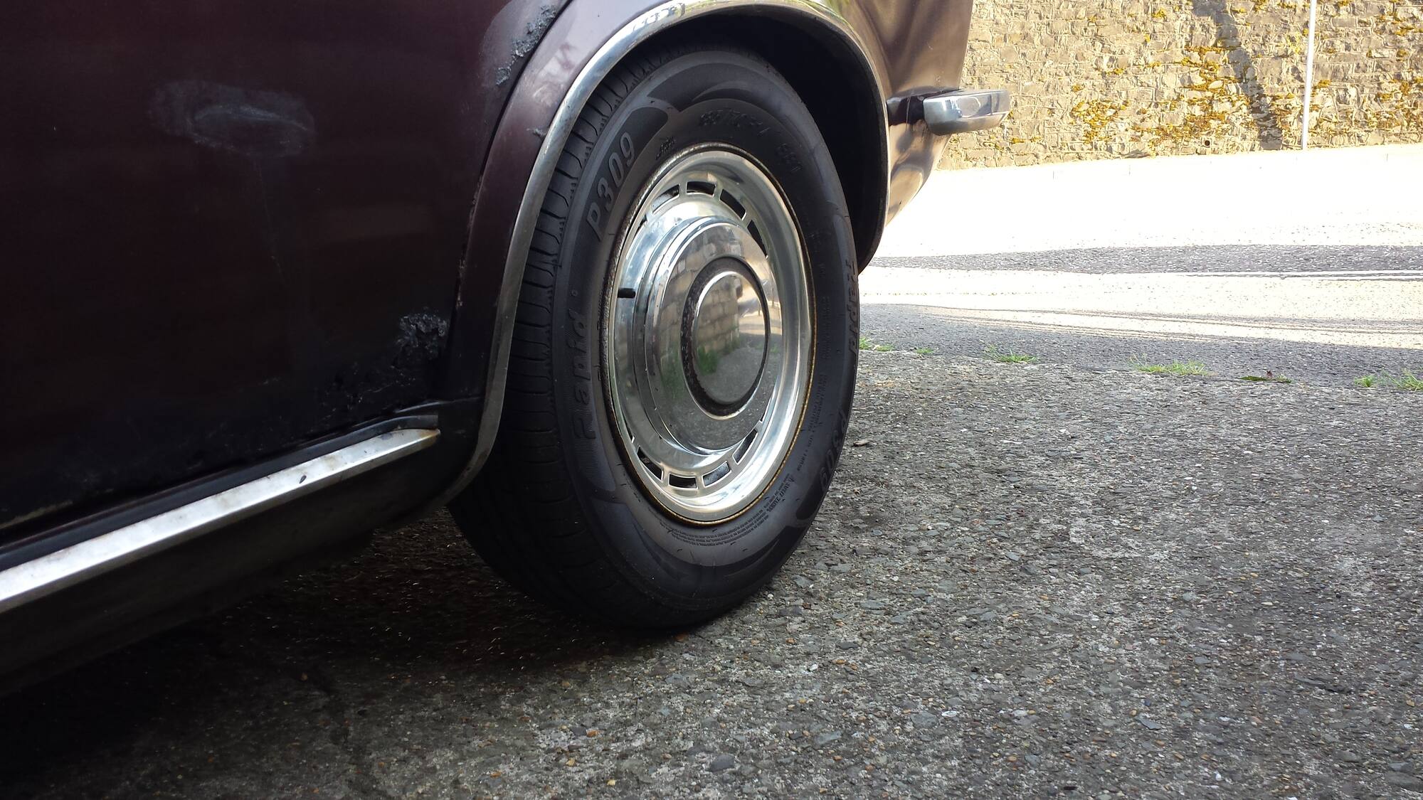

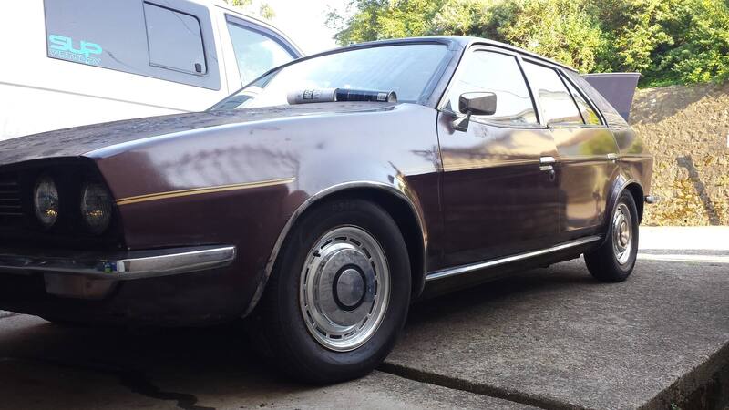

I had a free hour this evening so decided to sort the wheeltrims - the car came with a full set of trim rings in the boot and 3 original hubcaps, all heavily corroded with rust stains and a greenish tint.  They really let the car down so now I have one shiny Allegro hubcap I reckoned it was only right to bring the others up to a similar standard.  I attacked the caps and rings with a wire soap pad and a bucket of water, followed up with a quick wipe over with Brasso (the foulest smelling substance in my garage, I'd say).  I'm pretty pleased with the results - they're far from perfect but are hugely improved and plenty good enough against the car's shoddy paintwork.

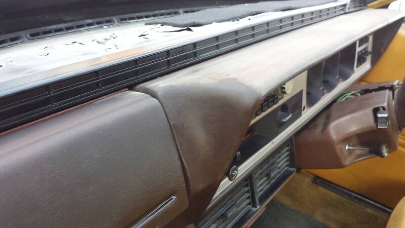

To finish off I attacked the very faded and sad looking dashboard with a can of tyre shine I had lying around to see if it'd help - I would have tried linseed oil but I seem to have run out.  I don't know if it will last but it looks a lot better without making it obnoxiously shiny.
A 50/50 with the top of the dash shows how much it's improved - smells nice too.
I have a plan for replacing the knackered vinyl on top of the dash.
I also refitted the brand new alternator the other night - just waiting on my new radiator now and hopefully if the weather behaves it'll all go back together this weekend.

One new alternator.

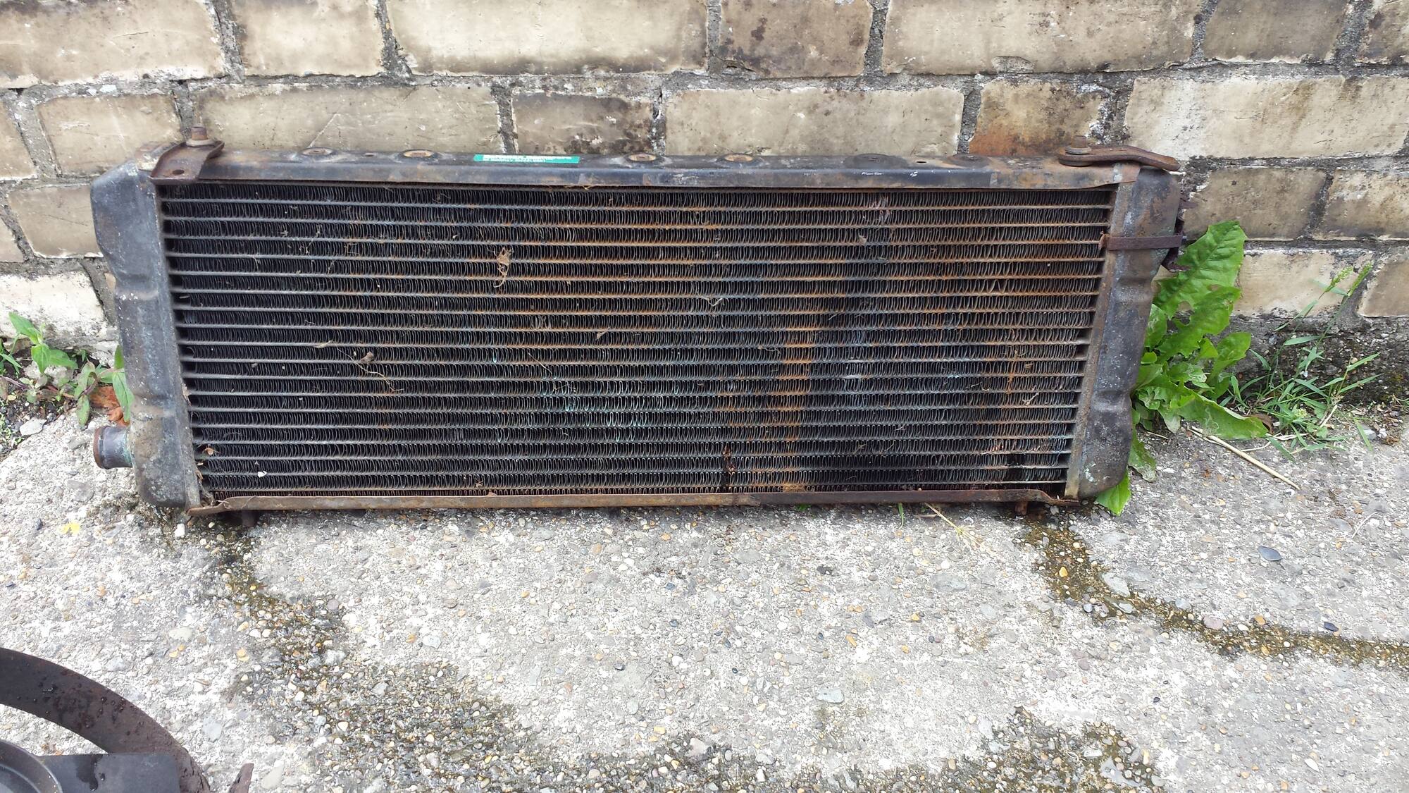

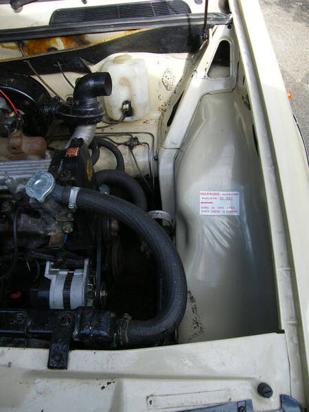

Next job was my new old stock radiator, listed specifically as suitable for an 1800 Princess and it looked correct on the listing.  That proved to be 95% correct - it's ever so slightly different.
Old:
New:
Spot the differences?  They're actually upside down in these photos, the top hose connector is on the side rather than the back and the header tank feed is in a different place and is a different shape.  That unfortunately meant that neither of the correct hoses would fit.
Fortunately I had a radiator hose section which I bought in error which had a wider bit on one end.  It turned out to be suitable for this comical affair of bodgery:
Yes, those are zip ties as the jubilee clips I had weren't big enough and I had to cut one of the original hose clamps off.  The header tank joint was provided by a piece of fuel line which was a tight fit but did the job.  Would you believe that the only leak from this ridiculous setup was from the coolant temperature sensor (bottom left with the green wire going into it) which evidently needs a bit of sealant around it.  The original top pipe is attached to the radiator and the slightly brownish weird-shaped pipe is the one I had hanging around as a spare.

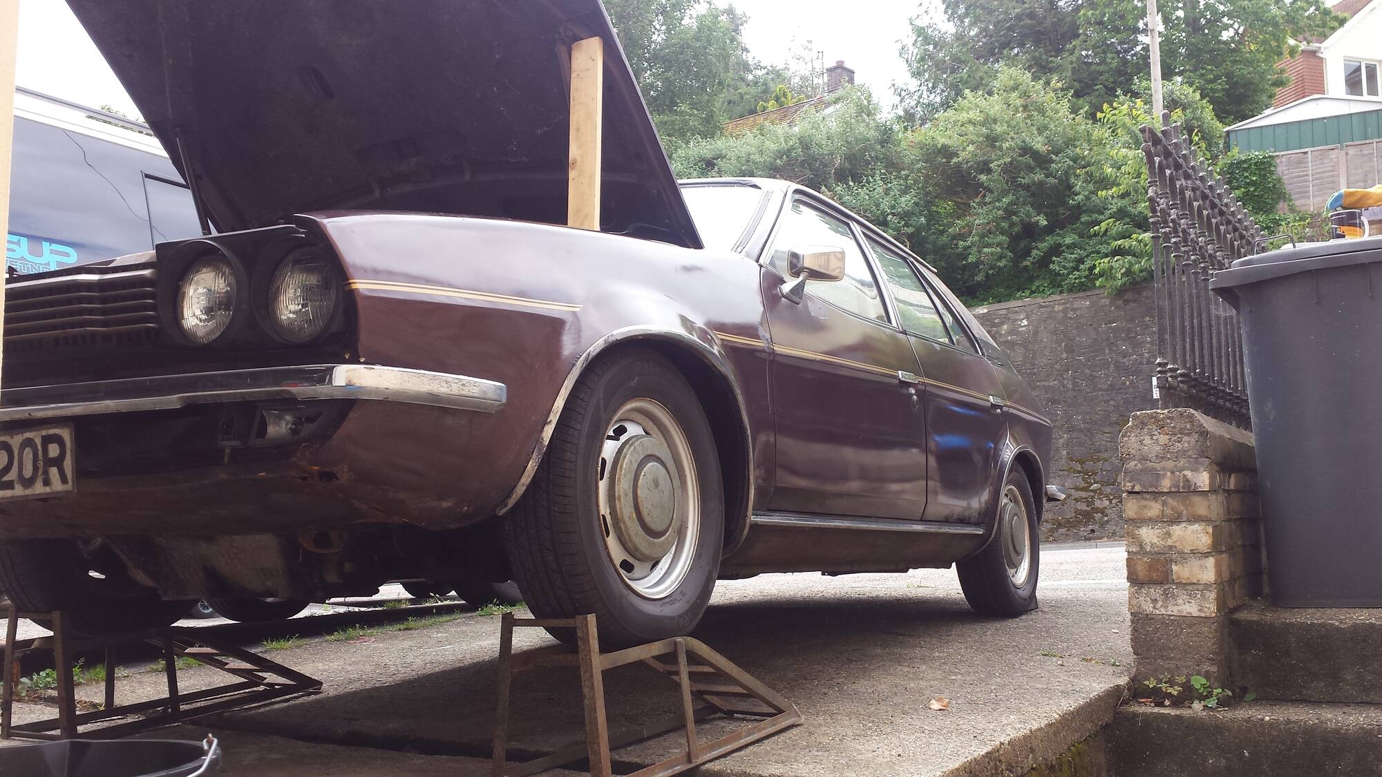

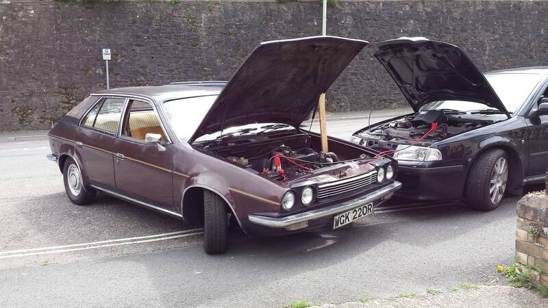

Right then, that's done and it has some water in it - time to get it up in the air.  The battery died again so I will get a better, bigger one next time I'm near the scrapyard which sells them.  Luckily with my mate in attendance he was able to help push it back off the slightly sloped driveway enough to give it a jump from my long-suffering Octavia, which is getting jealous of all the attention the Princess is getting.
With some extra volts the Princess started right up, we got it on the ramps (I will never enjoy that process!) so the farty exhaust could be replaced.  The bolts on the manifold clamp sheared off - which was actually fine, as we had good replacements ready to go - and the rest were easily removed, it probably only took us about 10 minutes to get the old one off and find out why it was so loud.

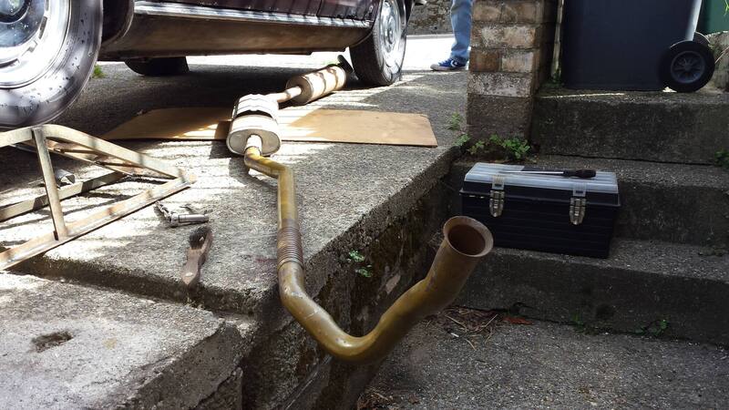

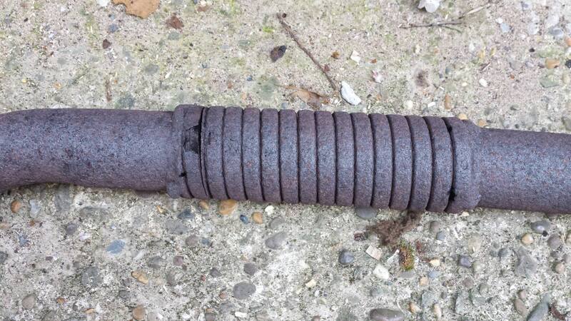

As I suspected, the flexi joint had broken in several places.  Time to fit my new old stock one, which fortunately fitted a treat.
Getting the manifold joint aligned was a bit of a mission, I realised afterwards that we should have fitted it to the manifold before attaching the rear section, it would have made it a lot easier.  It's a bit messy with exhaust paste but it has sealed nicely.
The first start proved that it's now a lot quieter which was fantastic - however it's not quite there yet, annoyingly the centre joint which I 'repaired' before with a dollop of exhaust paste and a bit of tin can is blowing again but it's good enough for now.  When it does finally make it to the garage for suspension and tuning work, I'll get him to sort the blowing joint while it's up on his ramp.

Looking at the problem with the radiator fitment again, I think it might actually be for a 1700.  Reason being, this style of top hose looks like the right shape and direction:
https://www.ebay.co.uk/itm/Austin-Princess-2-1-7-2-0-1979-82-Quinton-Hazell-Radiator-Top-Hose/283842418255?hash=item421653964f:g:SGkAAOSwnXRej3xl
The only issue is whether it'd be long enough.  I've bought it anyway, worth a shot,
The hoses I've seen on 1700s, mine included, are normally much longer than that, like so.
I've found a few examples of 1700/2000 Princess engines and they all have this longer hose.  However, looking at parts listed, they're all the shorter looking one like the one you bought.  Bit odd.  Anyway, that new radiator is definitely an O series one with the outlets where they are, doesn't really make any difference to performance, seems a bit of an odd revision really, you'd think making a batch of different pipes would make more sense than reworking the radiators.
