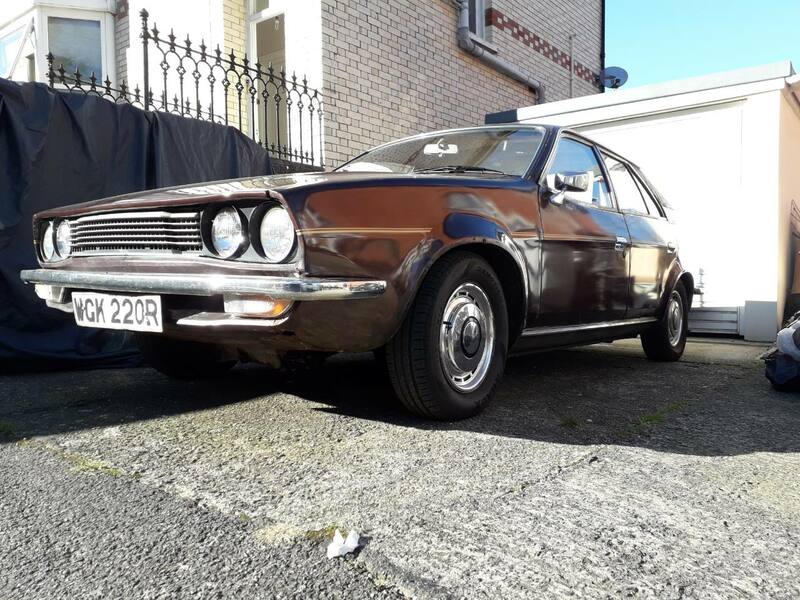

Thanks - this afternoon I redid the outlet pipe with the self-amalgamating tape and that has worked a lot better,  still probably not the final solution but will do until I can find the 100% correct housing.  Also, the stat housing seems to have sealed itself up overnight, as there's almost no leakage at all now and I let it run up to temperature.  Again, I now have the proper stuff to seal it properly but it will do for a short while.
While doing all this, I prodded the clutch pedal a few times and actually got some resistance, so stuck it in gear and actually got it off the drive and up and down my road without drama before it lost pressure again - pumping the pedal provides enough for a few gearchanges so I think a careful drive one evening when the roads are empty will get me the 2 miles through town to the mechanic.  Watch this space.
In the interests of not taking this karmic self-healing nonsense too far, the wipers decided to pack up mid-sweep when I washed the windscreen.  That was fixed by reseating the fuse in the slightly shonky fuse box.  I am starting to believe that it's sulking because it's been mostly ignored over winter and felt the need to vent its frustrations yesterday - now it knows it's getting some attention again, it has decided to play along - sort of like a passive-aggressive British version of Christine.
It even looks semi-presentable in the sunshine, from certain angles.

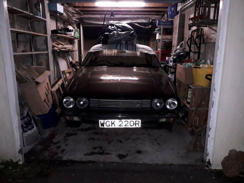

Minor Princess update, it's become a genuine garage find.  As in, I've moved house and have a full-sized garage which it just about fits in.
1822104041_WhatsAppImage2021-03-21at19_33_46.thumb.jpeg.c9616c390d9b77056241529849ce231b.jpeg
It looks quite at home in a flat-roofed, slightly dilapidated garage - not surprising as the garage was built around the same time as the car.

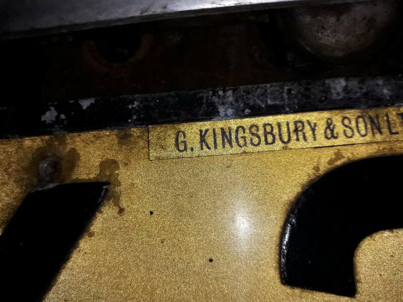

@LightBulbFun there's some sort of mark at the top but it's so corroded I can't make it out.  Maybe some CSI image enhancement will tell you more but this is the best I could do.
Edit: looks like maybe one of the words is Tucker?
ah awesome! thanks for remembering to grab those and grabbing them for me :)
I have forwarded the pictures to Stuart and ill keep you posted if he is able to figure them out :)
I sadly cant make much out, other than a couple letters here and there, (is there anything more legible on the front plate per chance?)

7 hours ago, phil_lihp said:
I'll take another look at the weekend, I can't get to the front at the moment as the car's squeezed in pretty tight.
my good friend Stuart got back to me and he says the rear plate is a Tucker Radiator Services of Bristol, Tucker "Moto-Plate" number plate,  of a rare slightly revised style he did not know about before a sort of Mk2.5
which is why it threw him initially as its similar to the Mk2 style but slightly different , but he was was very pleased to have discovered a new revision for his research :) (the front plate is a much more common Bluemels plate apparently, didn't notice it until now but yeah the front and rear plates are different!)
he says Many thanks for grabbing the photos etc :)
(also one for @MorrisItalSLX feel like it would be rude if I did not tag you in the this slightly in depth number plate post :) )
Is that "G Kingsbury..." a stuck on label. I remember dealers sticking their own names over original dealers names instead of making their own plates when they sold a car.
Yes it is - not sure what's under it, would be interesting to see where it came from originally but don't want to destroy the top label either, it would probably be the place that sold it to the long-term owner in 1979 after it'd had 2 years as a Rank Leisure Services company car.
G Kingsbury is still going!  https://www.gkingsbury.co.uk/
Thats only just around the corner from me! Might go and have a look, when we can !

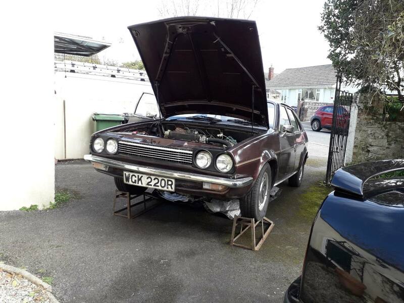

I had no real intention of working on the Princess this weekend, I have an entire house that needs dragging out of the 70s*/early 2000s into this decade but the sun was shining so I got stuck into fixing a couple of long-standing niggles.
*No, not the good kind of 70s, the dodgy wiring and woodchip wallpaper sort.
Loving my flat, spacious driveway, one of the main reasons I went for this house.
First off, the driver's front window is the easiest one to open but still somewhat reluctant, the interior door handle seldom actually operates the latch and the door doesn't shut very easily.  I stripped off the door card, sprayed everything that moved with oil and grease, greased the window channels and reassembled.  The window is better, the interior handle now works properly and the door shuts more easily.  The other 3 will need doing in due course but for now, this one gets all the use so was more of a priority.

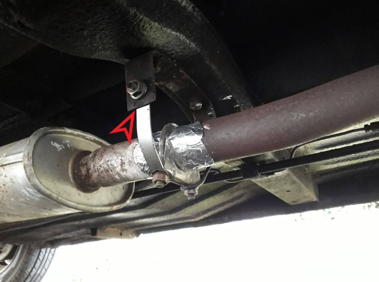

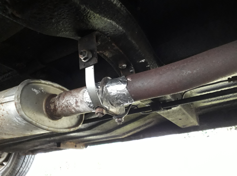

Second job, the exhaust middle bracket is mostly missing, the unsupported joint blows a bit and the remains of the bracket knock in a most irritating way against the exhaust.  Seeing as I have very little hope of ever finding the correct bracket, I thought: What would BL do?  The answer was clear, so I set about lashing something together out of random bits I had lying around.
One mini spanner, some foil and an assortment of nuts, bolts and washers later:
The result is a quieter exhaust and no more rattling.  I unbolted the remaining piece of the original bracket and found a mini spanner of the sort that comes with furniture in a corner of my toolbox, bent it into a suitable angle and it could have been made for it.  Now I know this is not 100% ideal as it has no bounce in it for absorbing vibration but it's better than nothing.
Bend the spanner a bit further and a cotton reel/bobbin rubber mount would fit right in there.
Yep,a mini one would be ideal,I normally keep a couple on the shelf of my shed,
you can get them cheap in Halfords.

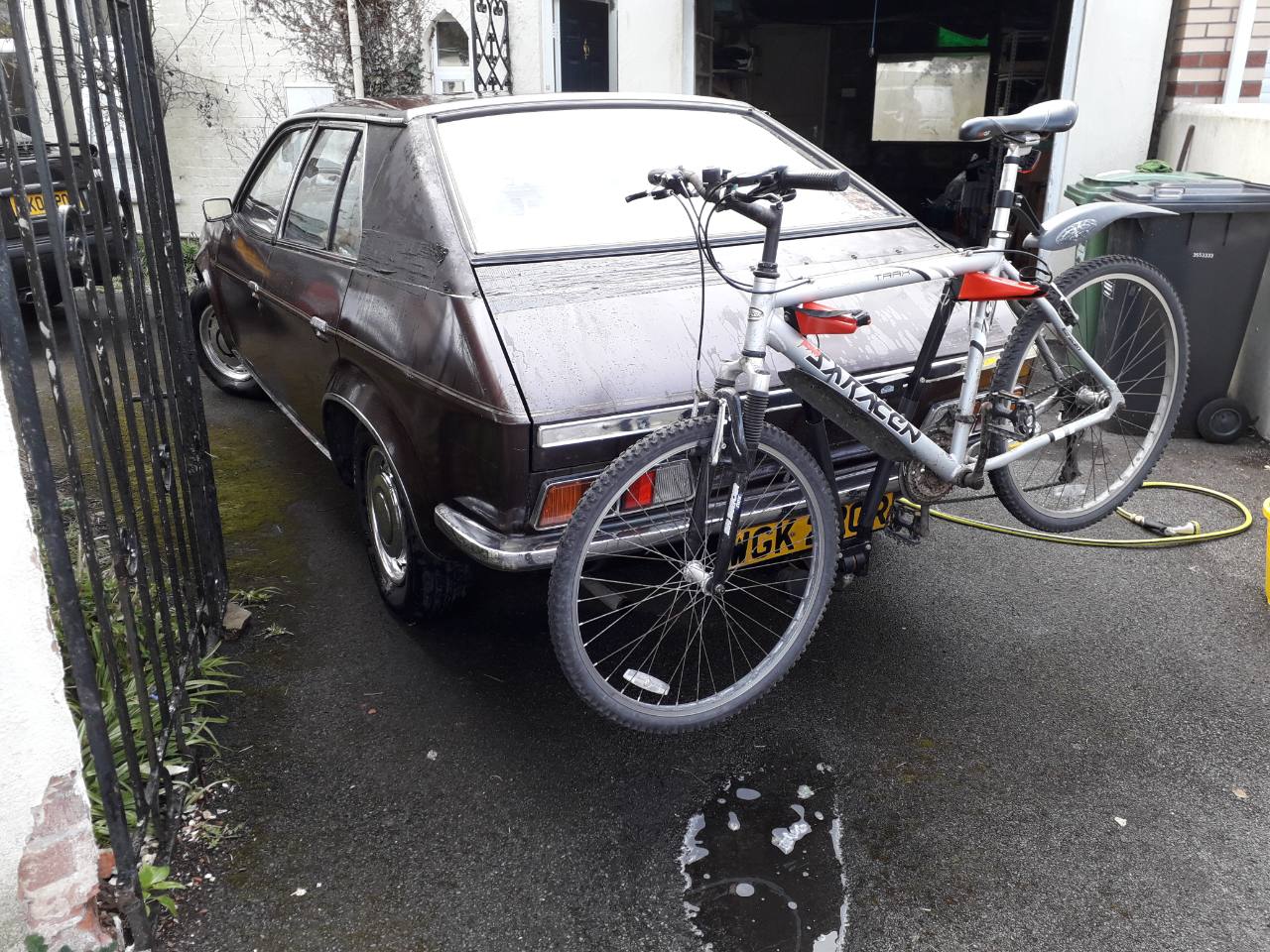

We just had our first fail to proceed.  Can't really blame the car too much though.
As it was blocking the daily Skoda in, I took the Princess a couple of miles across town for the weekly supermarket errand.  Apart from deciding to bring back the shrill belt squeal out of nowhere, it drove fine but as I left the car park on my way home I thought the fuel pump sounded a bit busier than normal.  As I drove past the petrol station I thought, hmm, maybe it's low on fuel - the gauge doesn't work so it's a bit guesswork as to how much is in the tank but I remembered putting fuel in it not that long ago, plus it'd hardly done any miles.
I passed another petrol station and thought, hmm, that pump is a little bit busy.
You can see how this ends.  On the last steep hill up to my house, it abruptly conked out and a quick check confirmed the fuel filter was empty.  Sigh.  At least I was close to home.  The petrol can I'd thoughtfully stowed in the boot was...also empty.
Once I'd walked back with a can of fuel it took a while to work out why it wouldn't fill the carb, turns out these electric SU pumps need a prime when run dry, I had to disconnect the pipe from the fuel filter and run it into a container for a few seconds.  It still wouldn't fill up the fuel filter so I bypassed it and went straight to the carb which worked and we made the final 0.2 miles home, albeit not running very well.  I've got some new filters on order so will fit a fresh one when they turn up.
On reflection, the last refuel was probably a) a lot longer ago than I first thought, possibly not even this year, and b) May not have been a full tank anyway.
Conclusion: I am a muppet.
Whereabouts? I might be being dense here but can't work out where it would fit.
As indicated.
