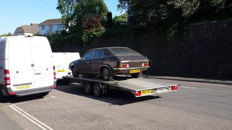

I found a transporter on Shiply who not only brought it to me for less than it would have cost to go and get it myself - factoring in rental of a van and trailer etc - but also arrived a day early and stayed in regular contact throughout.  Top bloke.  All done safely and at a distance and I wiped down the handles, wheel etc afterwards as well just in case.

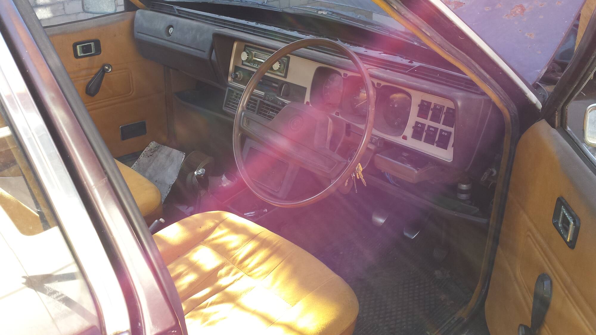

First impressions are...it's way more solid than I could have hoped for - there's some holes in the lower front valance and the top of the bootlid plus the bottom of one rear door and that's about it so far, although the tattered vinyl on the C posts is hiding uncertain amounts of crispiness which will have to be unearthed soon.  Sure I'll find a few more scabby bits before the week's out but the underside is slathered in underseal and it has done its job.  The 1800 lump looks horrible but runs surprisingly well in a noisy, slightly flatulent sort of way, starts easily enough with a bit of choke and there's no horrible noises.  I am certain the car's not been cleaned since some time before it was parked up in 1992, inside or out; the outside is dusty, stained and a bit green.  The interior mostly consists of dust and mould.
It's really quite marvellous.  I have had a quick pootle up and down my road in it but until I've sorted out what it might need in the way of oil, coolant and petrol it won't be going very far.  That said, it drives OK - or at least, it goes in a straight line, the gears function and the brakes work.  Pretty much as it was in 1977 really.
My to-do list is quite short for now but likely to grow every time I walk past it.
- wash it and polish the bits that still have paint on them
- clean the inside, seats and carpets out.  It's a nylon and vinyl biohazard
- find the wiring gremlin that is causing the lights, indicators and cooling fan not to work.
- sort the fuelling/carb issue that means it runs on pretty much forever until stalled when the ignition is turned off.  Probably also the reason why it pops and bangs on full throttle as well.
- get rid of the aftermarket fuel pump which has been "installed" with scotch locks and the rotten original fuel line, it works but it's not right and I don't trust it.  I have a NOS mechanical pump and will get some new lines and clips,  Might be related to the running-on issue.
- pump it up, don't you know, pump it up.  My tame mechanic has a hydragas pump hidden away which he's going to dig out for me.  It has a serious case of the hydrasags.
- the exhaust, which I'm told is a good one off another car, has a blown joint somewhere and is quite undignified.
As for less pressing items, the radio only produces parps and hisses, which is all very well but I'd like to get some LW tunes blasting out of my big crusty speaker so might have a poke at that and the bonnet struts, naturally, do not work.  One of them actually started spewing oil while the bonnet was propped up with a plank of wood.  Not sure on the bonnet's patinated finish - despite appearances it's very solid so I might just scrub off the loose paint and slap a coat of black or brown Rustoleum on it for now to keep it from deteriorating.  The noisy end will also get a full service including gearbox oil as the gearchange is somewhat challenging.  Will give the linkages a good lubing as well.
From photos I've seen and the evidence on the car, the barn/shed it was in had no door on it and the back of the car was somewhat more exposed to the elements than the rest of it.  Longer term will probably involve a replacement rear door and bootlid and some weldage on the front valance.  It desperately needs some new rubber window seals and if I were being picky I'd rather like a velour interior if I could find one - the dash top and parcel shelf need some new vinyl and the top of the back seat has disintegrated.
I don't think I will be bored for a while with this one.
