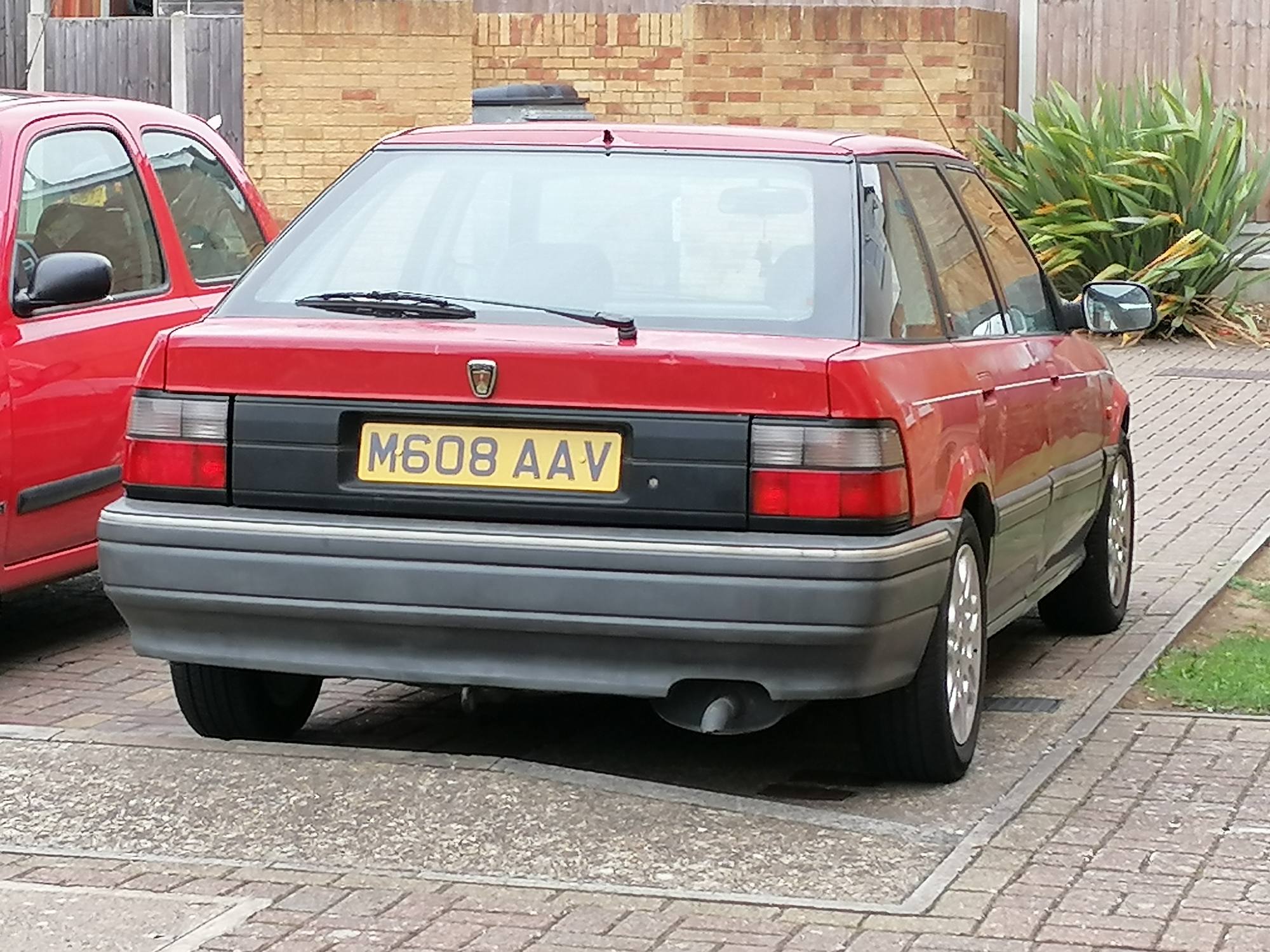

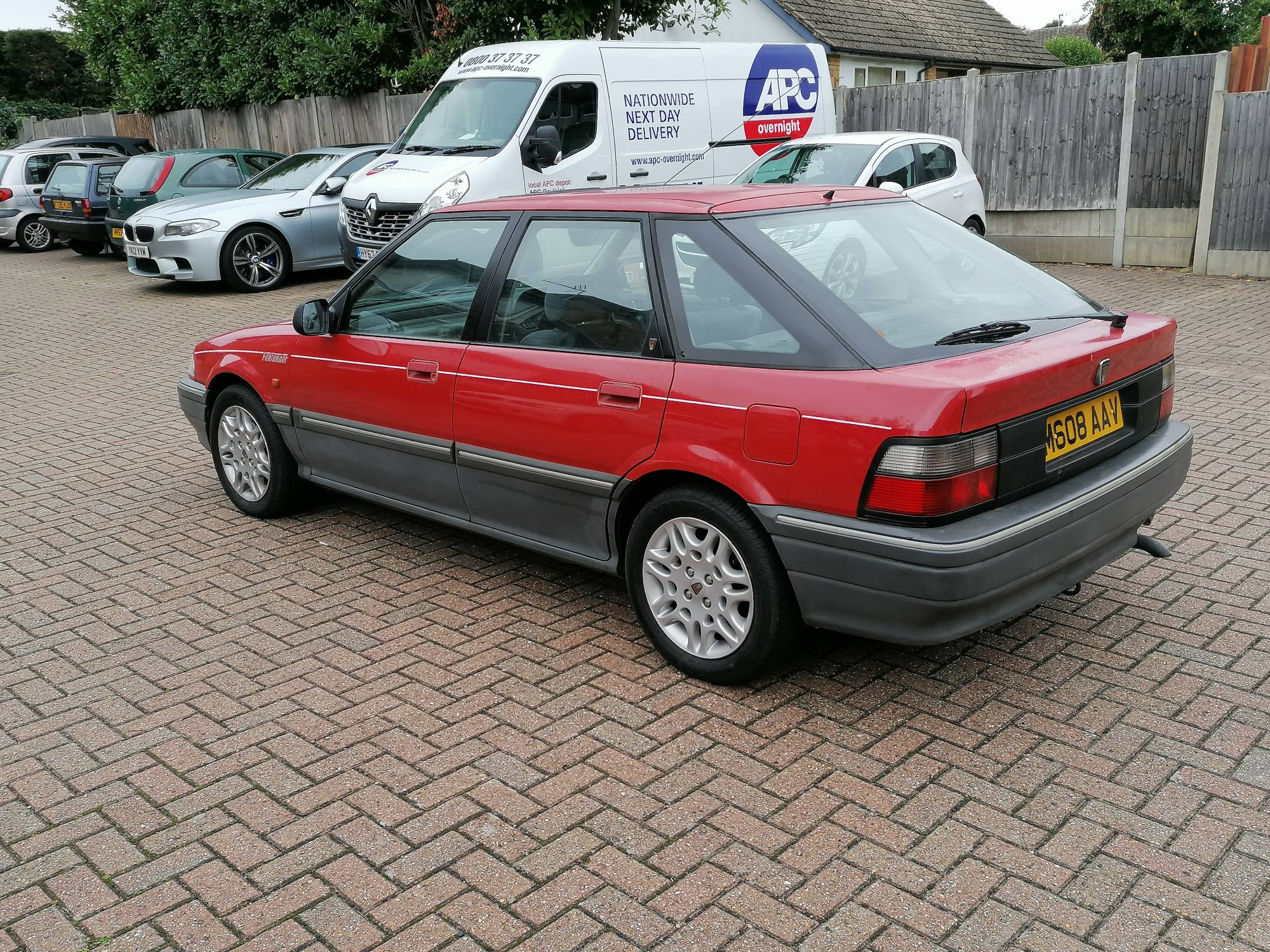

Figured out how to swap the springs without removing the strut from the car, so all sorted now.
It looks a bit arse down in the pictures for some reason, but it is level.
  • DoctorRetro changed the title to The Doctor's travels through time - Spring has sprung
Absolutely superb ride height there, right where it wants to be.

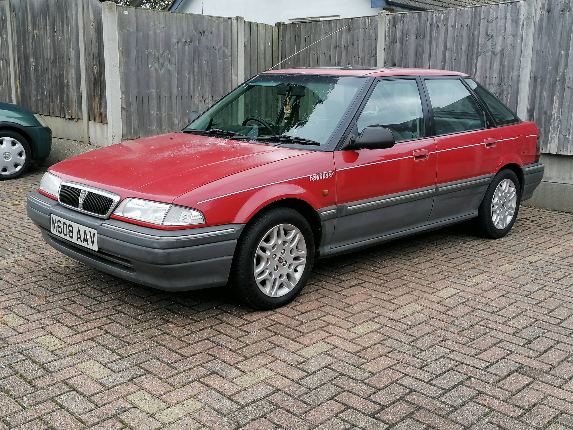

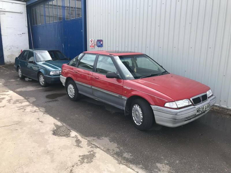

Comparison pictures from when I first got it.
Looks good! Glad you managed to sort it. Its a ride height I like as it's still comfy and useable

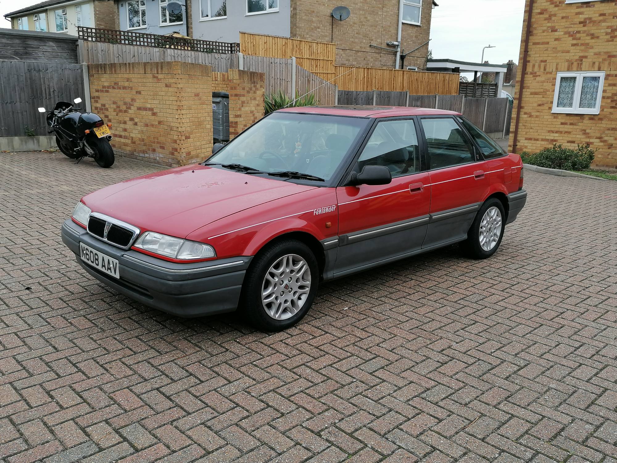

I've taken all the crap out of the boot and it looks better. Will take a picture tomorrow when the car park is more empty
It does look right now. How is the ride? Will it soothe your back or will you get every bump?
I wonder if the appearance of arse dragging had something to do with the standard rake having been reduced. I guess the rake will have been pronounced on the taller springs.

Most FWD cars are slightly higher at the front for some reason, so yeah it does show when you lower them equally all round. Hence why I'd normally use a grinder, then its a custom stance as opposed to and out-of-the-box one.
I'll try to park it in the same position as this one tomorrow to show the difference. The 416 was too low, pretty much on the bump stops.
I love the stance in the 416, just have to admit these days I can't be arsed dodging potholes and crawling over speed bumps at 45 degrees to avoid leaving the exhaust behind.

Better pics today. Not sure if the back needs spacers maybe?
Nah looks about right - it'll probably drop another 5-10mm in the next few weeks too

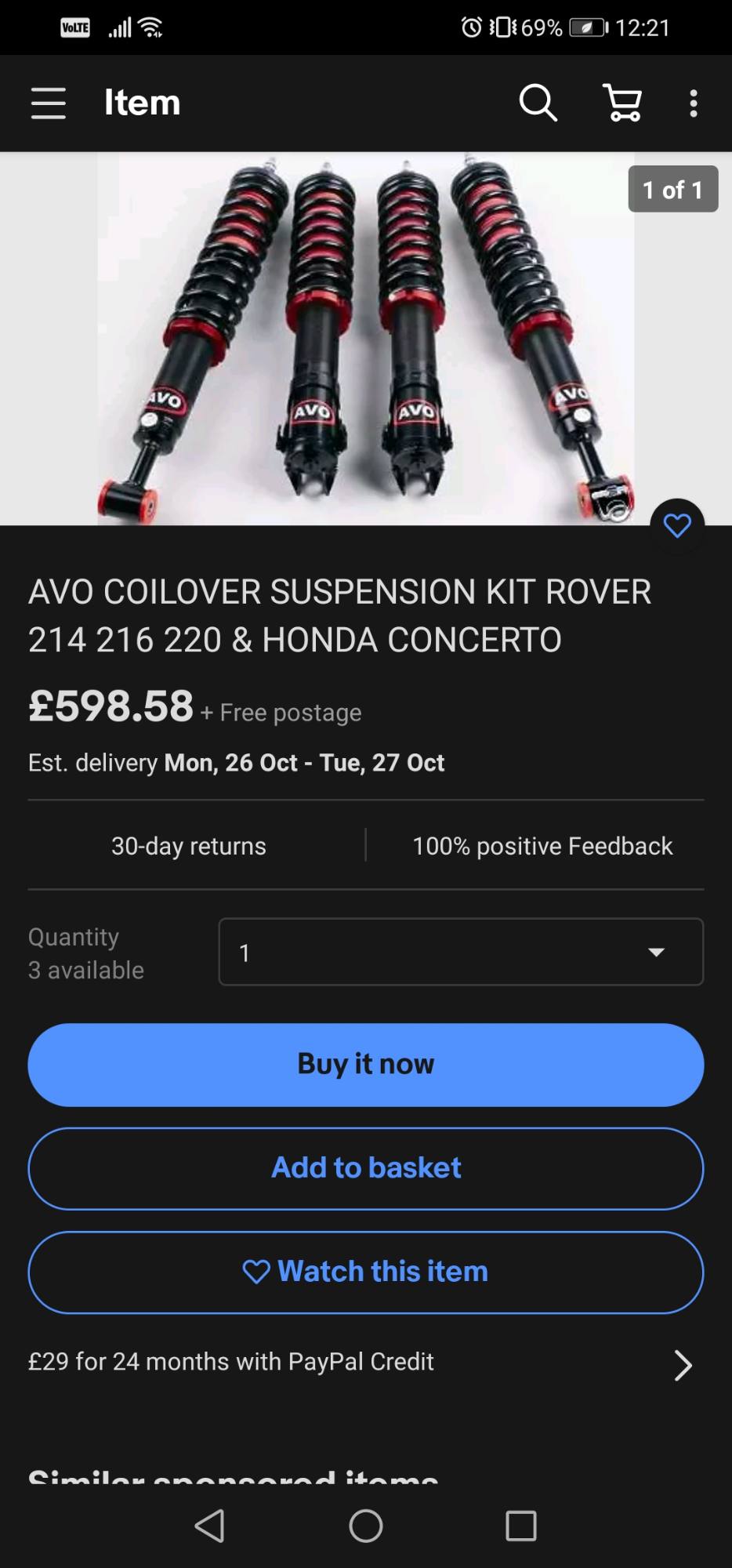

People often use coil-overs, though I expect that solution would be more than the car is worth!
Screenshot_20200926_122105_com_ebay.mobile.thumb.jpg.72e8054dbe72c37743b2fb74fab0a319.jpg
Free postage at least!

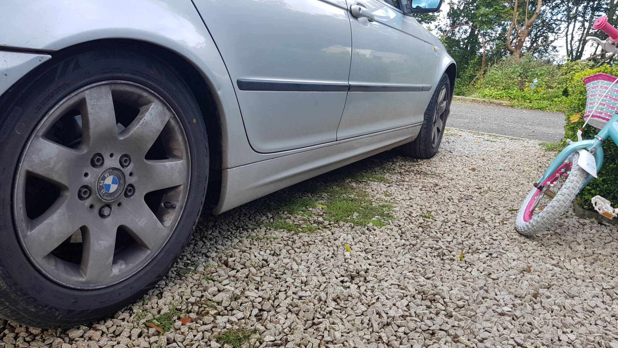

My E46 always likes like it's sagging at the rear wheel you look at the arches only.
In fact it's not, it's as well as a 15 year old can sit on original (presumably) springs. From a distance it looks right.
I think the front arches are set higher for greater suspension travel for hitting bumps with the heavy end, then designers make a huge fuss about drawing up-sloping lines to hide the wheel arch effect.

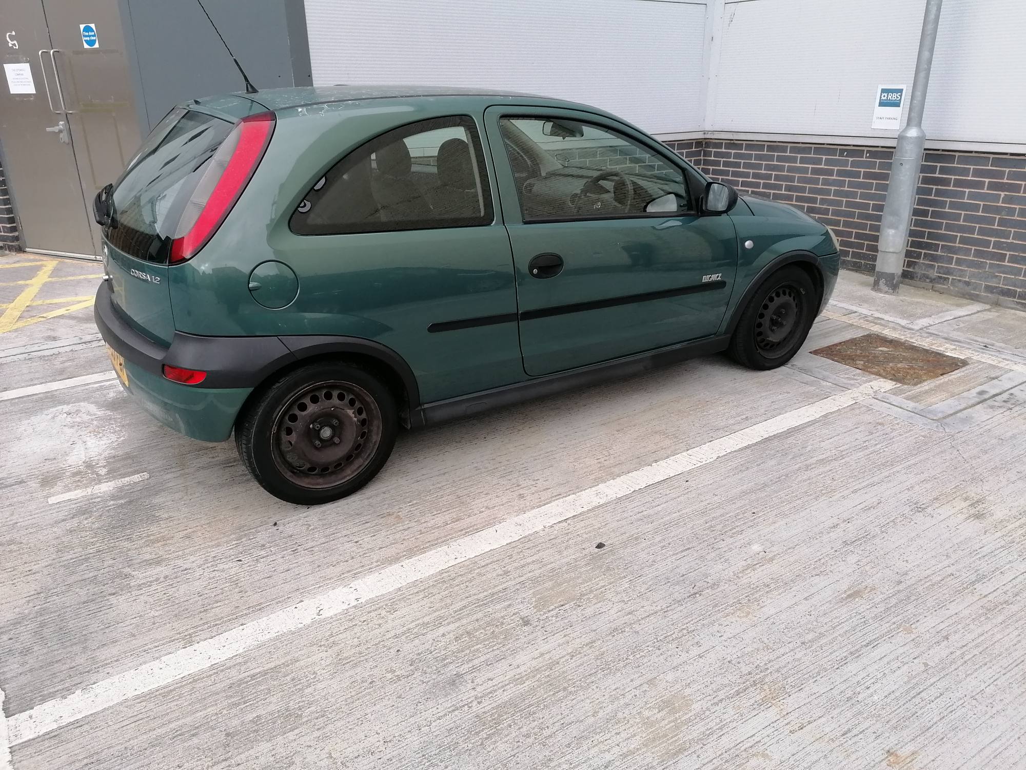

Corsa spat a wheel trim off on Progress Road today, luckily someone flashed their lights and I saw it and went back for it. Had to take the rest off, just in case. Will get the cable ties out at some point, maybe.
In other news, I'm quite sure that the vibration is purely an out of balance, damaged wheel or a misshapen tyre. I'm going to do a tyre rotation tomorrow to check if it makes any difference. Annoyingly I just sold 4 vauxhall wheels with decent tyres. 🙄
I had a vibration on my S80 under load. When I had cruise control set on it, the vibration would appear when going up hills. I thought it was the upper engine mount, which I changed. It turned out to be the tyres. I’d do what you said above and rotate the tyres before starting to replace stuff.
Took the front wheels off and put them on the back of the Corsa.
Went for a blast up the road and the wobble through the steering seems to be gone, replaced by another vibration, but not so much through the steering as through the whole car. I'd say that's pretty conclusive eh? I couldn't see any particular issues with the tyres, so perhaps just a weight come off one of the wheels...
