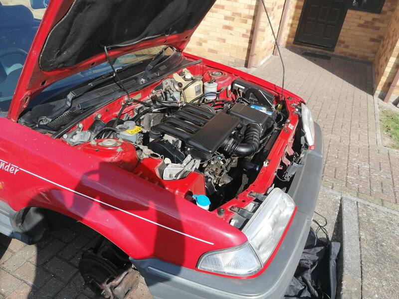

Changed the fuel filter and a fuel hose. Now it won't start. It seems it isn't bleeding properly. 😭
Am I doing something wrong?

There isn't a non retrn valve on that bleed nipple so if it is open while pumping the primer you are just sucking the air back in that you have pumped out. Until there is fuel in the filter it will be a slow process of priming , opening the bleed nipple, closing and then priming again. A canister filter can be filled with fuel before fitting but your type can't so you need fuel in the filter before bleeding properly.
Have you got a self bleed brake kit ? That might work.

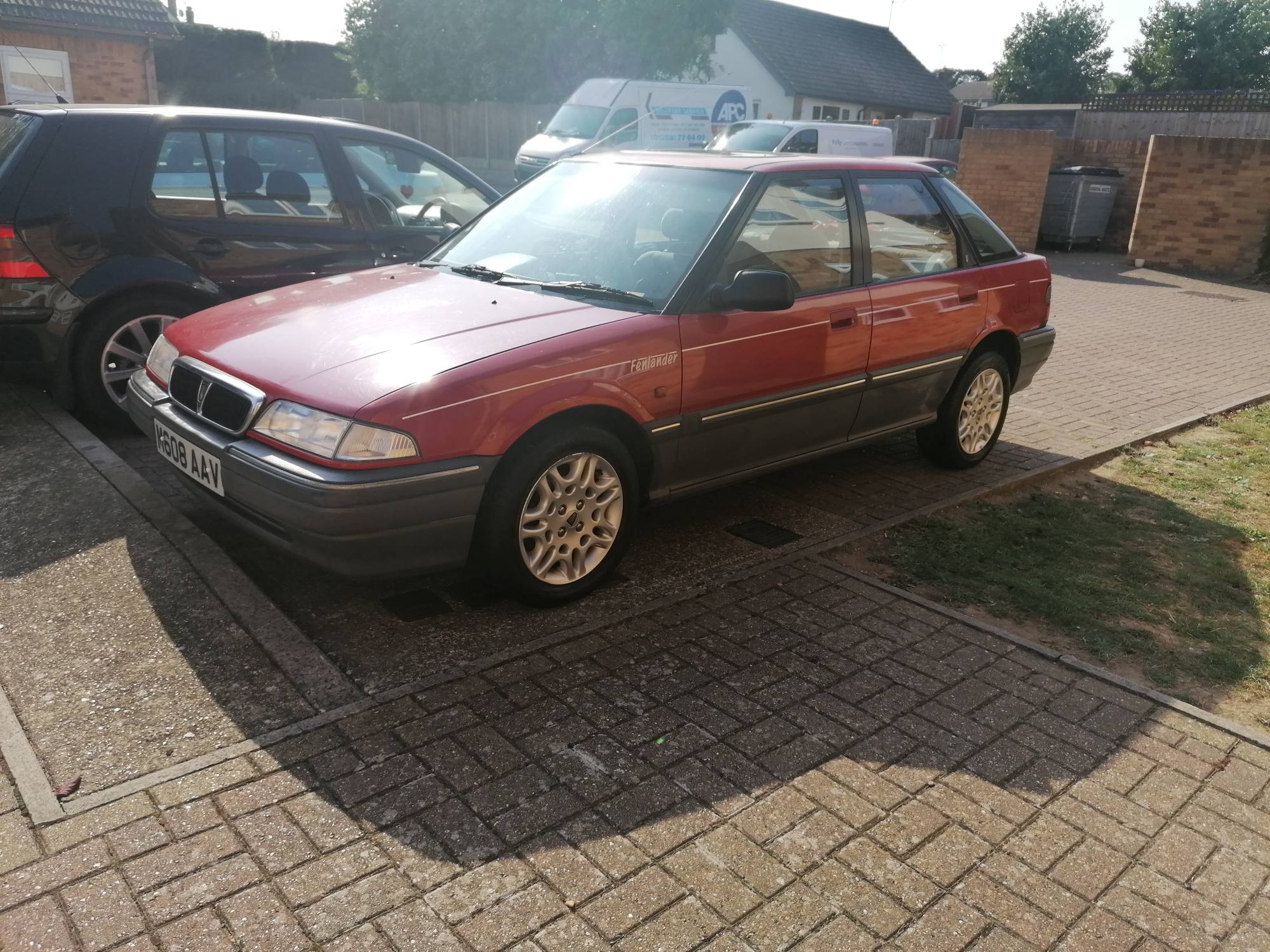

Back home now. I survived.
Many thanks to @wuvvum for picking me up from the station.
First impressions? It's not as shit as I'd expected. 120ish miles and I can't detect a misfire. I can detect a droning from a pulley somewhere in the engine and a wheel/suspension wobble at certain speeds. Oh and handbrake is really poor.
Apart from that it's smooth to drive, seating position isn't horrid (after I'd raised the seat) and it pootles along nicely.
With enough cranking the Rover will prime itself if it's still not starting. Perhaps you've pinched a seal on the "sandwich" fuel filter.

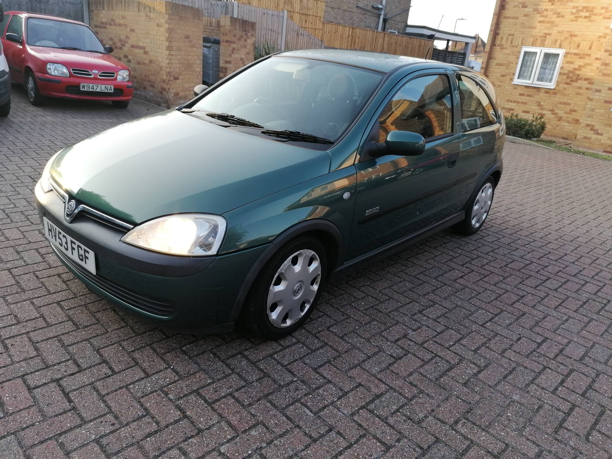

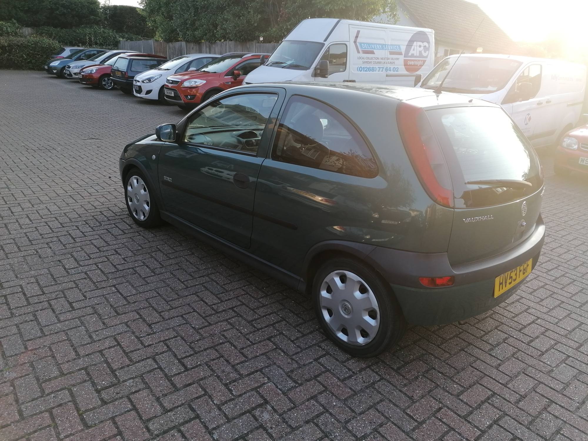

I've always wondered if Corsa was an excellent and reliable car, or there were so many that there are loads of old ones now just because there were loads of Corsas in the first place?
Probably more the latter. They are perfectly capable cars, if a little bland. Not Toyota-like reliability of course, but competent.
they wont tear up the tarmac
The seat frame might tear up your arse getting in though, if I remember rightly
Very unfashionable to even talk about a non-French small car on here, but these are robust little buses.
They're derided only because they're still ubiquitous.
Interiors on base models are utterly grim though, I presume the Elegance spec is not that.
Can't go wrong with it!
nowt wrong with a corsa c. better than a similar age renner or shitroen. almost vw like.
I drove a Corsa C when they were quite new and it seemed worse in a lot of ways than my shagged MK2 Polo. They do seem pretty reliable though and would maybe be better with a 4 pot engine.

Please consider buying a Rover L series fuel filter and bypassing the crap "sandwich" filter to get it going. Fill it with a gear oil bottle or syringe or something like that. They are only £2.52 at ECP just now, tap in 1997 Land Rover Freelander.

I’m by no means a diesel mechanic 😂 but I had a similar priming problem with the S123 when I changed the fuel filters. What worked in the end was a mega amount of cranking - I drained the battery..., then ran it off a jump from another running car. Eventually I was graced with that beautiful acrid diesel smoke.
